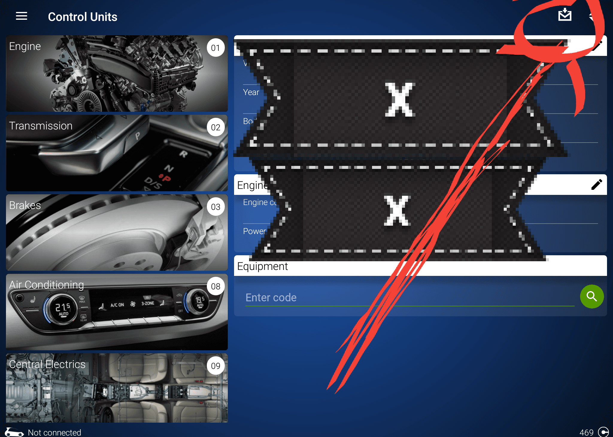

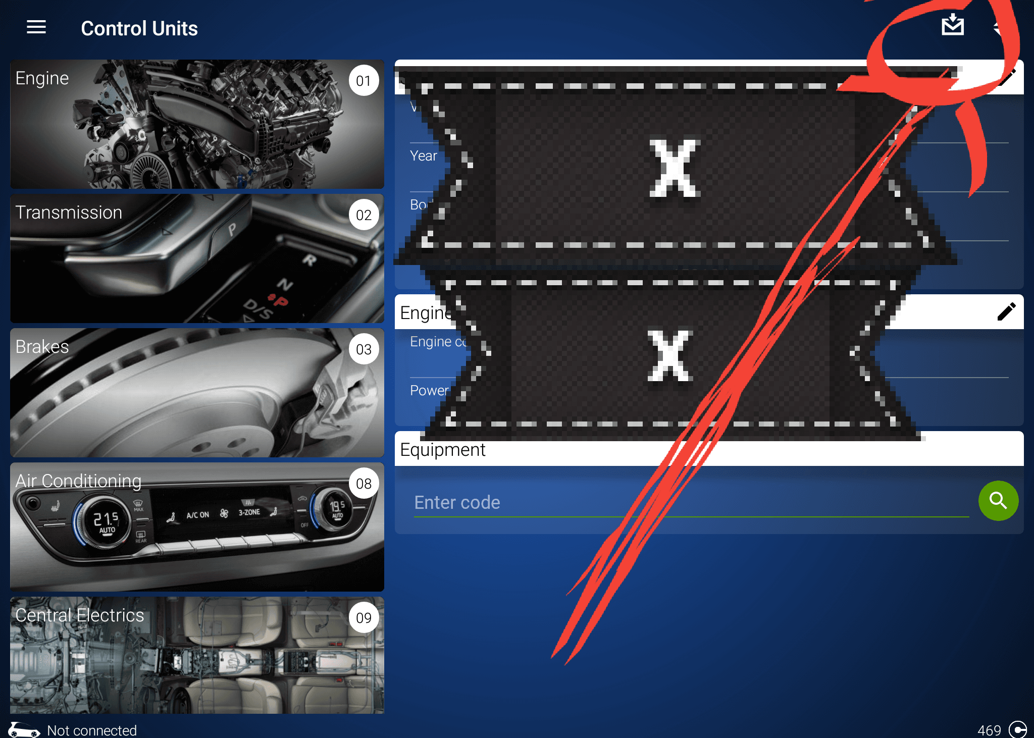

If you see this item arrowed, you tap on it and email it to yourself but without the Pro you wouldn't be able to restore it !.
Reactions: R53Winny
R53Winny
Apr 11, 2022
85
34
Thanks Tell... Think for the price I'll just register Pro for added safety.... Do you know where the back is normally stored? In a cloud, phone or vehicle ecu etc?
