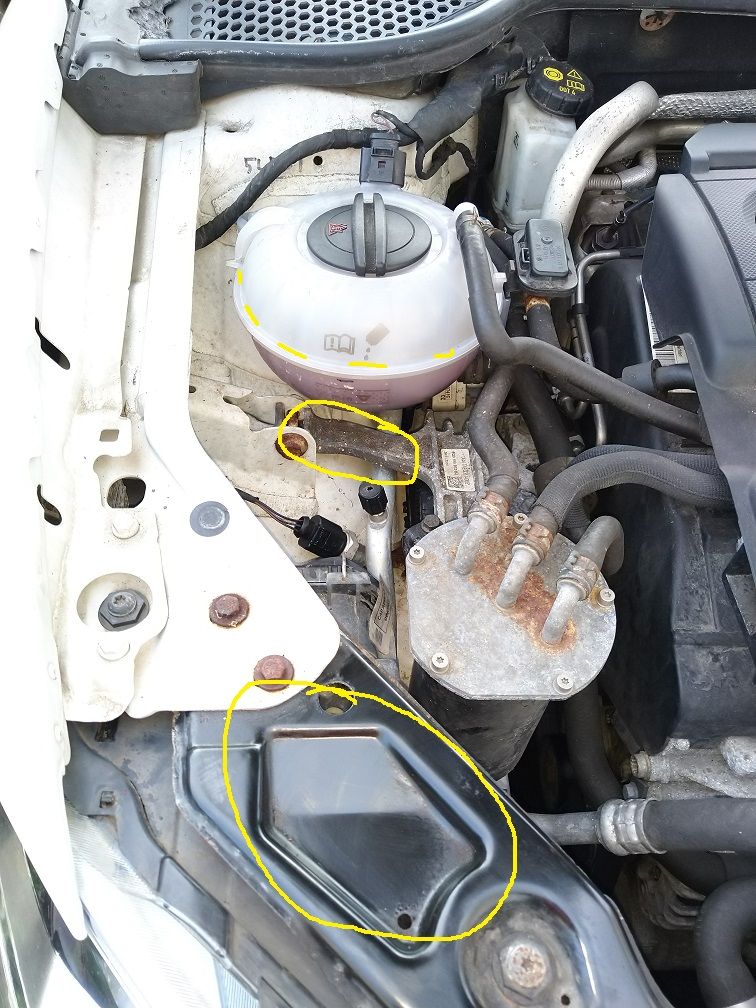

Hi, I've got a Seat Leon 1.8TDI, and have had a few instances where it has lost coolant (coolant level warning light, etc). I have been monitoring coolant level closely, and after most journeys it does not move at all, including where I have driven hard to get engine temp high, but no loss of coolant and level just stays same (once cooled). But on a short motorway journey (40miles) it did loose about 100-150ml coolant in that one journey. There was a bit of coolant in the places marked in yellow circles in photo. I've never seen any coolant actually leaking / spraying. Does the coolant expansion tank have a pressure relief to vent coolant when pressure too high ? Does where where I saw the coolant match where any vented coolant might end up?
BTW - after the first time of loosing coolant, I saw the posts here about the silica bag in the coolant tank and it looked like the one in mine was burst, so the expansion tank was changed as first measure - but it has not fixed the occassional loss of coolant. I suspect the bits of silica have made a small blockage somewhere and that the coolant system pressure is going up higher than it should, and giving the occassional venting of coolant. But the cabin heating seems to be normal, which seems to be common problem with a burst bag, and the car warms up just as normal. Does the expansion tank cap do anything, as that wasn't changed?

@SuperV8 - thanks, your comment that the boiling off can be related to when a DPF regen happens is very useful, as may explain why I didn't get any loss of coolant in my attempts to get the engine temp high with some "hard" driving around, and that it seems to happen during motorway journeys. The cabin heater is working, i.e. giving out hot air, but good that you confirm what I have read in many posts on here that it could be a blockage somewhere.
Does where I have seen the bits of coolant in engine bay match with venting due to high pressue ? I've tried to figure out where it vents from, but I can't see anything obvious or have read any clear description.

The pressure relief valve is in the expansion tank cap.

You asked where exactly does the discharged coolant escape from - if you look at your picture, at the LHS of your series of yellow dashes, you should be able to make out a raised section running down the side of the header tank, it is via this flattened tube that the coolant's escape route is which, if memory serves me, terminates at the welded join area of the header tank - that flattened tube's open end should be down there.

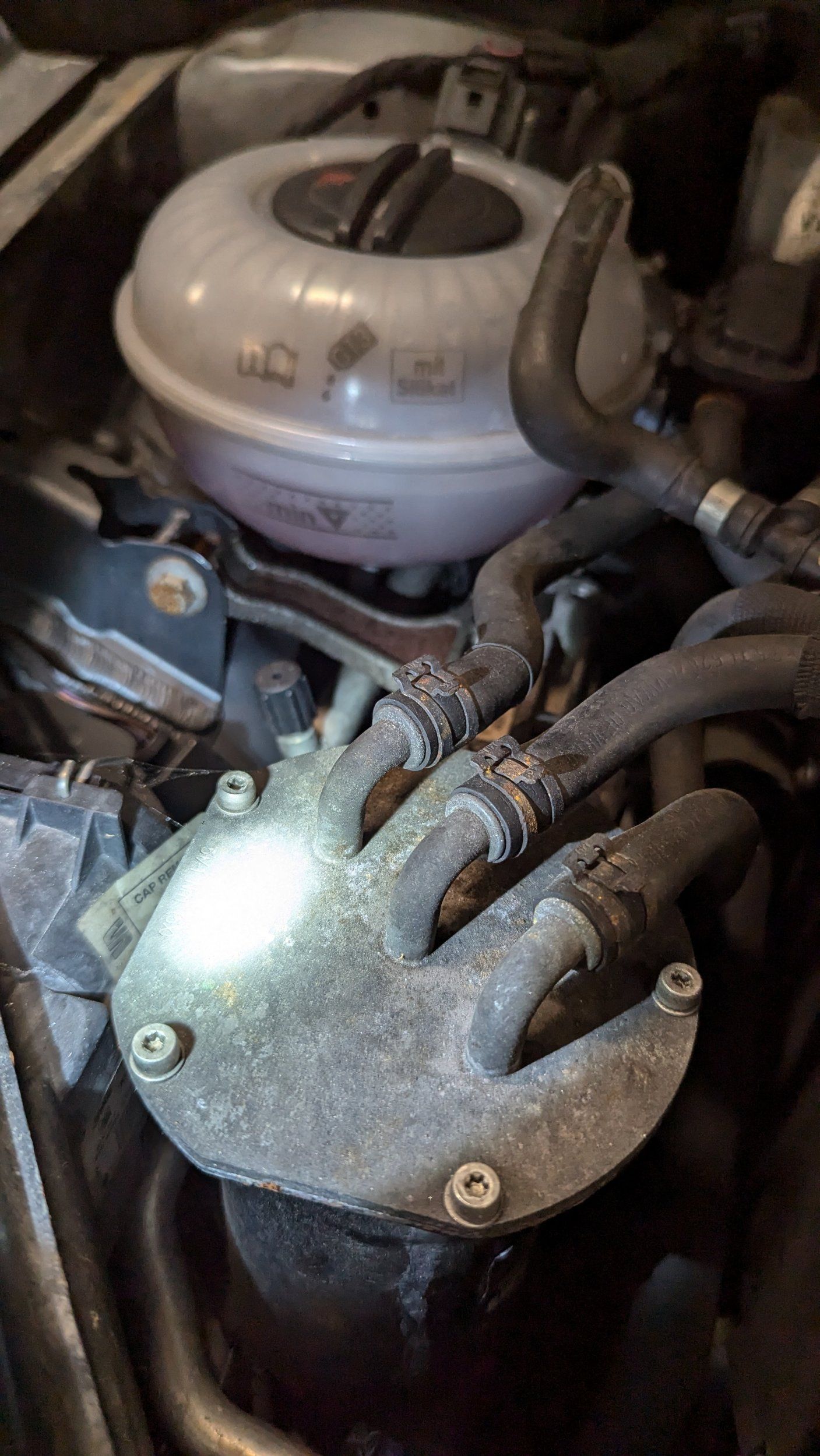

Hi
Can you tell us if you solve the problem with coolant losing, I have the same problem when the DPF regen start...thanks

Hello,
I have a 1.8tsi and also losing some times coolant. I had a leak from the water pump and had it replaced, but this time I don't have any leaks and have some red residue from the coolant on the rubber that seals with the bonnet after very hot days. After how long do you see a change on the water level?

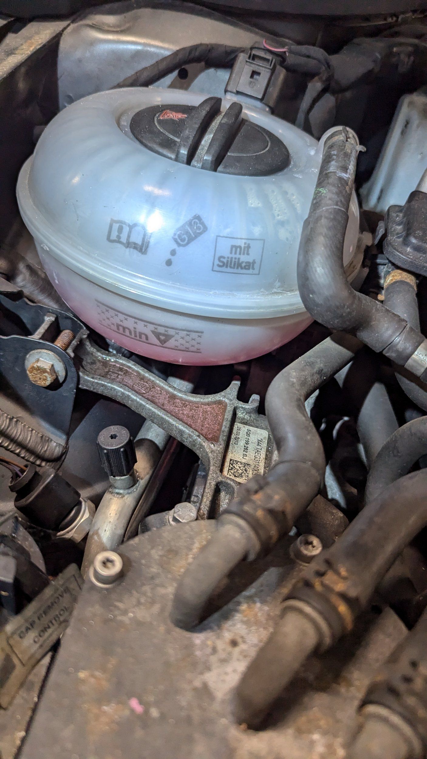

Hi - when the garage swapped the expansion tank at the start the replacement was one with silica bag. I was going to ask for the one without silica bag, but sometimes you don't want to risk winding them up by coming across as an "expert" by virtue of "reading a few things on Internet". I may get them to change at next service once there is less pressure to get the car working, or may try to carefully remove myself. Sadly I don't have the time or inclination to get under the car myself these days for DIY fixes.

It takes a while for the bags to break down and split, so you should be good for a while.
BTW - the expansion tank is on top of the engine and is a 20 min job. It's something someone could easily do in the future if you wanted it done.

If your car now has G12evo in its cooling system, surely the correct reservoir to fit, if replacing now that G12eco is in the coolant, is the later version without Silicate pouch - these pouches, I think, were only required on certain car engines which could experience higher than normal temperatures, which caused the G13 to lose some of its effectiveness as an anti corrosion - and adding on these Silicate pouches could keep the G13 in "good condition".
The silicate bags were added due to another VAG master stroke concept of "coolant for life". The same concept as the 20,000 mile servicing - to appeal to the fleet managers and keep costs down. As the cars now have more aluminium parts in the coolant system, they needed to have the anti-corrosion inhibitor topped up with the silicate bag. Sadly, those bags split and cause other issues.
