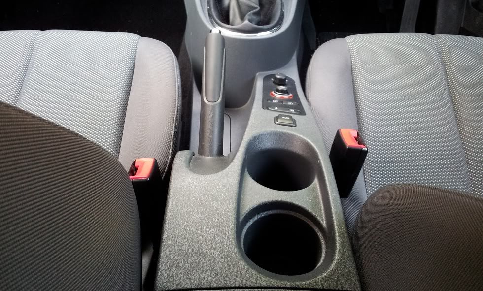

My belt receivers are not the same length, far from it, just taken a photo but i need to have 15 posts before I can post a link to a photo on this forum.
The passenger receiver is level with the top of the centre console, the drivers receiver is nearly 2 inches higher. It is also angled more forward than the passenger one too, something is not right here.
I am aware that the receivers shorten when in a collision, so this could mean that the car has been in an accident and the drivers receiver has been changed and is at the right height, the passenger side may be low because it retracted and wasn't changed, perhaps the drivers receiver failed to retract...

Hmm, the distance between the receiver and the rear of the seat (looking side on first photo) seems to be the same there. The passenger on mine is the same, the drivers is pointing further forward, has a larger gap and is much higher. I'm really a bit stumped as to what has happened here, I'm wondering if another SEAT has a similar fit receiver and has been put in as a replacement. This would be presuming they are bolted on and not a part of (welded) the subframe.

Here we go, picture from rear.
Both seats same distance on sliders however. Note the difference in receiver position, it's 2 - 3 inches further forward on the drivers side and about 2 inches higher.
Weird one?
Does appear to be a bit weird. We need someone with exactly the same model Leon as yours to check theirs for a proper comparison. It's possible there are differences between models.
