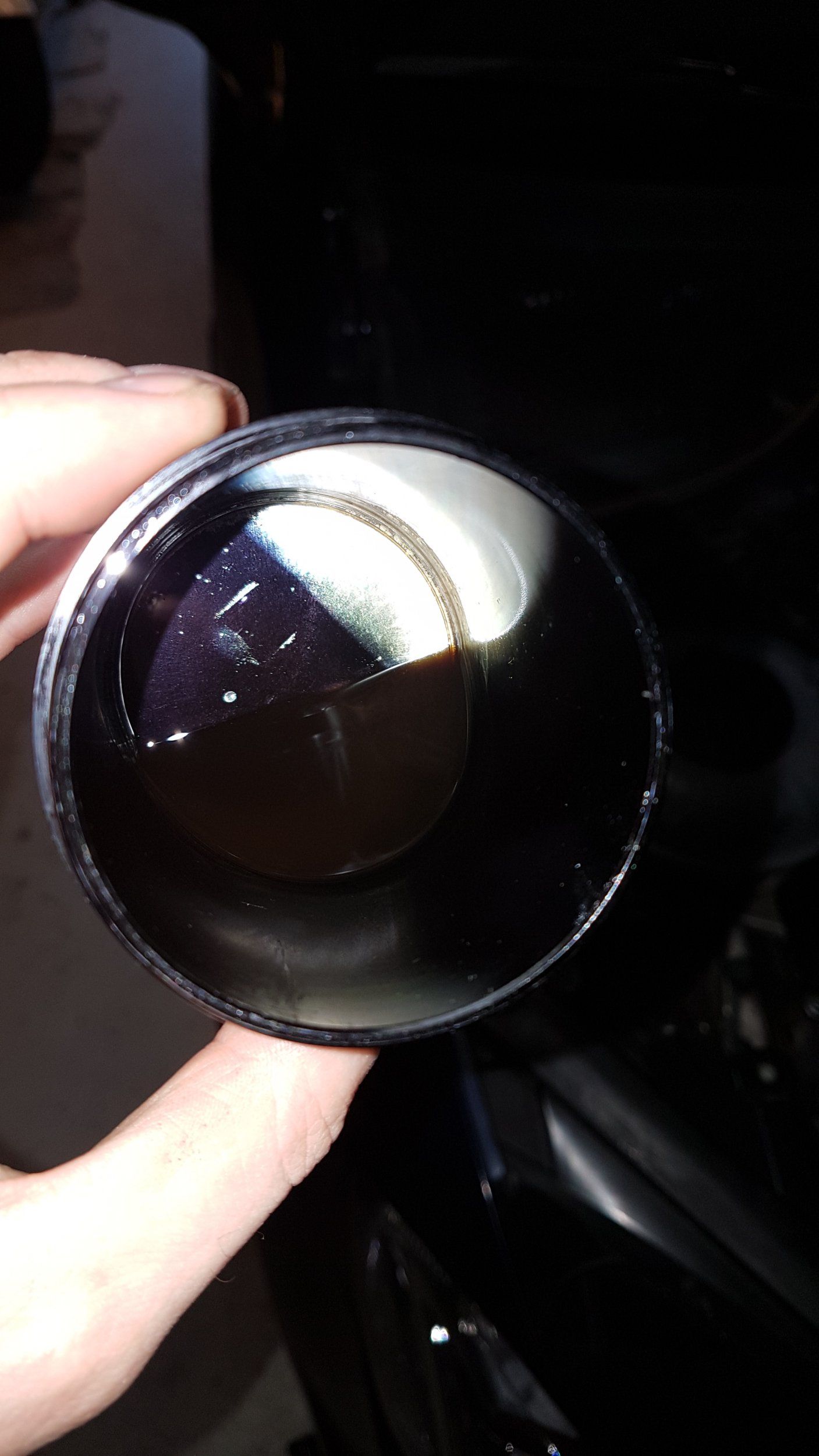

This is what i get in a week:
Reactions: Lozzy15

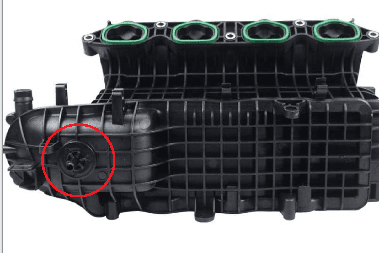

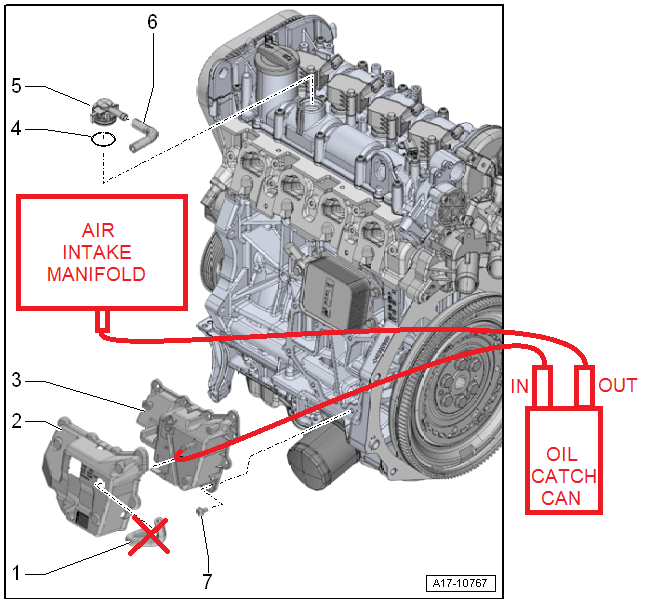

I'm sorry to say you guys that this is not how you fit an oil catch can on this engine, if you fit the oil catch can the way you did you are only catching the blow by from the head and not from the crankcase, which is where the vast majority of the blow by is!
The EA211 family is equipped with a PCV system fitted on the block underneath the air intake manifold they then have an hose that goes from the PCV directly to the air intake manifold, you can see better from the image below:
To install an oil catch can on EA211 engines you have to get rid of the stock hose (Nr.1 in the diagram) and connect an hose that goes from the PCV to the inlet port of the oil catch can, you then connect another hose that goes from the outlet port of the oil catch can to the hose fitting located on the under side of the air intake manifold, you can see better from the image below:
I have personally installed it this way, and believe me i do catch a lot of nasty oil.
Metter of fact if i unplug the dipstick from the catch can with the engine running i can see vapours flowing out!
Hope this helps!

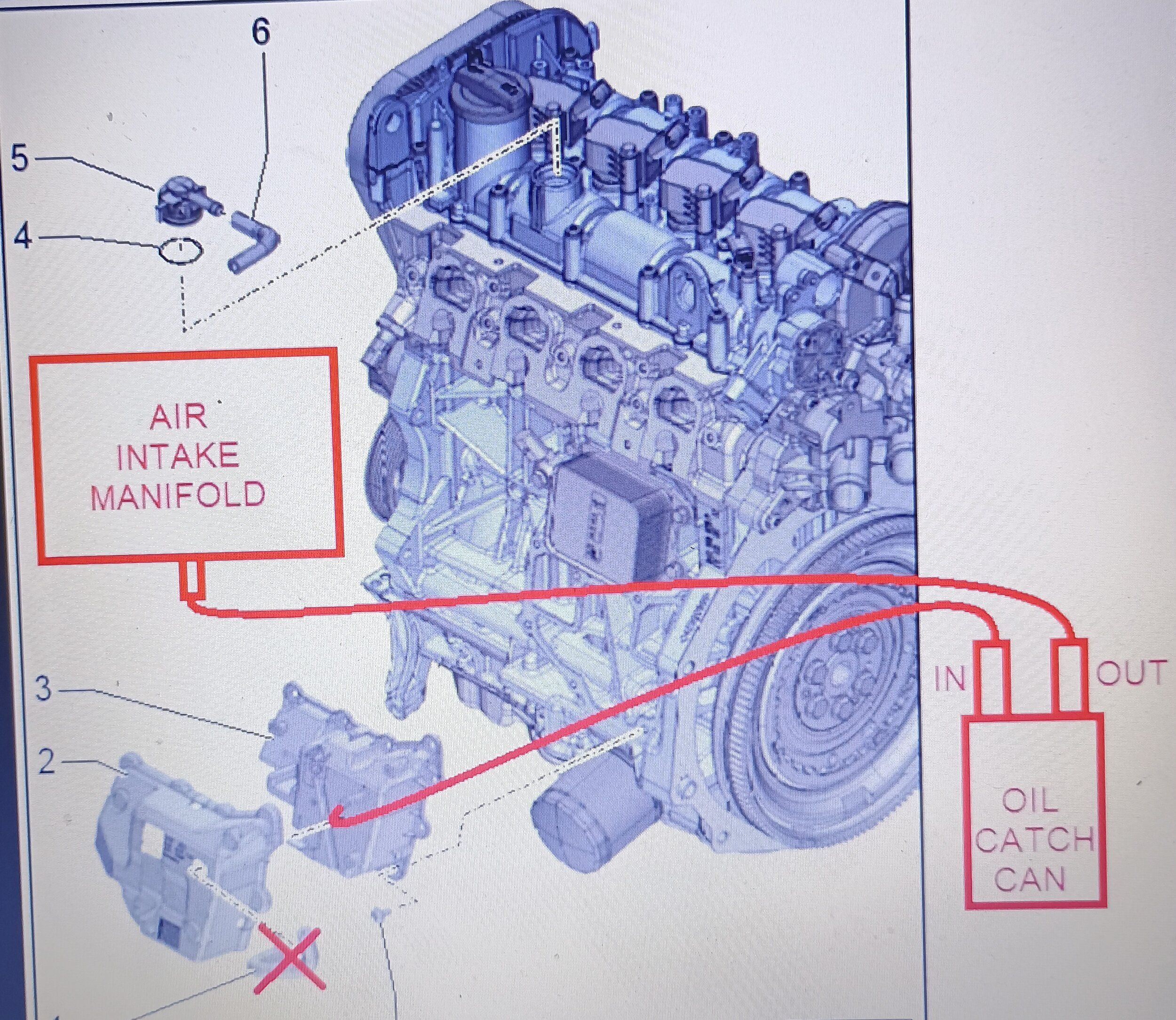

Sorry for reviving something old, but this is super relevant.
So what we can conclude here is that 2 catch cans are actually best?
One for the cam-to-turbo ventilation as Lozzys original guide refers to, and one for the crank ventilation that is hidden below the intake manifold?
Interesting which one is worse
It would be interesting to see the difference. I only have the one as shown in the guide and it gets fairly full and has to emptied around once a month. I think you could probably plumb it all into one catch can if you were to do the lower one too, using some one way valves to ensure no issues arise from linking up the breathers.

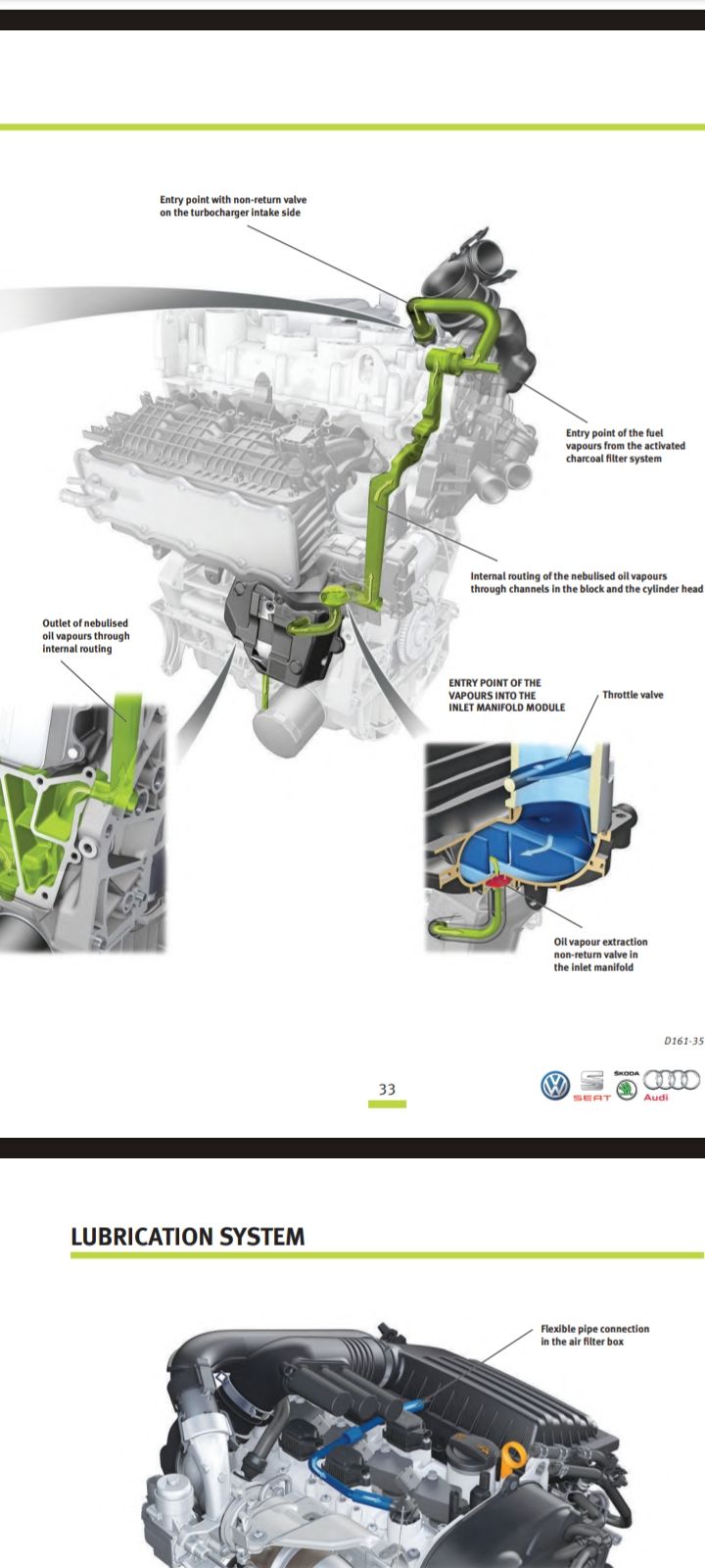

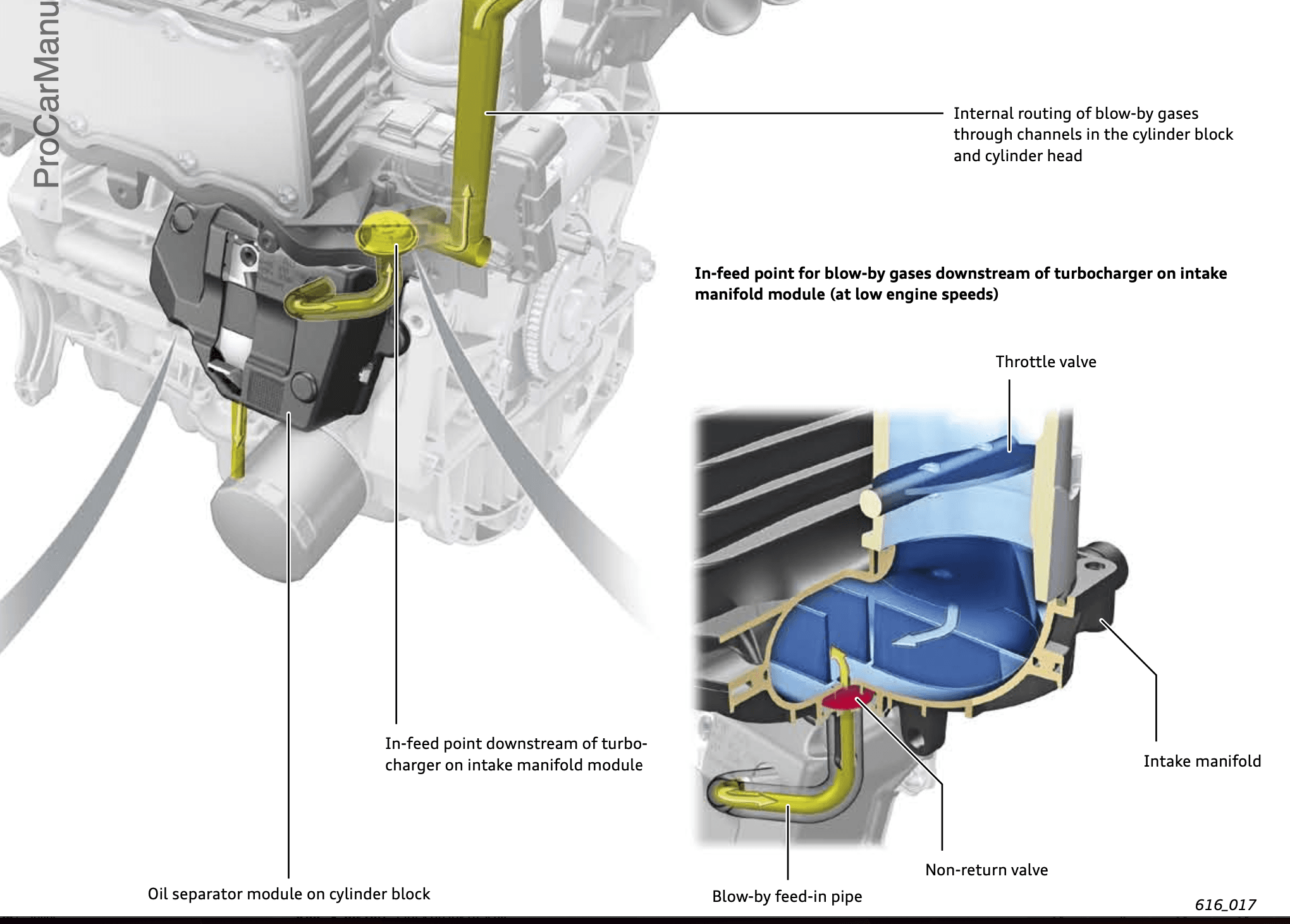

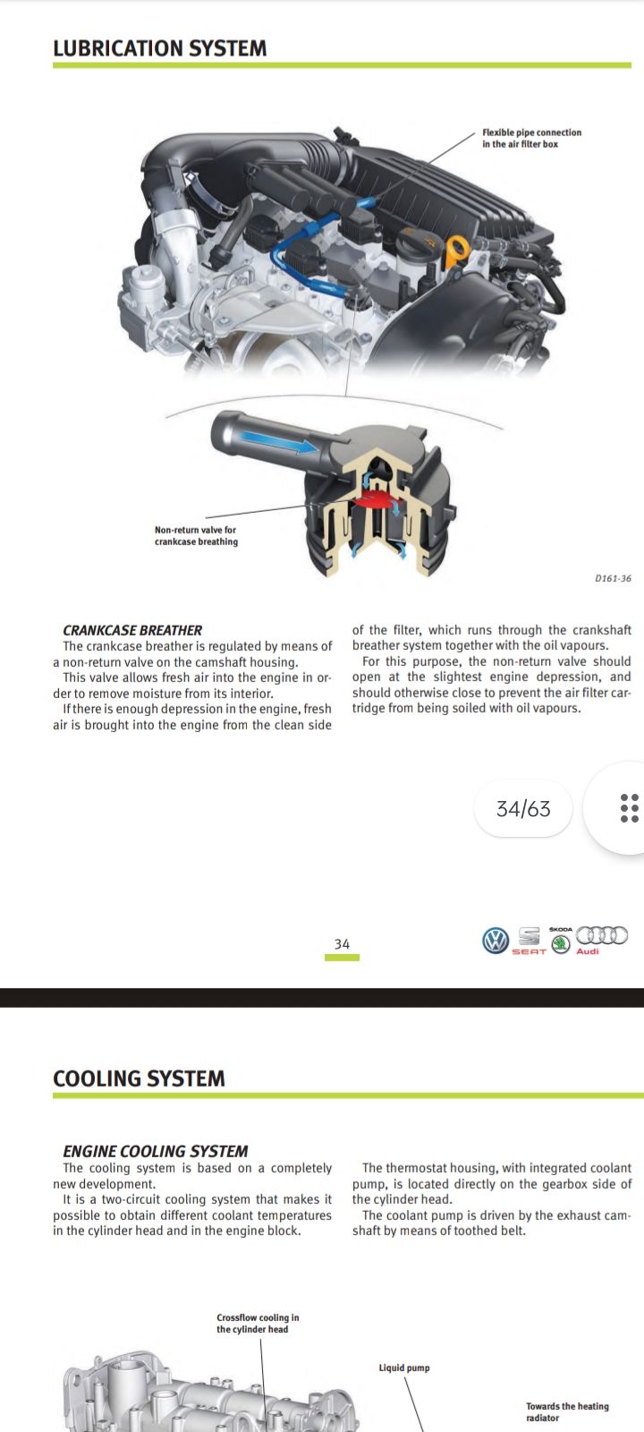

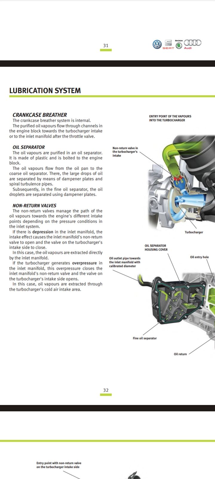

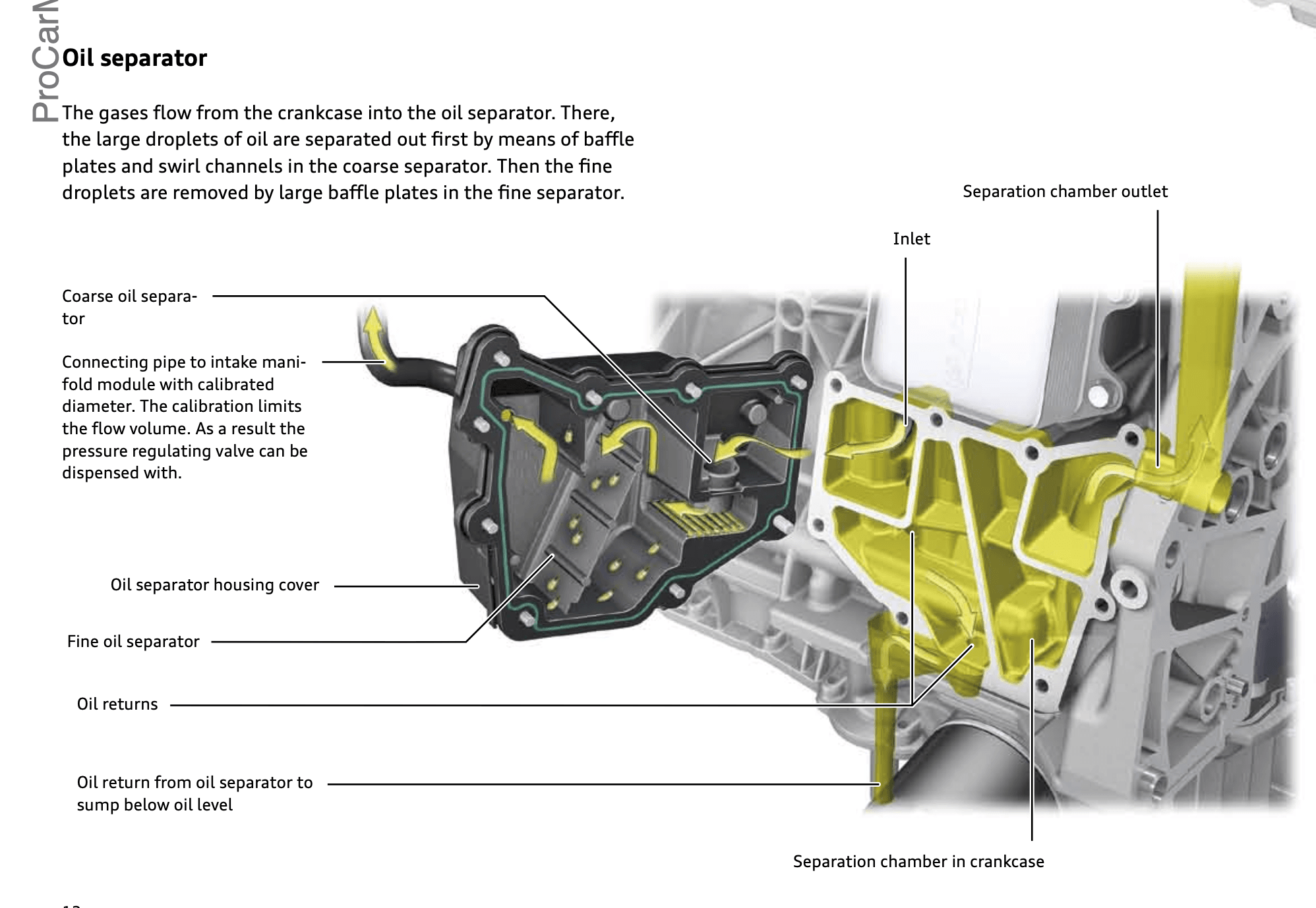

I was just reading that today and saw this thread ... there's already an oil separator attached to the engine itself ...
Reactions: Walone
There is yes but it does not catch dirty crap from vapours just seperates clean oil and returns it to sump, all the crap in vapours goes into the intake manifold when engine is in vacuum or into turbo when in boost pressure,
Reactions: RUM4MO
Yes, of course there is, every modern internal combustion engine except a 2-stroke will have and definitely needs an air/oil separator.

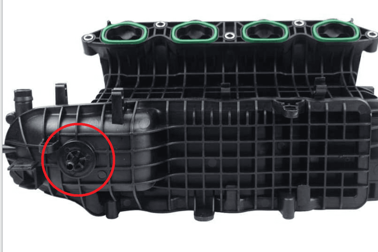

In fact it's the same system, the first one of Lozzys is secondary system activated when the pressure is too high the primary one is when pressure is low and it evacuate oil vapors from pcv directly to the air intake manifold
