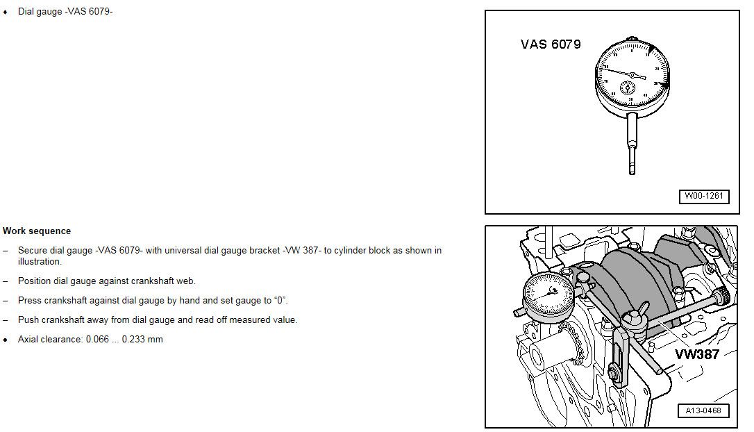

The crankshaft appears to be loose. Its has a lot of play in it. Its floating back & forward. Surely this can't be right?? Would the trust bearings be worn?

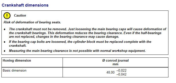

I'm pretty sure the bottom end of the 1.4 16valve engine can not be dismantled? Yes, sounds unlikely doesn't it and the first time I heard of this I thought my leg was being pulled, but, it would seem that if you strip the mains the bottom of the engine goes out of line so when you reassemble it the crank journals lock up because the mains are not in line anymore? Anyone able to confirm this, my knowledge on this one is by no means certain. However I have heard of another engine, during a "pub type" conversation which the speaker claimed suffered from the same curse.

@Crossthreaded, well that would tie in with the lack of part numbers and "see workshop manual" in the parts listing comments.
Yes Rum. you can do big ends, but what good that is when you can't remove the shaft to get it reground I don't know? I believe the bottom end is only available as a complete assembly?

Petrolhead, what code is your engine? The following are from Elsawin for engine code CPTA.

Thanks for that vw.man. Pretty much confirms what I understood to be the case. Just slackening the mains is enough to allow movement which then renders the bottom end unusable! Purely as a matter of interest, as I'm unlikely to ever own one, are the mains caps of the "all in one" cradle type configuration or are they separate? I could perhaps understand the distortion if they are an all in one cradle design.
