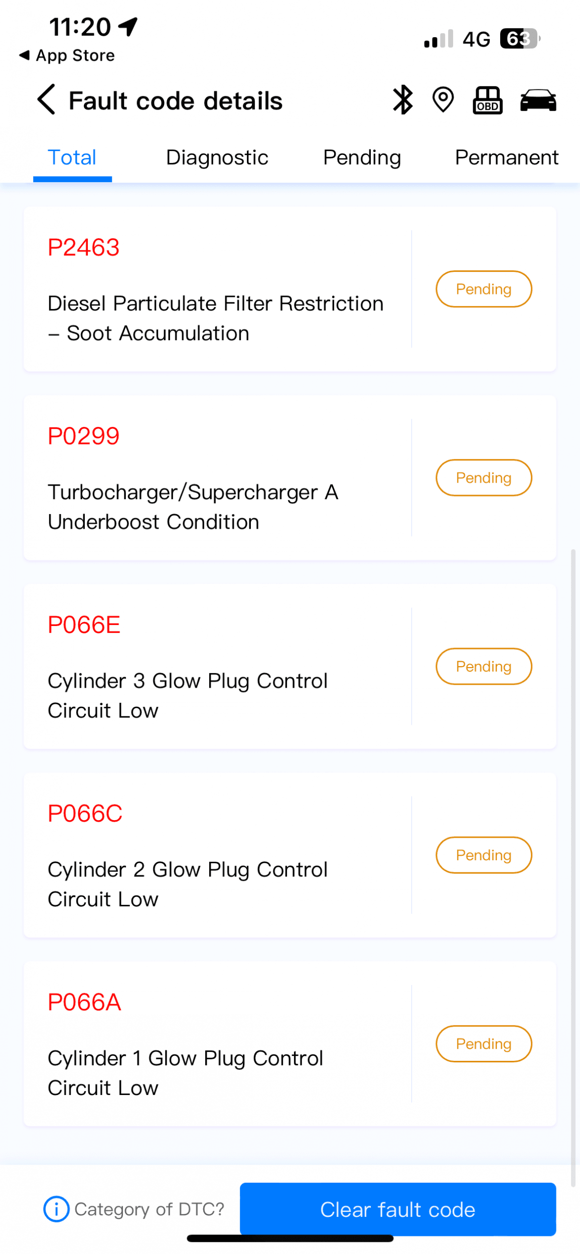

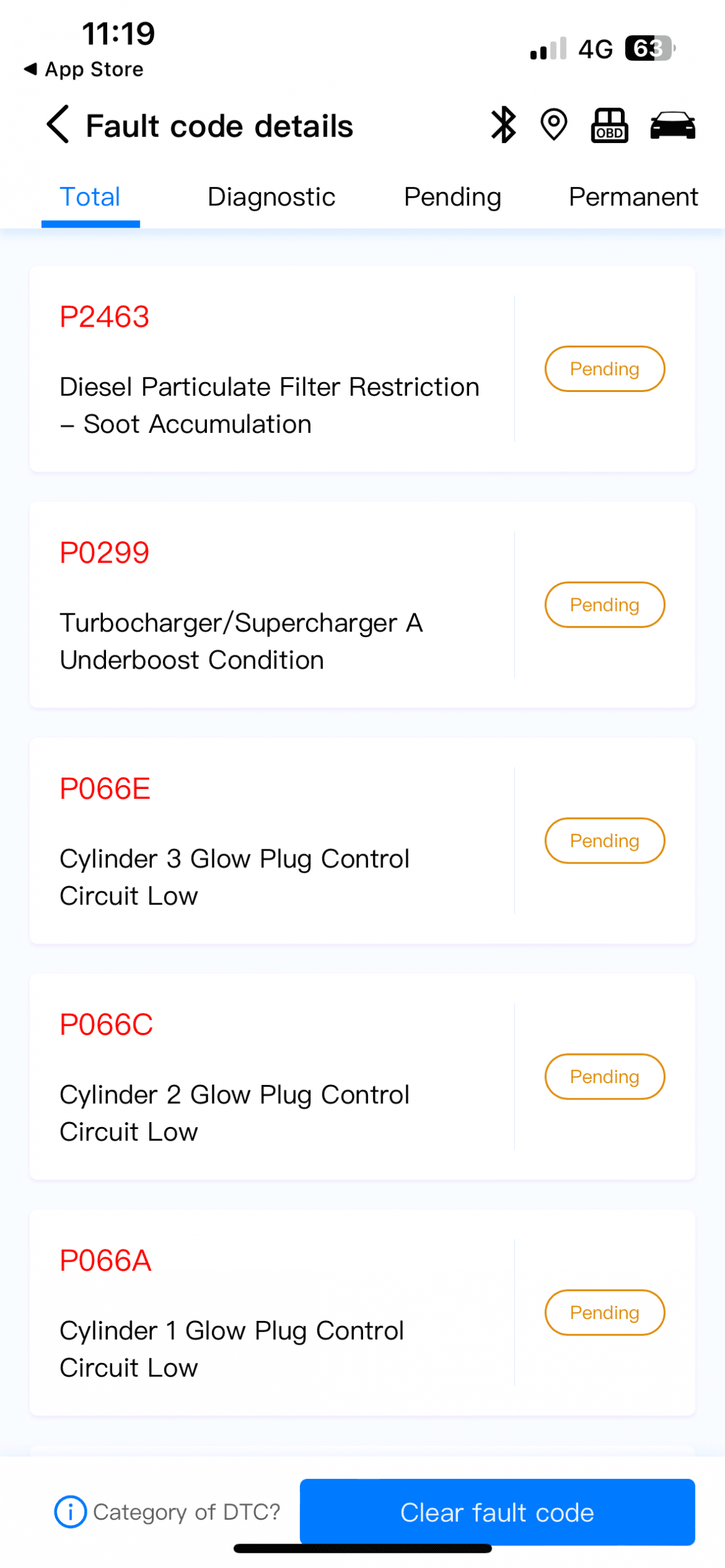

Yeh I have scanned it a few times and the codes that come up are for the glow plugs as the glow plug light is flashing on the dash even though I had them Replaced when I had it serviced in April. And the other fault code is for the turbo nothing comes up for the Oil pressure! Just get a warning on the dash which goes away after a couple of seconds. I tried clearing the fault codes but they don’t clear. I have got the new battery now I’m going to put it in and then see what happens. i think i will have to replace the glow plugs and the oil sensor they could have got damaged by not having the correct voltage going to them. The Turbo issue is another can of worms !! Been quoted £500 to get it fixed but don’t know what that entails if he’s going to repair the same one or put a new one in I’m going to call the mechanic and clarify all that.

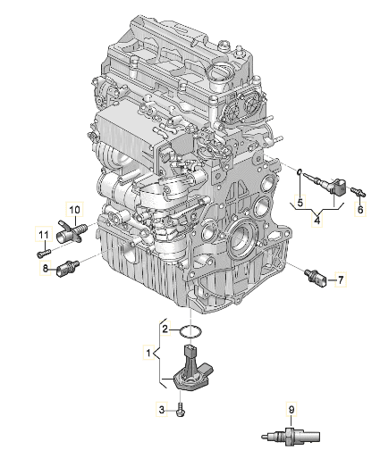

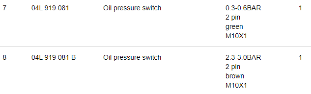

Looks like the TDI has 2x oil pressure switches!
1x green low pressure and 1x brown higher pressure!
They are both on the oil filter housing.

If you have a low pressure oil light problem - I would look at the low pressure switch first - the green one.
