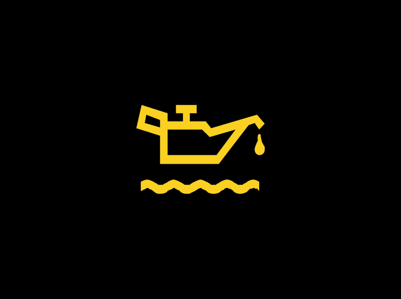

I'm getting the message again after 9500 miles that oil needs servicing.
I just wondered would my dashboard display an oil icon like below if it is indeed low as this has never shown for me since owning the car for 7 years
I wanted to wait until July as thats when my mot is due
That light in the image you have attached is the engine management light, an indication that there is a fault present, usually related to something that could potentially affect the emissions.
Does nothing light up on the dashboard for low oil then? All I ever get is the service required message after 9500 miles
If the oil level sensor is present, correct and activated then you should see this light if the level drops beyond a certain point.
Check coding in a couple of modules, also, if the level is below minimum on the dipstick then it'll show on the dash.
How would I know if its activated?
I don't think there's a question of it being activated or deactivated. There's an oil level sensor of course, it's a vital part and its warning light should always be working, if the sensor is not faulty of course. Turn off the ignition, turn it on again and when you see all the warning lights are on for a brief moment, you'll see the oil warning light there too. That's the initial check to see all the sensors and lights are OK.

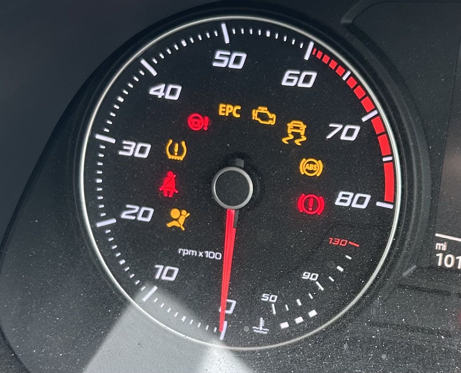

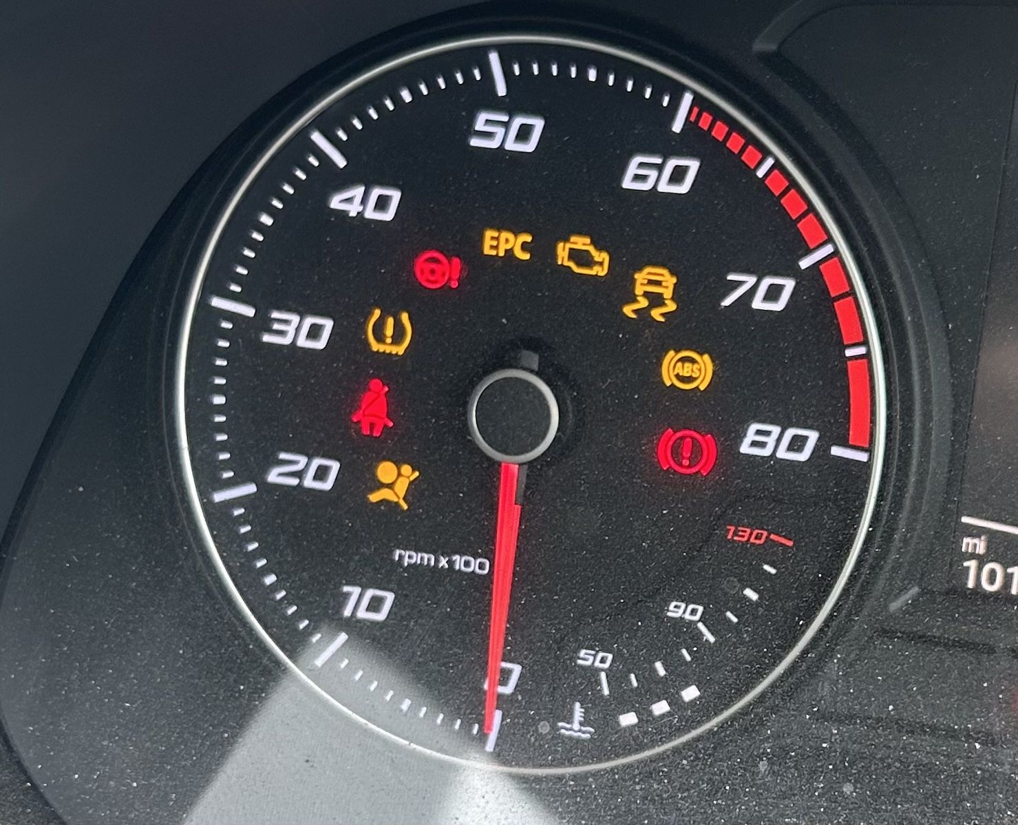

Had a look at my dashboard today but there was no oil light when turning ignition on.
