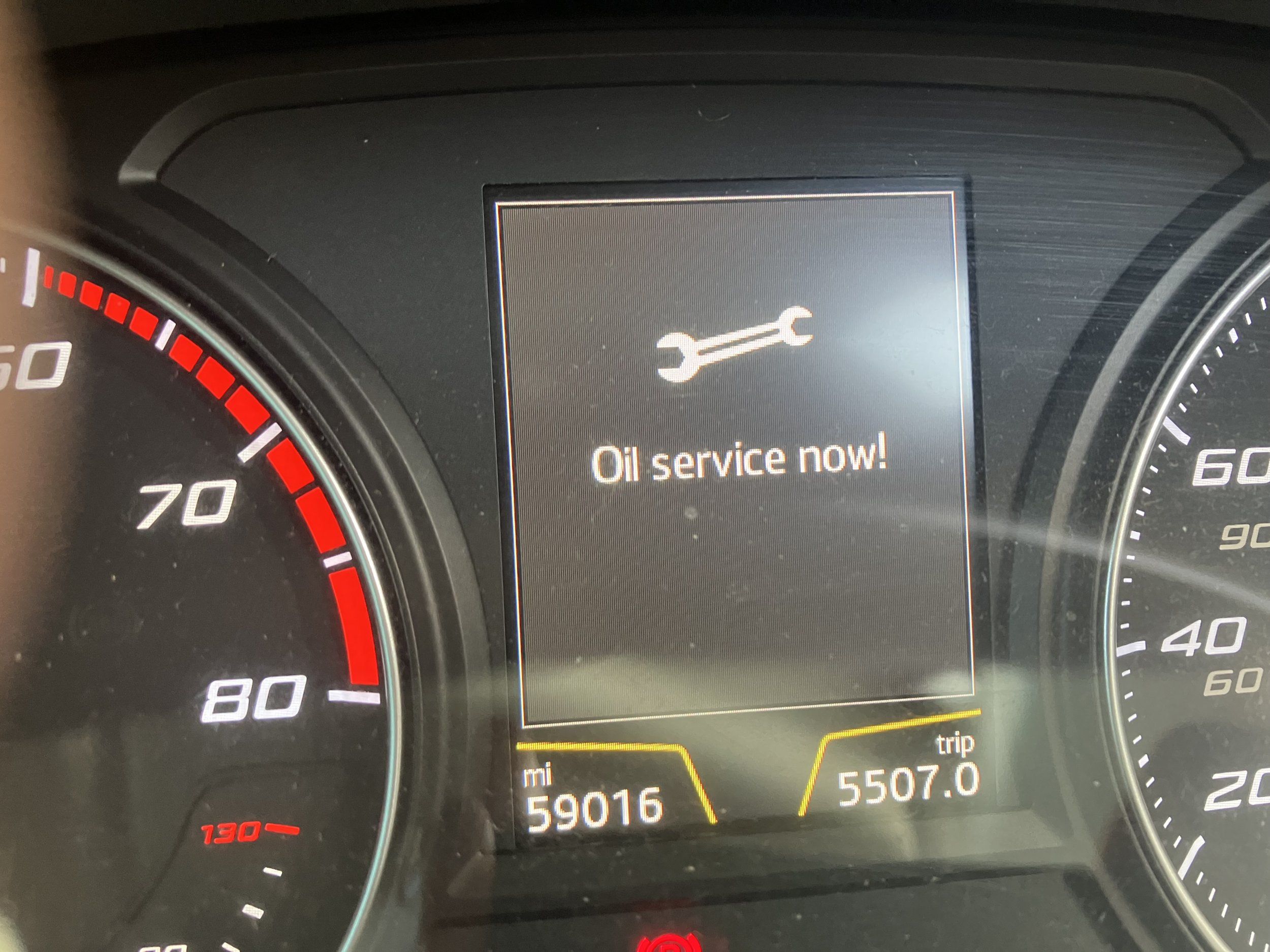

marklcfc Active Member Feb 13, 2023 56 2 Apr 17, 2023 #1 Is there any way to prevent this showing up/beeping at me every time I start and turn off the ignition?
black_sheep Active Member Mar 10, 2013 1,244 588 Apr 17, 2023 #2 Yes. It should be reset when you have the car serviced! It can also be done via software such as VCDS. I trust that you are not trying to rip someone off by falsifying that a service has been completed: It will be similarly to this for Mk7 Golf.
Mr Pig Active Member Jun 17, 2015 2,963 1,136 Apr 19, 2023 #3 If you hold down the mileage reset button while turning on the ignition that'll reset it. Reactions: marklcfc
poppo2K3 Nov 3, 2022 9 2 Apr 19, 2023 #4 Just remember resetting by button makes the service interval change to 15000 km instead of 30000 km for Longlife. Sendt fra min SM-G991B med Tapatalk
