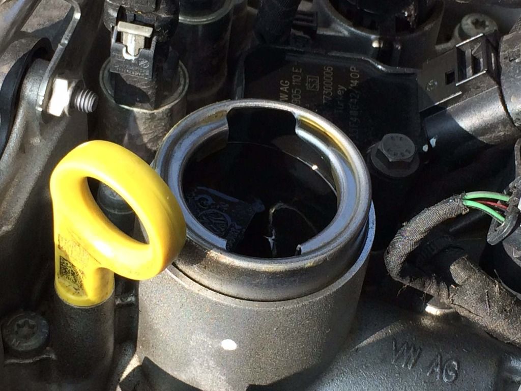

Well - that was embarrassing! Seems there is a metal swirl plate just below the filler cap. There must have been some oil sitting on top of it (presumably because it was cold) so it looks like the oil level is that high. The drive to the dealers got the engine nice and hot, so when the technician opened the filler cap it was all fine!

Checked oil on my Fr 150 ACT, now at 12000 miles. Have topped it up a couple of times before with no issues.
Dipstick showed oil at bottom of marked area, so needs a few mls. Opened filler cap, poured (slowly) and the oil disappeared over the engine. Looked closer and oil level maybe 1cm below the top.
Checked oil with dipstick. Still low.
Added oil v.e.r.y slowly. Waited a bit. Checked dipstick. No change. Ran engine for a minute. No change.
Waited 30 minutes. Small increase in level by dipstick and oil dropped a little in the filler.
Now out of oil so have to buy some more and try again.
Do I have an engine problem?

Thanks for the replies - it's all very odd. I seem to have confused people a bit too, so to summarise:
1. In 12000 miles I've only needed to top up the oil a couple of times totalling less than a litre
2. This time, the dipstick level was at 'minimum' so would expect to need 500ml or so
3. My bottle had about 250ml left, so opened filler cap and started to pour slowly..
4. Overflow almost immediately
5. Had a look and oil level is about 1cm from top of filler cap.
6. Waited a bit - level had dropped slightly so added a drop more oil. Waited again, no change. With the overflow, probably only 150 ml of oil added.
7. Ran engine for 5 mins. No change
8. Posted here and phoned dealer but had to wait for a call back. 30 minutes later, checked oil again - dipstick level had gone up a little and level in rocker cover had gone down a little. Put in rest of the oil and had to drive to an appointment - about 20 minutes each way.
9. Checked oil again when engine cooled down. Oil in rocker cover had gone down a bit - say 2cm below the top of the filler cap. Added another 200ml of oil very slowly. Dipstick level now in middle of marked area. Decided to leave well alone.
I called the Dealer back and they said sounded like a possible air lock since the car hadn't been used for a few days. Booked in for a service anyway and they will have a better look then. Otherwise advised to keep an eye on oil levels....
All seemed very odd.

A picture saves a thousand words.....
Just back from a 40 minute steady drive. No warning lights, oil temp dead steady at 90C.
BUT... when I checked the oil level I noticed that there was oil the full length of the dipstick...
Not good, surely!
Thanks for all the thoughts so far. Any further ideas? Should I stop driving and get it to the Dealer?

Just emailed the Dealer with the photo to see what they think... Oil the full length of the dipstick is normal apparently...
