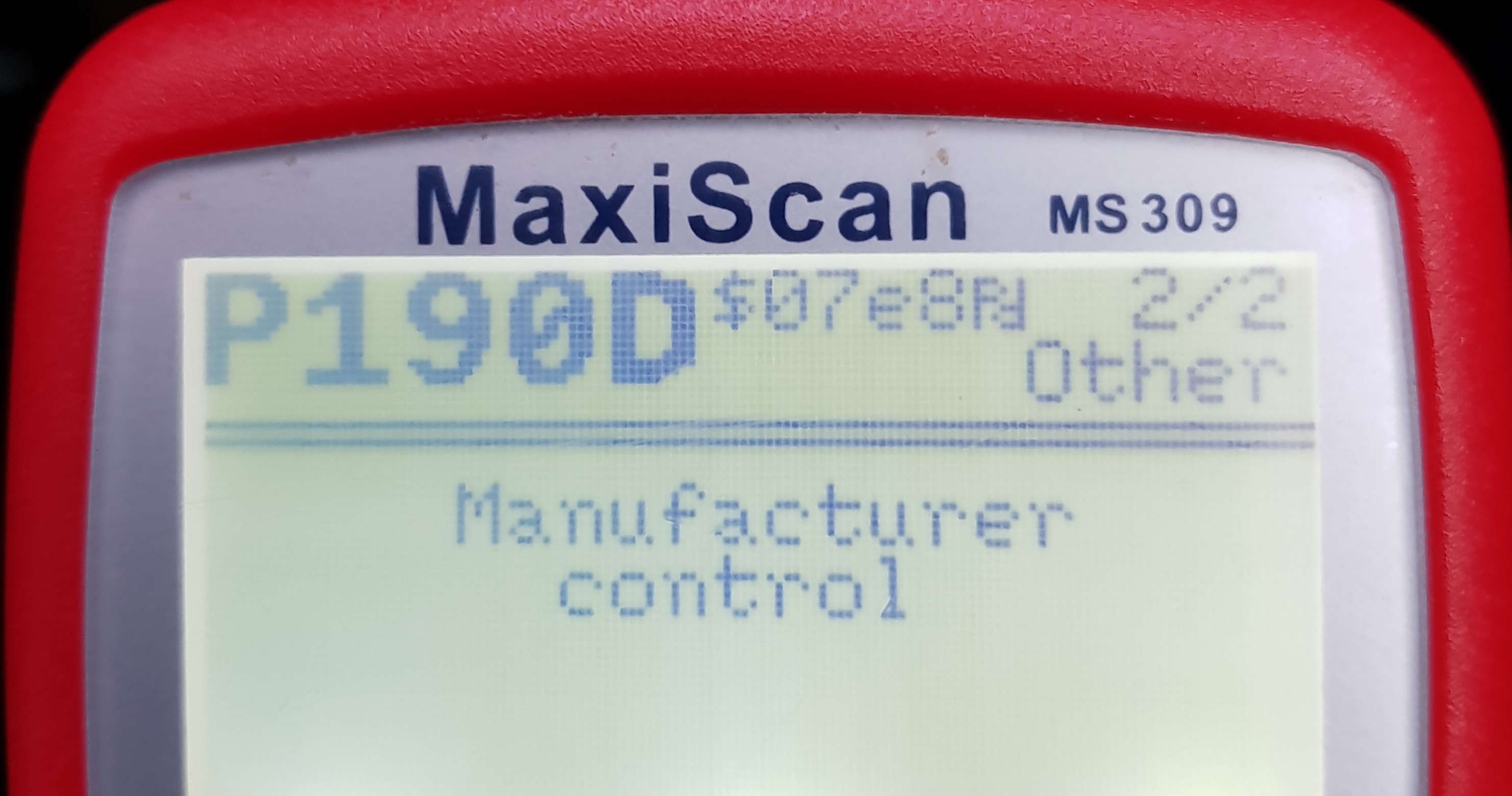

- I have had a 3 EMLs appear since I've had the car. I bought myself a cheap OBD-II to keep a track of what they were. One was an unrelated sensor which I have had replaced and has since not returned. The second was "Coolant Pump Control Circuit High" - I had the coolant temperature sensor replaced and that particular one has not returned. However before and almost immediately since the sensor was replaced I have had an intermittent error code of P190D (with no explanation given other than "Manufacturer Control") appear. After the service I had the mechanic run a diagnostic with VCDS and he was helpful in explaining the various codes and clearing the history of them, but during the drive to work the next day this P190D error light appeared again and will randomly turn on and off. A little bit of internet digging suggests it could be a mechanical issue with the coolant pump itself, others suggest a powertrain issue.
