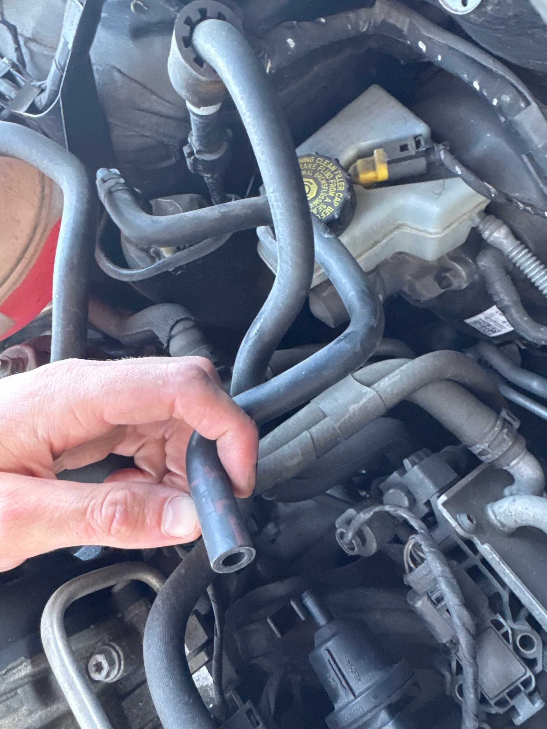

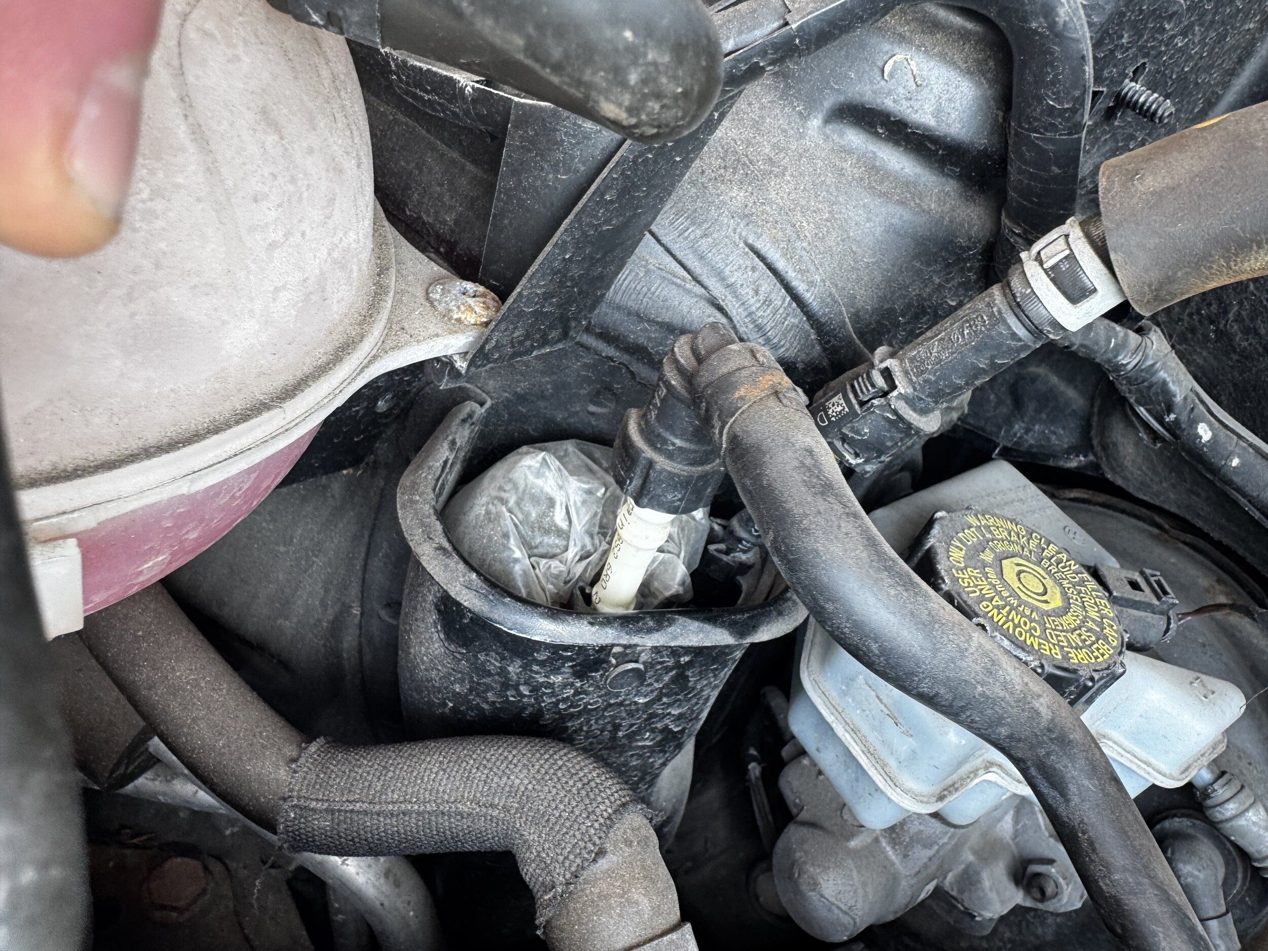

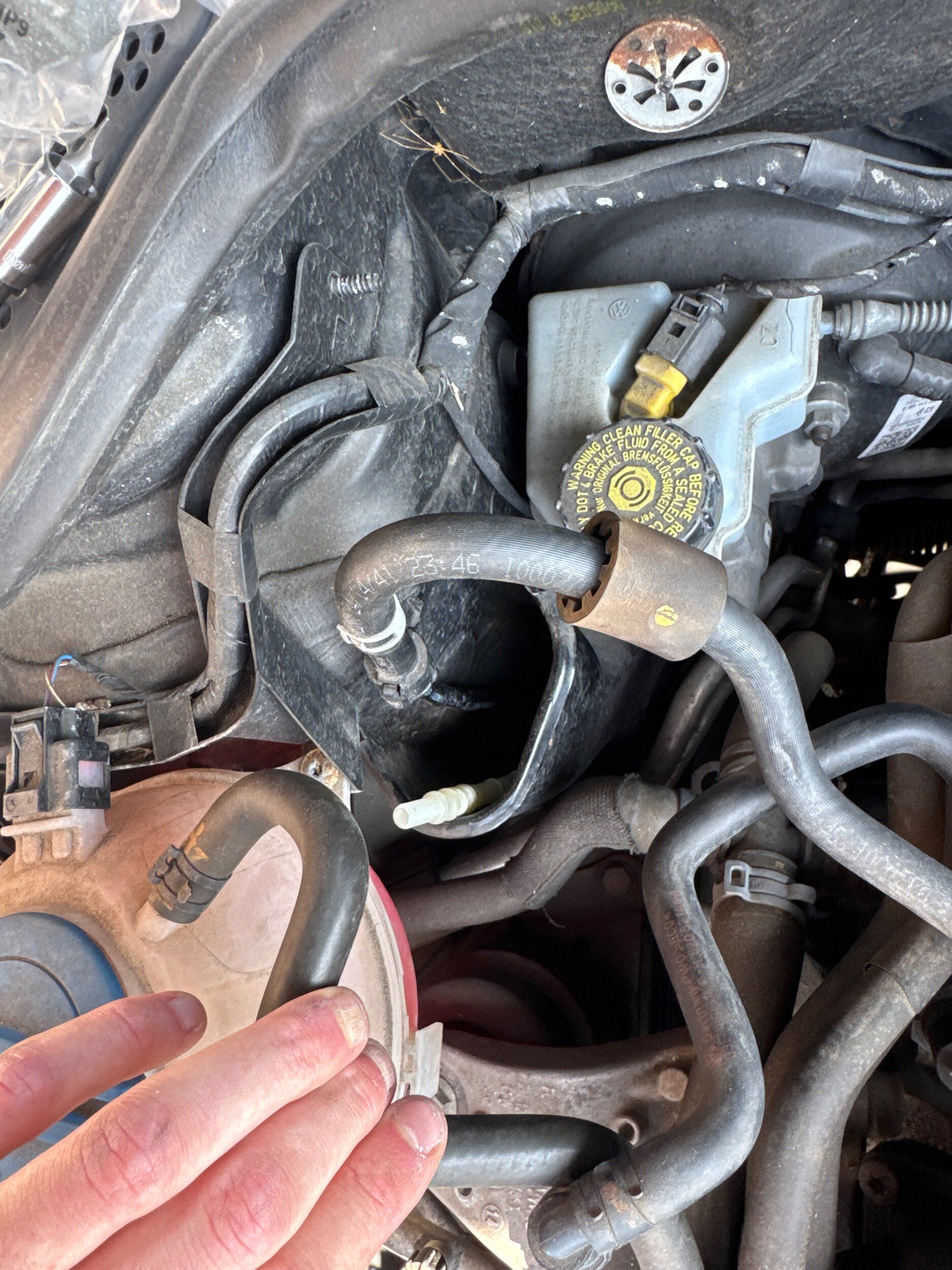

It’s a 2014 Ibiza I tech 1.2 TSI. Changed the purge valve which doesn’t pass when no power is sent to it, the engine side hose sucks a hard vacuum. I have bought a charcoal canister but can’t find any information on where it is / how easy the fix is.
I initially thought it was in the engine bay coming off the purge valve but the lines just lead underneath the car.
Any information is greatly appreciated.
I have never, yet, needed to look into this, but I think that the charcoal canister is way back at the tank filler area - which is probably why it can suffer from getting filled with liquid petrol when the car is repeatedly filled to beyond the first or second "click" stop.
