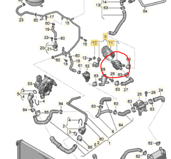

Don't know about your petrol - but my diesel 184 has 3x coolant pumps!
1x electro mechanical and 2x smaller electric pumps for the various coolant circuits.

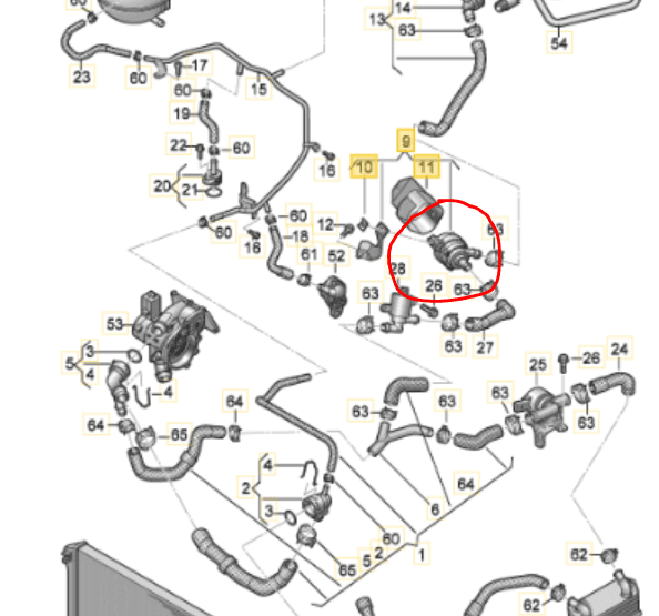

So you do have an additional electric coolant pump 5Q0 121 599 AA
Will I have this additional coolant pump even if I have dual climate control?
Yes. That drawing and part number are from a 1.8 petrol Leon.
Presuming the only pump you have had changed is the main coolant pump?
This electric pump is additional to your main pump.
They often run after the engine is switched off to prevent heat soak - which is what your seeing as your temp increase when you turn your engine off.
Looking at your fault code - P194B00 - this can have other causes and NOT just the coolant pump!
Could be either:
Coolant pump
Coolant temperature sensor
Coolant temperature sensor 2
Engine control unit
For each - if you have a multi meter you can check the pins to ensure there is an expected value?
