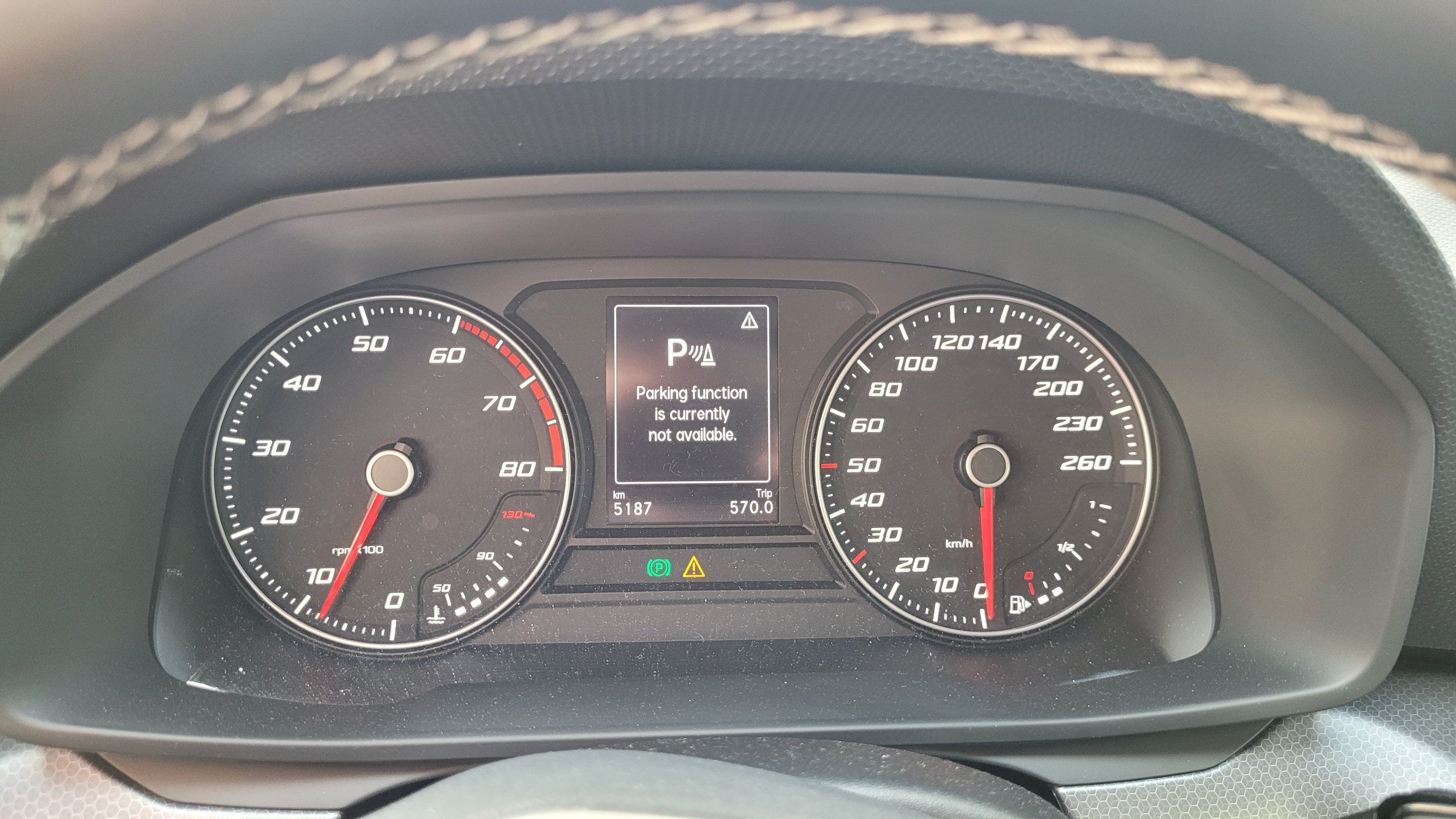

I am posting here because I have a couple of problems with my Leon but one of them is especially irritating. I bought the car brand new in January and it has already been four times to the dealer (mostly for problems with software) but they do not know how to solve it. The car has the smaller display, they say that it is updated to the latest version.
So the problem is that sometimes when I put into reverse the parking sensors and the rear camera are not working. The error displayed is "Park function is currently not available". I believe that the sensors are clean enough at that time and they are not damaged, the weather is also dry (no rain or snow etc.). The catch is that the error can happen several times in one week/day or sometimes the car is fine for more than a month. In some occasions when the error pops up also the error "Manoeuvre braking currently unavailable" is shown. I have the feeling that the dealer will not be able to solve this so I really hope that one of you could help me with advice on what is wrong and what can be done.

Does the message only appear on start up?
Yes for me. I get the manoeuvre Braking Currently Unavailable, then parking distance control error when I stick it in reverse, on most startups. Then when I turn car off and on again, the warnings go

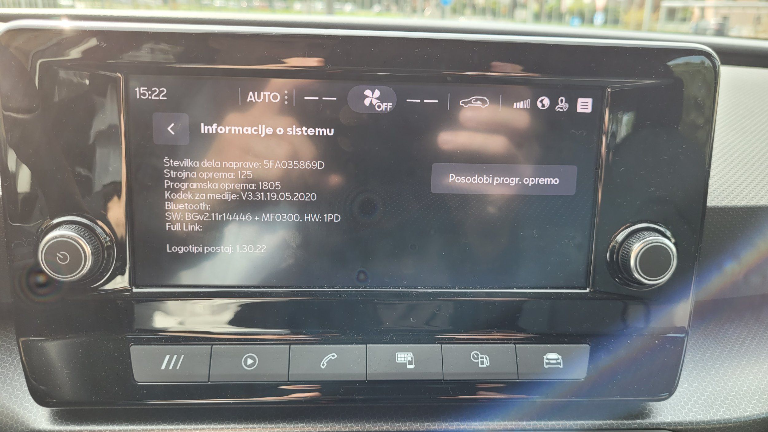

Do you have any diagnostic scans from your car with the software IDs on?

It would seem the parking assist update doesn't show against your VIN but it might still be relevant. Without the part number or software version it's hard to say for sure though.
Which software version id do you need me to confirm, something i can find out or would I need the obd readout?

I’m getting the same errors on startup . Manoeuvre braking is currently unavailable . 2023 seat Leon FR. When this happens the reverse breaking sensors don’t work . Cleaned the sensors and no difference, and if anything is slightly more repetitive . It can be ok for short periods ie hours then error again. The error appears each time the car brakes to a halt , usually in traffic and also on startup if the problem is there . The car is now out of warranty so I’m looking for ways to go with this . The software hasn’t been updated since I got the car even though it’s always been serviced at seat since new.
