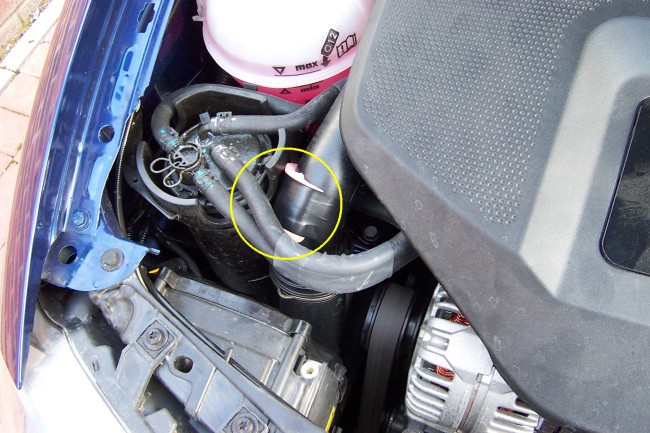

Found my "Growl" noise to be the intercooler pipe vibrating against the fuel filter. Thanks to Al and Niall for pointing me in the right direction.
Sweet as a nut now. :thumbup:

Same as I had when I first got the car then:

Yep that's it, it only started doing it a month or so ago after 2 years of ownership so I couldn't understand what it was and I was fearing the worst. It is alot quiter now especially on the motorway, I've just got to get rid of an annoying rattle from the glove box area now.
