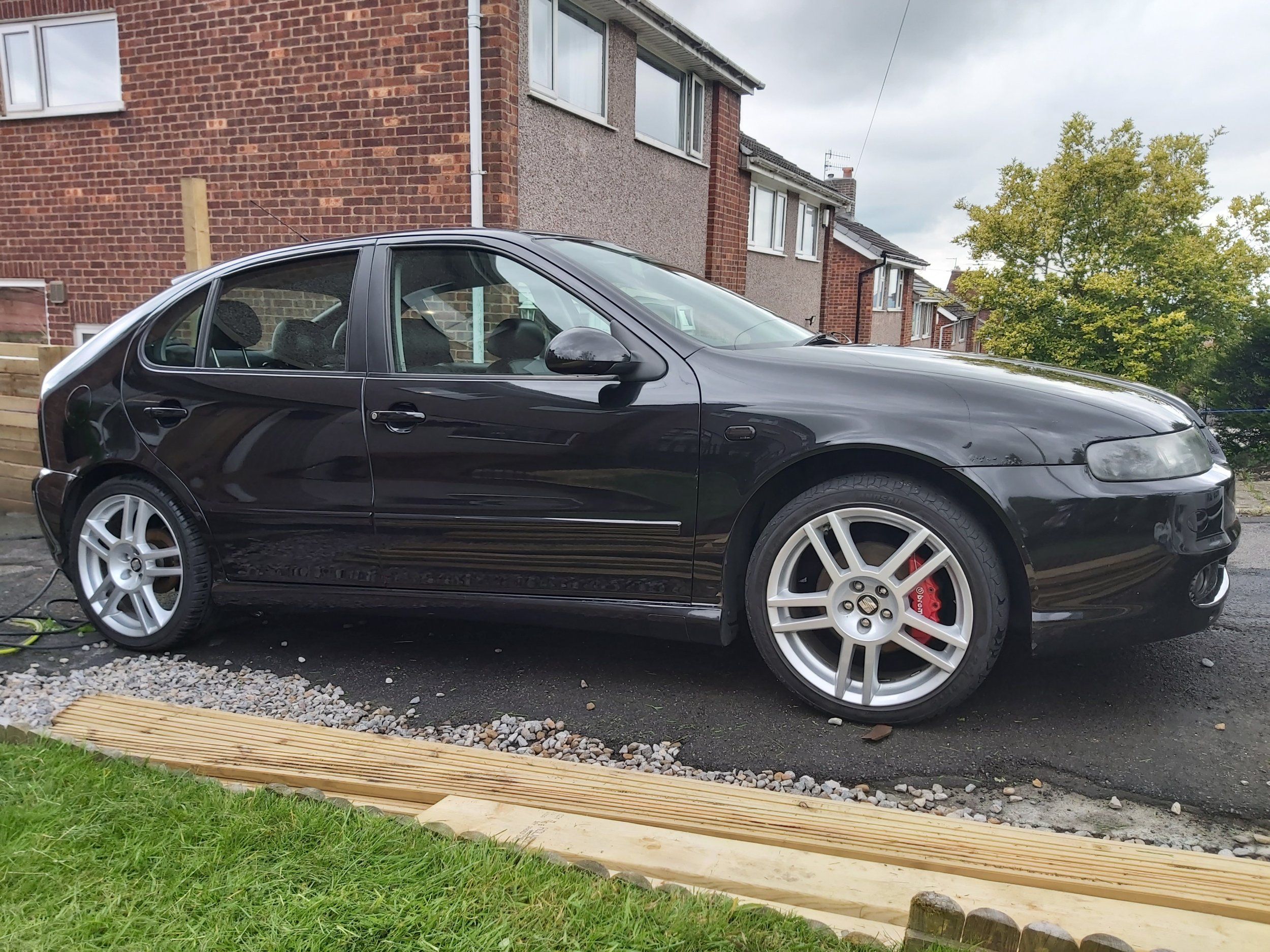

ive have just bought my dads 2004 cupra tdi off him, struggling to find details and pictures of a perfect ride height and what springs to use, current situation he has 2 new standard springs fitted at the front, and its now higher at the front then at the back, looks awful, and i can fit my hand vertical in the gap. any suggestion, its sat on 18" LCR alloys too
cheers reg,

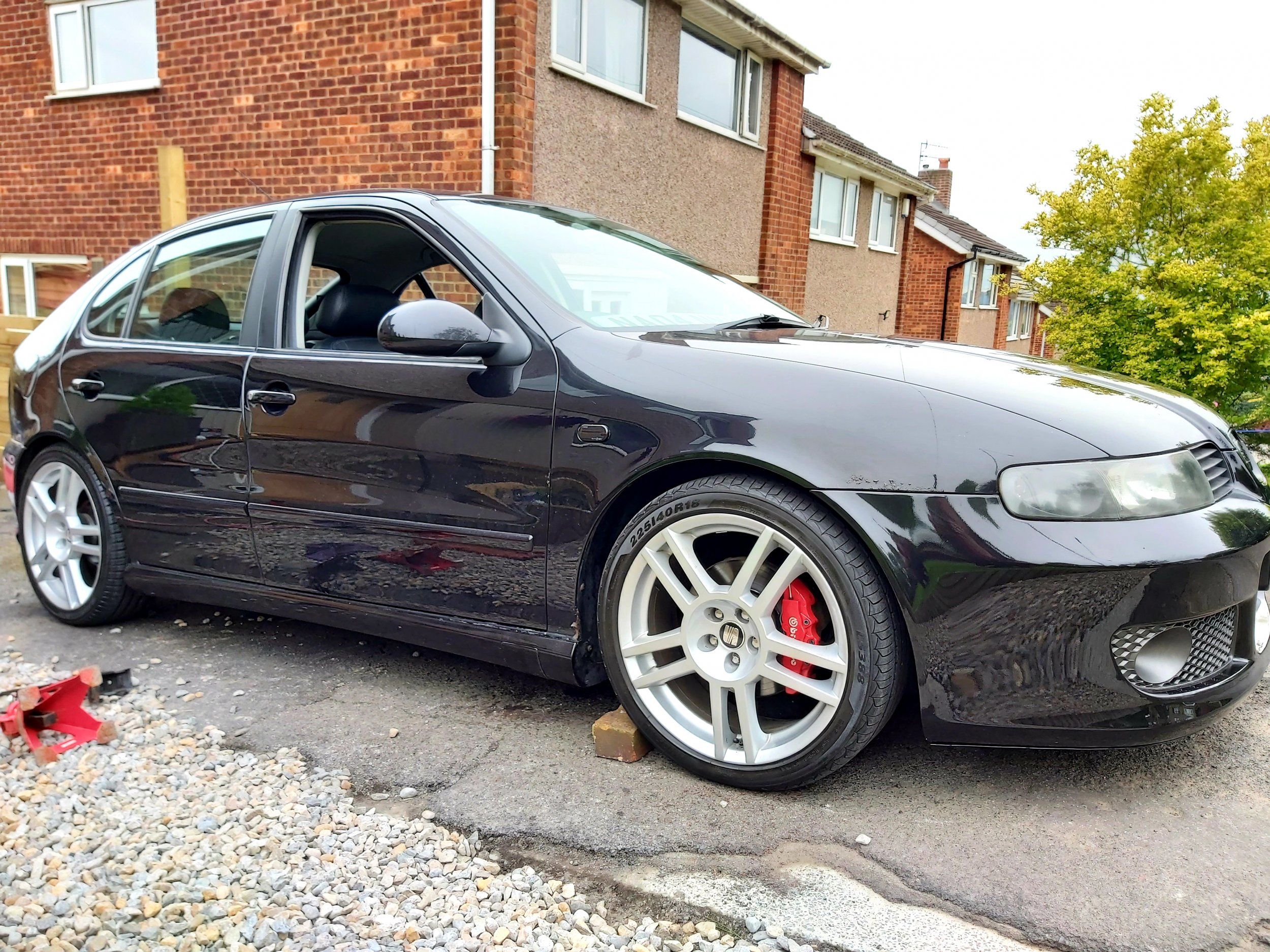

Thats mine on cupra R H&R springs
Sent from my SM-G973F using Tapatalk
29527-2 I have fitted but going to change to 29526-2
I spoke to h&r and they confirmed they will lower a cupra R between 20-25mm and a standard leon upto 50mm. I bought them 2nd hand but practically brand new but they seem to be too low for my standard struts (12 month old bilstein b4) so I'm going to order the 35mm front springs instead and possibly the powerflex -10mm top mounts so hopefully will sit slightly higher but will hopefully stop my struts bottoming out over potholes
