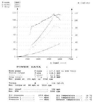

Advisory figures quoted 10bhp and up to 10% more torque. Got it RR before and after and it seems that the torque graph has changed hugely! I have posted a before and after RR graph. The torque line is the top line that you can see.
Before
After
As you can see the torque has changed from peaking at 4000 to peaking at 5000 and then dying. Surely it is better holding peak torque for longer like it was before then after the remap.
Also chip installer told me to put in BP advanced/Optimax and this was in the car on the day of the run. I have 7 days to get a refund if I want one and am seriously considering it. Any ideas/suggestions?

your before graph is better - get a refund
think of it as 'area under the graph' - the more there is under the torque, the better - the more level the torque, the better

Yes, you've lost your fairly flat torque (curve) between about 4 - 6000rpm. In this respect, I would probably say it's less driveable now! The torque is down pretty much all round. Peak power/torque might have improved, but not a lot else.
Pressure and air temp are just about the same, so you have similar conditions for the two runs. Definitely worth a refund I'd say. As a matter of interest did you get a good deal for two rolling road runs?
