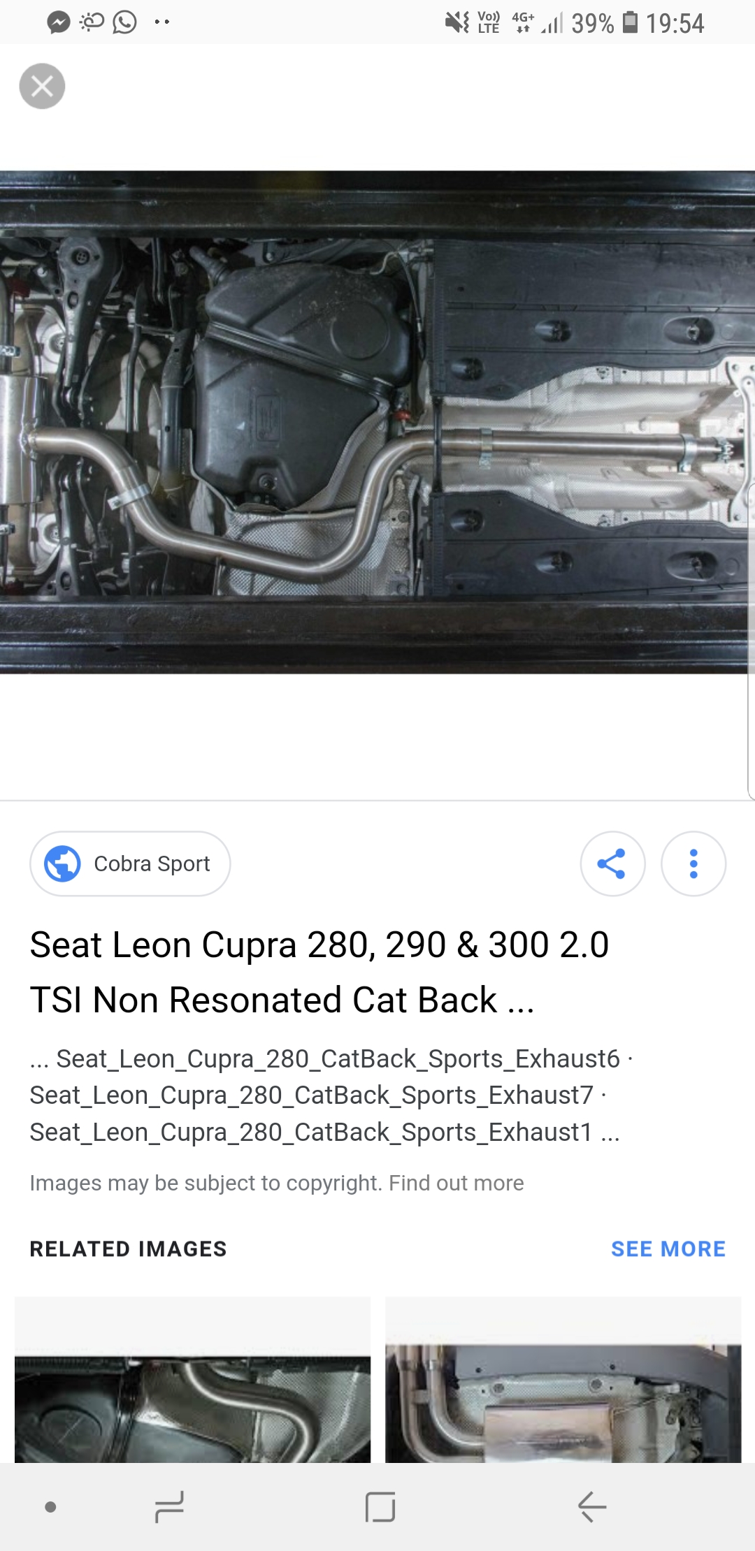

Yeh so on the car, itll go turbo then the dpf which is on the downpipe.. but if you go down the delete route do it all correctly and dont half ass the job which i did... i kept the standard pipe which got the dpf cut out amd closed back up lol... ill post a picture to show you where i sufgest you get rhe exhaust from
Pye_FR170
May 15, 2018
38
So the far right hand side of thebphoto theres 2 clamps and the wee bit of pipe its like a connecter between the downpipe amd center section.. id go from there back since itll b easier to get the downpipe changed
