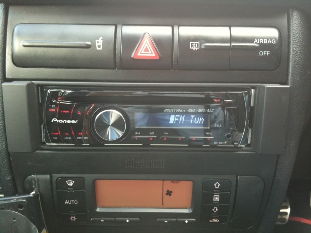

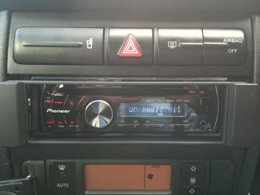

Was a simple plug and play effort (thank god) but I'm having troubles with the fascia (fills the gaps at either side)
The fascia won't fit over the headunit and if I take the headunits plastic trim off (surrounding the removable panel) then put the fascia on, it leaves a gap where the plastic trim should be.
I got the fascia off Ebay not Halfrauds for obvious reasons.
Has anyone had this problem?

Without plastic trim
With plastic trim

Remove the cage and feed the cage through the fascia first, then push the cage into the hole, with the fascia attached and it will sit correctly.
Caught me out the fist time i swapped head units.

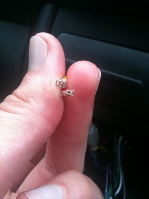

I'm afraid the yellow wire is thicker and the bullet at the end is larger than the red one. So when I put the red into the yellow it's too small for the connection and vice versa. Pic below
Any ideas? I really appreciate your help.

Noooooooooooooooooooooooooooooooooooooooo
Put them back as they were.
You separate the bullet connectors further down the loom.
