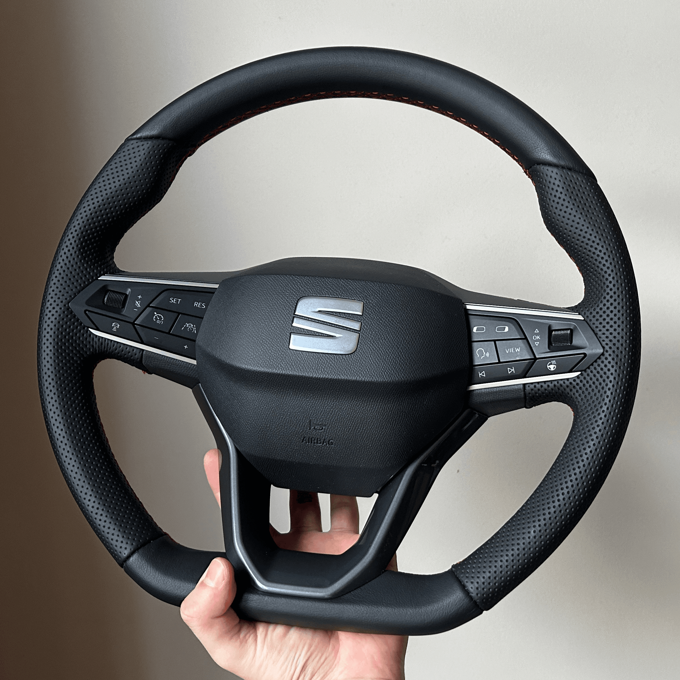

There are Cupra steering wheels without DSG paddles but are rather rare (e.g. 5FF419091A but most of the times have white stitches and silver trim from Seat, not Cupra). You could do similar thing that I did in my car - FR steering wheel (with custom leather and stitches) with Cupra trims.

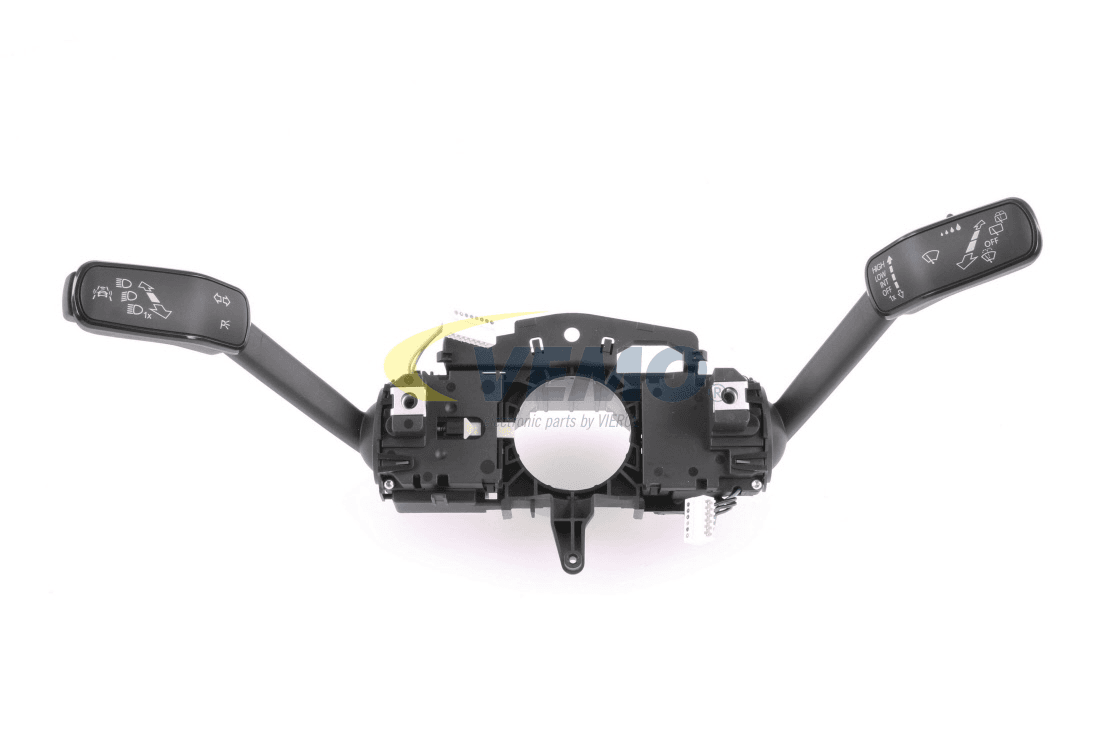

If you have any assistant in your car (Front Assist, Line Assist, Light Assist and so on) you want to order stalks with Assistants button of left stalk with 5Q0953513AJ part number. If you don't have any assistants then you can order stalks with 5Q0953513P part number which does not have Assistants button of left stalk.
FYI this is how 5Q0953513AJ looks
Reactions: cairus
So you've got 5Q0 slip ring and steering wheel with Travel Assist button.
Okay thank you very much for your help, then i will look for 5Q0953513AJ :)

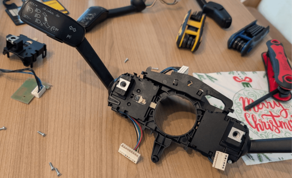

Nachdem ich den Lenkstockschalter komplett zerlegt habe, um den Geschwindigkeitsbegrenzerknopf umzubauen, spekuliere ich nur, da ich es nicht getestet habe. Ich denke aber, dass es funktionieren sollte, wenn man die nicht mehr benötigte Einheit einfach ausbaut. Ob die Lenkstockschaltereinheit dann meldet, dass ein Teilnehmer fehlt, weiß ich allerdings nicht…
