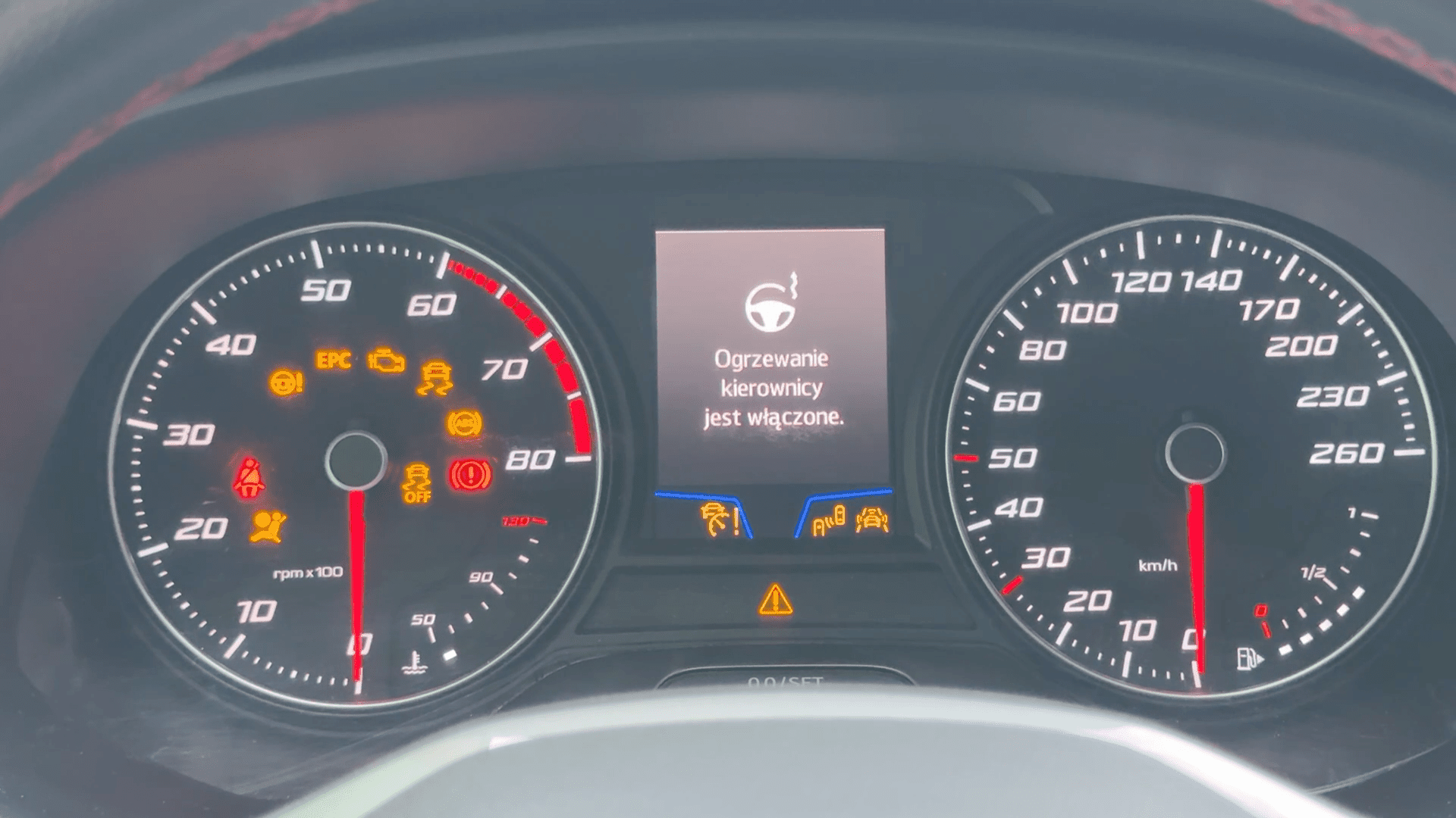

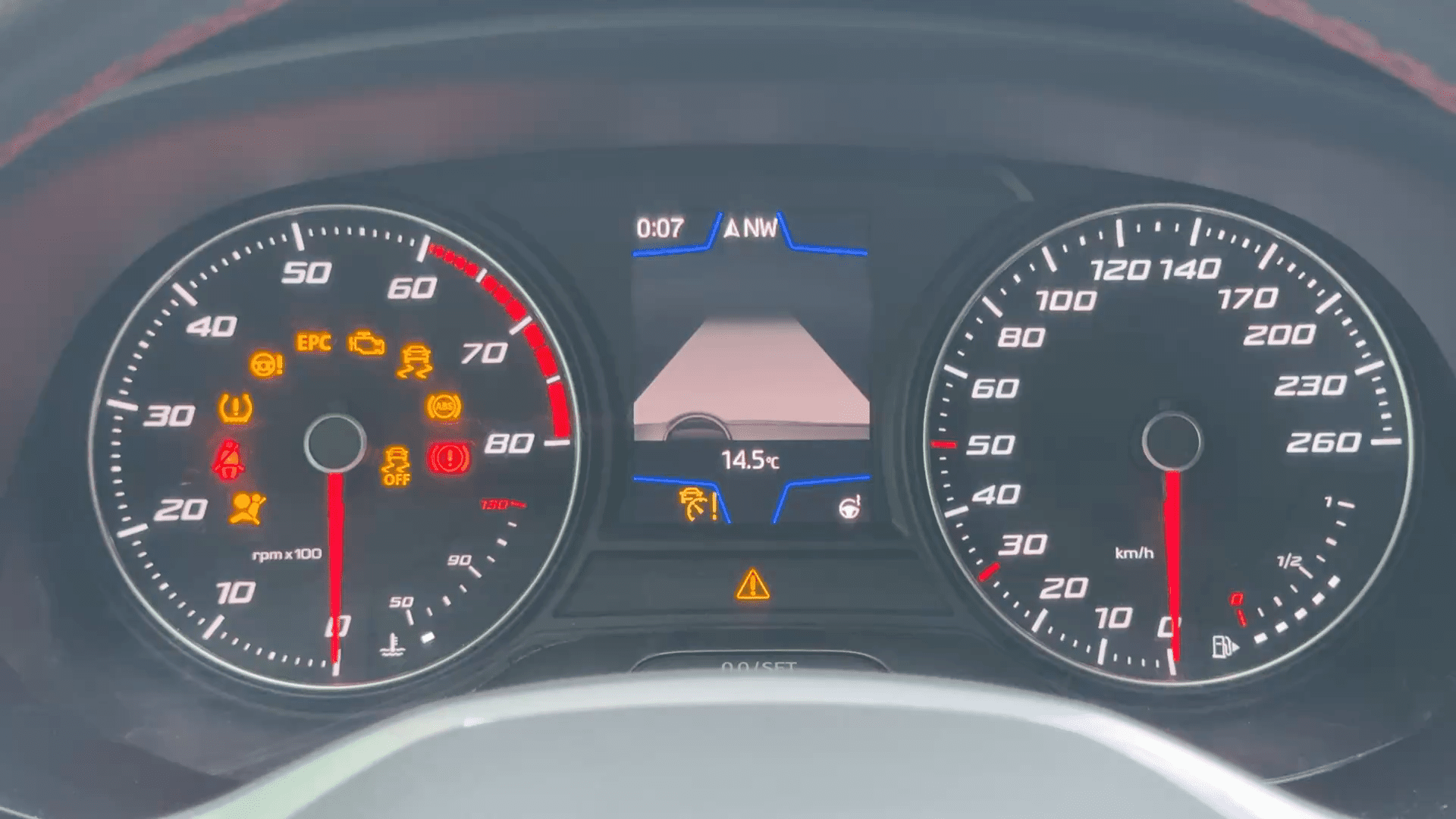

You've got correct clock spring, but your airbag loom is not compatible with MQB/MQBEvo platform. AFAIK there is no separate part number for airbag loom so I see three options:The pins are mixed up like pin 1+2 are airbag pin 7 is horn signal and so on...
Would it be possible to just buy another clockspring? or can you point me to the right airbag part number?
- you will look for airbag loom by searching "leon kl airbag loom" or "formentor airbag loom" and hopefully find one
- you will modify airbag loom that you've got, but it will require rewiring almost every cable
- you will order whole new airbag with correct airbag loom
Correct airbag number starts with:
- 5FA880201 - that's your best choice, well tested by community, but loom might need rewiring if airbag is from VZ5 trim (e.g. 5FA880201AR)
- 5FF880201 - refreshed version of previous number, same story about VZ5 trim
- 6F0880201 - Ibiza/Arona airbag, there are few numbers that will fit, don't know why they have separate part number
