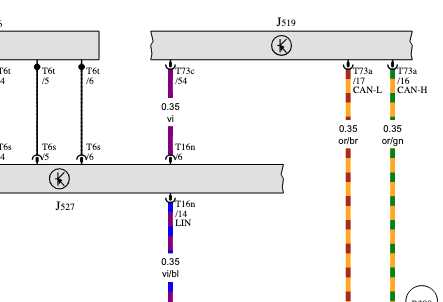

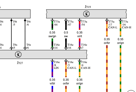

Those who got 5Q1 module, do You have wiring diagrams for Your VIN from ErWin system? as I can not find different schematics for MK3, or somebody provide VIN and I can look in erwin... MK4 already have different gateway itself.
As with every transition between old and new solutions in VAG there are not much details about it. The best you can do is to search "November 2018" in "S01HPA5F120-Basic_equipment__2-door_vehicle__From_November_2016-3.pdf" diagrams
You can also look for "T16n". This code is used only for the 16-pin 5Q1 connector on Leon MK3 diagrams

Yes, there is differences in drawings, but on fast look, it looks like it only CAN is not connected and thats it...

Images are nicely aligned, there are 4 less connectors between GW/BCM/clockspring in 5Q1 compared to 5Q0

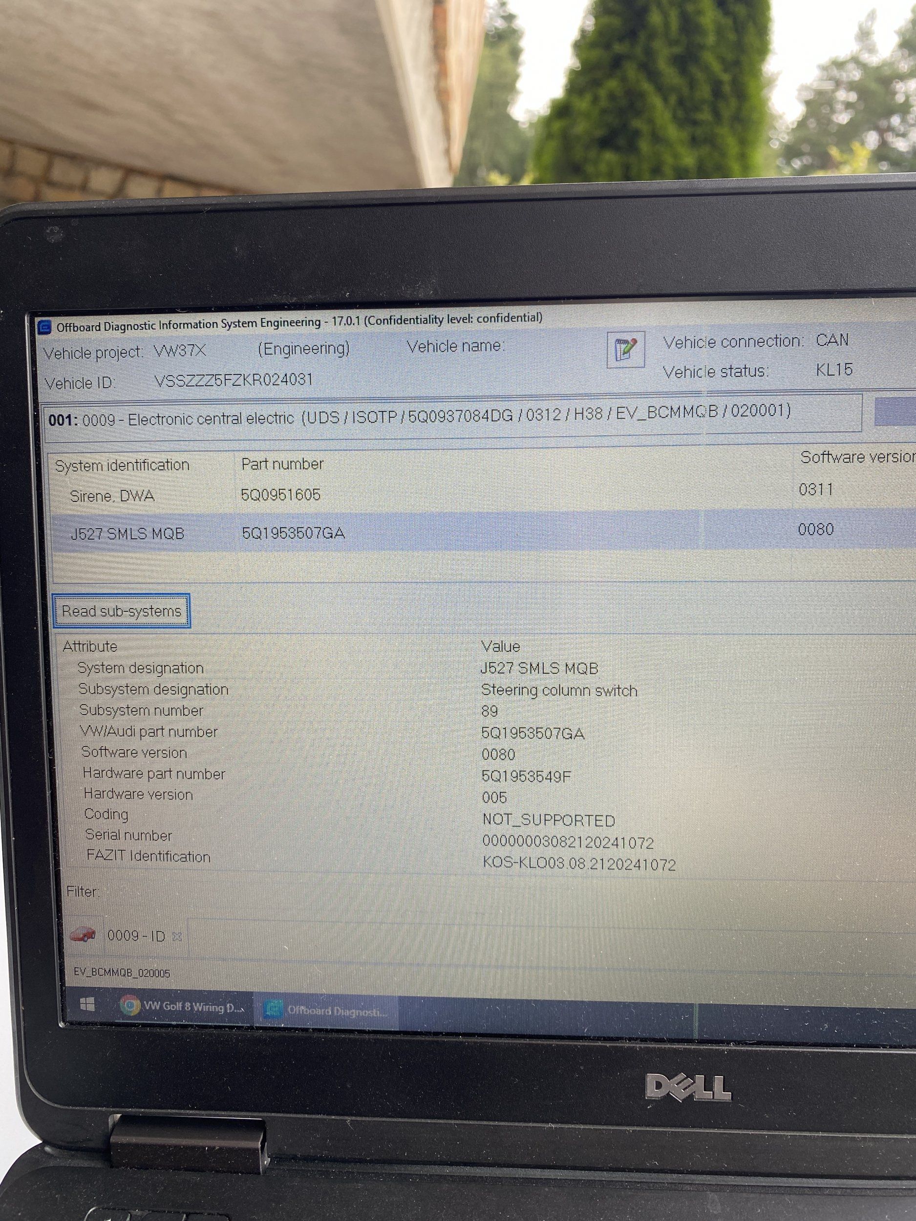

Guys I solved mystery, everything works great!!! Later I will give more information. Probably even was not need to update SW... Was missing LIN line from BCM, repined it as per wiring diagrams (from Golf 8) and wuola, works like from factory! :cool:
Reactions: Walone and cairus
So ok, here it is.
I got 5Q1 module from Golf 8 - 5Q1 953 549 F, with heated steering wheel option.
I repined it using Golf 8 diagrams as I got it from Golf 8, and You never know. Also as I had Skoda Kodiaq 5Q0 module installed before, I will not write from which pin to which I pinned wires as wiring already was not like from factory...
Repined connector now looking like this:
Pin 1 - Red/blue(Positive from fuse box for heated steering wheel)
Pin 4 - Brown (GND)
Pin 5 - Violet (LIN from BCM - T73c/54) [This I was missing, as did not have this wire at all]
Pin 6 - Red/White (Positive from fuse box)
Pin 8 - Brown (GND for heated steering wheel)
Pin 9 - Yellow (SIG- from AirBag module)
Pin 10 - RED (SIG+ from AirBag module)
Pin 11 - Black/white (SIG from engine control unit)
Pin 12 - Violet/Blue (LIN from Gateway)
blue/violet wire (this one was going from J587 - Selector lever to old 5Q0 steering control module) this need to wire to BCM T73a/24.
Leftover Can High, Can Low just take out or isolate.
And from beginning I did not have black/green, black and violet/red so not sure to which diagrams to relay on.
Coding is done trough Adaptations in 09 module under "SMLS" adaptations.
Also in Adaptations > Lenkstockschalter > Verbauort Lenkstockschalter, change from CAN to LIN
And finally it works.
