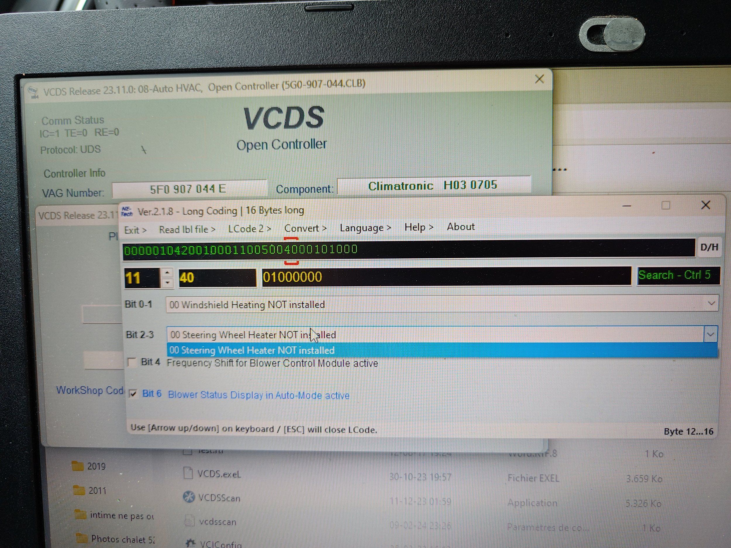

I have one last question... I will add the loom tomorrow, but i wanted to enable in vdcs the heated steering wheel... But even if i see the bit i can't enable it for some reason? Is it because it need the loom installed? Or is it bc my car doesn't support it ? (The new steering wheel was not installed too !)

You should be able to code it in module 08 regardless of heated steering wheel being installed or not.

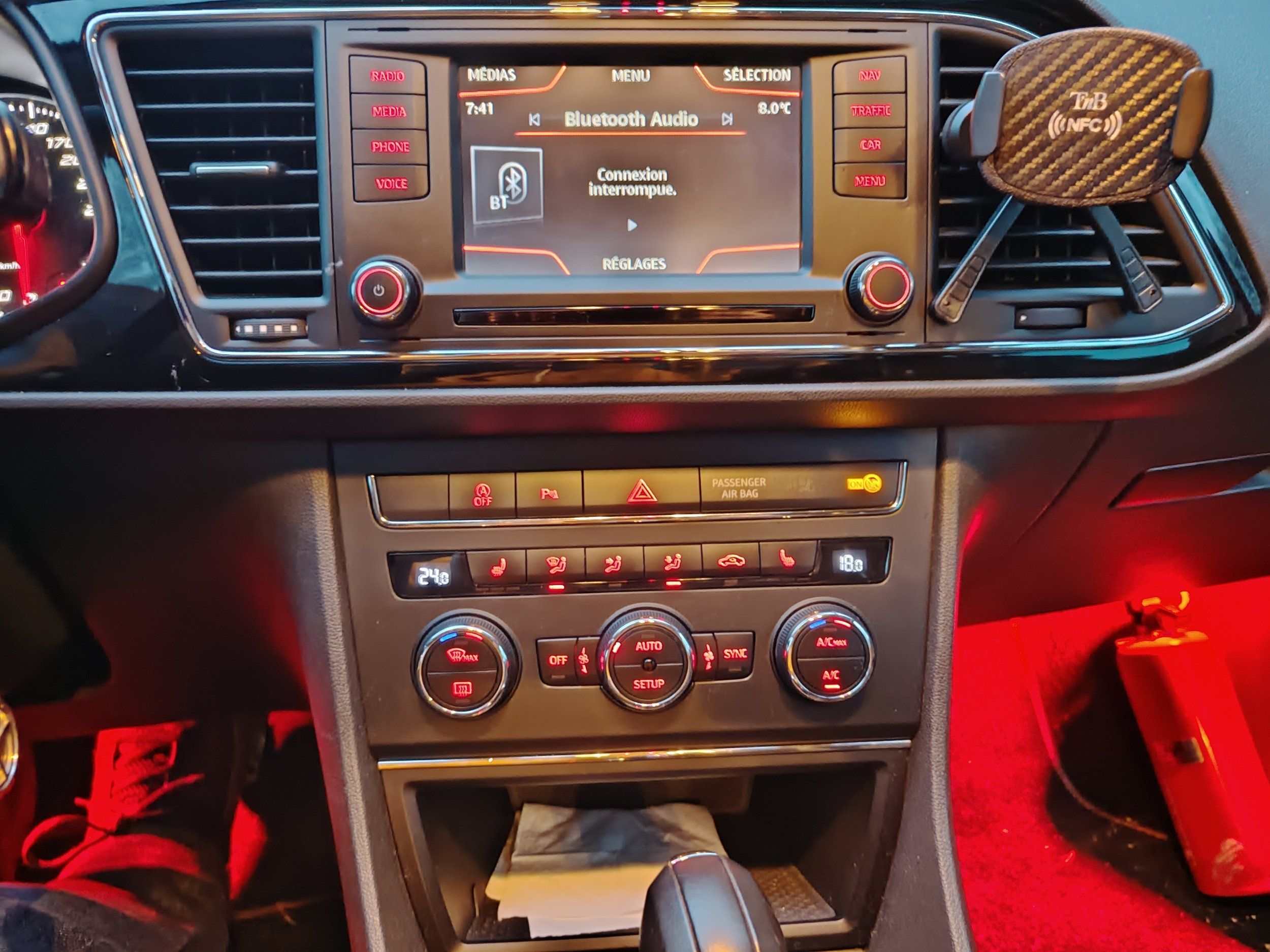

How does your HVAC panel looks like? Is it automatic or manual? I've heard that automatic HVAC is required in order to make this work

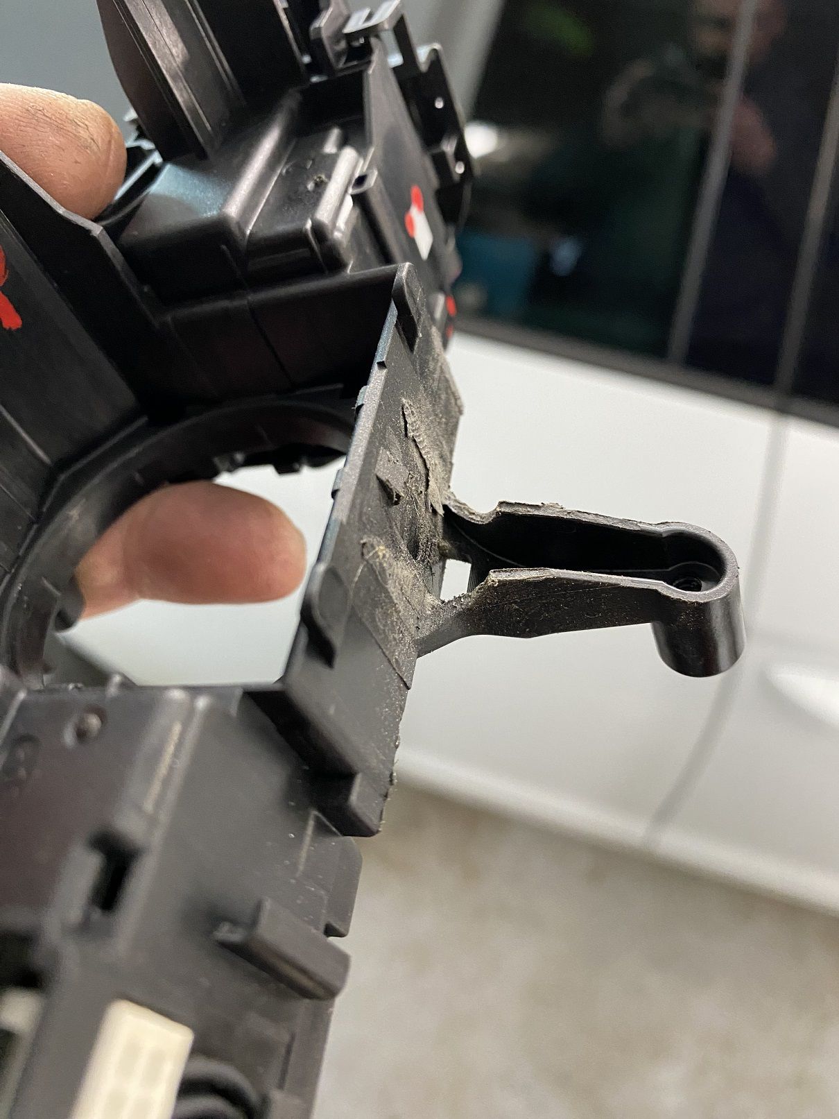

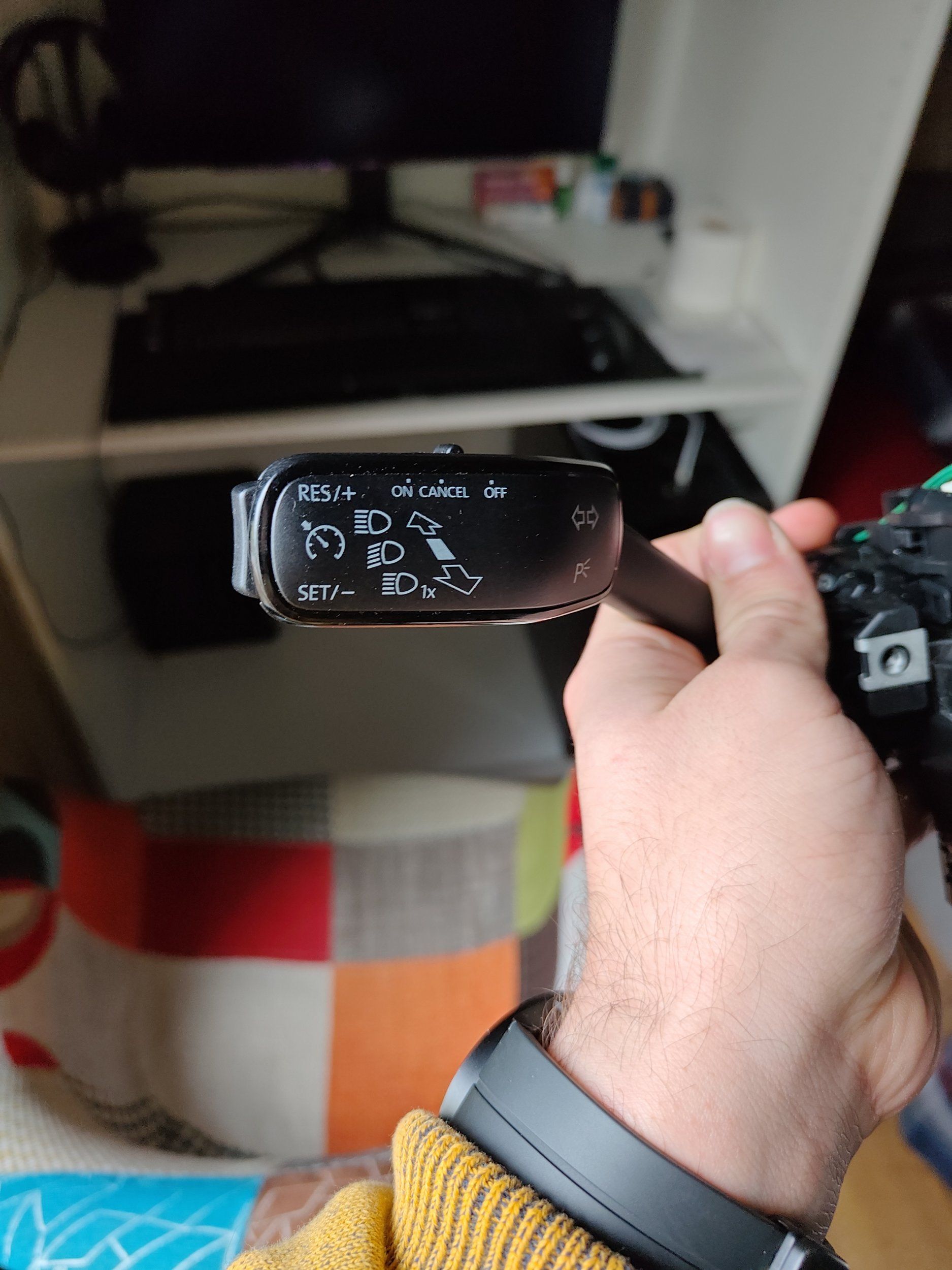

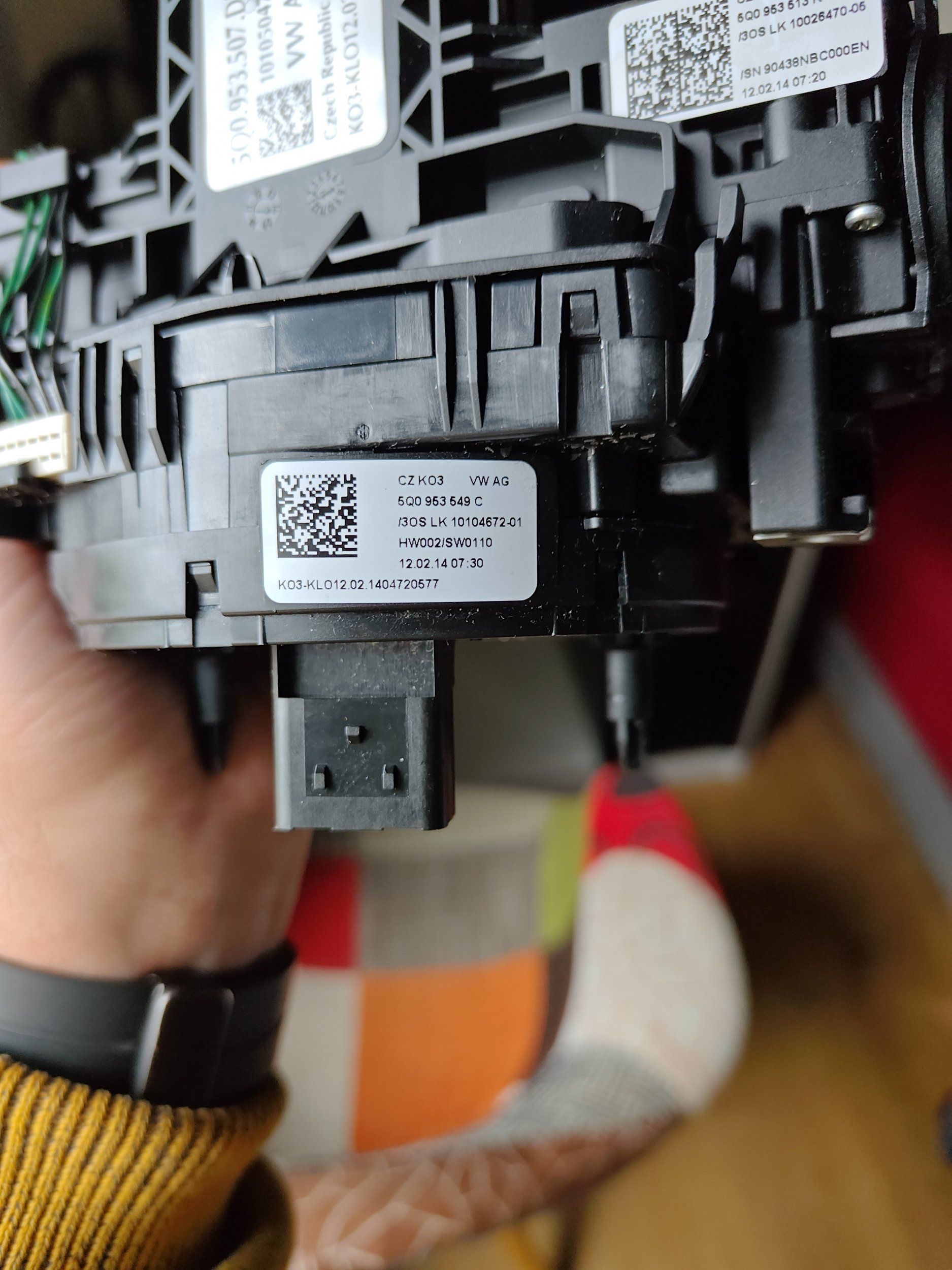

From my case, NEVER buy steering control module from China, e.g. aliexpress.. I Got same error as @grabania. Aliexpress module just stopeed working heated steering wheel. I checked module, wires and etc is ok, something wrong in board itself. Other things was still working.

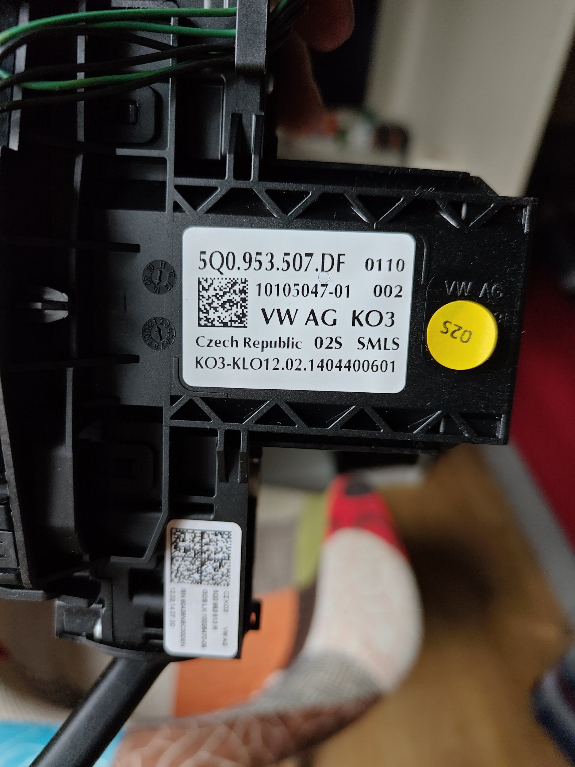

As we have still winter here in Latvia, and I can't get correct module fast enough but got module form Kodiaq (5Q0953569B) laying around, I decided to use it. So Wiring pinout was same as needed, but unfortunately it not fit to the stalks. I was lucky to get very cheap stalks from Tiguan (5Q0953502AJ) that fits these module. I was need to cut one place to fit it on steering column, and wuola, I got heated steering wheel again. :sneaky:

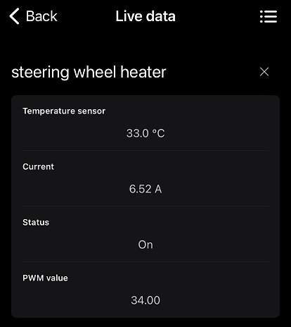

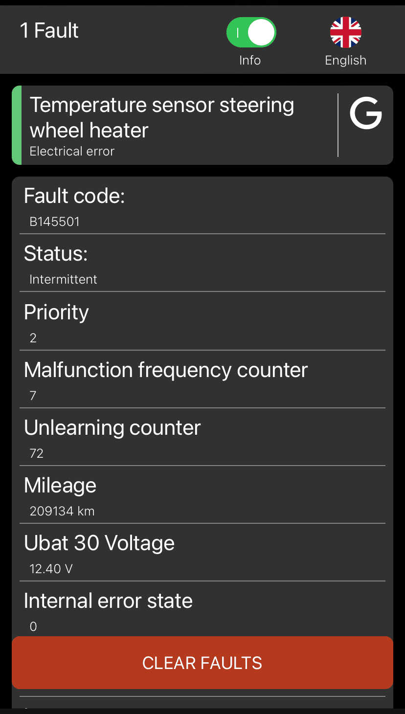

Just one thing is when turn ignition on, it drops fault about heated steering wheel in VC, but immediately disappears. Heating works ok, and all 3 heating levels are working ok (instead aliexpress module have only 1 - max heat). In OBD11 error it is like something about temperature sensor, but in live data it shows correct temperature. So for now I leave like it is, but later when some correct original module will be available for reasonable value I will get one for sure.
