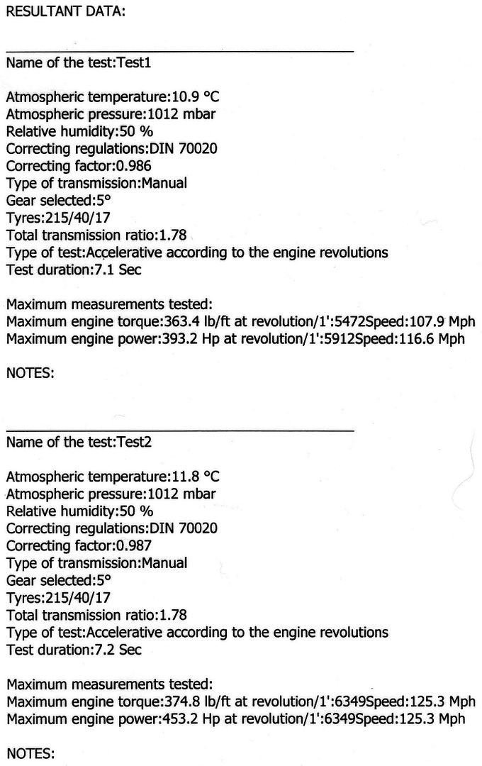

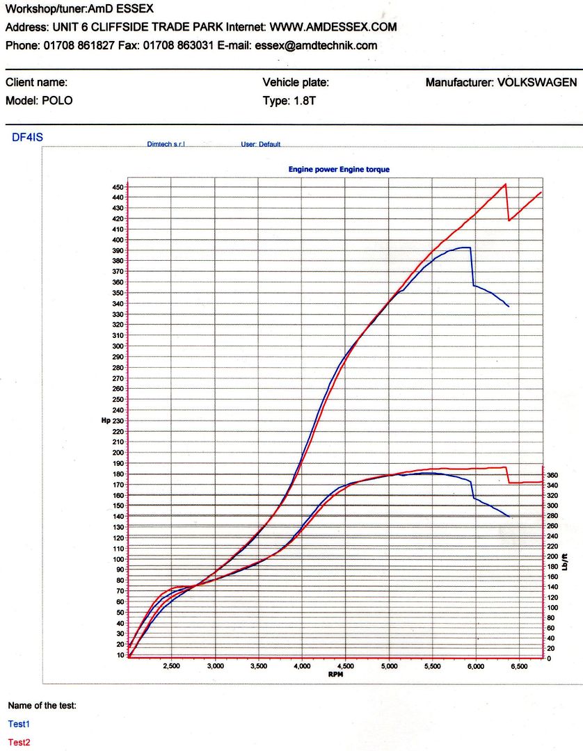

Dyno results
Hi guys, just got back from holiday yesterday night, thanks for your help and comments every1.
Took my car to AMD Technik today to get my KW V3's fitted and decided to take it on the rollers for a power run....:D
Here are the results:
It made 453bhp @ 6349rpm & 374lb/ft @ 6349rpm!! :happy:
The Torque and BHP keeps rising!
I love the torque its just keeps building!
I setup the AVCR with my new 1bar spring and it was running 1.5bar with no boost spike.
They took it to 6k first then 6.4k but didnt go past it as they didnt know my rev limit... wonder what it would be at 7.5k:whistle:
We was going to do one more run once I got there to 7.5k but I decided not to run it again.
All in all a great but tiring day.. AMD are great ppl and the V3's are great!
I have never felt that much pull in 2nd gear ever in my car, Its transformed the car totally.
Thanks a bunch guys:)
Holy crap .... in a polo!!!!! :drool: That's insane, are you happy with that by any chance and have you been out M3 bashing yet? :happy:
:D Just waiting for the right weather... have alot of leicester ppl trying to arrange a drag race with me down our 'mad mile' we have here, got an R8 waiting for me, should be interesting!
very good results mate and i'm especially excited as my turbo is based on a gt3076r:)
3076 is alot more top end power will be crazy with your 4wl drive!
On that run I didnt have my 1.9bar spike or hold 1.7bar to redline it was just flat 1.5bar, still got good spool due to the inlet/exhaust manifolds, I defo recommend u get them if u havent allready, compared to other gt30 setups i've seen im running less boost but making the same power :funk:
Cant wait to see yours at pod!

Mate,that must be a big gt30 to get so much power from 1.5 bar!do you think the inlet mani etc has given you some gains then?
ryan_s3
Full Member
Mar 27, 2004
1,270
You won't make 450bhp @ 1.5bar peak power something isn't right? I'm from Leicester too,Madmile eh?You from braunstone?
str8ballin
Feb 27, 2007
211
No it was 1.55bar:D...... unless amd ran more boost on the dyno which I dont know about, or it hit more boost on the rollers, but i doubt that could happen on both runs!
On the road its peaks and holds MAX 1.55bar..
:lol: madmile! Im from Anstey..u?
Do you guys mean I must be running more boost to make those figures? anything more boost near redline and your out the effiency range of the turbo?!
ryan_s3
Full Member
Mar 27, 2004
1,270
i'm not far from you mate.15mins
We've run 2 bar flat on a gt3071R and it only made 450/460 mate on a 2l evo engine with cams etc!
Still must be quick in a polo! Get it on some decent rollers,DD ideally.
