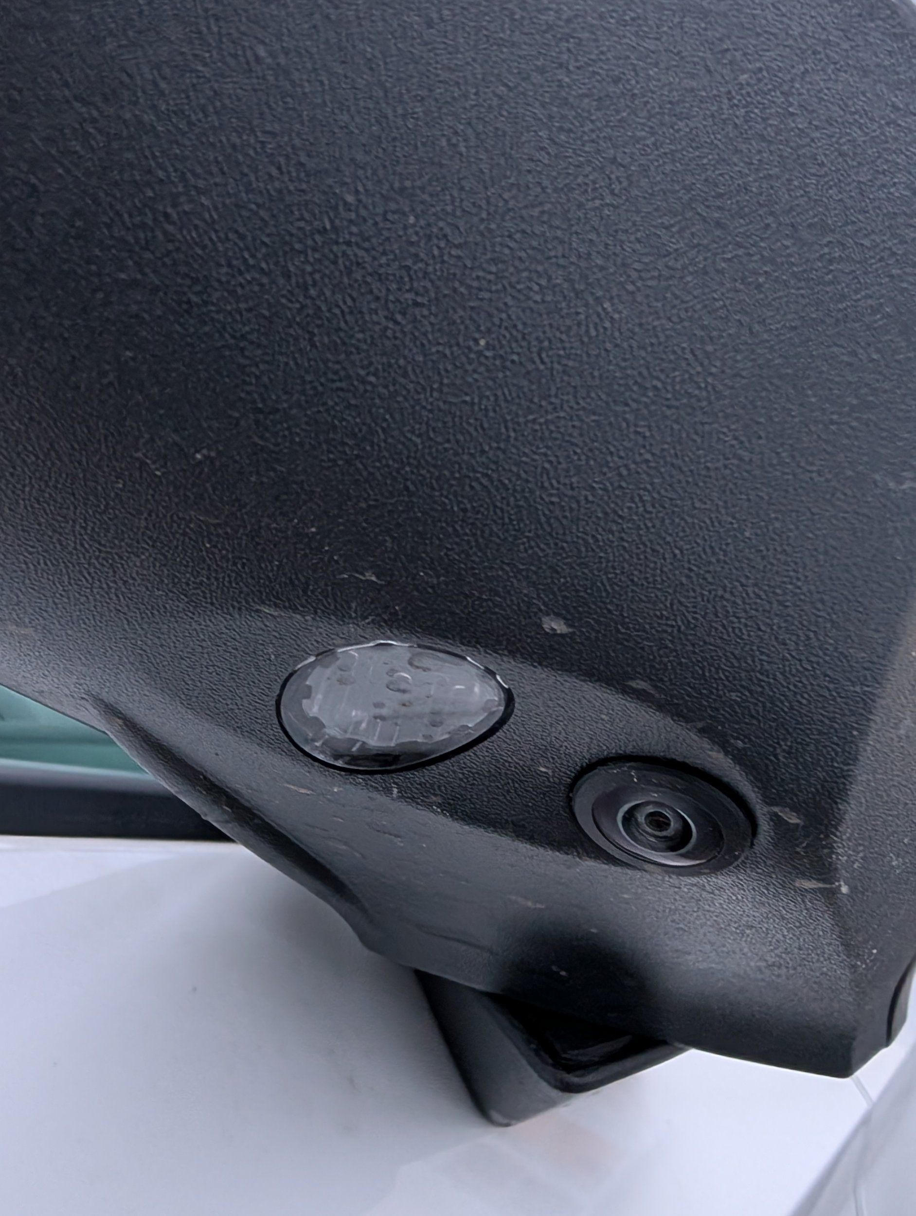

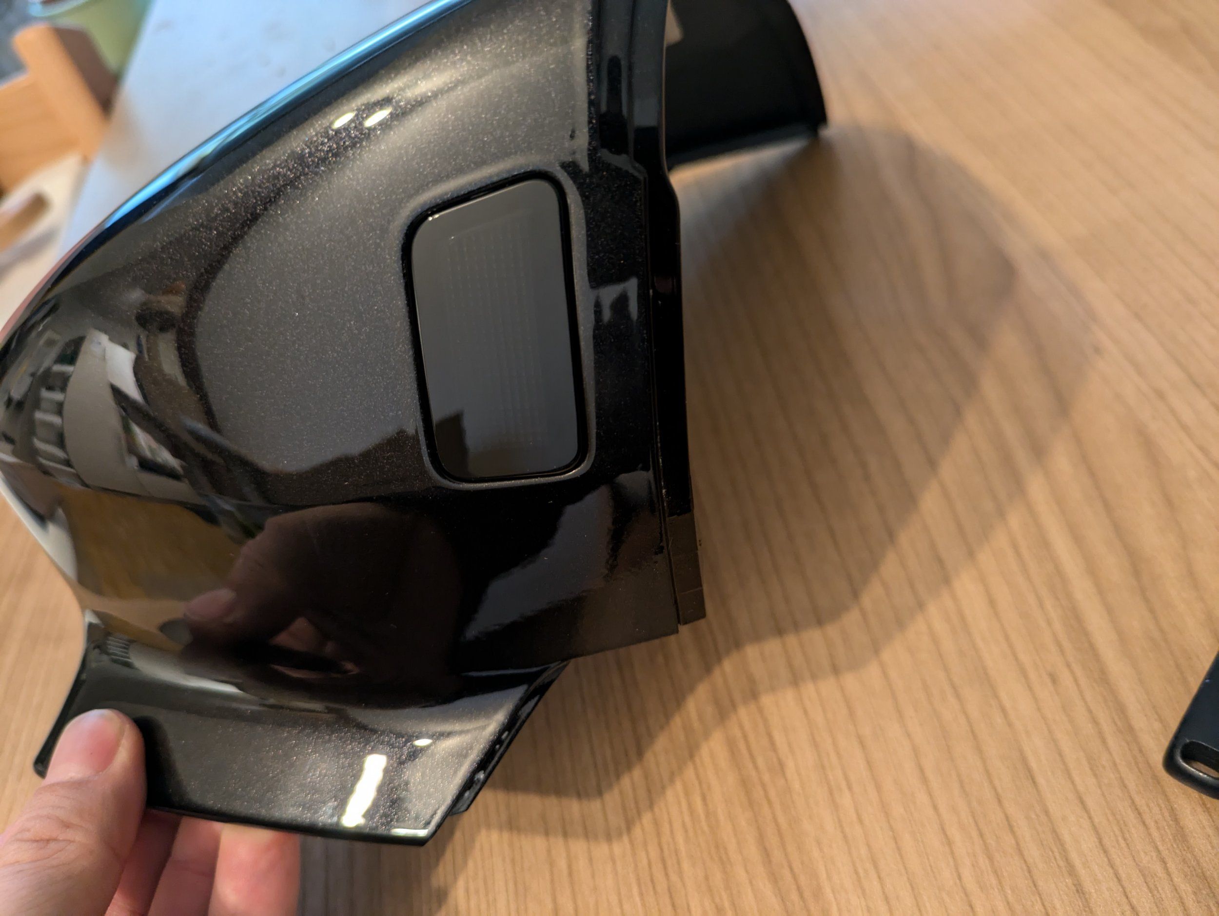

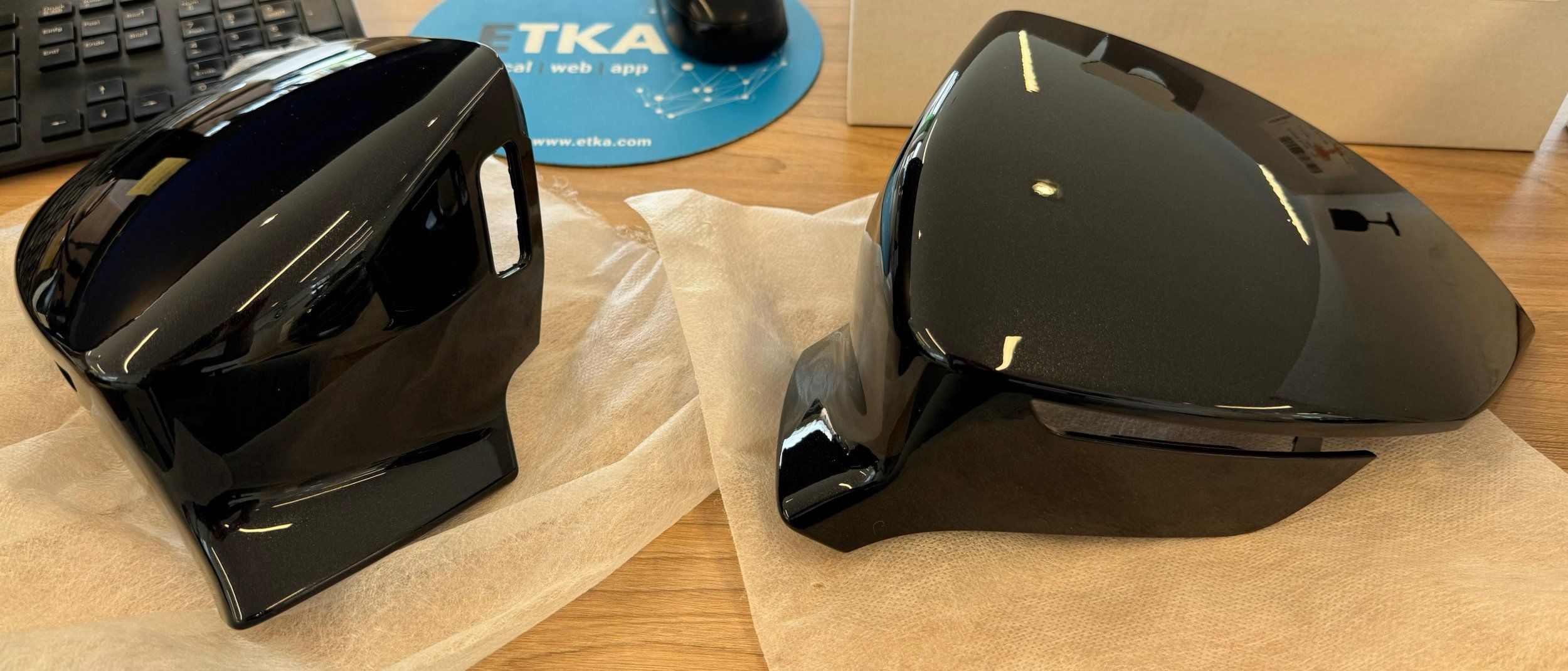

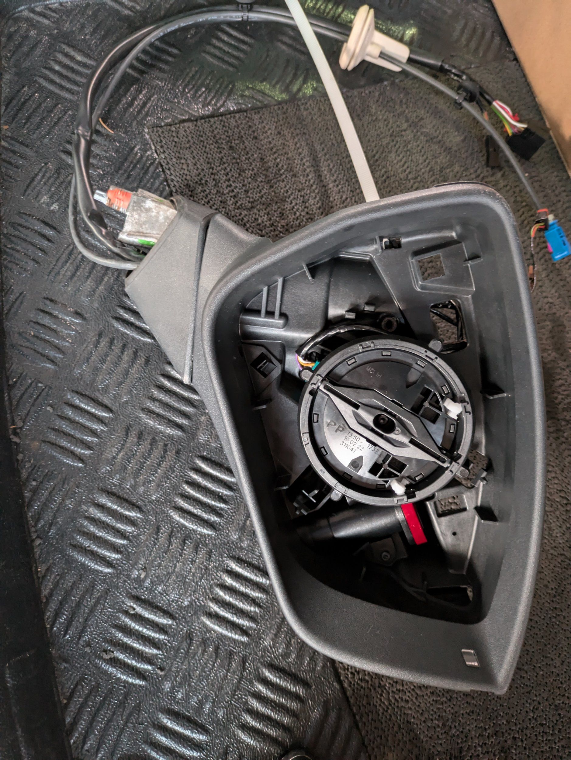

1) Exterior Mirrors
Well, nothing off-the-shelf fits, so I had to get creative.
I opted for the OEM mirrors from the Ateca/Tarraco.
Of course, they don't fit plug and play on the door.
So I bought the original exterior mirrors from a car that had been in a wreck.
The idea behind it was to modify the mounting base.
So I completely disassembled the mirror, unplugged the cable, and then saw how it worked.
I made myself a tool to separate the base from the mirror.
In addition, the LED from the blind spot warning system is moved into the housing.

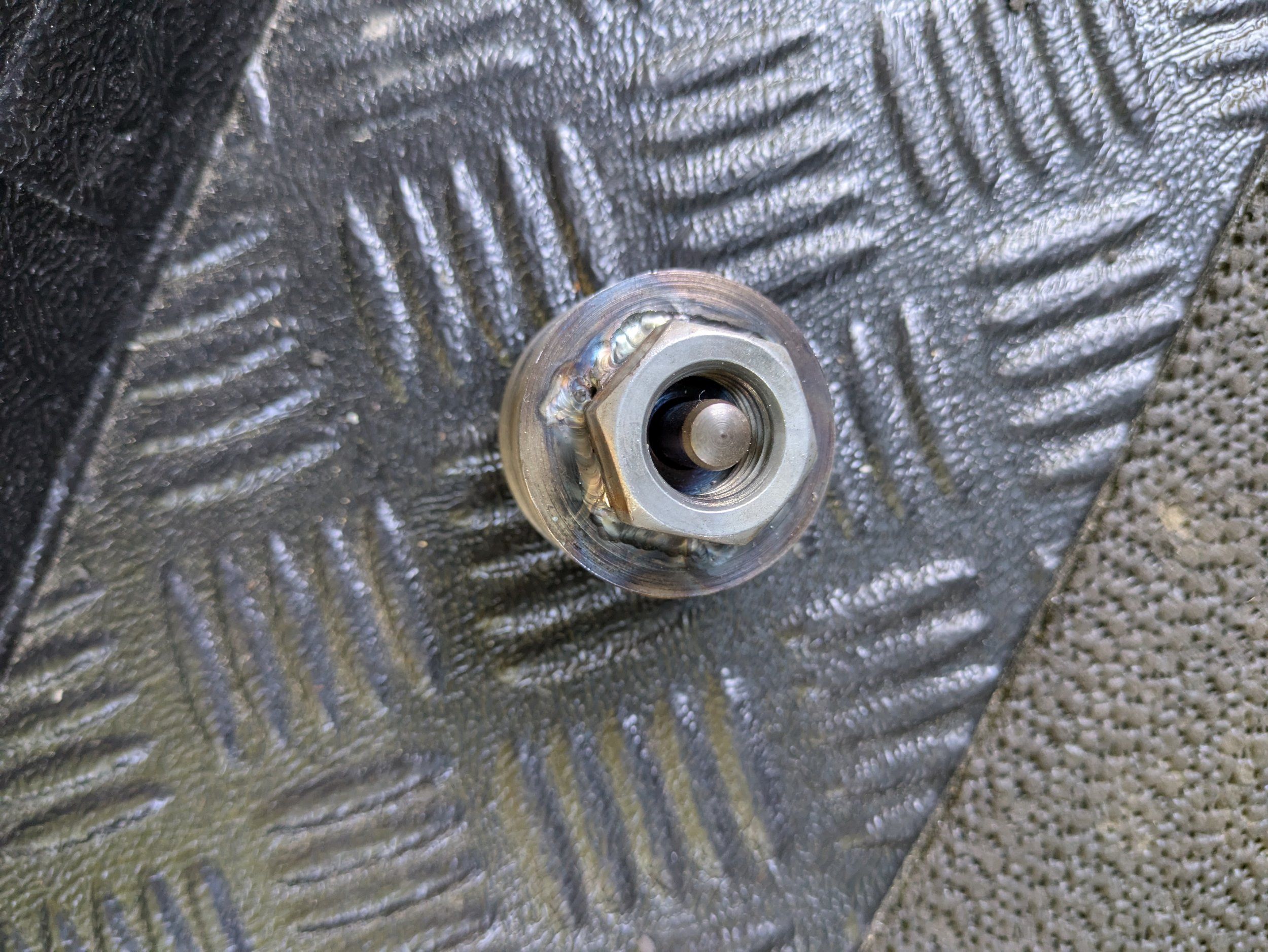

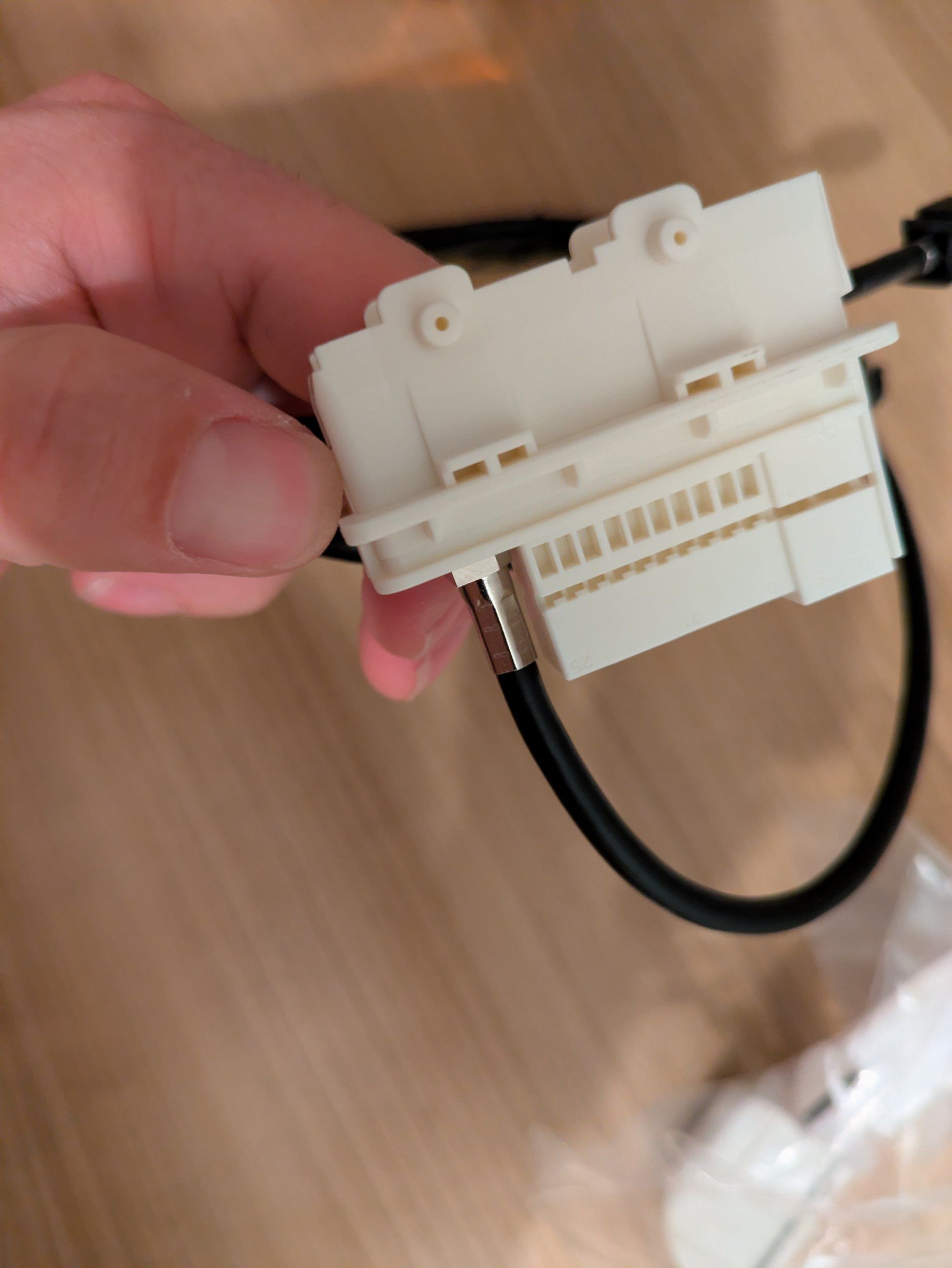

2) The Door

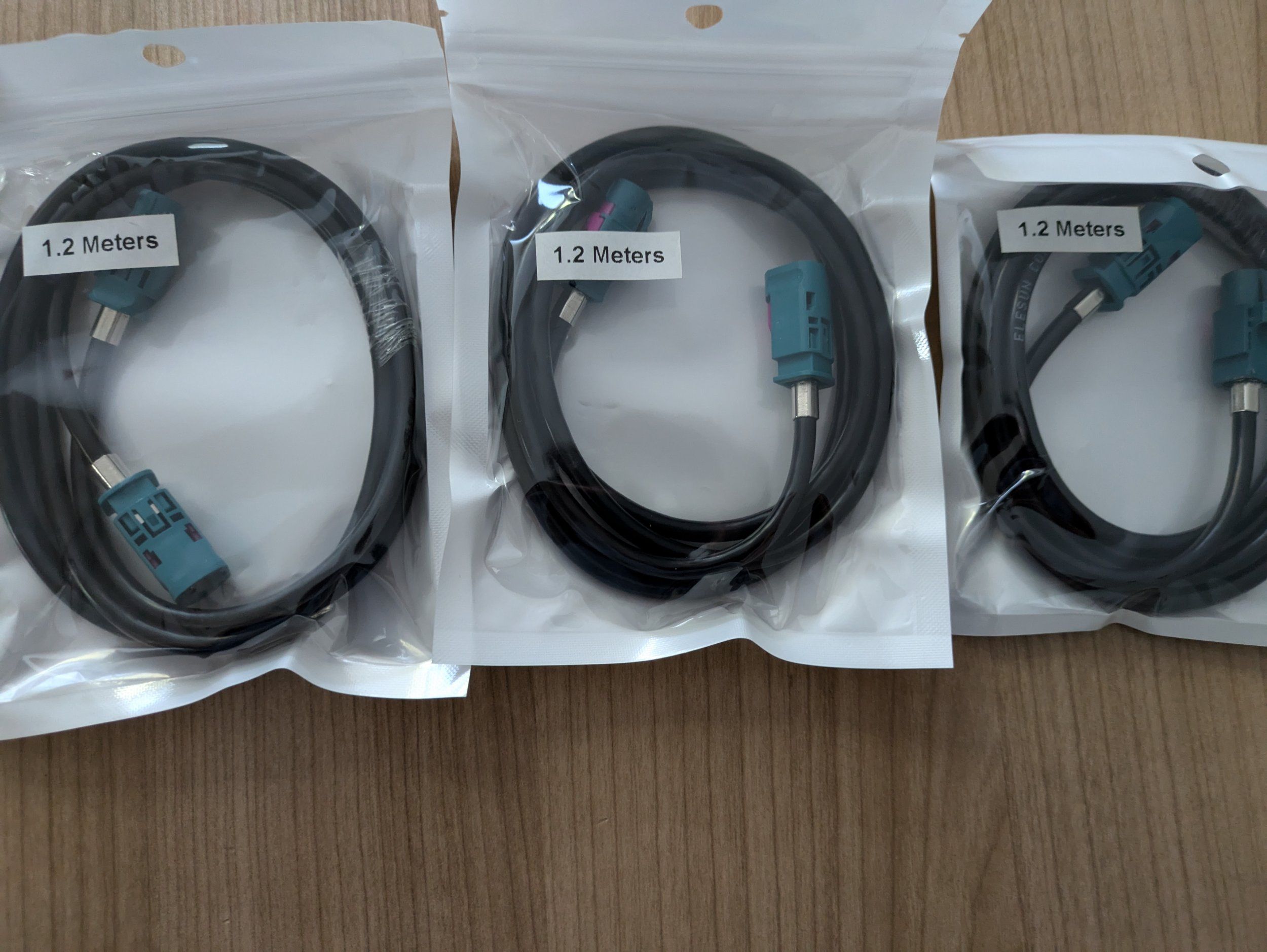

Since I still had both original exterior mirrors from a wrecked vehicle, I made an adapter from the corresponding OEM mirror cable sets.
Why all this? The Ateca has a direct connection for the door control unit, while the Leon doesn't. Regardless of which solution you choose, either the connector on the mirror or the one on the vehicle side has to be replaced.
Another thing that needs to be added here is the HSP cable for the camera. So far, so good, but it has to run from the door to the interior.
This means that the door's pivot point on the A-pillar needs to be replaced.
The camera cable, however, needs to be extended.

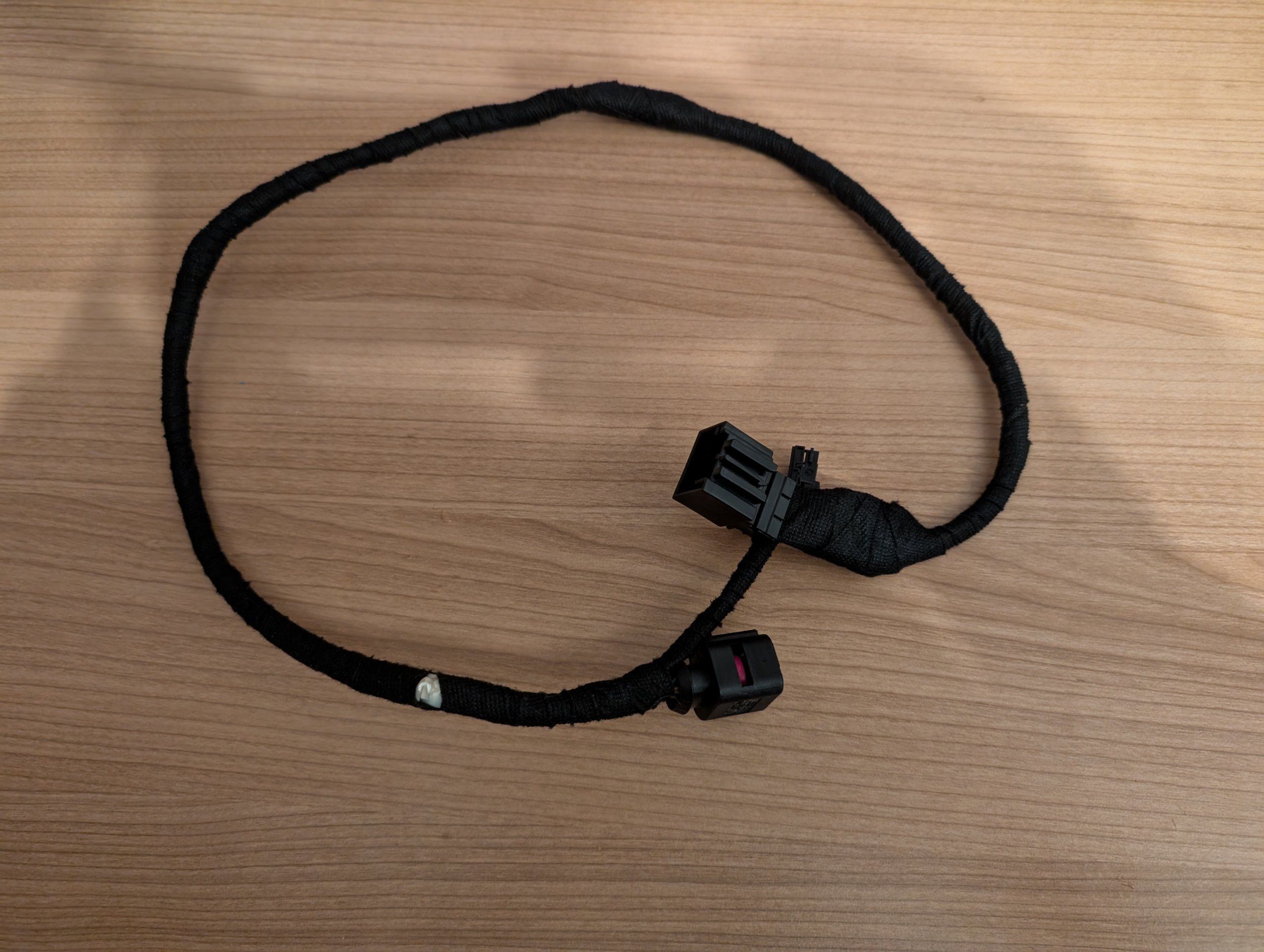

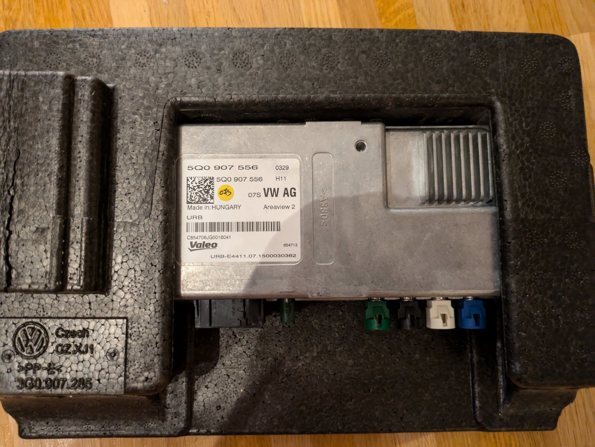

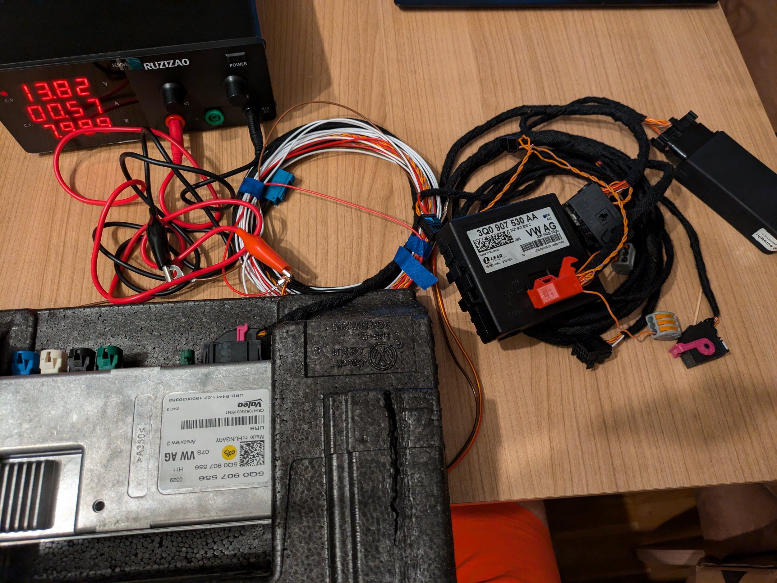

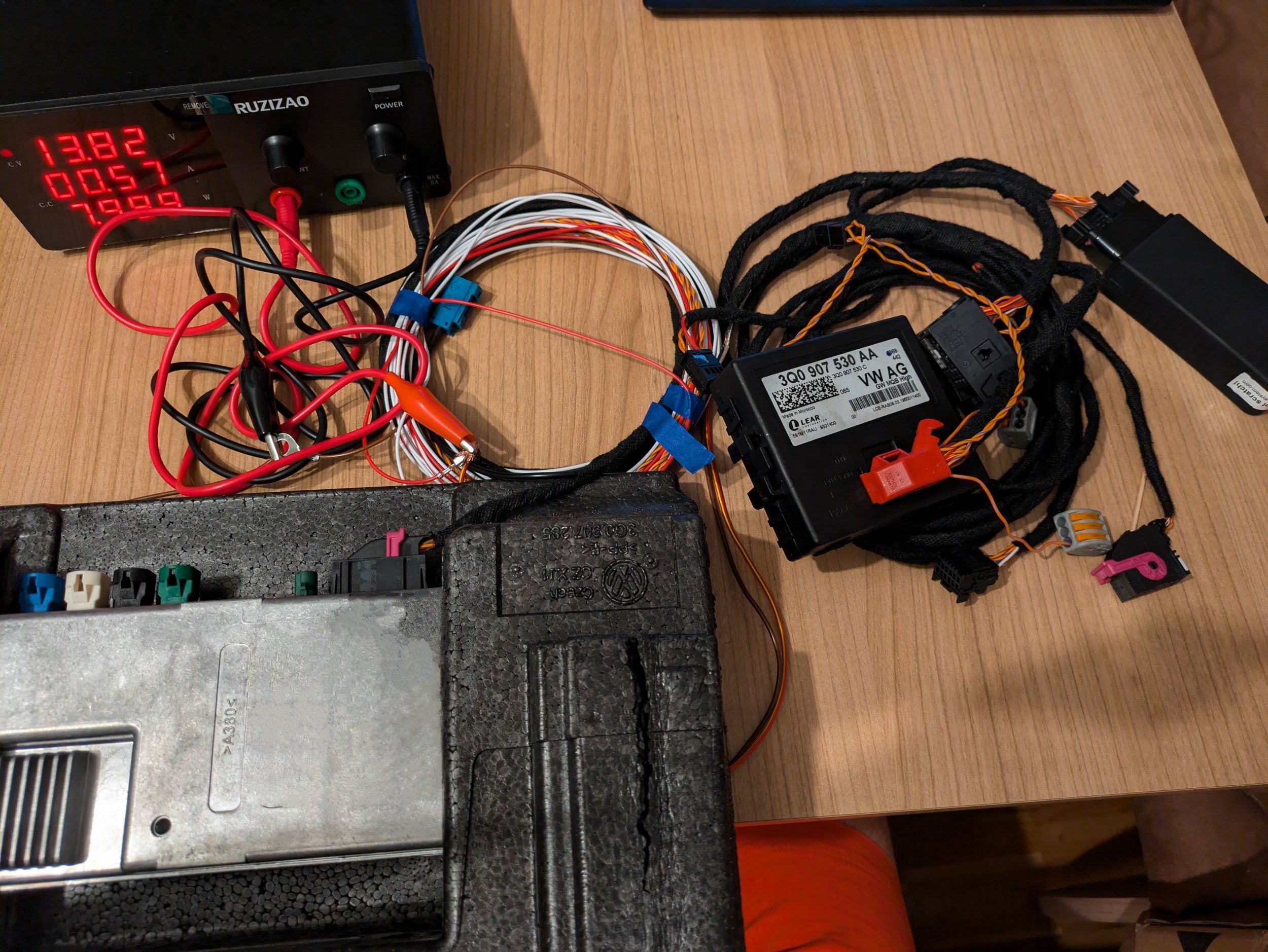

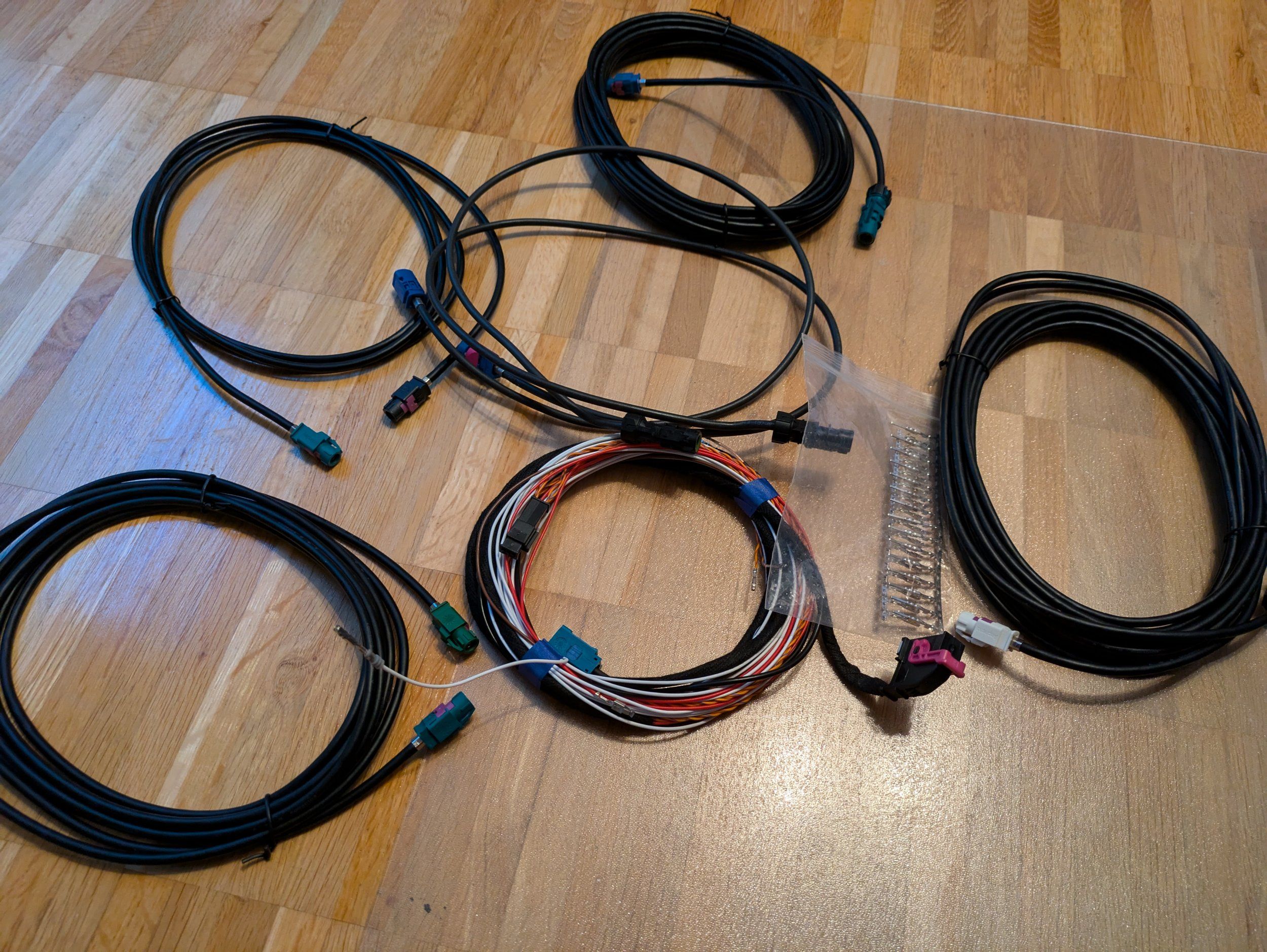

3) Control unit with wiring
I ordered the wiring harness from AliExpress and picked up the module not far from me.
The original control unit on the passenger side is normally located under the seat.
I'm considering installing the control unit in the trunk; the cables should be long enough.
The following signals:
- Can high
- Can low
- KL31
- KL30
- Video signal
- HSP adapter piece

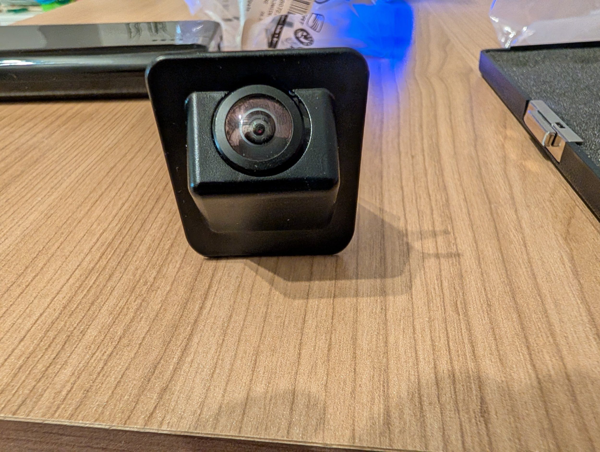

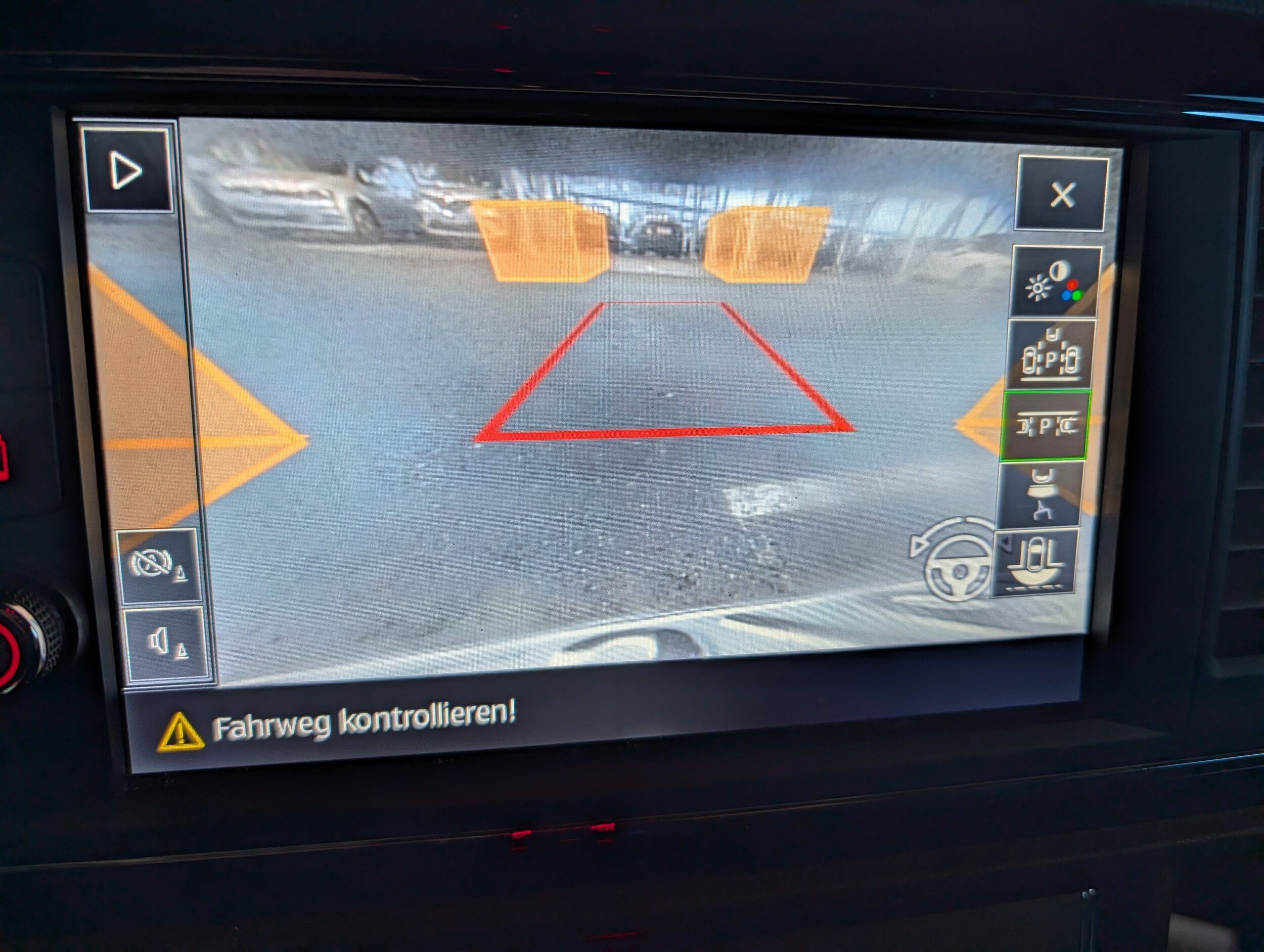

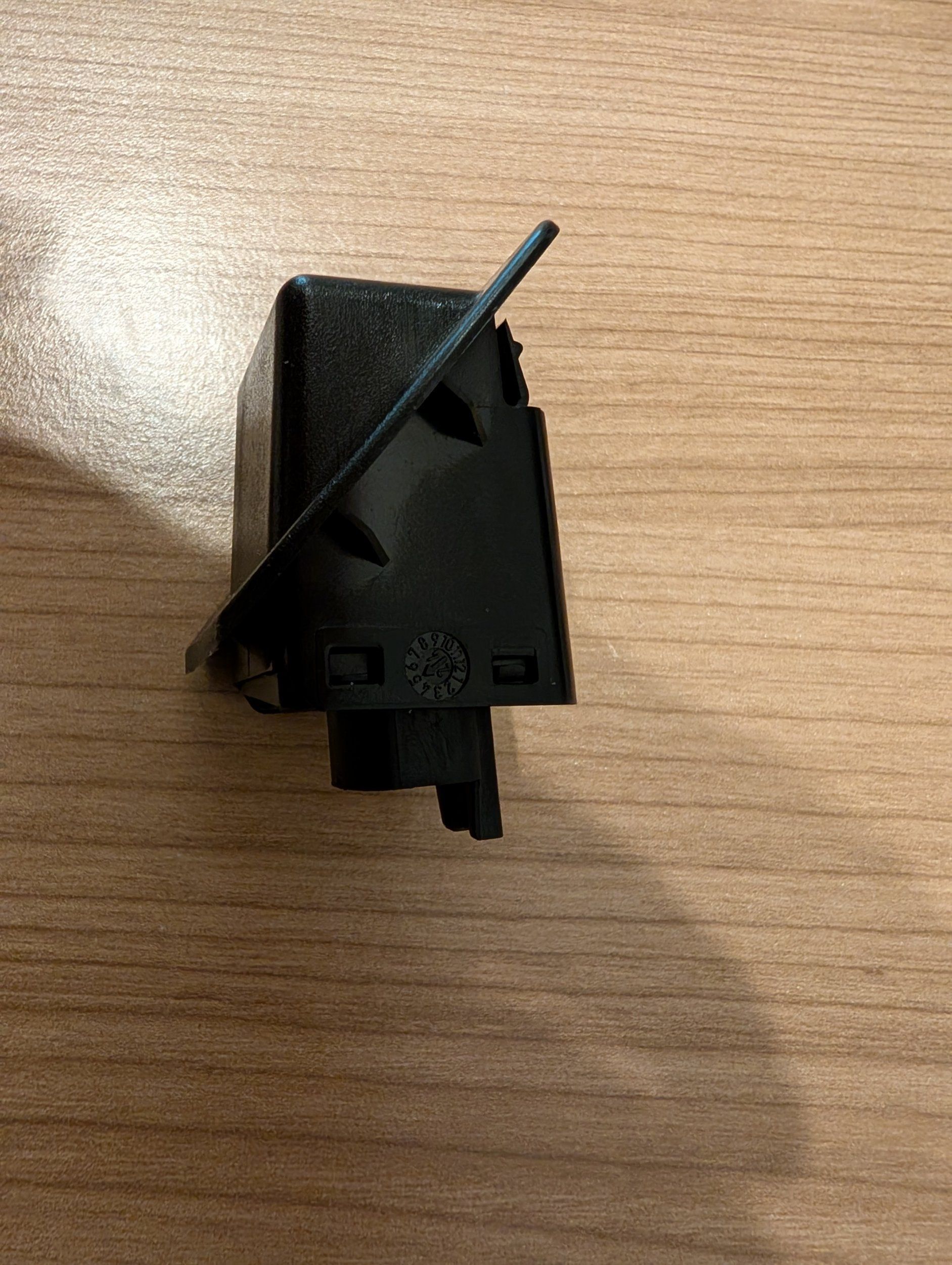

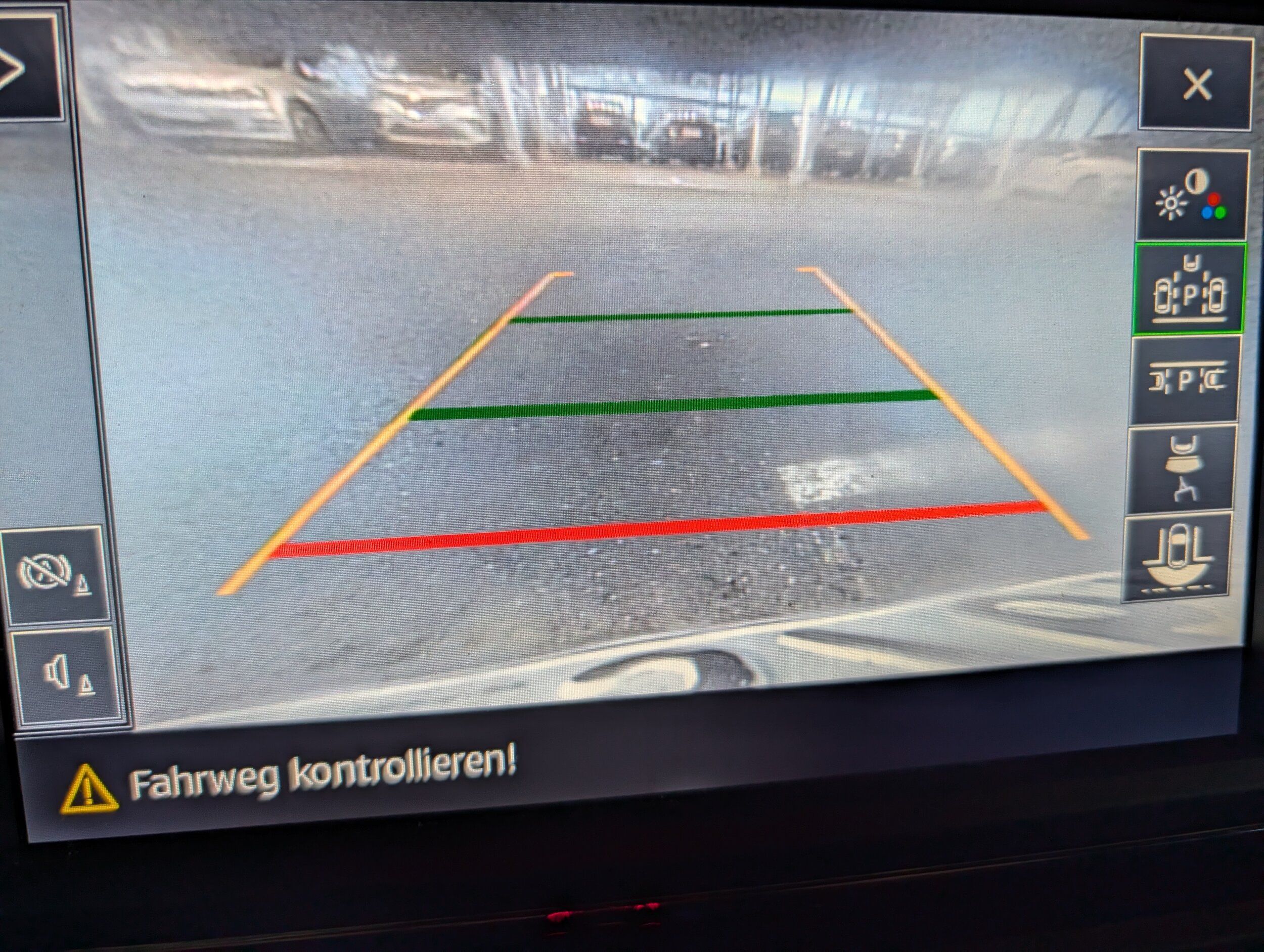

4) The rearview camera
The camera is a standard AirView camera, like the one in the exterior mirror.
The mount is OEM from Seat, which I think fits perfectly.

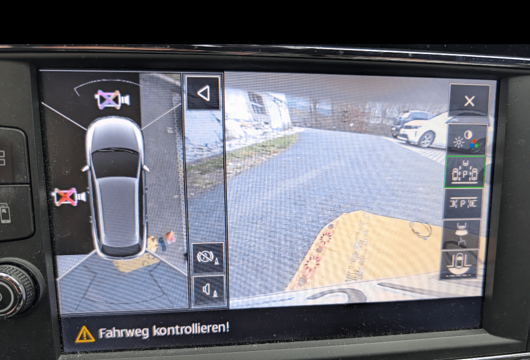

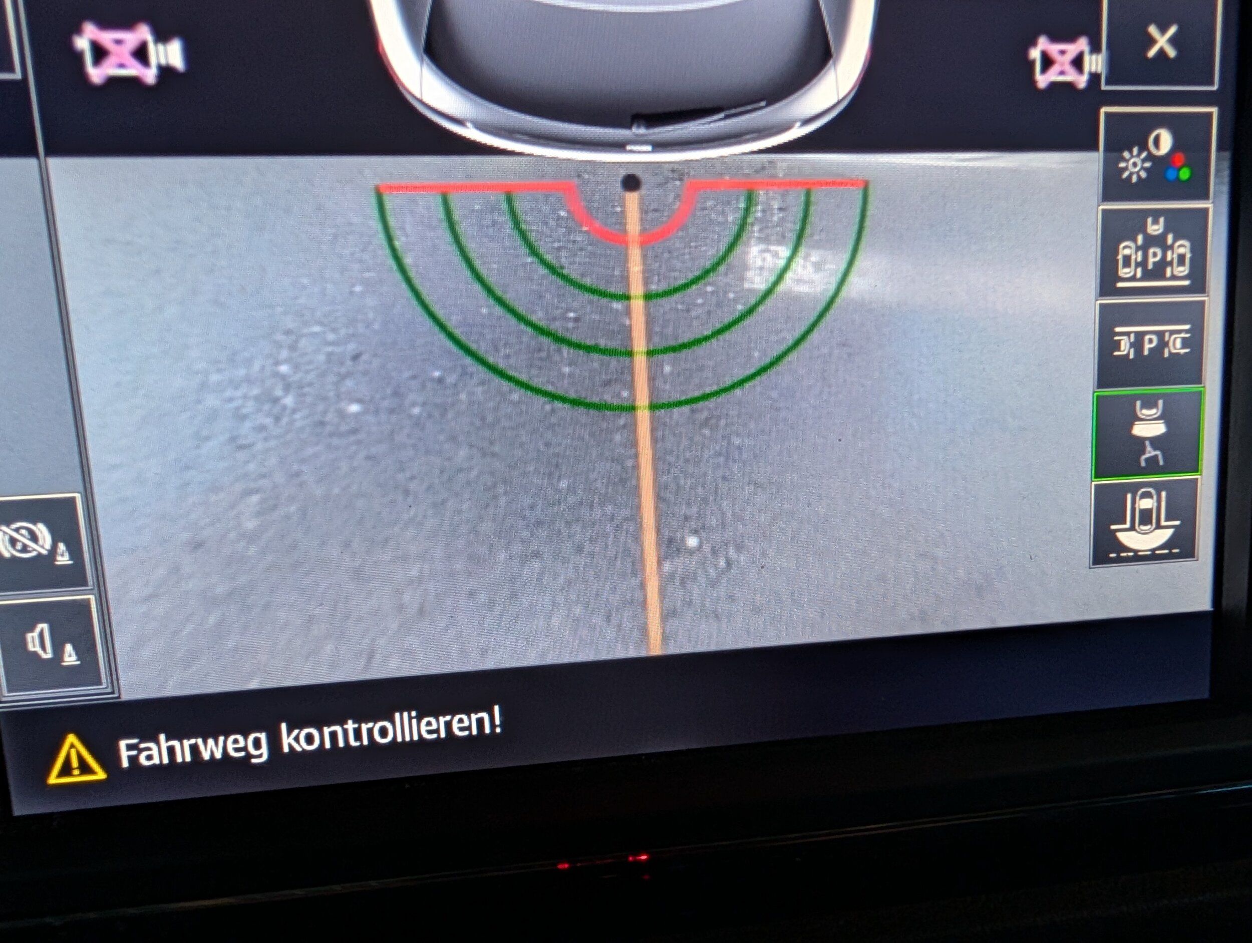

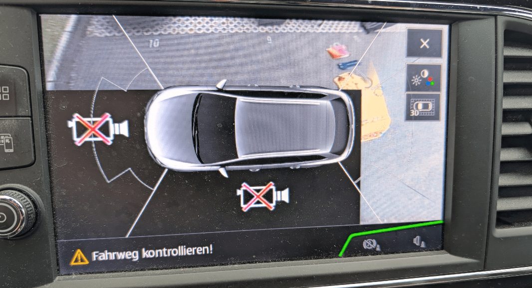

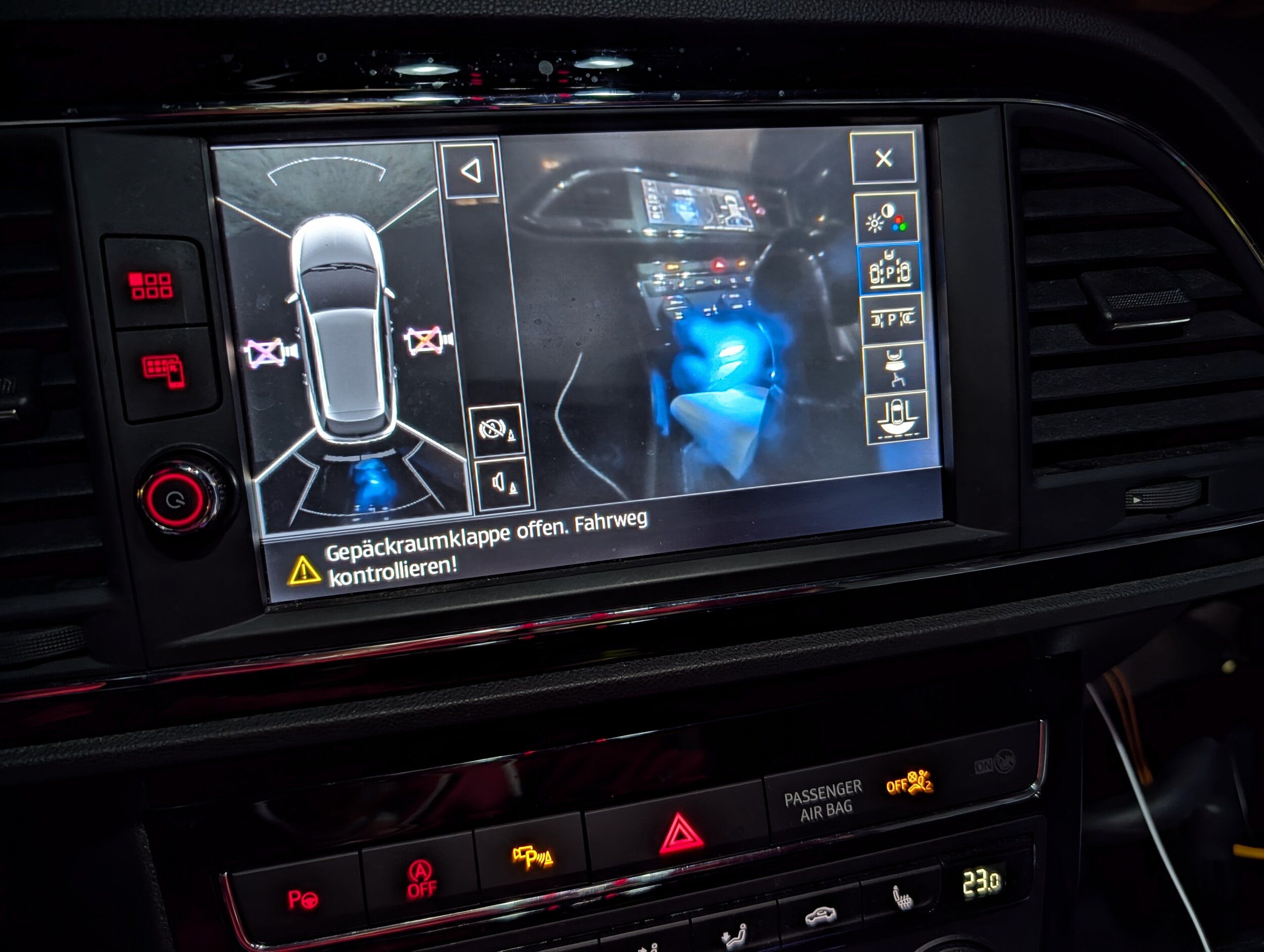

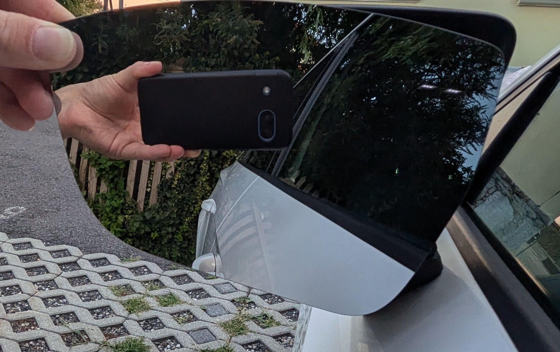

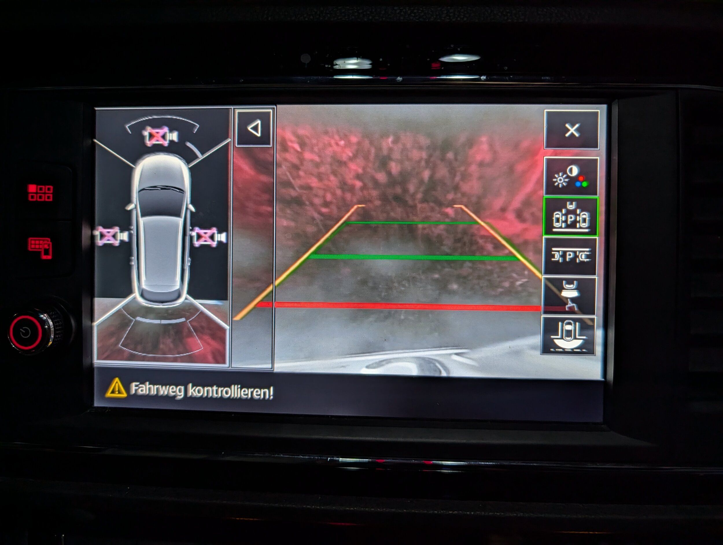

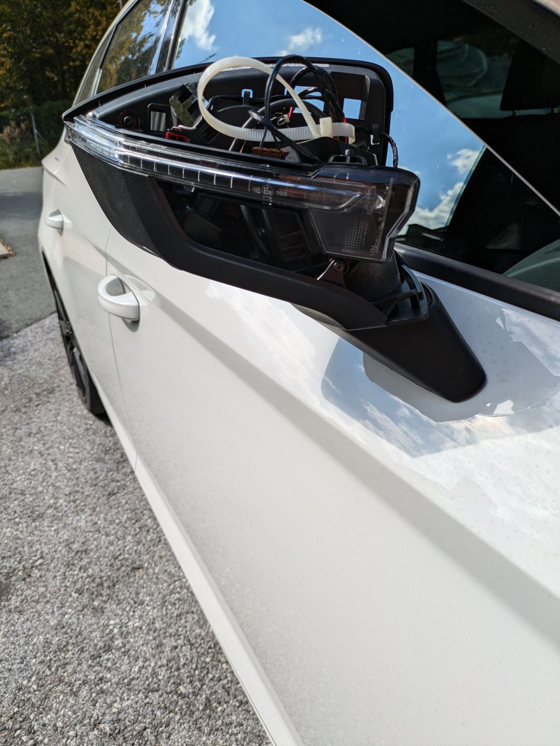

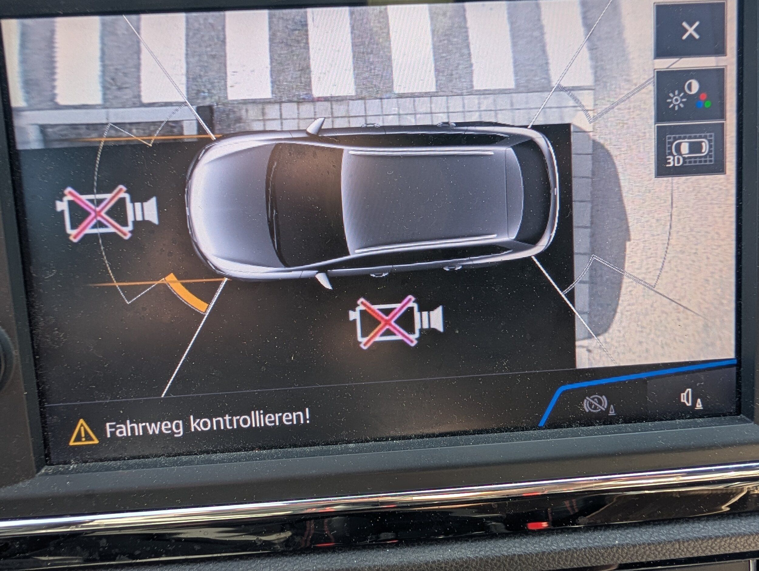

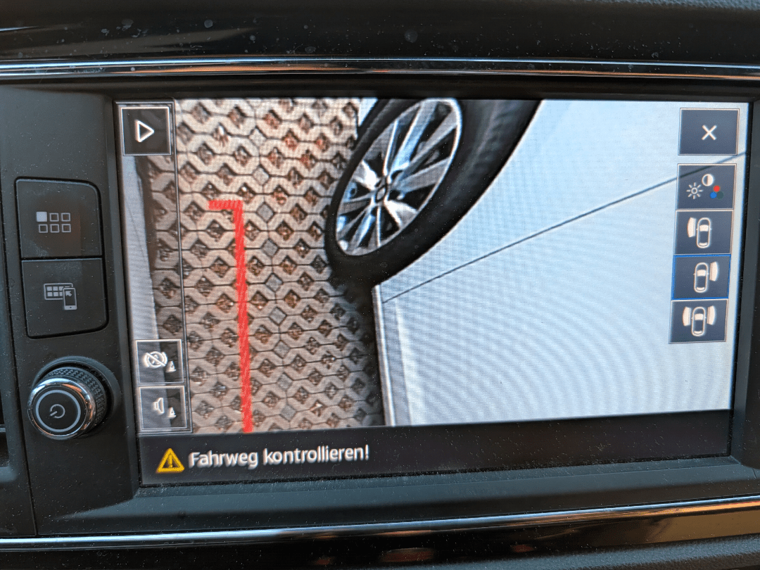

So, a little progress here too... the second exterior mirror is installed, with adapter cable and test drive cap. Put the glass in and test it...

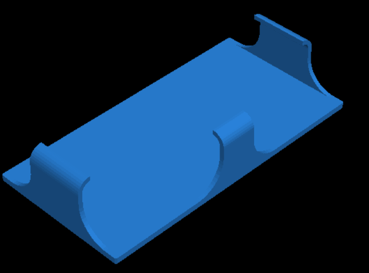

I also have the first prototype of the bracket for the control unit. I want to install it in the trunk.

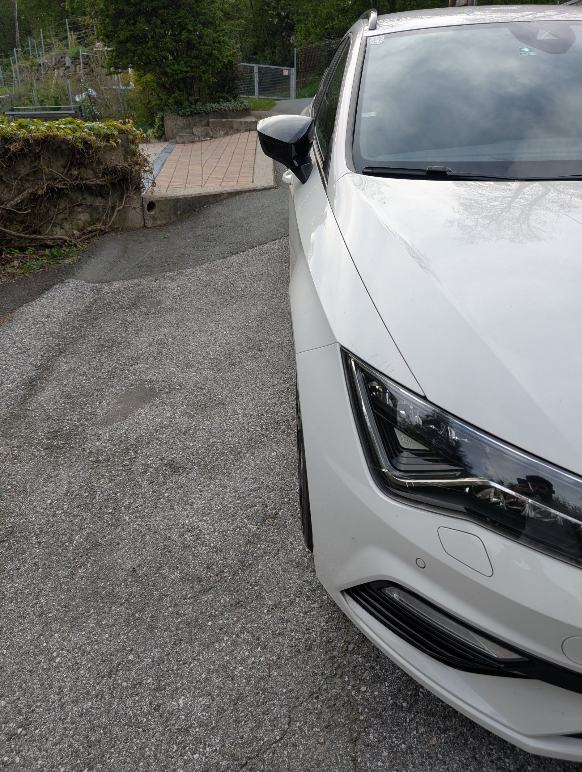

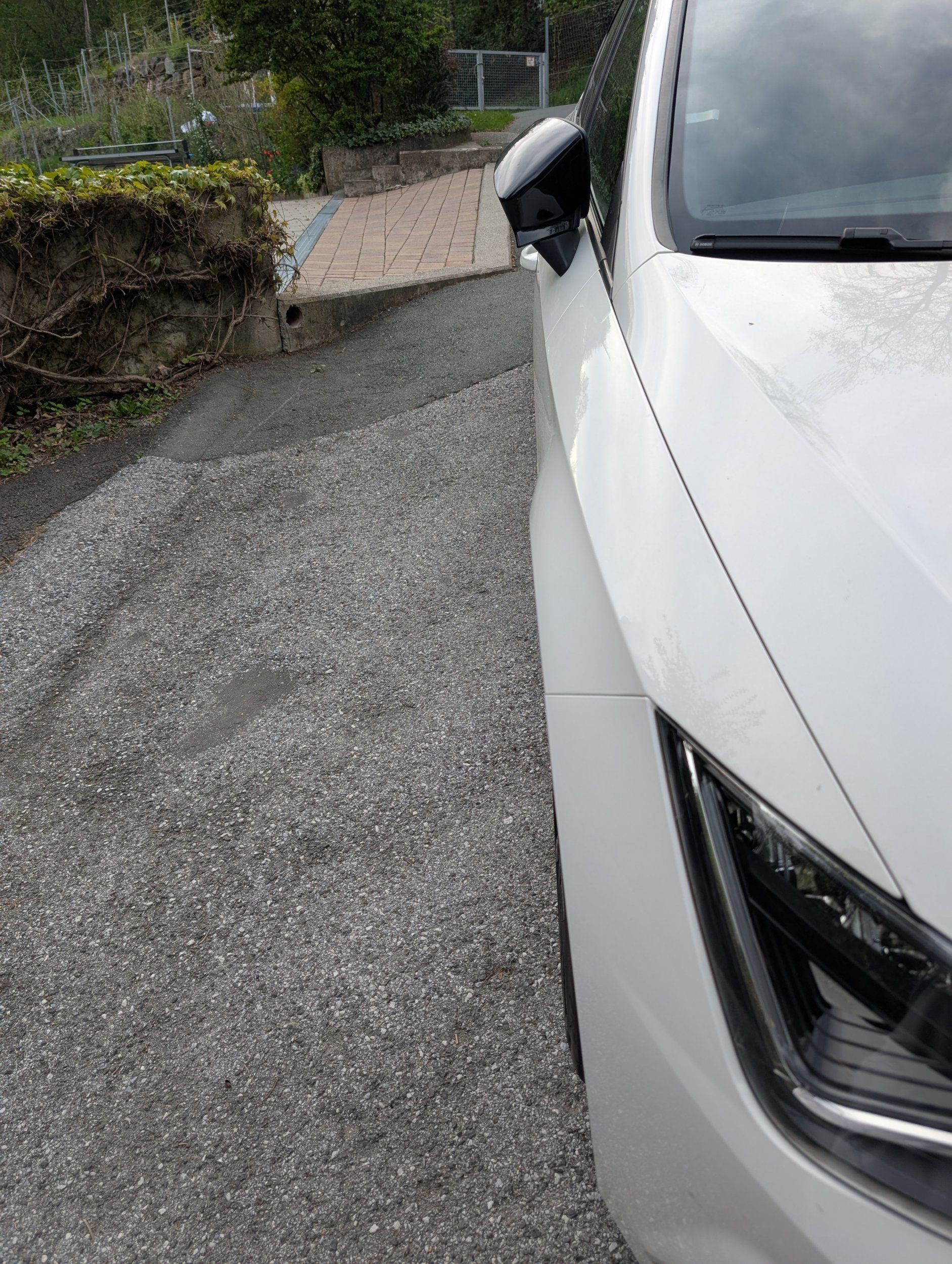

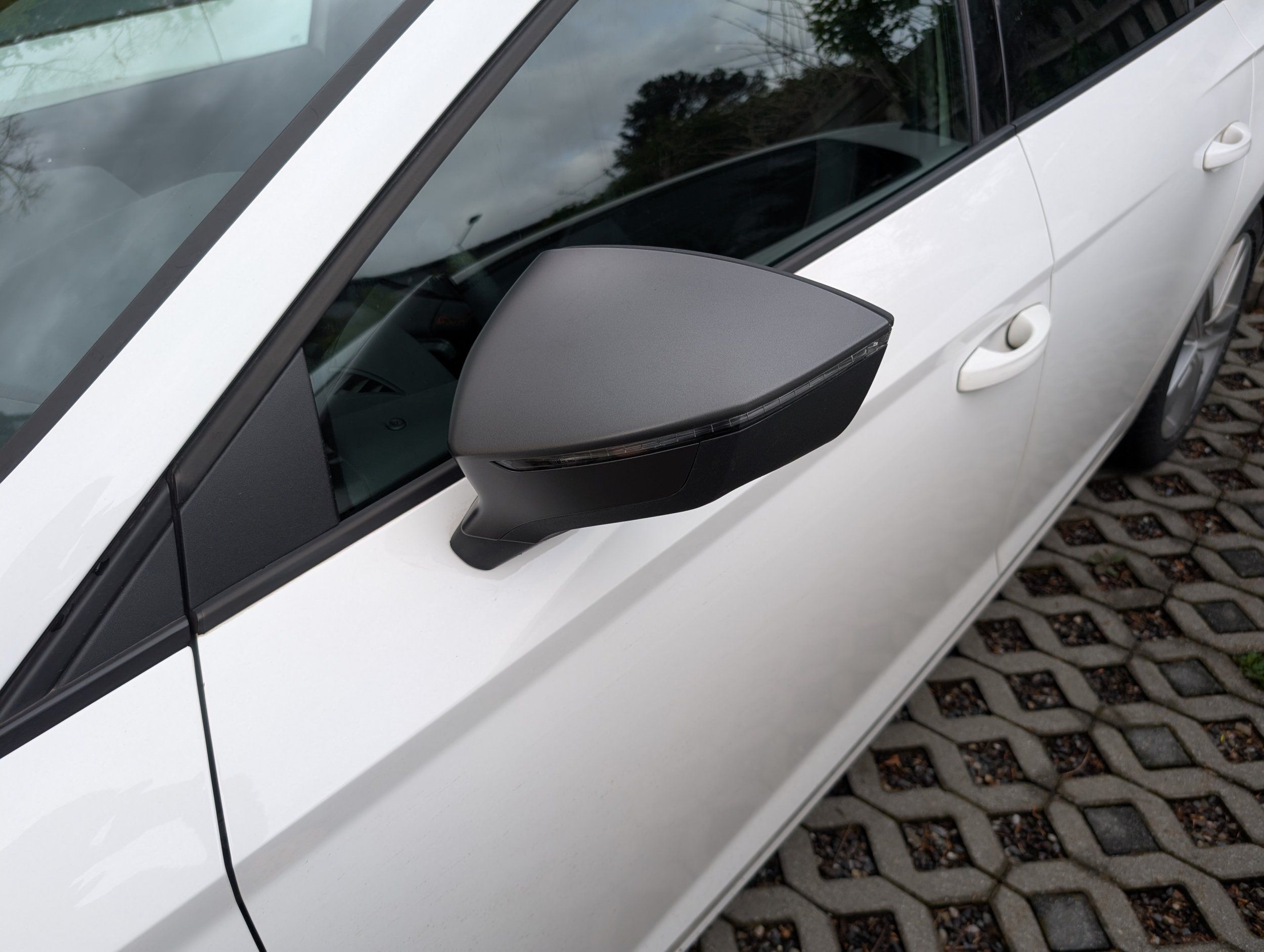

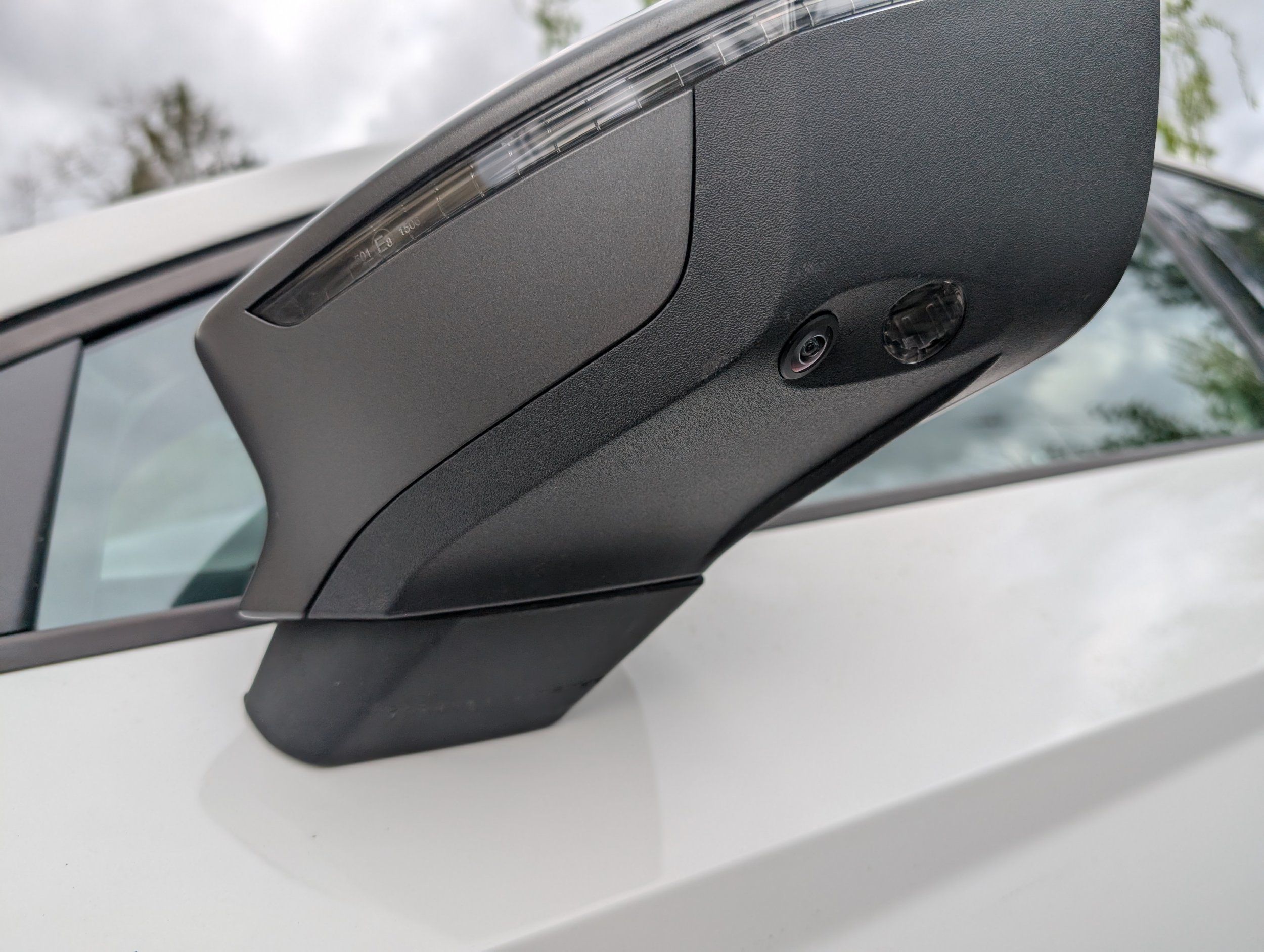

the side view... yes the mirrors are definitely different in the overall picture of the Leon now.
Other Views
I still need to adjust the alignment a little.

I will sure be following this topic, are you also going to swap the door connectors for the ones with the hsd connector?
No fakra, HSD cable...
I have OEM Mirrow
Have No Problem with 3D View
Yes, i Change door Connection
