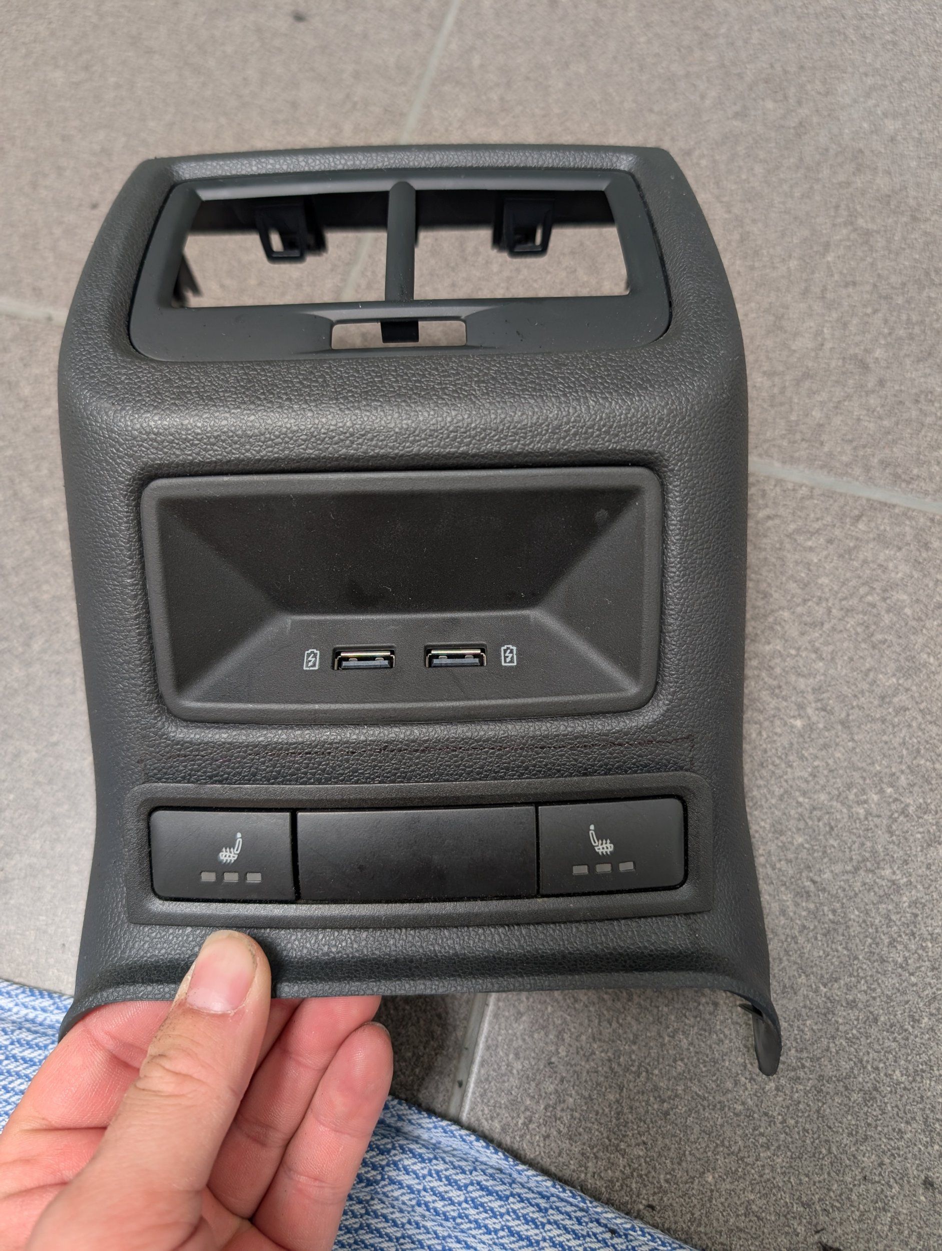

Thanks to the new seat configuration, I now also have heated rear seats, which I would of course like to activate when needed.
The part numbers are from the Octavia 5E facelift:
- Control unit for the rear heating mats 3AA959772 with matching mating connector 6Q0937713,
- Buttons 5E0963105A and 5E0963106A. I will provide the item numbers for the matching connectors later.
I'm currently installing the buttons.
I'll probably install them to the left and right of the panel. There's the most space behind them.

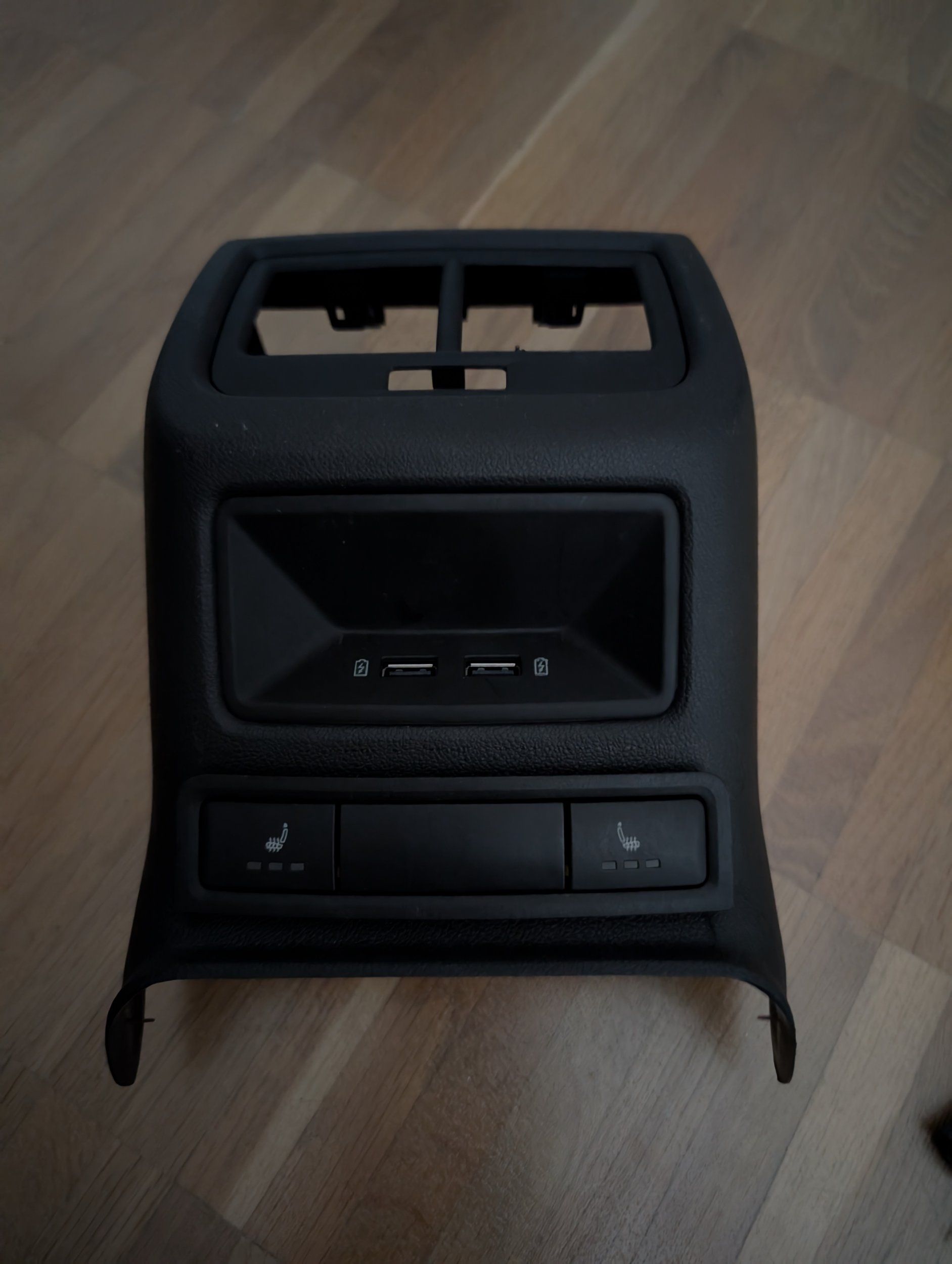

the rough adjustment has been made.
Reactions: gabz
So, the first implementation. But I'm not entirely satisfied yet. It's enough for a start. Now, as far as everything goes, let's wire it up.

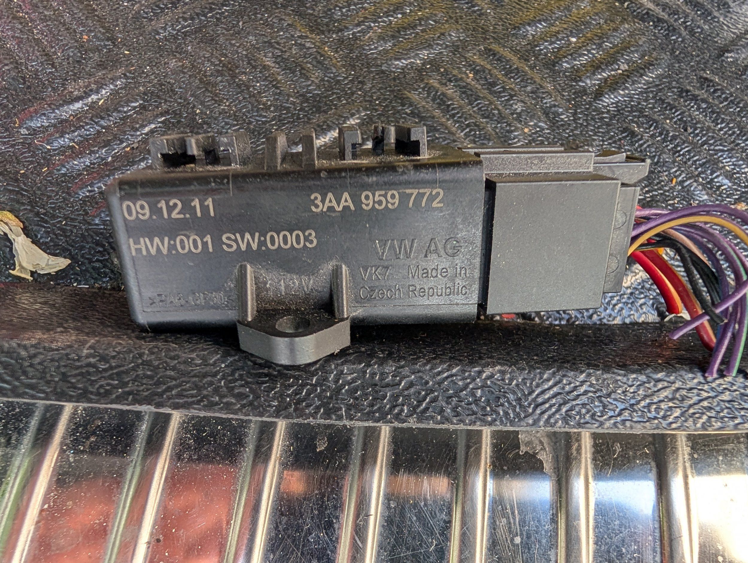

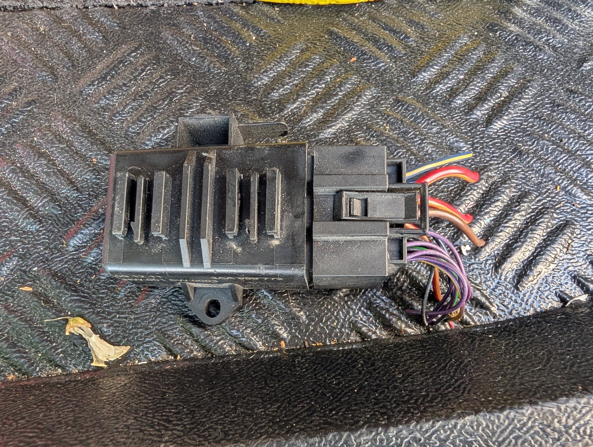

The control unit with plug and a few cm of cable for the rear seat heating has been delivered.

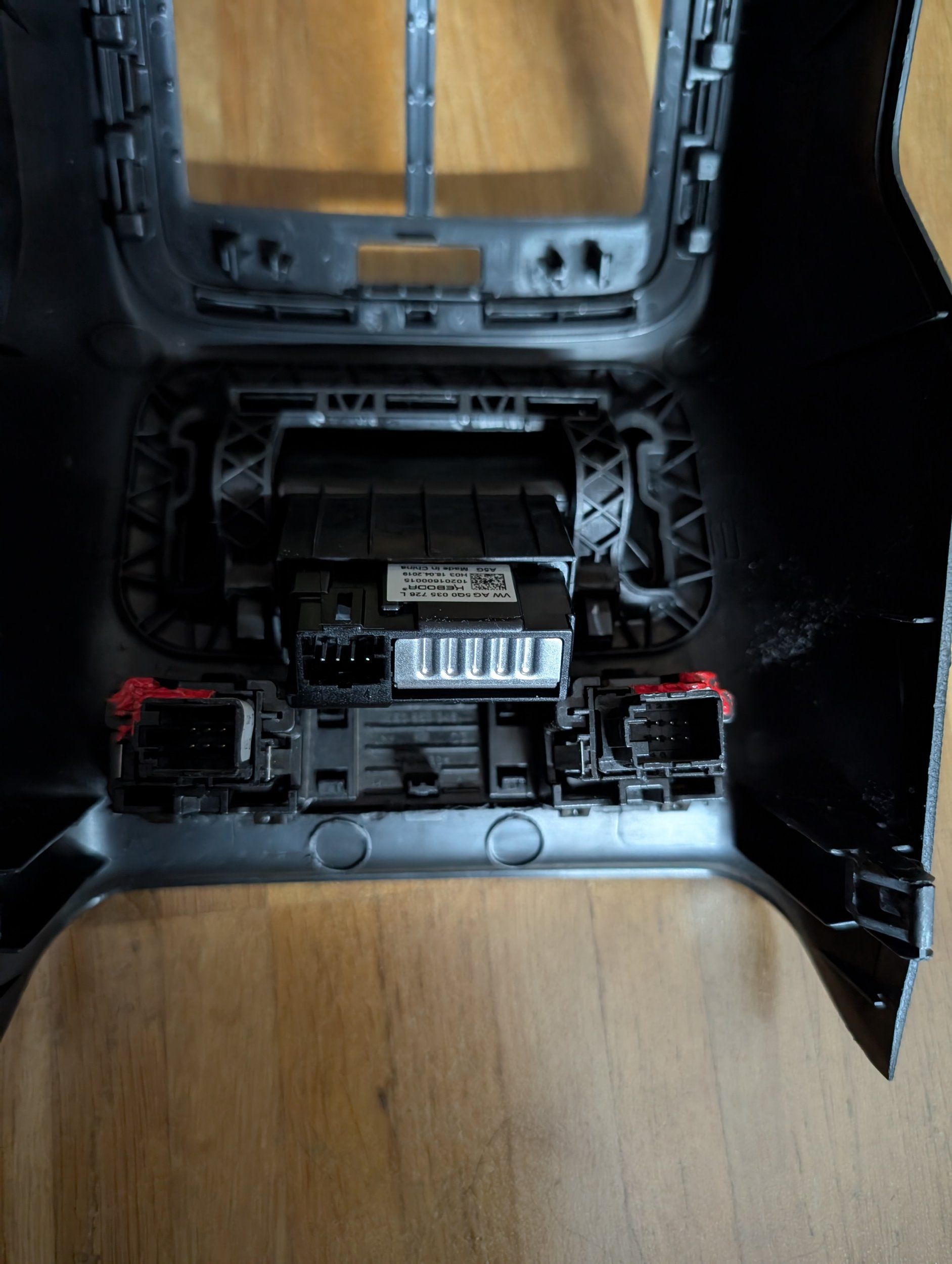

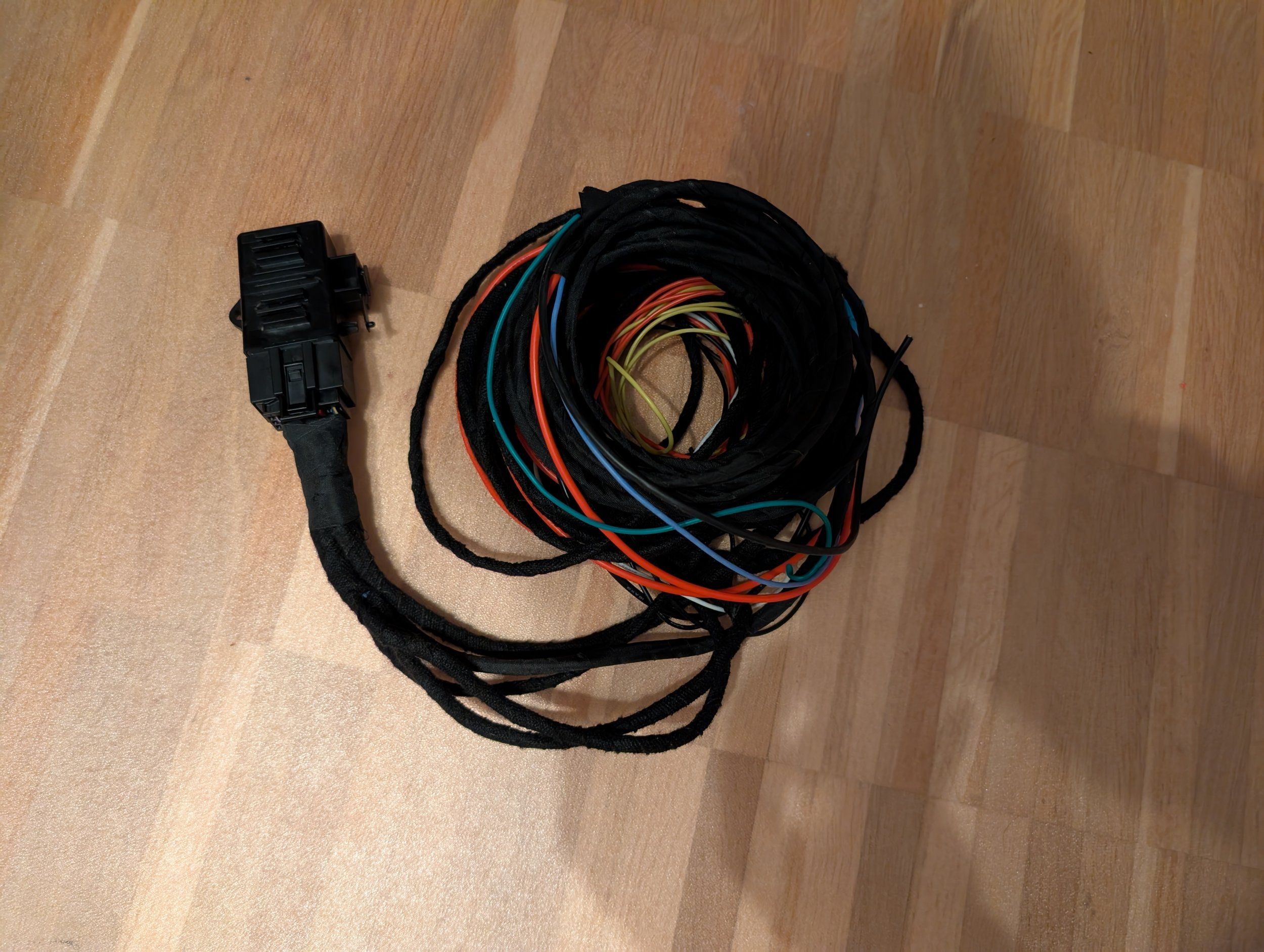

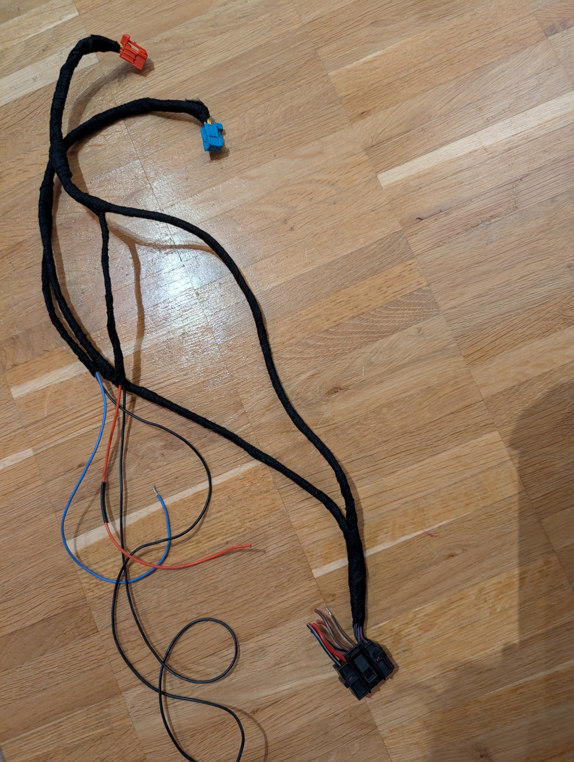

The cable harnesses are being manufactured... the module will be installed in the center console. There's enough space and it's easier to reach than in the trunk behind the trim.
Reactions: Slavixs

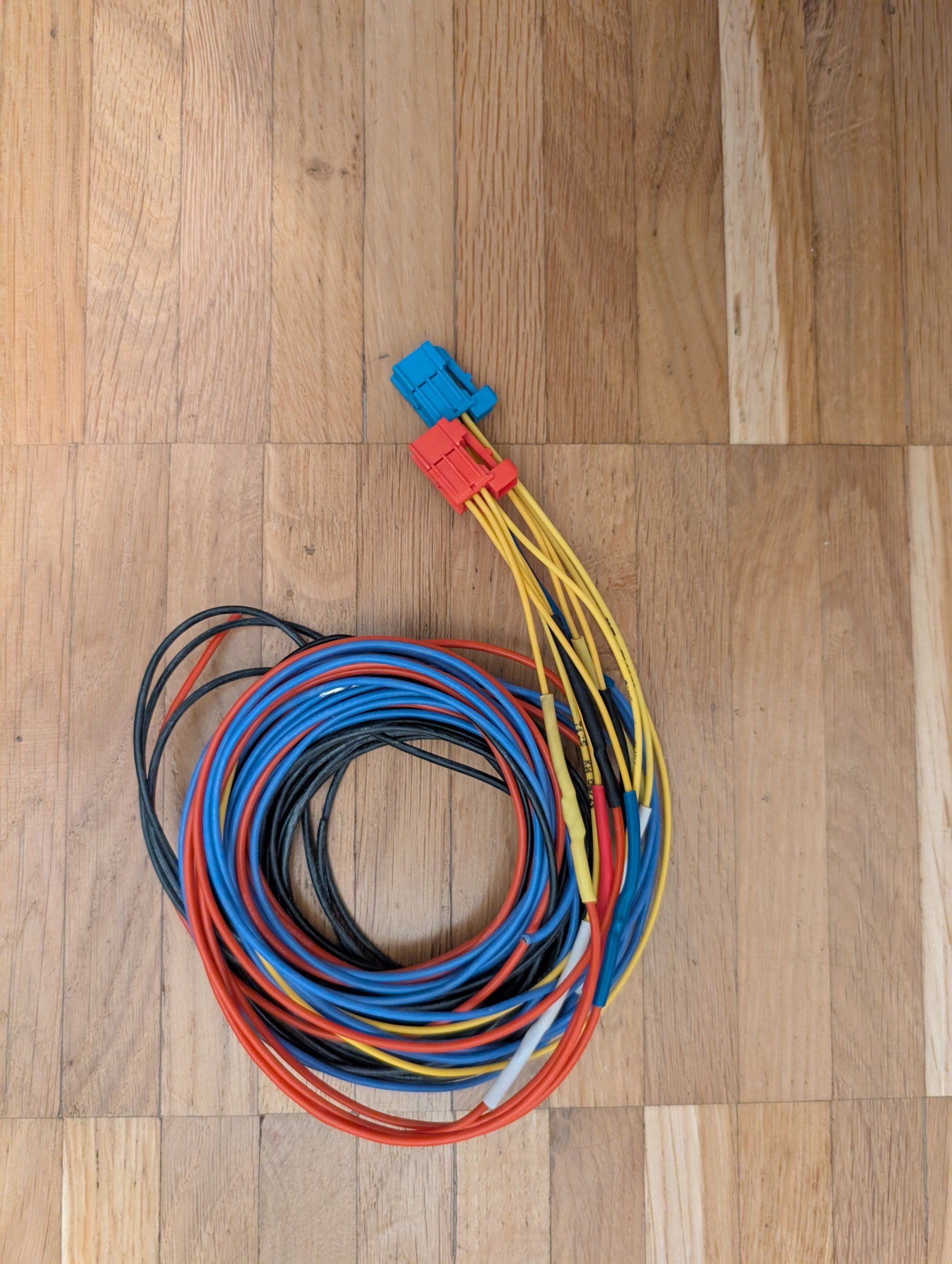

Good morning. The seat heating buttons are wired up, but terminal 58d and terminal 31 are still missing for connection. Next comes the wiring harness for the power supply.
Reactions: Chariot

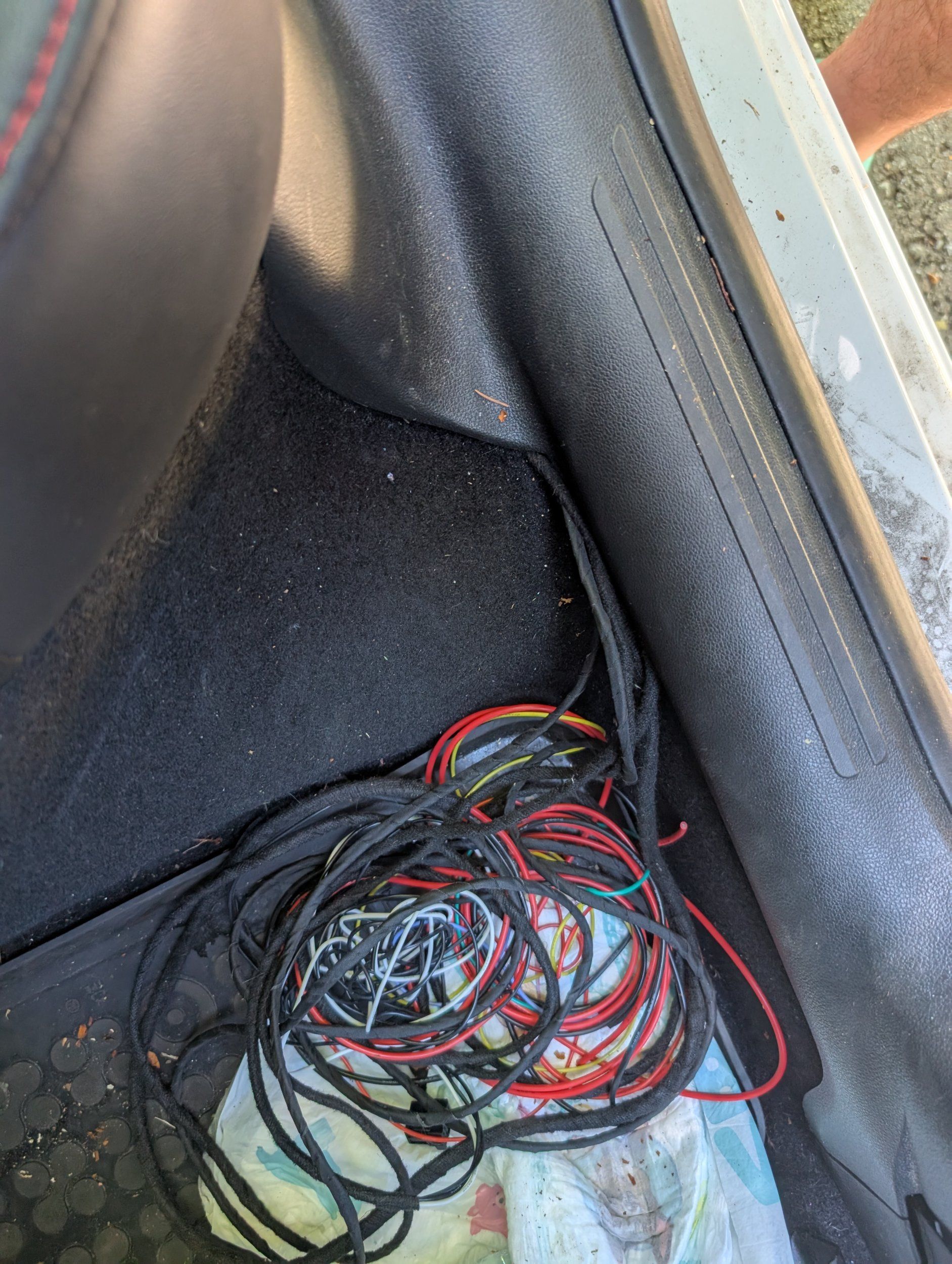

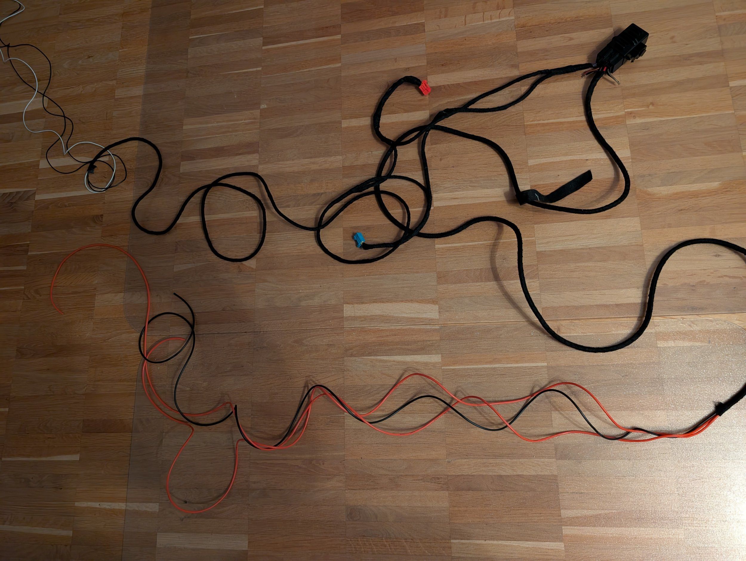

So, the wiring harness to the control unit is finished. Install it, pull everything in, and connect it to the vehicle.
Reactions: Slavixs and gabz

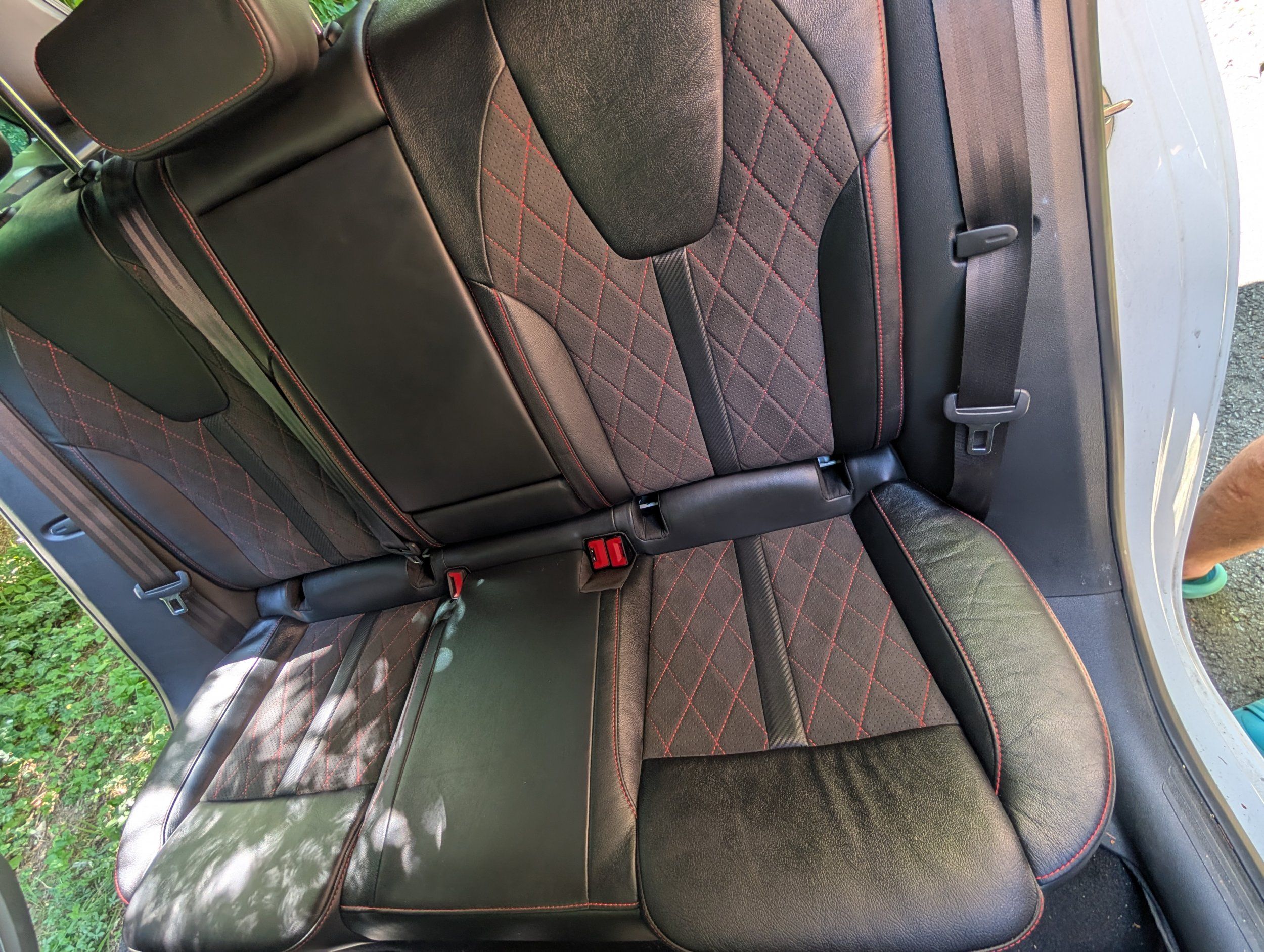

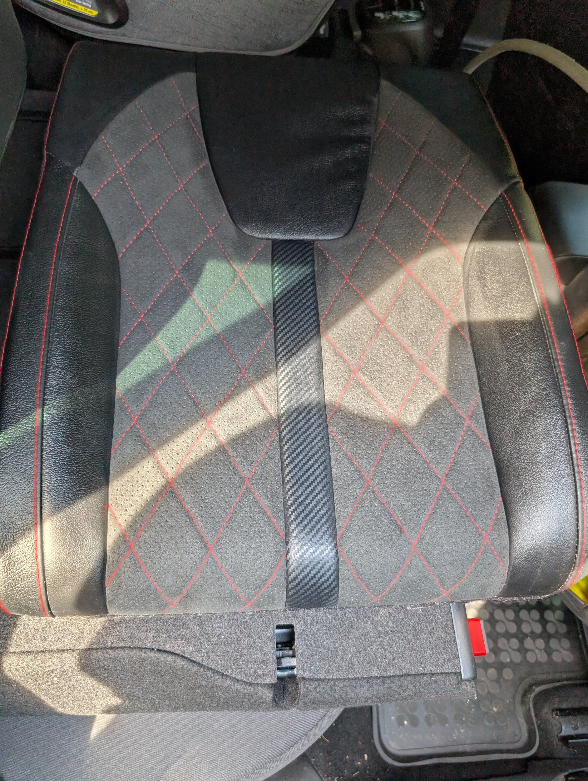

So, today I picked up the rear seat from the car upholsterer. I'll install it and wire it up when I have time
I'll report back.
Reactions: gabz and Slavixs

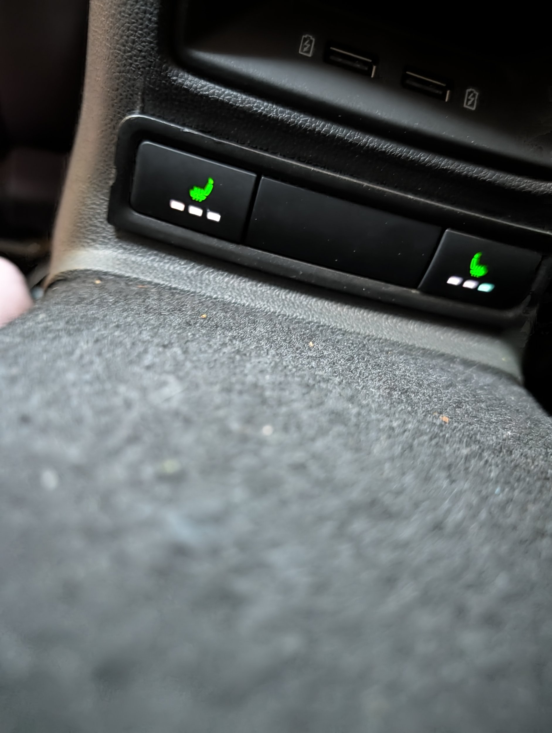

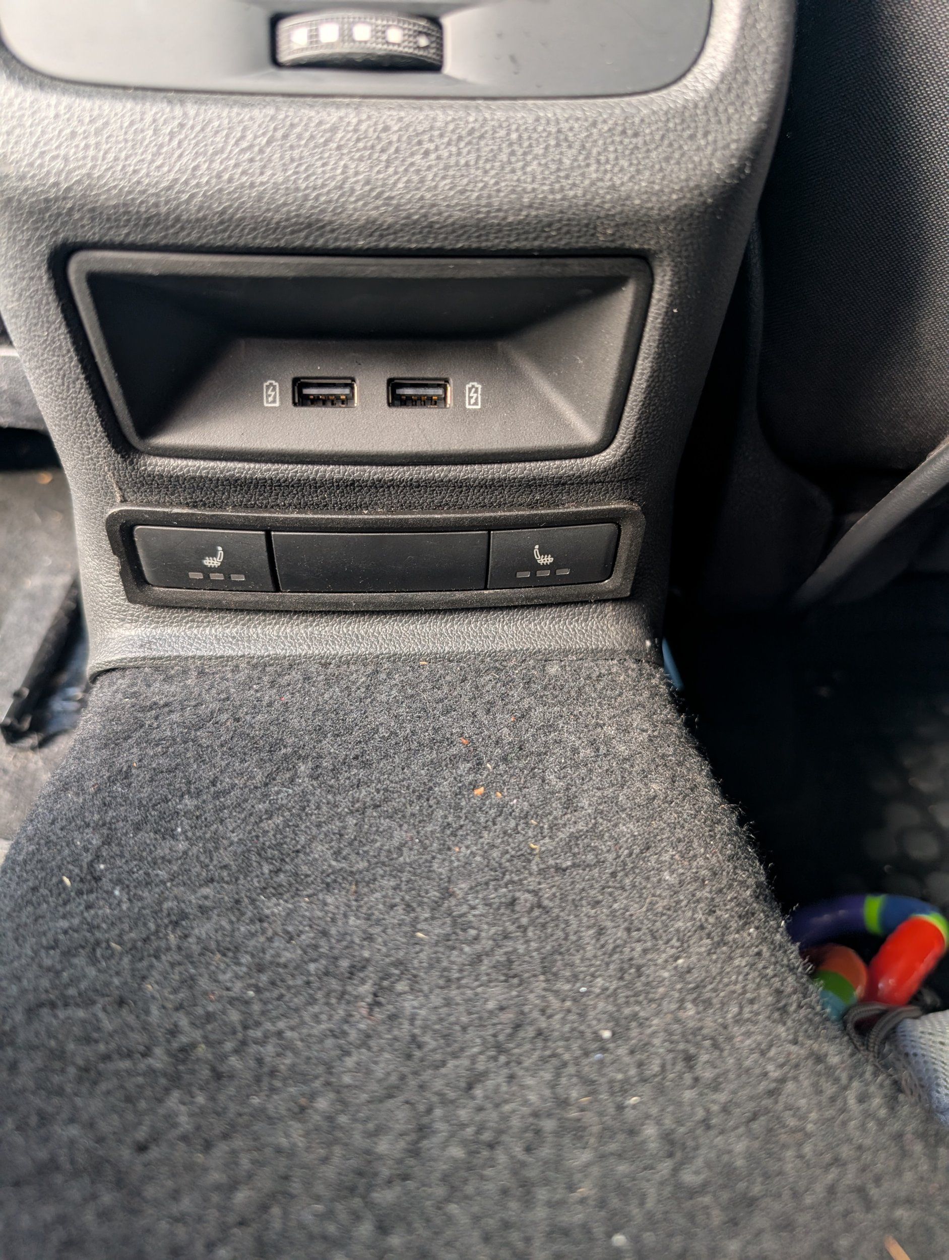

I had a little time today.
The buttons are wired and connected. The control unit is in place. All the cables on the driver's side have been pulled, and all the wires that still need to be connected are still connected.
This is what it currently looks like:

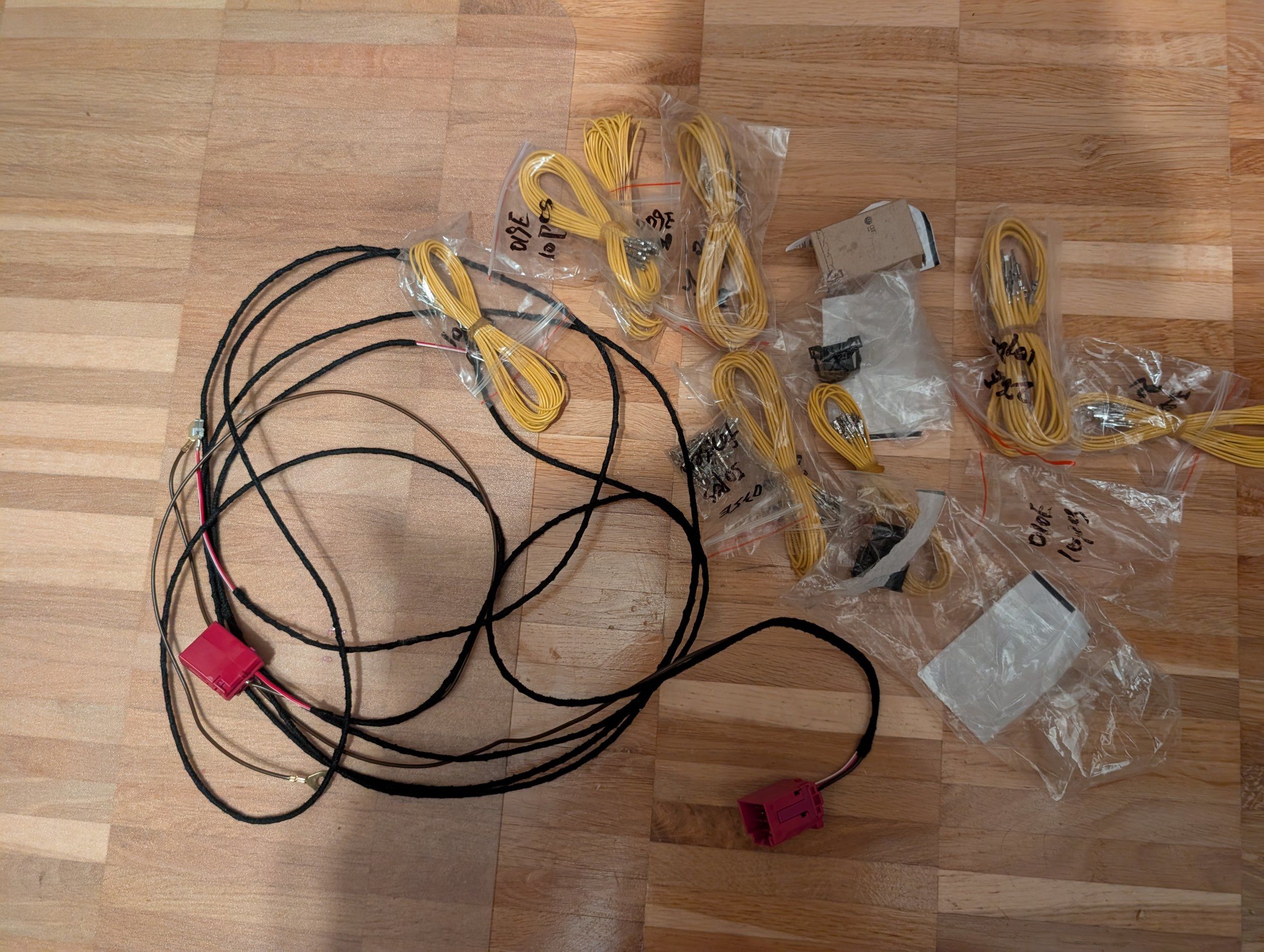

So, parts for the seat conversion have arrived again. I searched on AliExpress and recently found a retrofit wiring harness for electric seats. 17 connections with a red Audi connector. Only Supply but netter then nothing. Same as the Octavia Mk4. I also ordered a few repair cables.

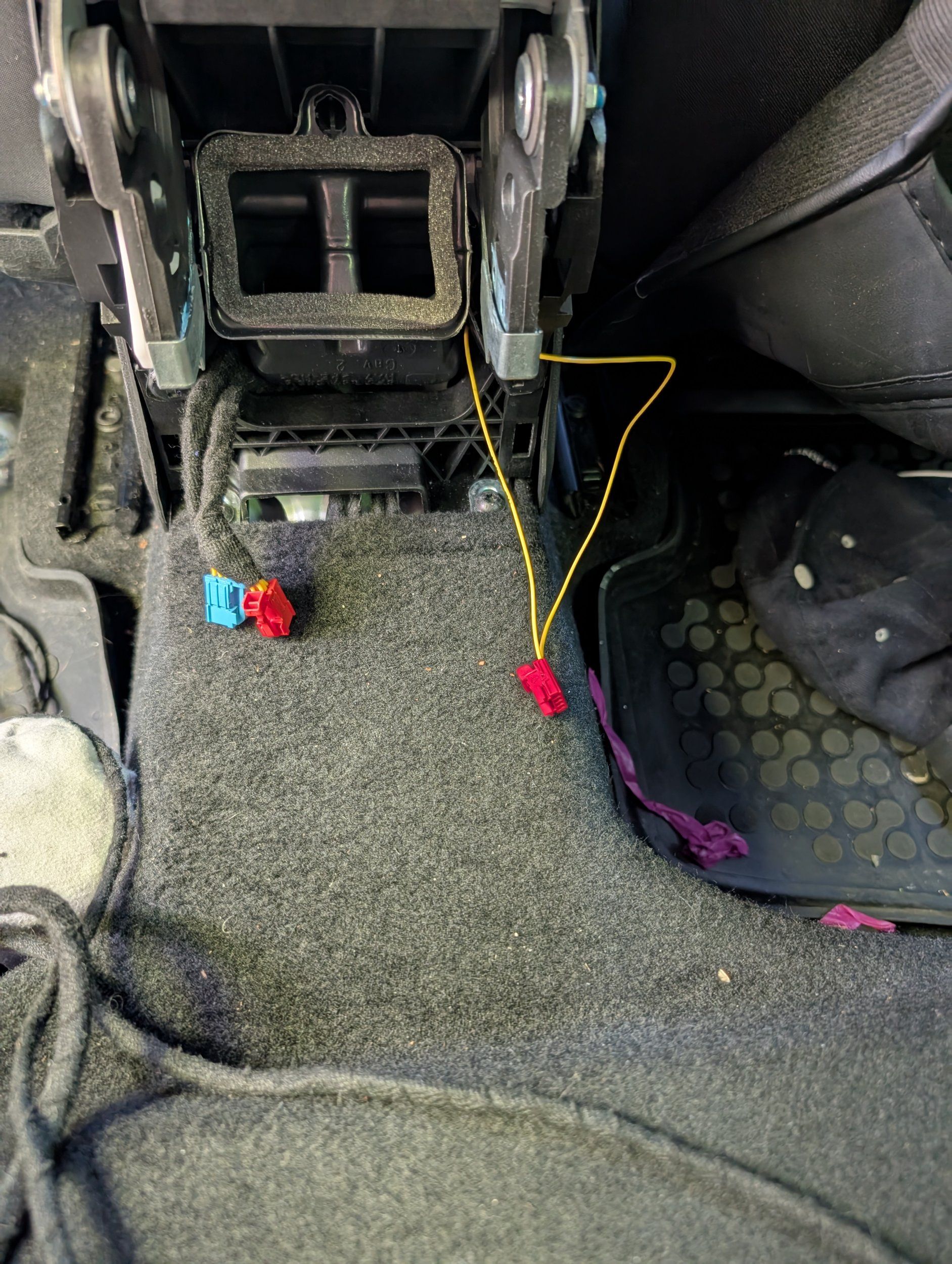

So here's some news... I pulled the cables forward. Installed the connector for the rear seat. Connected the BCM, connected terminal 58d, etc.
