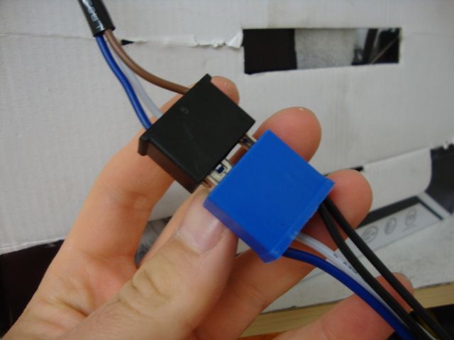

Well here's the last instalment they are finished, I decided to wire the bulbs and halo's into the OE connector do there are no wires coming out of the back of the light unit so it looks totally OE I will have to mod the wiring that plugs into the lights a bit though.
I bought some silicon wiring to match the bulbs wiring and some connectors that fit the OE wiring plug, to do this you need some tools to remove the small connectors in the plug, (I get all my wiring parts from Vehicle wiring products in Ilkeston in Derbyshire, they are top people and if ordered before 1pm they order will come next day)
You remove the OE wiring for the main and dipped beams, and wire in the live and earth wires for the bulbs and fit a connector on the end then cut the connector of the end of the wire going to the bulb and replace it with the other half of the new connector, this just makes it a lot easier to replace the bulb.
You also need to connect all the Earth’s together. You then connect the side light wire to the wiring for the halo starters, I connected the wires on the starters together to make it just one live and one earth, (like a daisy chain) (If you are only doing the dipped beam this is what you have anyway) When you have finished you should have something that looks like the picture below.

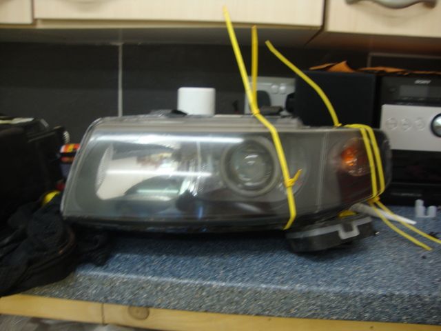

The last thing you need to do is seal the fronts back on, i used tiger seal, you will need to keep some pressure on the two halves to make sure the seal is good and water cant get in i used good old gaffer tape, i have put some paper between the lense and the tape as i have had a problem with the adhesive on the masking tape marking the lenses, so wasn't taking any chances.

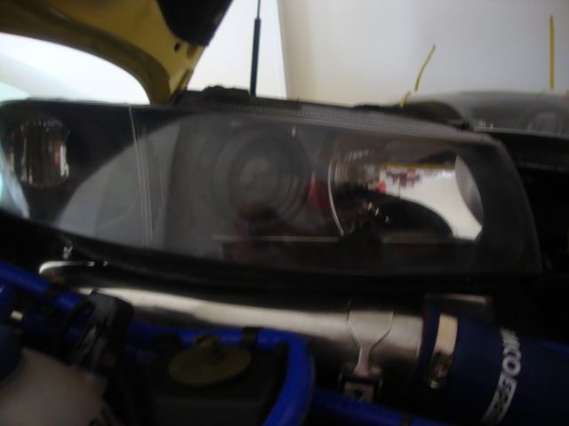

As it looks now.

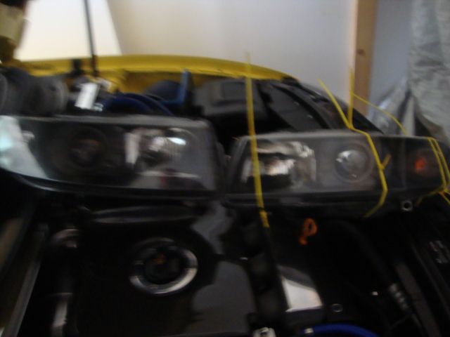

Well ive had a go at this there still not finished , I need to dress up the lights a bit put there getting there
heres some pics , sorry about the quality of the pics my workspace was a mess
As for the wiring im stumped to were these wires connect to
to work the bi xenons do you need to just wire these to one light on the control box on the loom ?
cheers for looking
You neeed to wire them into the loom.
cheers Phill ,so do i need to just wire these into the passenger side headlight , tbh the instructions are confusing me alittle
sorry to bug you but the 2 black wires and the white and blue do the black go to earth and blue and white go to the main beam
