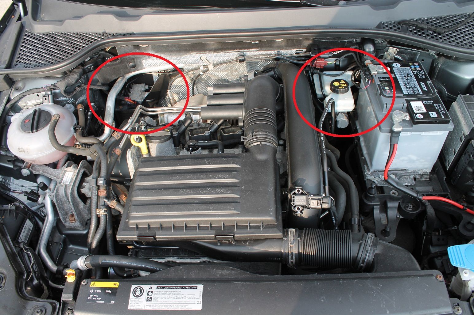

I think usually the ABS module would stay in the same place, with only the master cylinder moving depending on driving position.
If the master cyl is on the opposite side of the car to the ABS module you'll have 2x additional long pipe runs across the engine bay.
Also modern cars with traction control can have dedicated 4 channel ABS modules so you have 4x separate lines from the ABS module to each caliper. Older cars with 3 or 2 channel ABS would share pipe and split near the axle again changing the fluid volume.

I did buy another cheapie made in China vacuum brake fluid bleeder that comes with an "auto top up bottle" - I have fitted an old Gunsons "VAG" sized metal reservoir cap to it and will buy/use a 1/4" BSP fitting to adjust the existing fitting length to suit my VAG cars. I found that while it will fit my 2011 Audi S4 perfectly as the space above the brake fluid reservoir is unrestricted, on my wife's 2015 VW Polo 1.2TSI, the area near and above the brake fluid reservoir is restricted, but I found that by removing the bracketry for supporting the 2 Lambda probes - one plastic nut and pull off a grooved/threaded body mounted stud, I can create a space so that the bottle can be screwed onto the brake fluid reservoir. That kit comes with 4 tripod sort of adaptors to allow the bottle to sit in/on the brake fluid reservoir and be adjusted so that the correct final fluid "height" is kept at all times including after the job has been completed.
