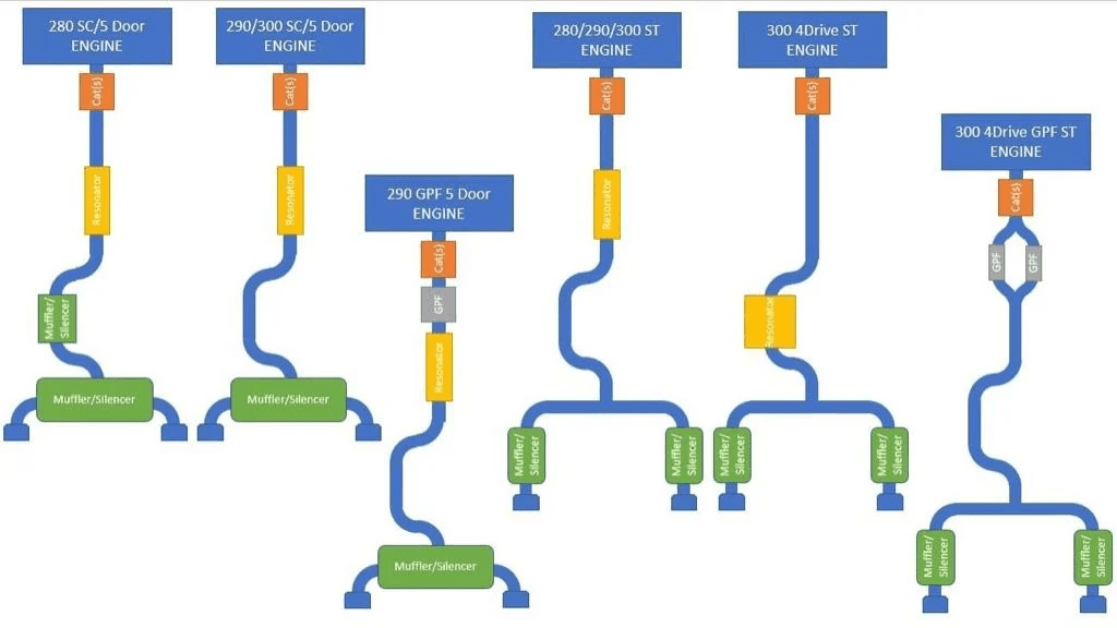

@DamoH put up a great diagram outlining the various exhausts on Cupra’s -
Might help with understanding which exhaust set up you have - it helped me 😝

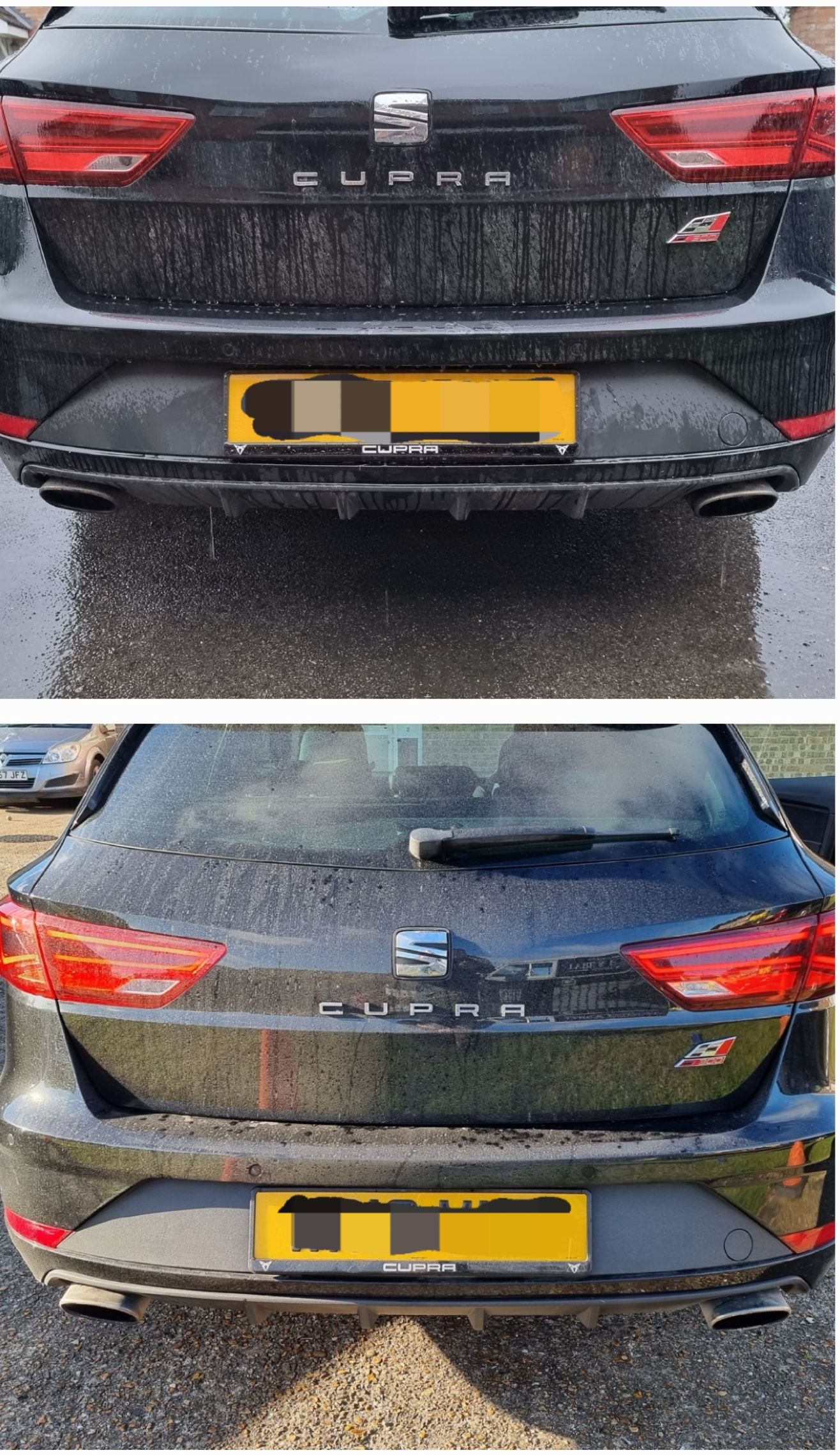

VAGSport Res delete fitted today! Was a little concerned initially that it didn't sound any different from the inside (even in Cupra mode with sound actuator turned down), however outside of the car it sounds sooooo much better! No drone at all. Very pleased.
I did notice however that as a result the exhaust tips are sticking out a good inch or two more now. Undecided if this looks better or not..... 🤔 (Excuse the dirt!)
