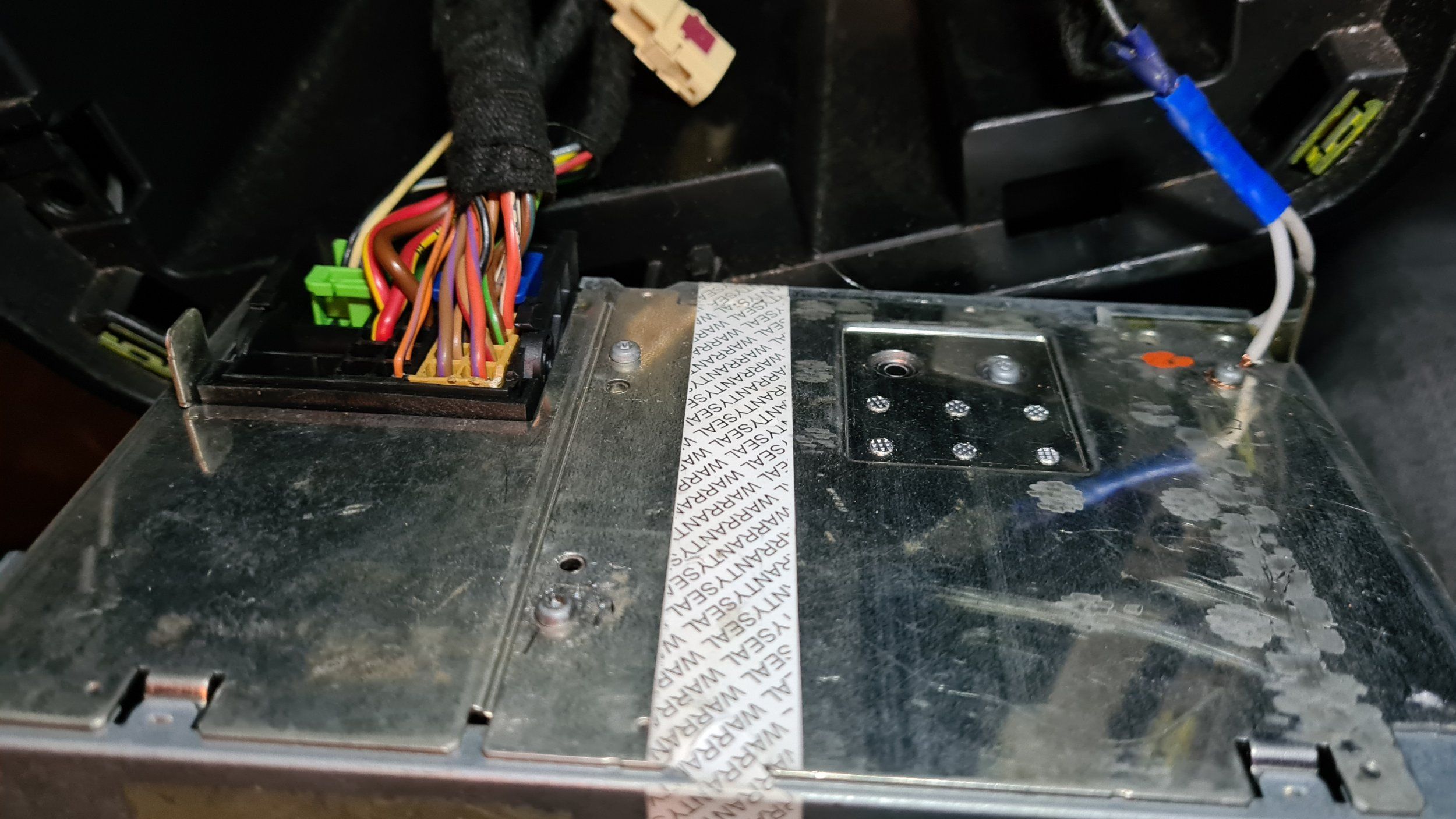

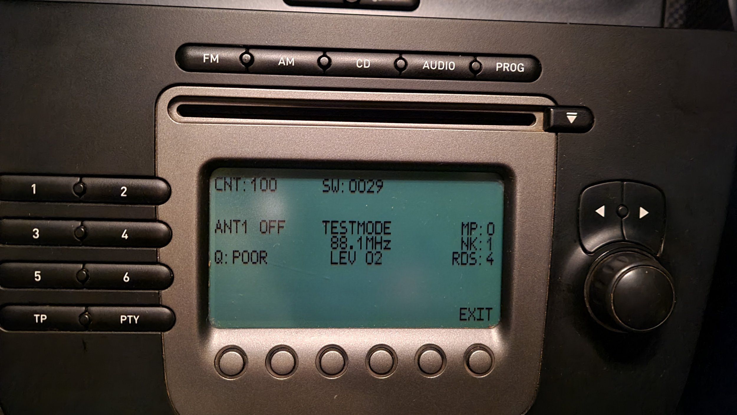

The radio diagnostic menu shows Ant1 Off.

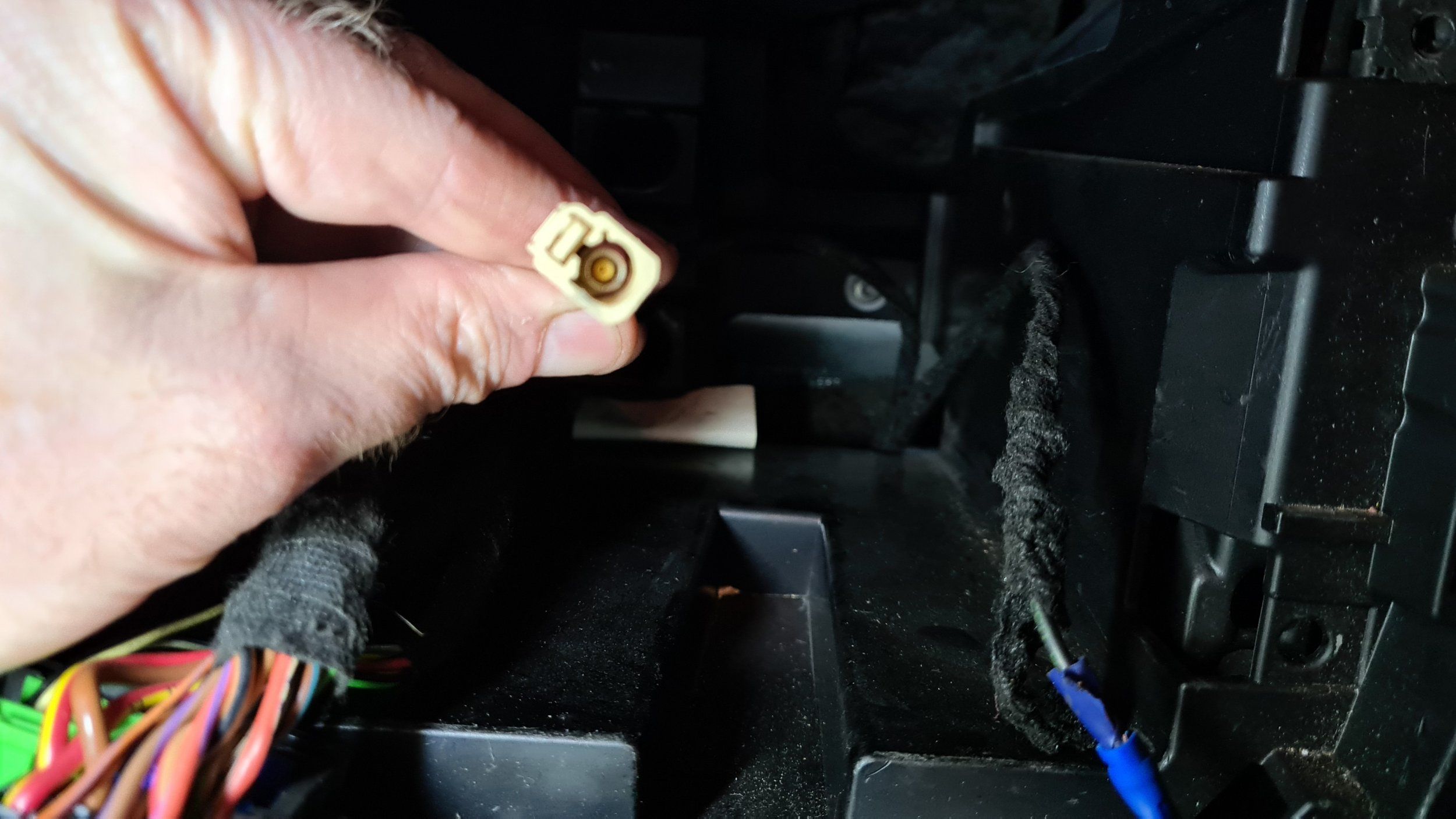

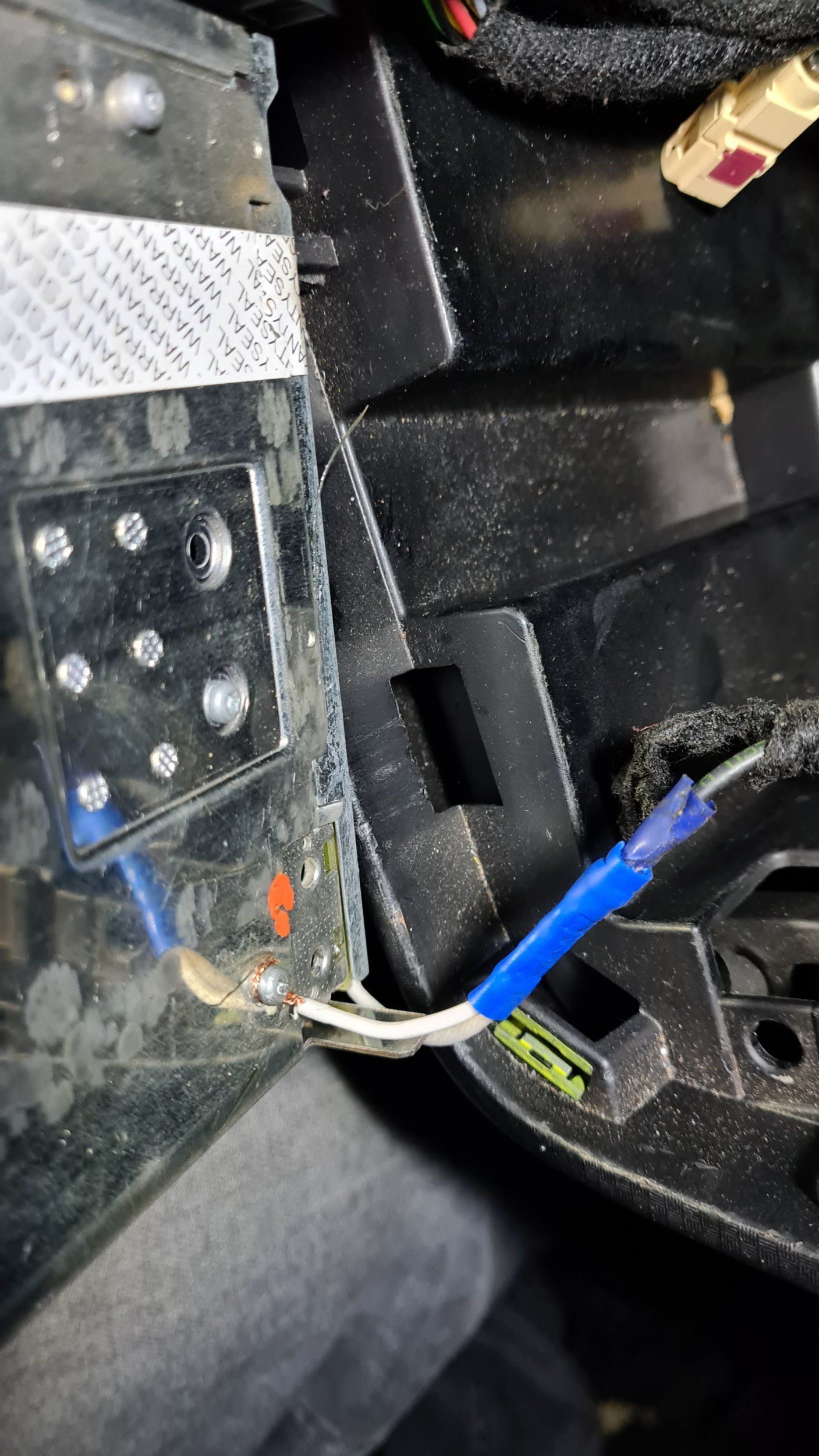

So today I pulled the radio out and found someone has cut into the aerial wire and spliced it in.
The plug that goes into the back of the radio is removed and also the port on the back of the radio appears missing.
I've added some pictures.
Any ideas how I can fix this?
