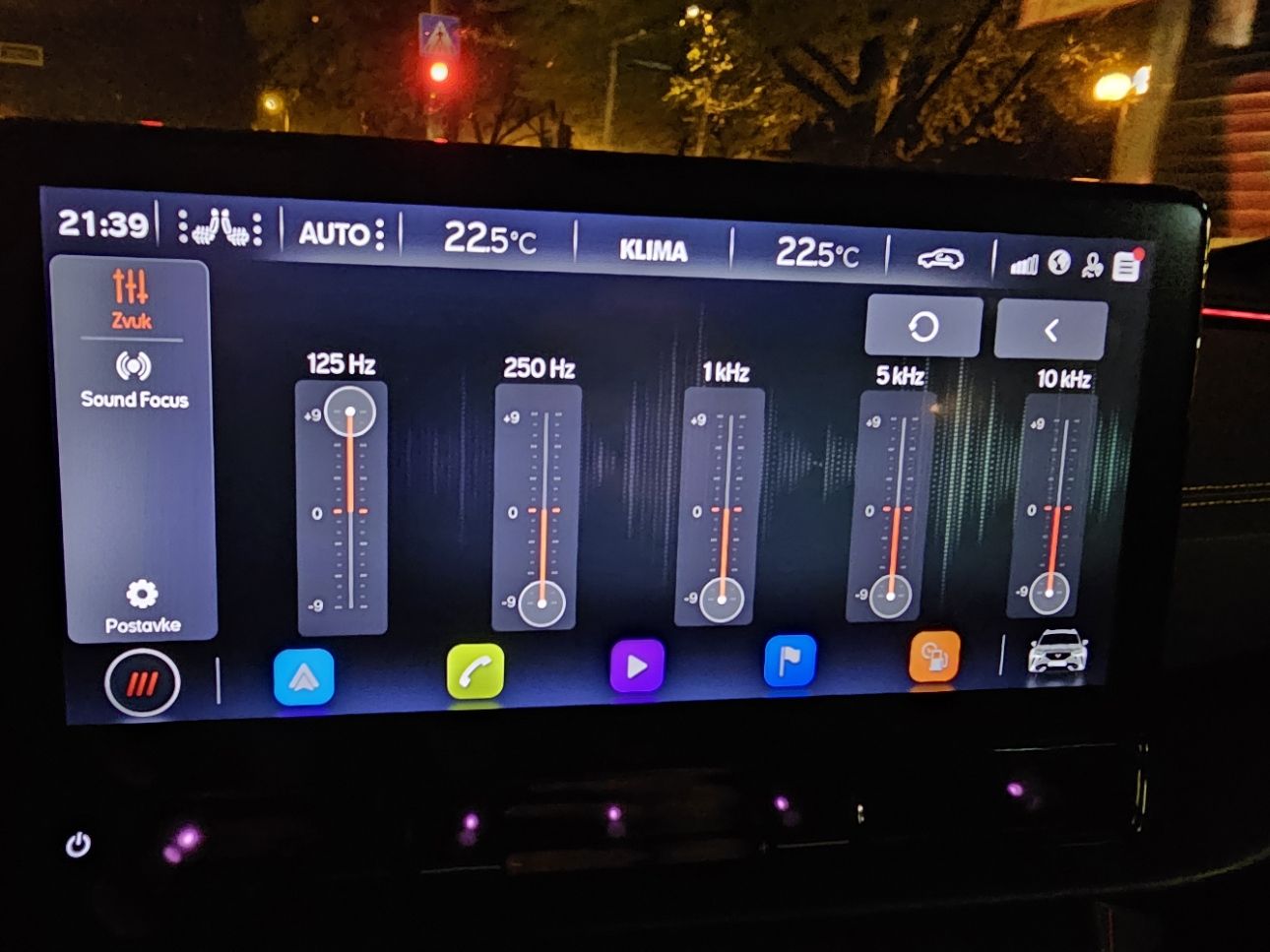

1) Used custom sound settings and changed them to following
2) Played from Deezer song "Let's Get Down To Business" (it has great bass. Every time you need bass sample just play first few seconds).
3) Used "Sound focus" to target desired doors
By using this I have found that I get rattling sound from both front doors and rear left door, although while driving it seems to me that I hear only rear left doors.

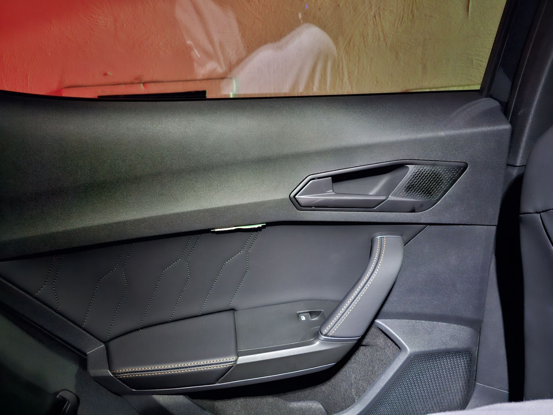

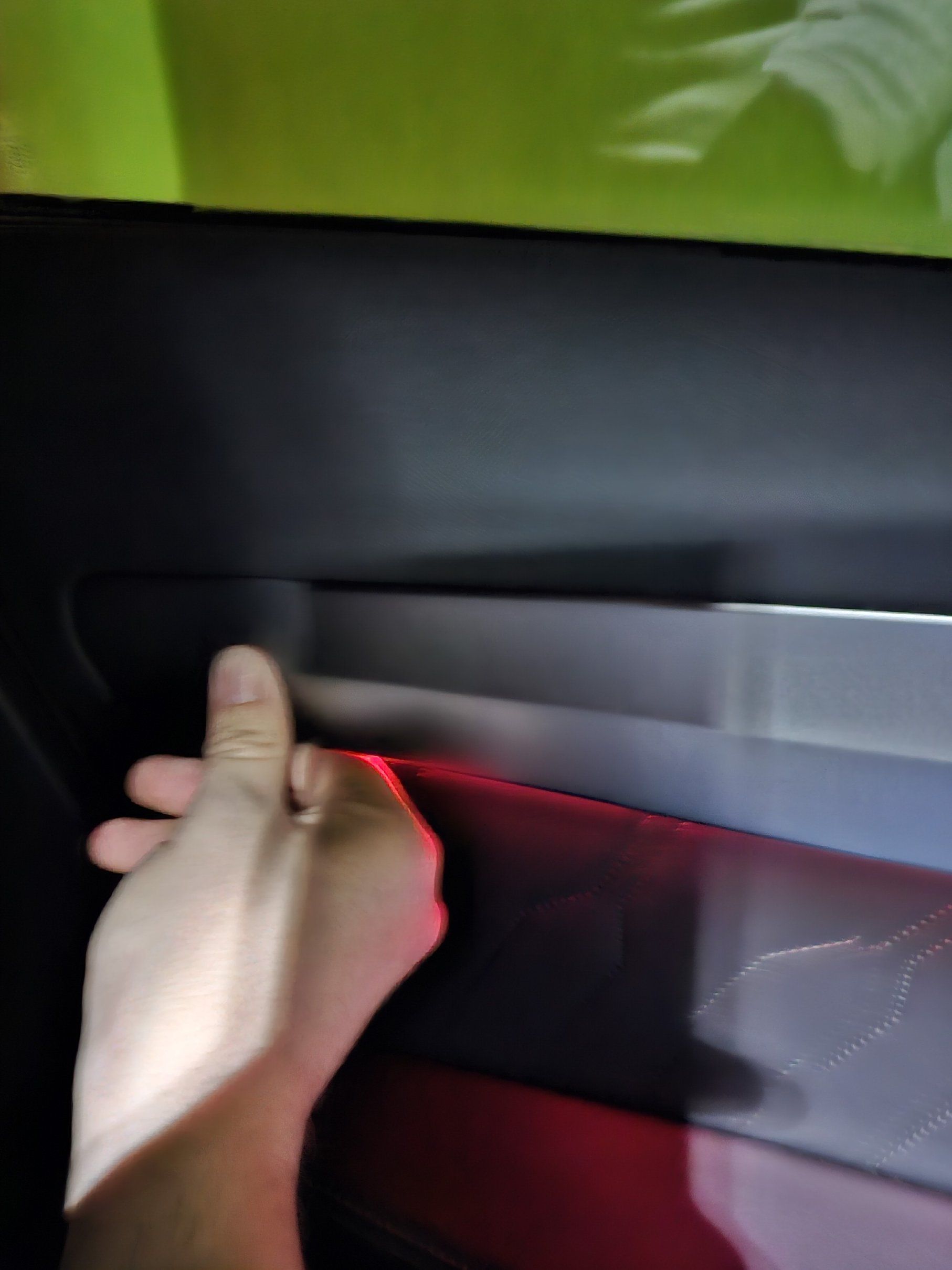

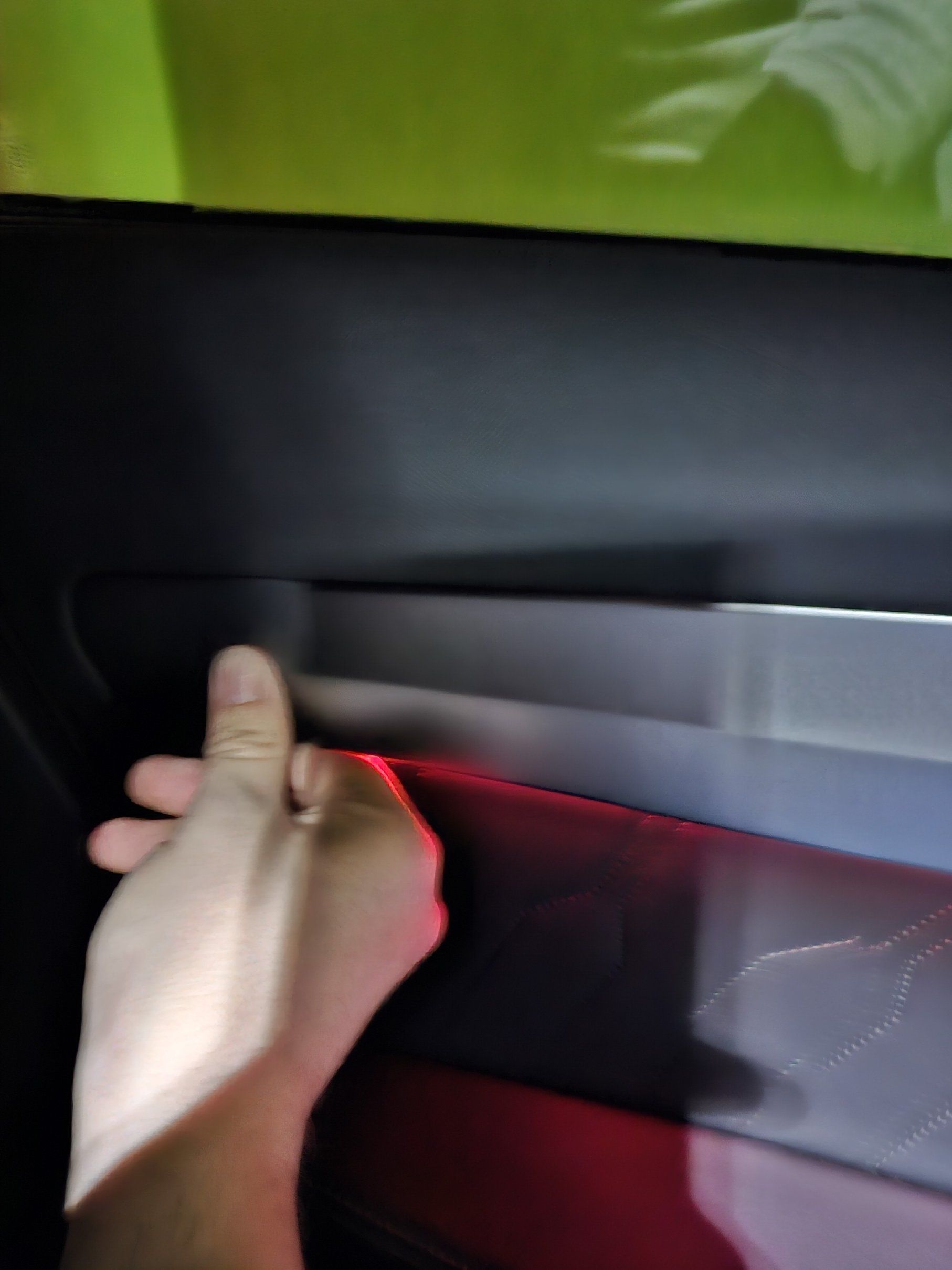

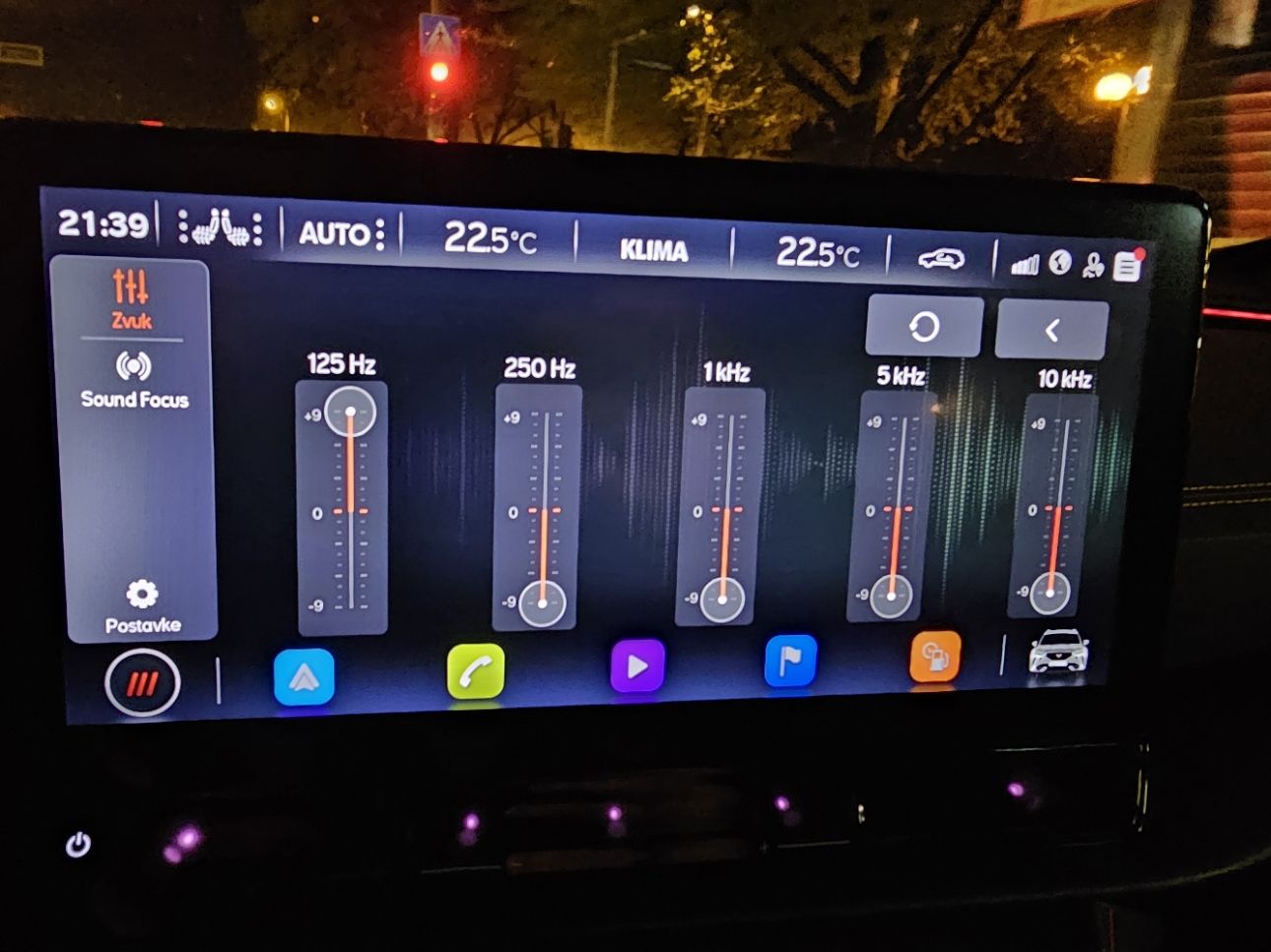

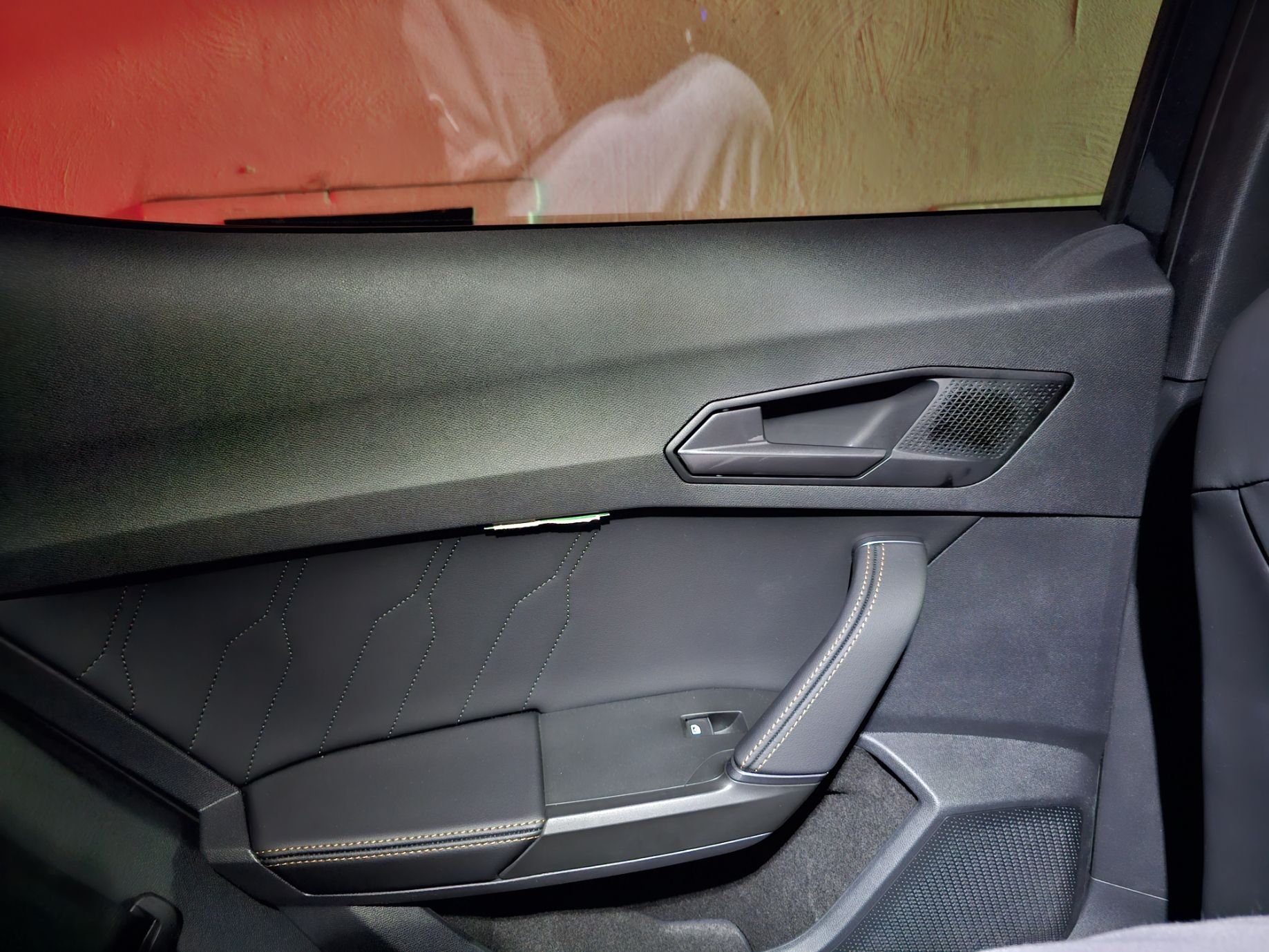

On both front doors rattling sound stops when I push in area on picture bellow (it stops also when I pull towards myself). Placing cardboard didn't helped. It seems like only option is to put some sound isolation bellow that plastic with LED (between that plastic and door interior).
On rear left door I isolated rattling sound on place where you can see cardboard on picture bellow. On these doors placing cardboard eliminated sound and I currently don't hear it while driving (although I need few more days to verify that).
