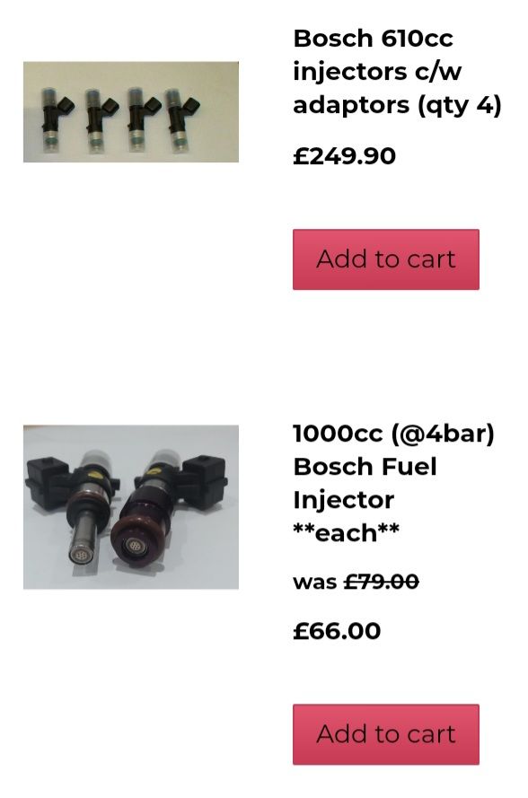

Could i run bigger capacity injectors?
A- to eak out a few extra hp
B- so when its tuned the injectors arnt running flat out.
They sell these so could ask them to fit a set whilst they have the car.
Any opinions?

As for injectors you need to decide what the end goal is but if it's just to facilitate a remap then 550cc injectors will be more than sufficient.

Badger 5 mapped my car last year. 282bhp with standard injectors although he did tell me they were maxxed out. Fuel pump seemed happy too. Depends on how deep your pockets are. I’d be inclined to stick with what you have and see how mapping goes. It’s easy to spend money on stuff you might not necessarily need.
