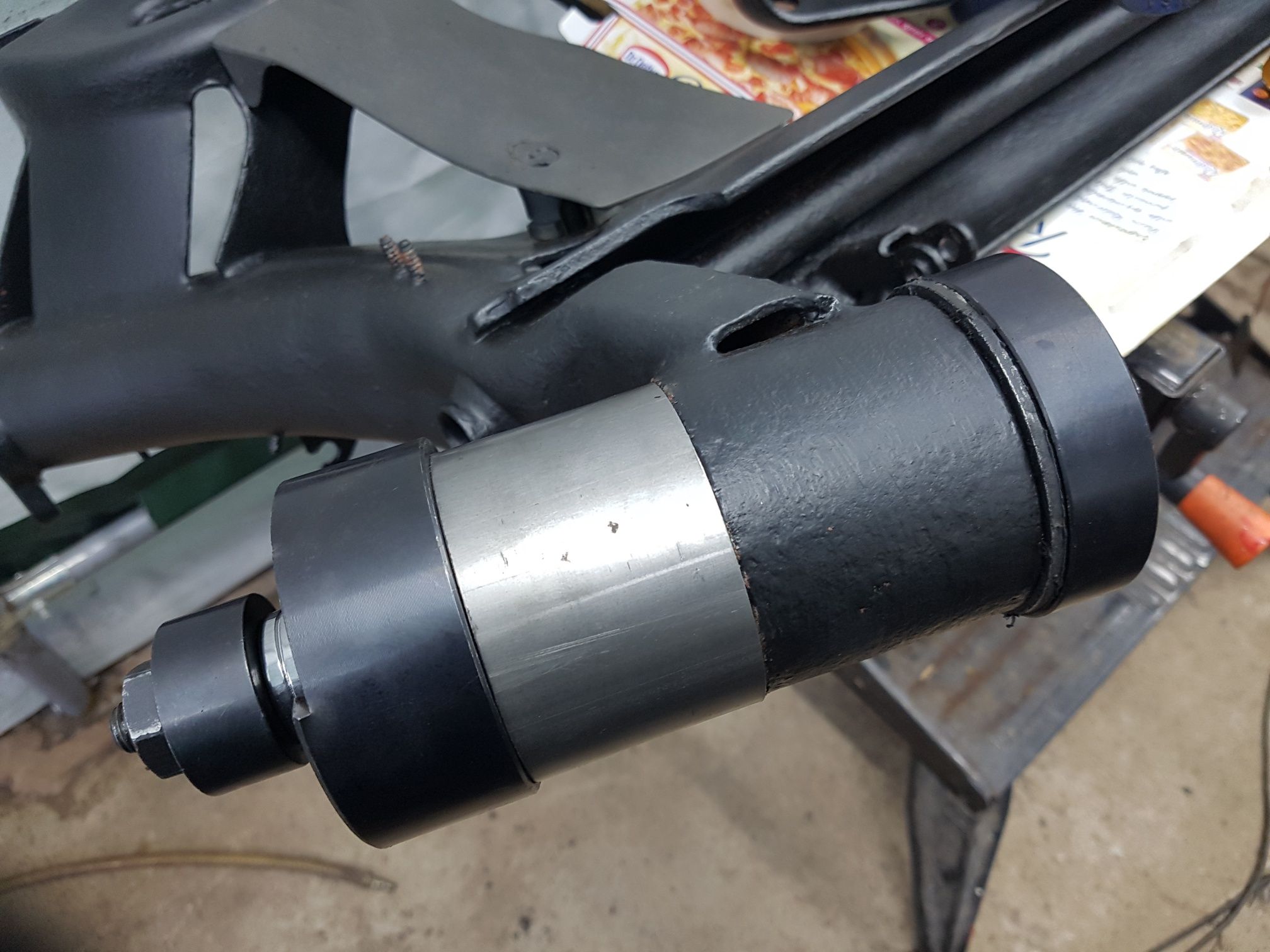

Hi again, moved on to the rear beam bushes now after getting everything stripped down and painted.
Not sure about the fitment of the bushes I got - all the 69mm diameter ones availible seem to be like the ones I bought, but info/videos I've seen seem to all be 72mm which look a bit different, I'm assuming 69mm are the correct ones as even these have been a bugger to get in:

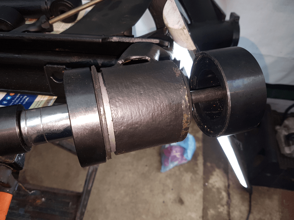

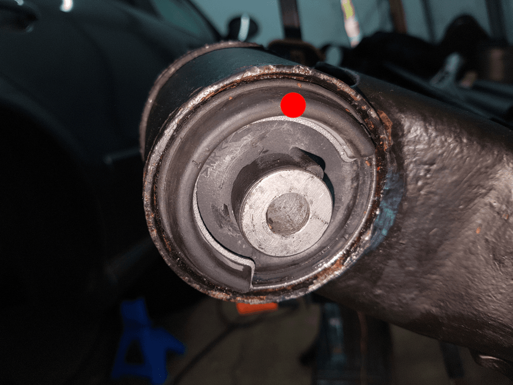

This bit with the red dot is not on the bushes I've seen installed. So as I am compressing the bush in, it bottoms out and this is what I end up with - ~5mm gap:

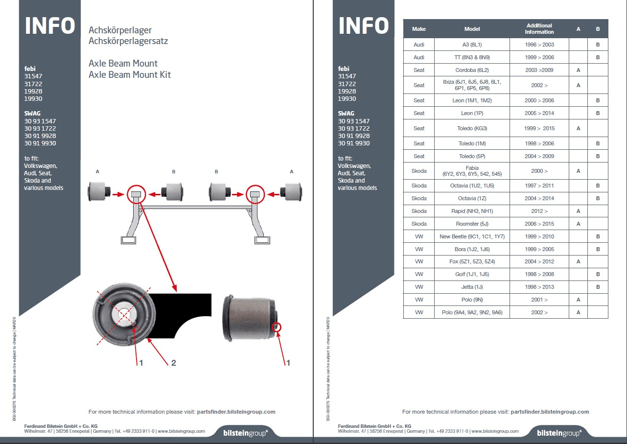

This is the info for the bushes I got:
They came as a set but are both identical. If I line up the nib (1) with the bottom weld for both sides, the orientation the rubber bit (red dot) will be different position, is this correct?
I can get a bit of 70mm ID pipe and push the bush in all the way but now wondering if its meant to be like this with a gap.
Wanted to get some help before I go any further as getting the bush back out will be fun if I need different bushes.

Just an update in case it helps anyone in the future, I bought a sample piece of 76mm OD 2mm wall pipe off ebay and it worked a treat to get the bushes in the last 5mm.
The beam went back in far easier than i was expecting, lined up perfect.

Something I found when I did mine was that there's a narrower section that sticks out the other end that can sometimes get squashed if you're putting bushes in yourself and you don't have a proper press. More than one person here experienced that I think.
Size wise though, I used ones that were advertised as being bigger than my rear beam was listed as being, and they fitted fine. I think they're all the same size, given the rear beam is the same, I think.

Good to know they are probably the same diameter whether is says 69mm or 72mm but glad that jobs out the way. Having the right tool proved to be key again as i was scratting around initially for washers/hole saws/washers and such which where just bending with the pressure. My bushes had advisory for 2 years and they failed on the 3rd year :ROFLMAO: so looking forward to better handling for sure, especially as by the time ive finished all the suspension/steering bits will be new.
