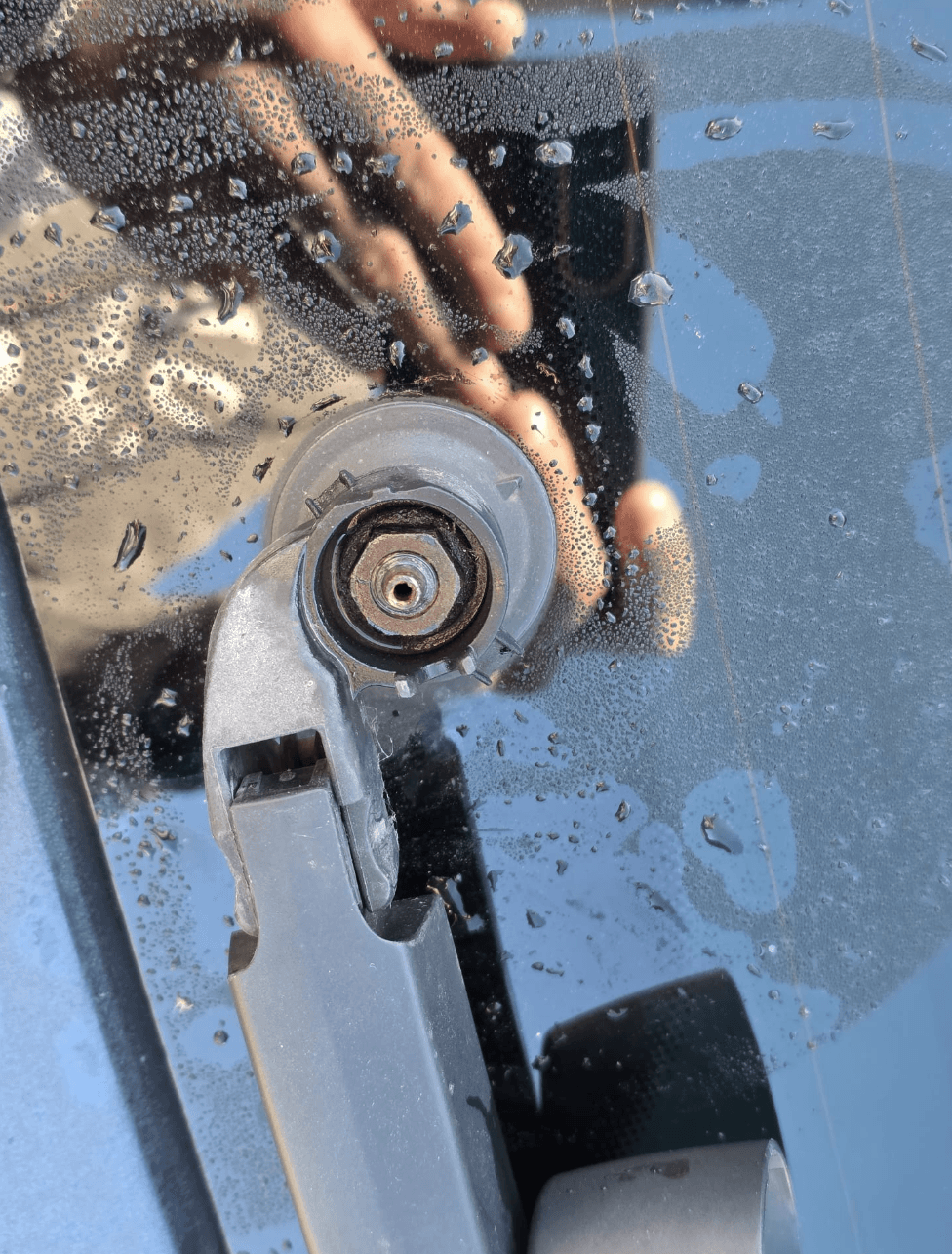

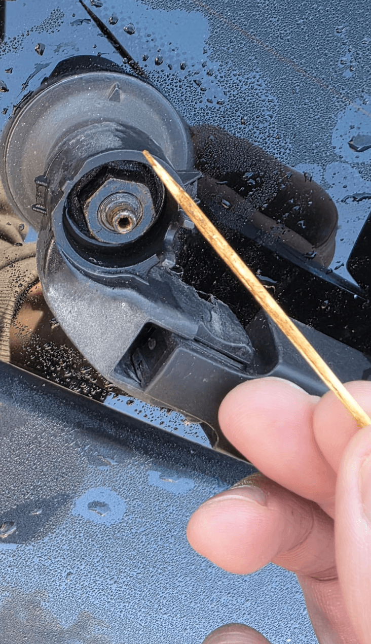

I think mine is totally clogged, but not just from the nozzle but possibly throughout the whole tubes. I've put a tooth pick into it, pretty deeply, first attempt it was like soft jelly.
These are photos are from second attempt with a clean toothpick. Ive not been able to get water to come out of it without the nozzle so I believe its a deeper issue. The front spray works perfectly fine, but when attempting to use the rear ones, I do hear the sounds from the car bonnet but no spray from the rear without the nozzle attached.

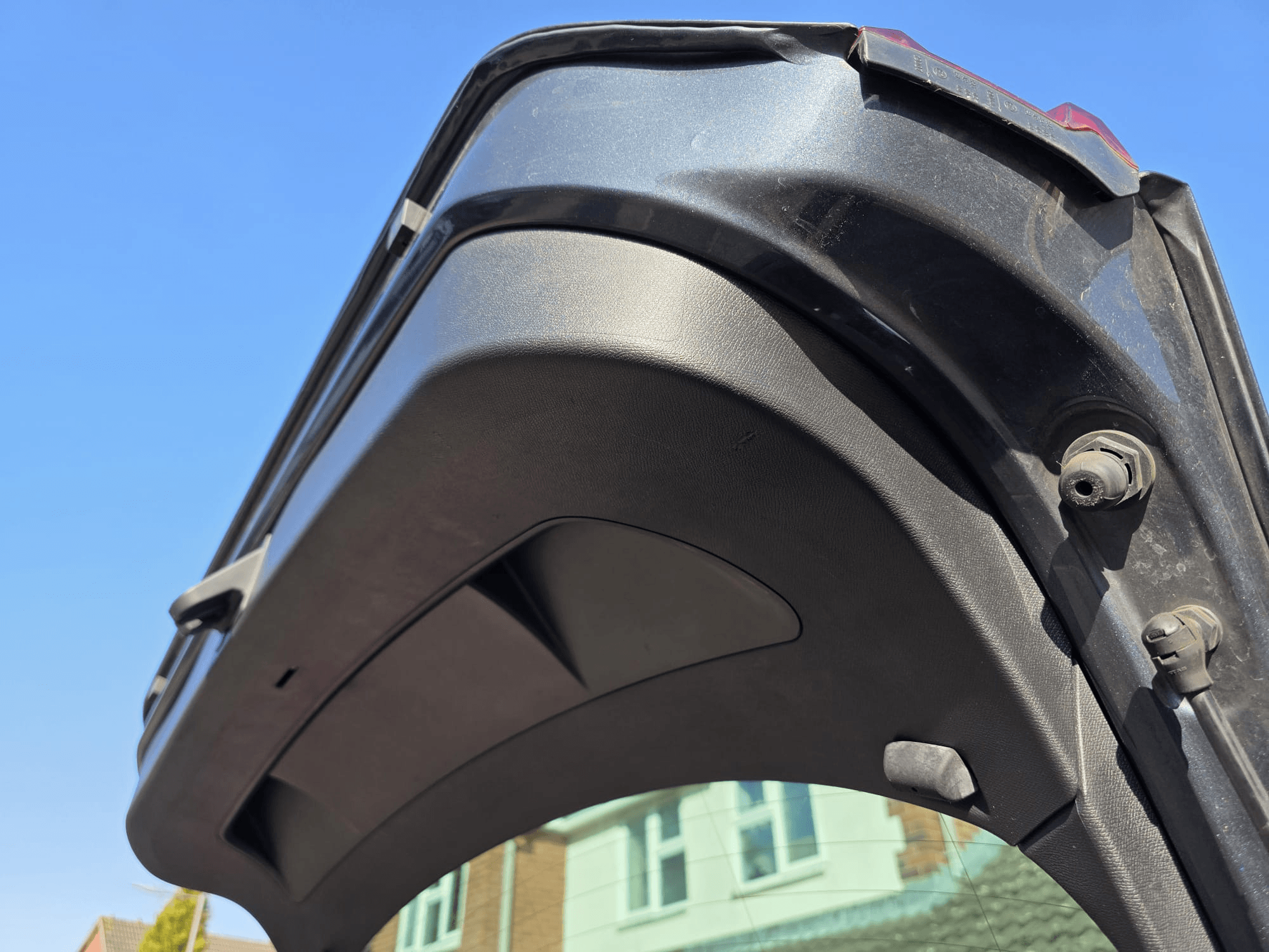

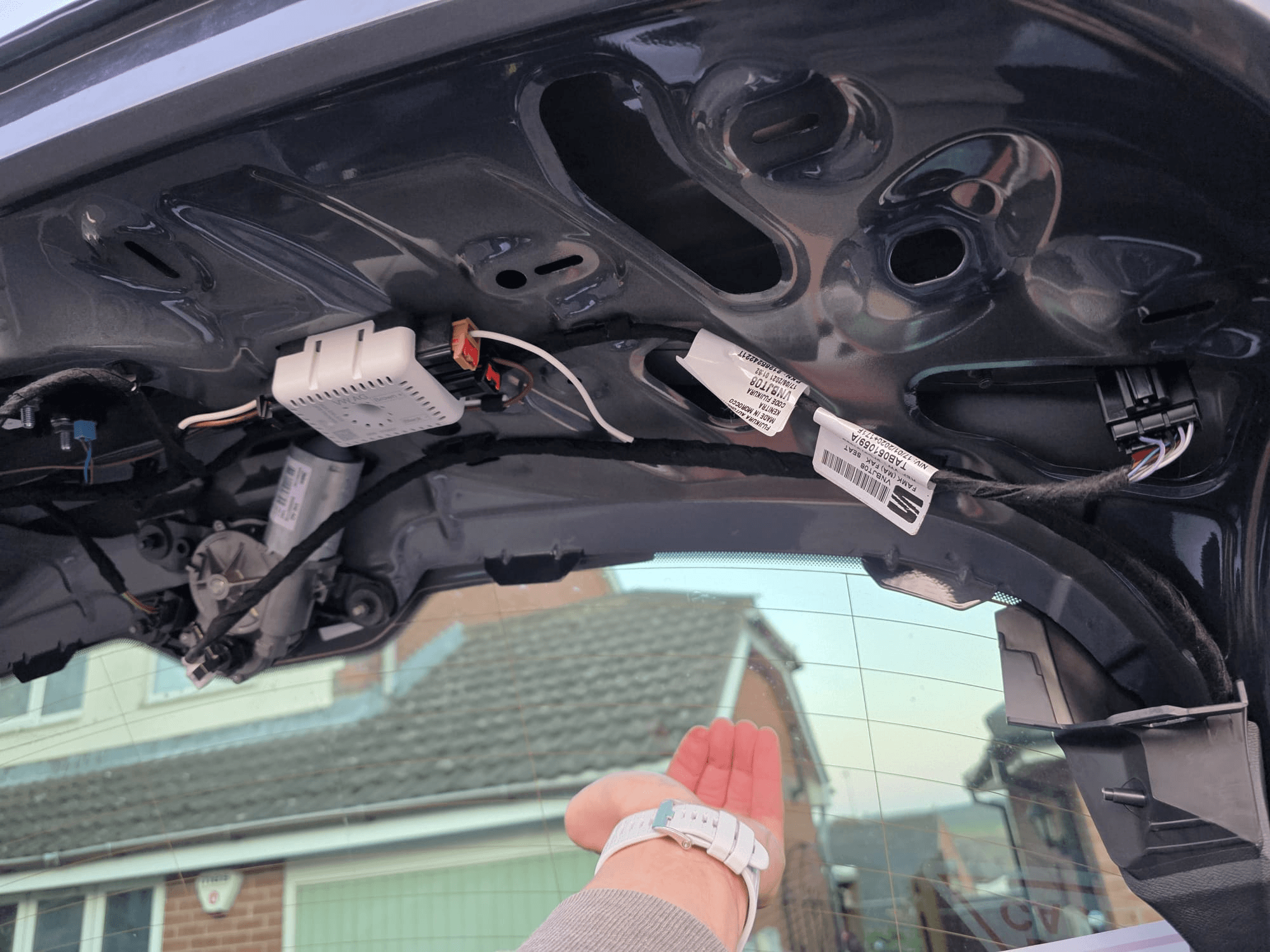

I'm not too sure where to start in terms of removing the plastic trim as I didn't want to use too much force incase I'll pull any cables away. Doesn't seem to be much give.
all good, just had to use more assertive force (little had after rotator cuff injury) around this initial area, then it pops off:
luckily disconnecting the tube here and letting it spray unhindered through the pump fixed it:}
