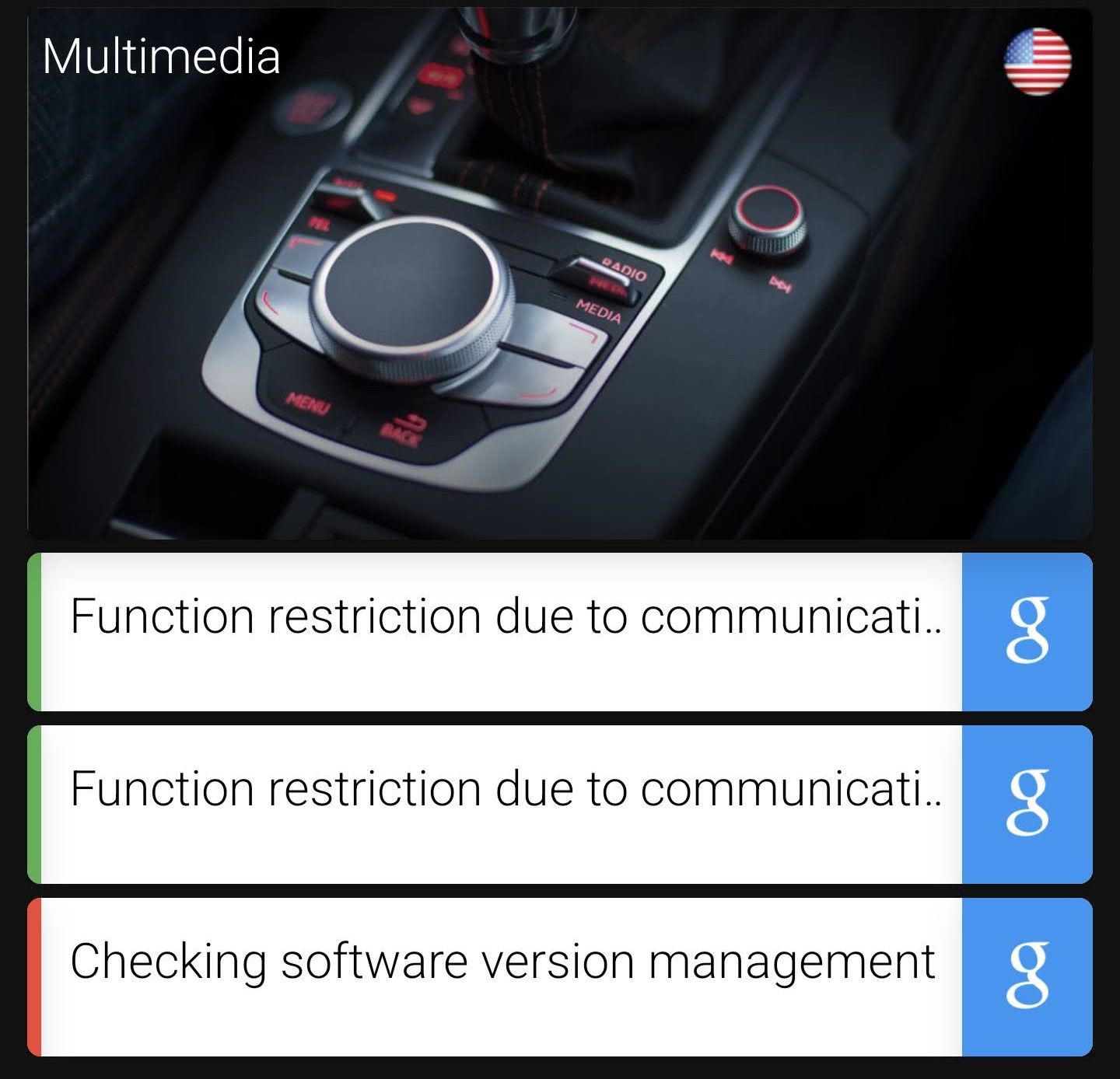

Keep in mind when you do update yourself the 5F unit will store an error code that needs to be deleted if your car is under warranty. Presumably, a dealer can decline the warranty claim for the unit if code found?
