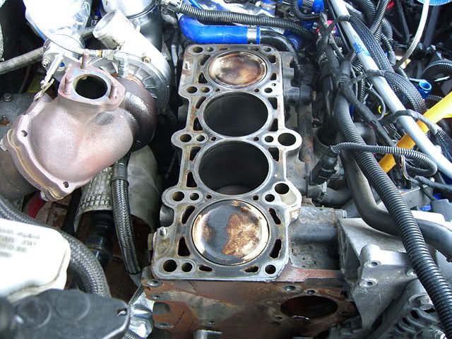

I got the head off today, here's some pics:
http://i312.photobucket.com/albums/ll330/SonicBlueLeon/hd1.jpg
http://i312.photobucket.com/albums/ll330/SonicBlueLeon/hd2.jpg

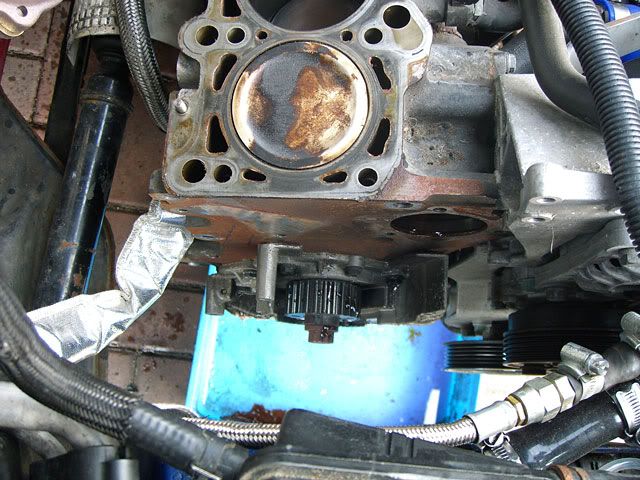

Check out cylinder No.4!

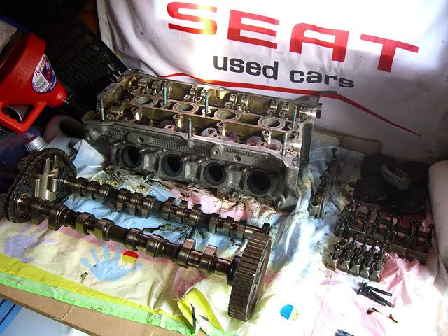

Head disassembled ready for exchange:

Well at least you have found positive signs of a problem.
Nothing worse than removing everything and not finding anything.
Seems like the right idea to do the rods as well. Alot of extra cost but once its done, its done
Yes indeed, definately alot of oil coming through on No.4 and signs of slight leaks on No.1 and 3 as well. With the amount of work required to get the head off, doing the sump etc. will actually be pretty easy - the timing belt area is just a total nightmare to work on!

Cylinder 4 is pretty shitty isnt it. lol.

Hmmmm yeah no. 4 deffo looks like the issue lol!
