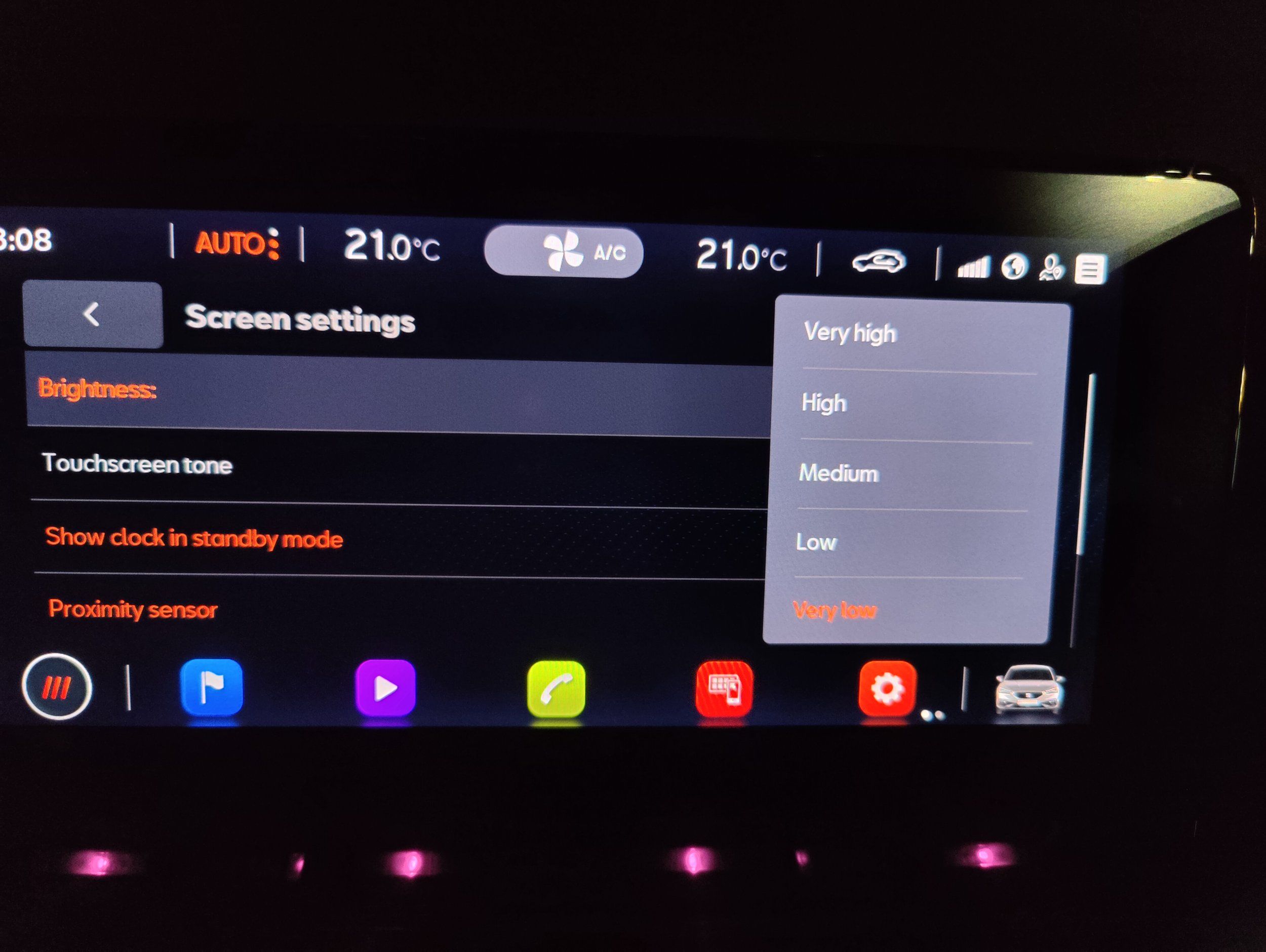

Hi, driving the car at night. When using car play the screen on Waze maps is at full brightness.
Does anyone know if it’s possible to reduce the brightnes and if so what’s the process?
To change the screen brightness there's 2 ways.
In the infotainment settings (gear icon with red background), you go to screen > brightness > change to low/medium/high.
You can also go to notifications(little speech bubble in top right corner) > there then a brightness slider this adjusts the brightness of the screen, digital cockpit, and illuminated buttons
