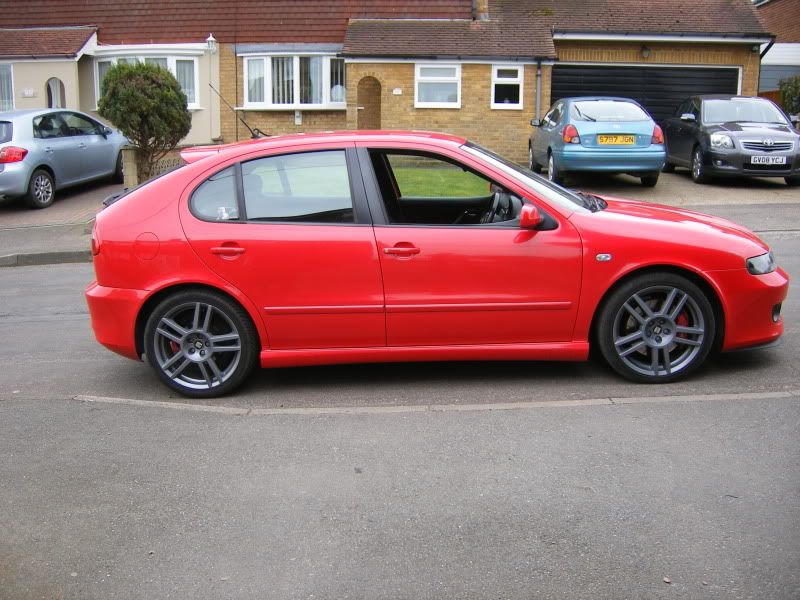

Done them in a Ford Nimbus grey
quite please with them but i still might change them again
ite mate i have a yellow leon wanna do mine need to get few scuffs out and change them from silver to a very dark grey any advice u can give me mate be appreciated cheers
what i did was use a tiny bit of filler on the deep scratches and curb damage, then i used a primer then the base coat and then laquer. on smaller scratches i used a high build primer to cover them flatted the paint panel wiped then painted them. the best way to do them is in a warm room to bake the paint, and wear a mask as the fumes are very strong
do i need to sand them down first mate if so by how much also how many tins of primer , paint and laquer
