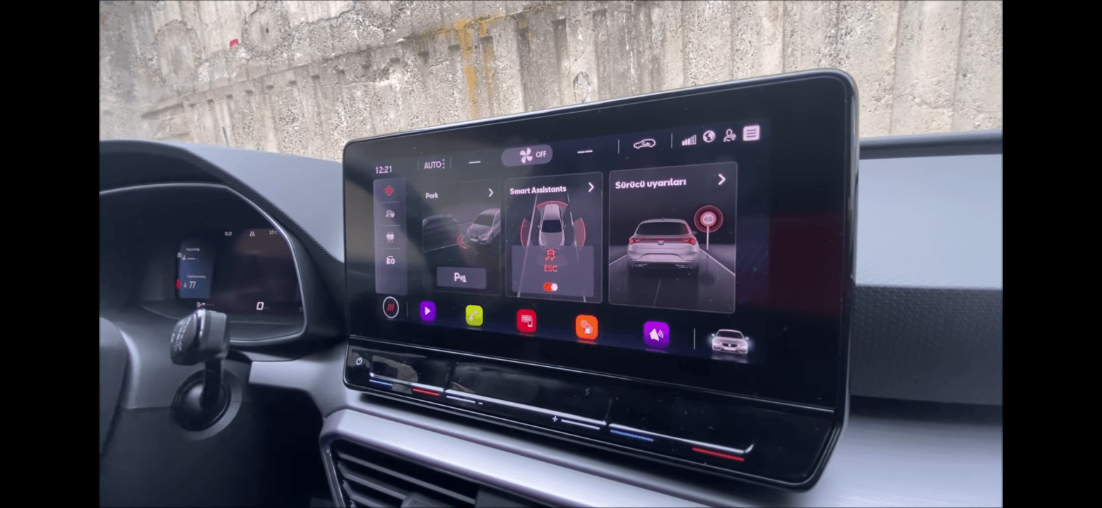

Hi everyone,
I'm from Turkey and I got a Leon FR in this week.As I understand it, Leon versions are named differently in each country. For example we have manual transmission, 1.5 TSI 130 hp, limited interior ambient light (only two color- red and white-) in FR and without navigation, full link and dashboard ambient light...
what i'm asking is;
Can i activate navigation, ambient light, full link with OBD or vagcom,etc..
Actually, I know that about is hardware. Maybe i'm wrong but I have an observation..There is tax problem in my country and maybe The topics I describe are limited by software. But İm not sure...
Do you think the problem is software or hardware?

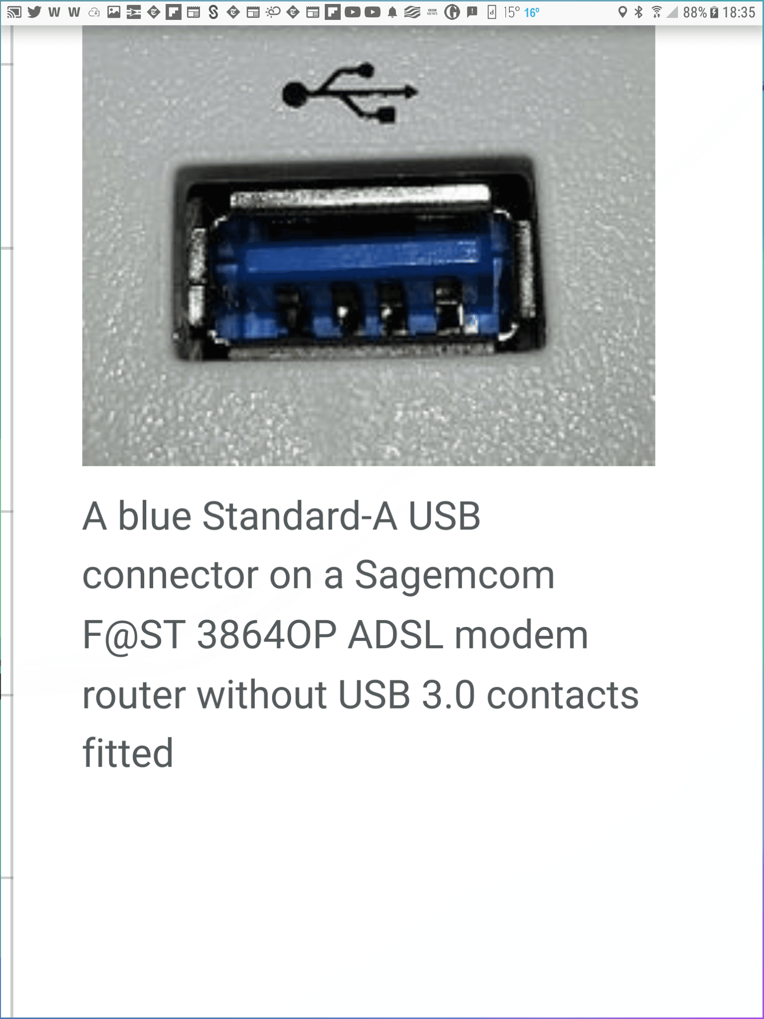

That's probably getting up to 100% no. Mib3 if it's a Leon 4 unless your USB sockets are type A, type C that's Mib3. Mib3 connected services are the order of the day. Nobody I'm sure has too much knowledge of enabling navigation on that type of hardware if navigation is built in but not enabled. Ditto full link.
Type A USB would mean a mib2 has been put in, but I doubt it.

But İm sorry I didn't quite understand what you said. Because I am not a professional in these matters. I don't know what mib3 or mib2 means :(
is it like software ? or like hardware system??

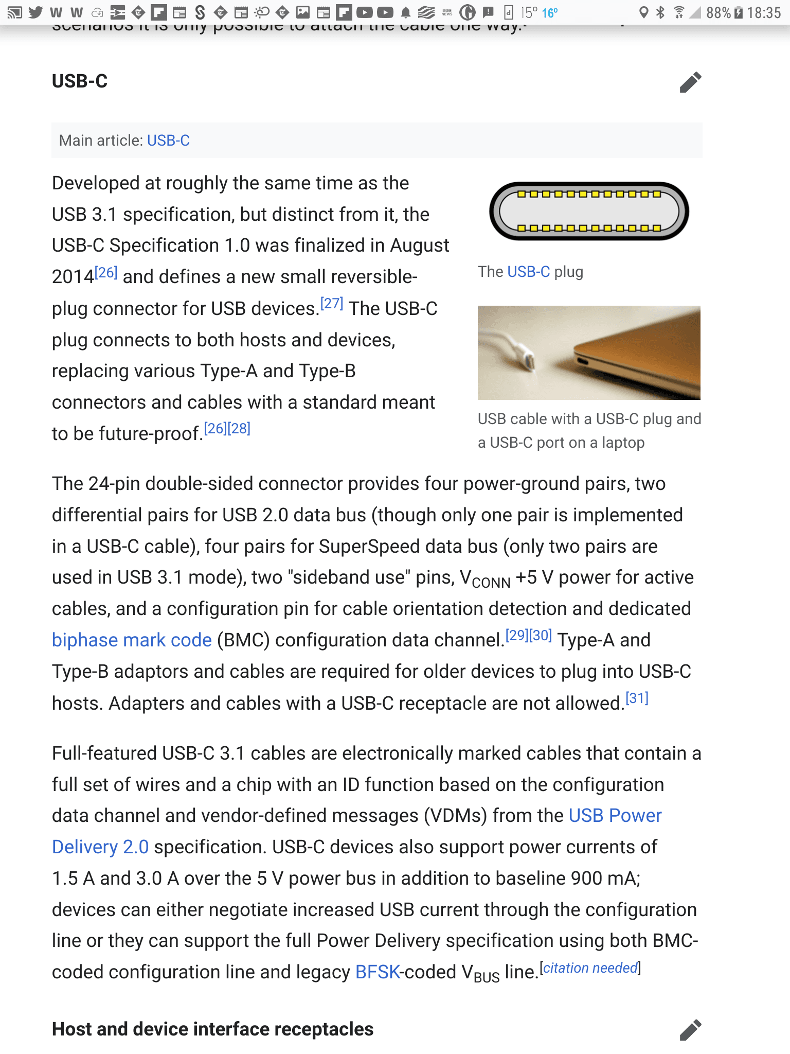

And whats the mean of USB type A or C?
if you are talking about USB type in console, its type C but i'm not sure you're talking about :((

Mib3 all navigation maps held on an SSD. Updated by connected services over the air and offline via USB-C. That is an oval connection - see diagram.

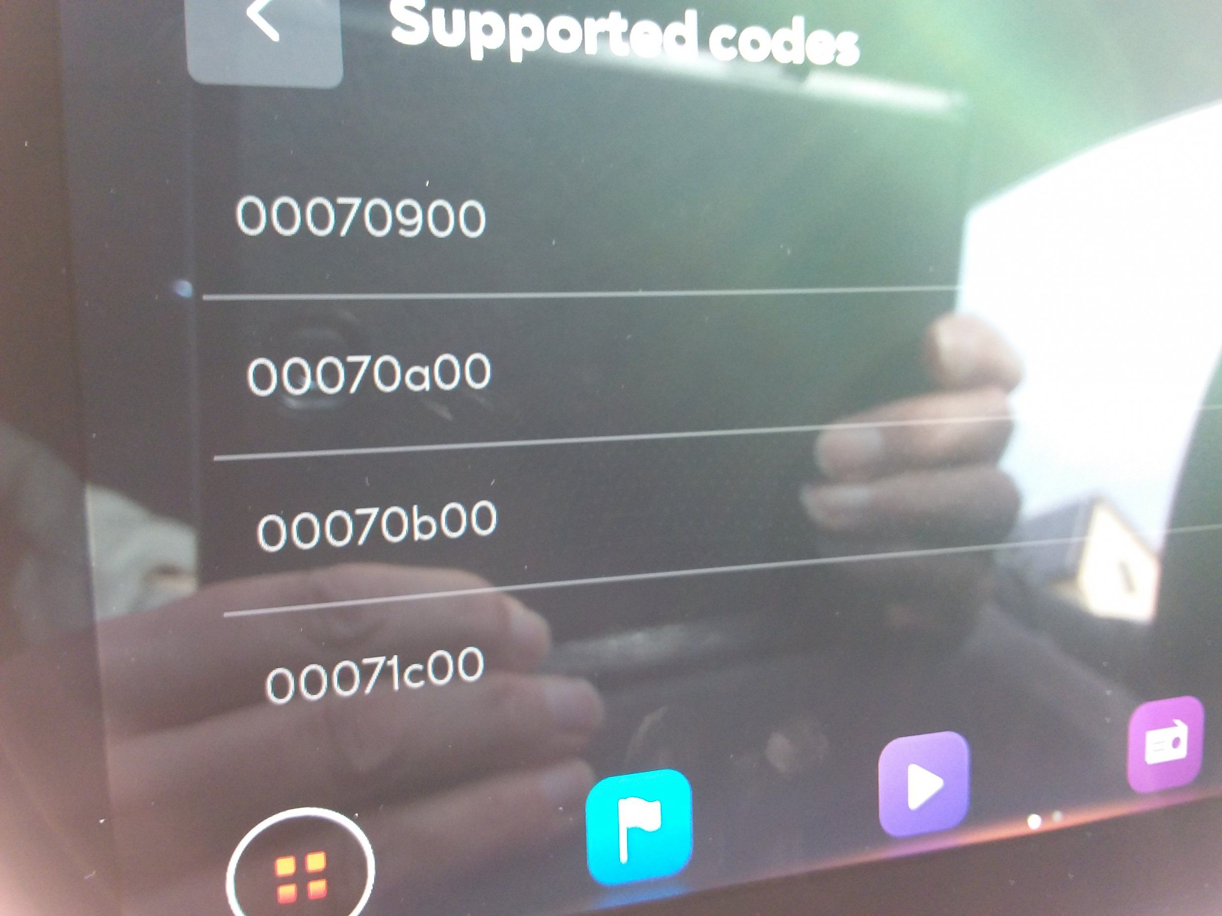

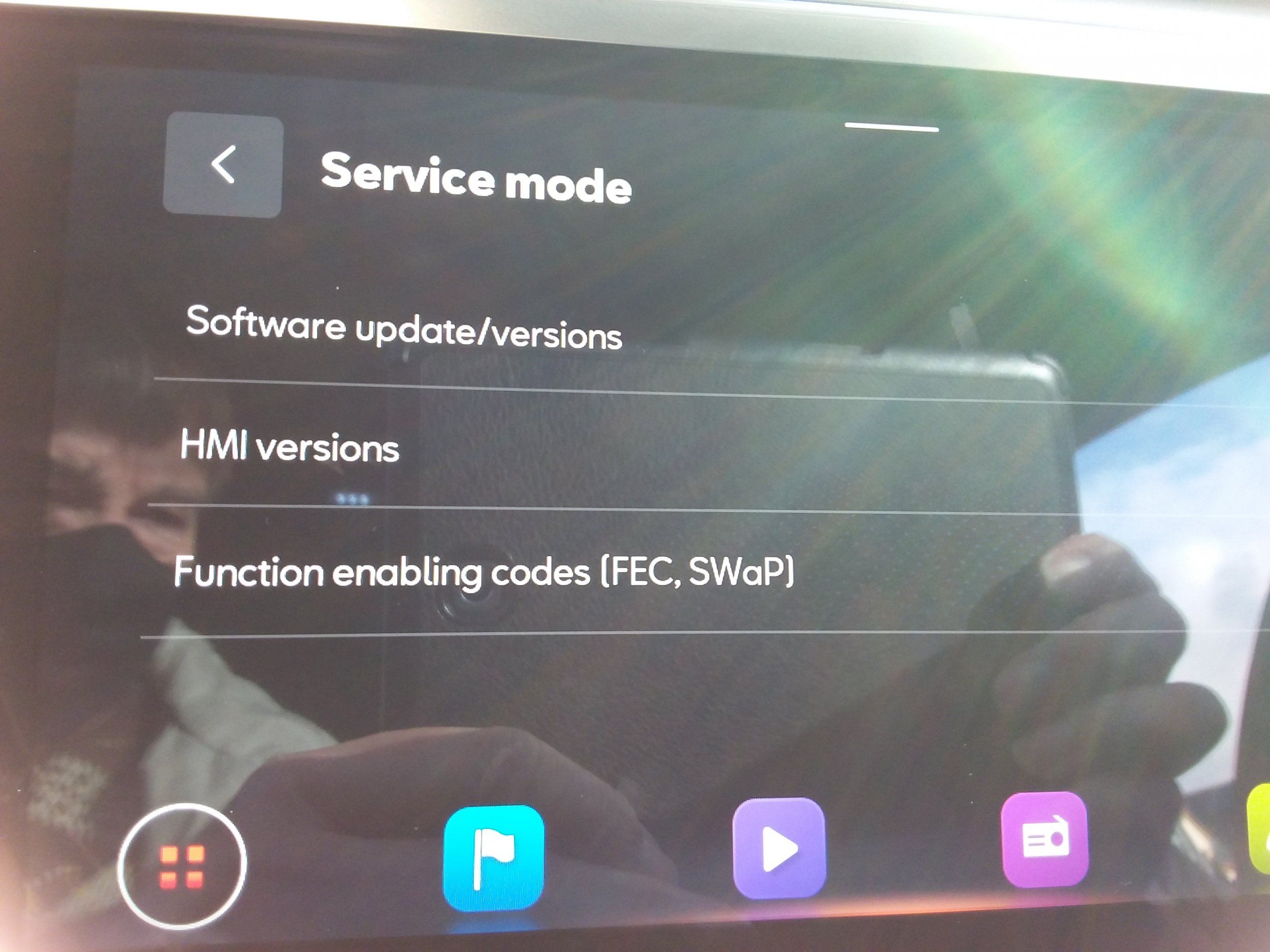

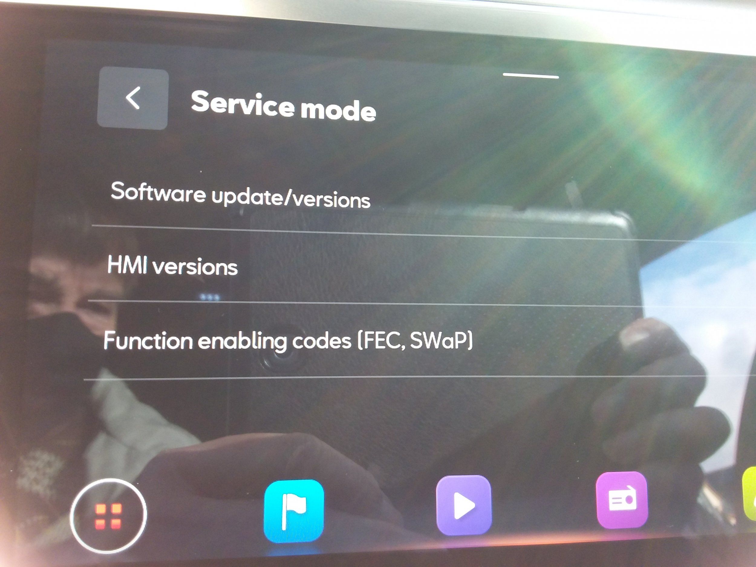

You then press the "menu" button until a screen that comes up than mentions FeCs. I got the local dealer to do it. He told me what he thought was the new menu button, I held for a few seconds, the mib2 trick, it worked, not that he knew what they were... he said so, had to do my teaching them ?.
I think you might press that bottom left button. You hold it for a few seconds, then you see a screen which mentions FeCs. Service menu. Photograph available and installed. Installed is what you have, uninstalled is what is possible but not activated. Need to photograph the system information screen that tells you model and software release.
Then you need someone who's done the same then compare FeC codes. It's like making a 4k TV but controlling people to watch SD or HD. The kit can all be the same.
Then you can Google and workout what you have.

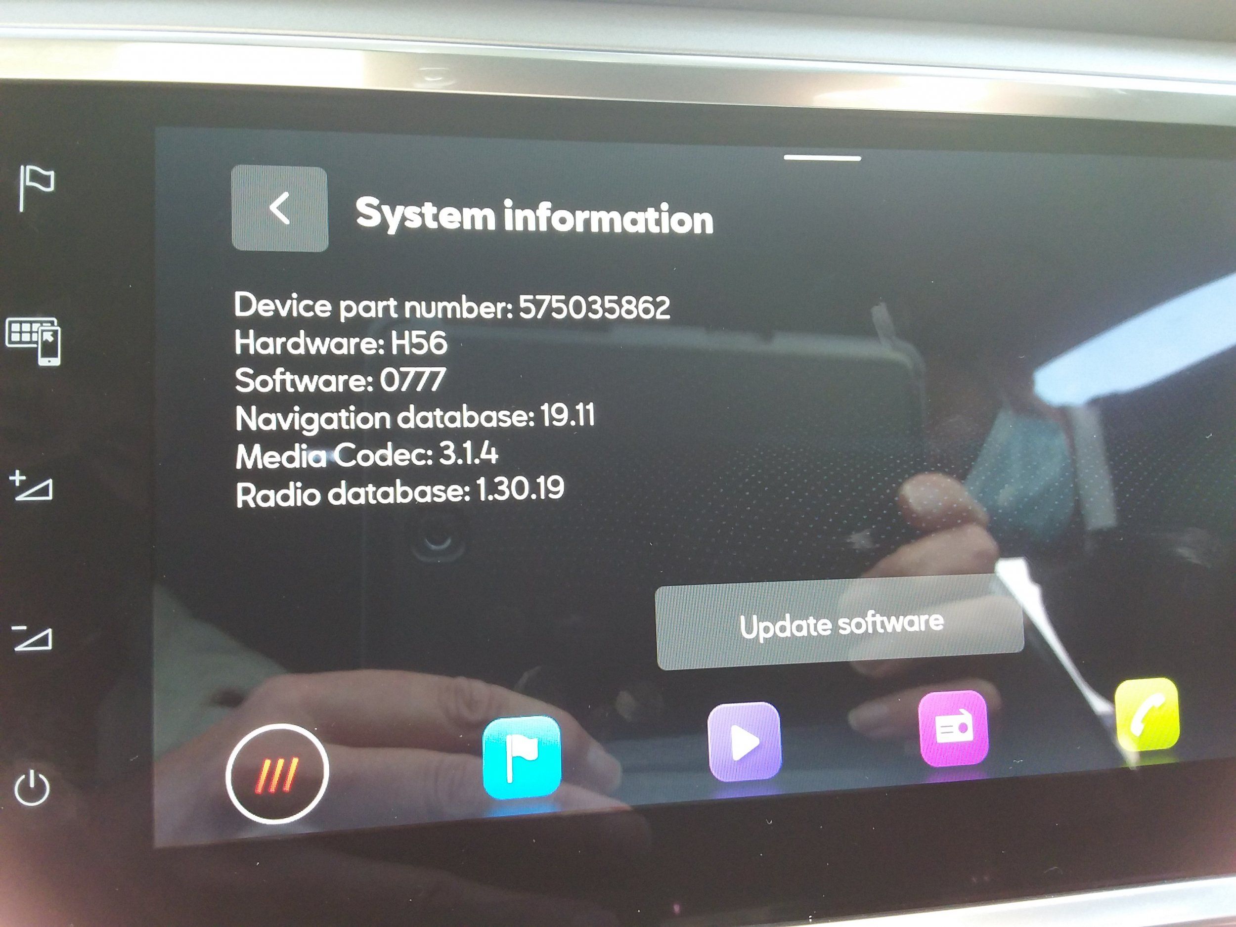

Found the pictures I took. Get the idea. Someone who got a fully specified vehicle and compare with yours on the hardware code, software, installed FeCs and available but not installed.

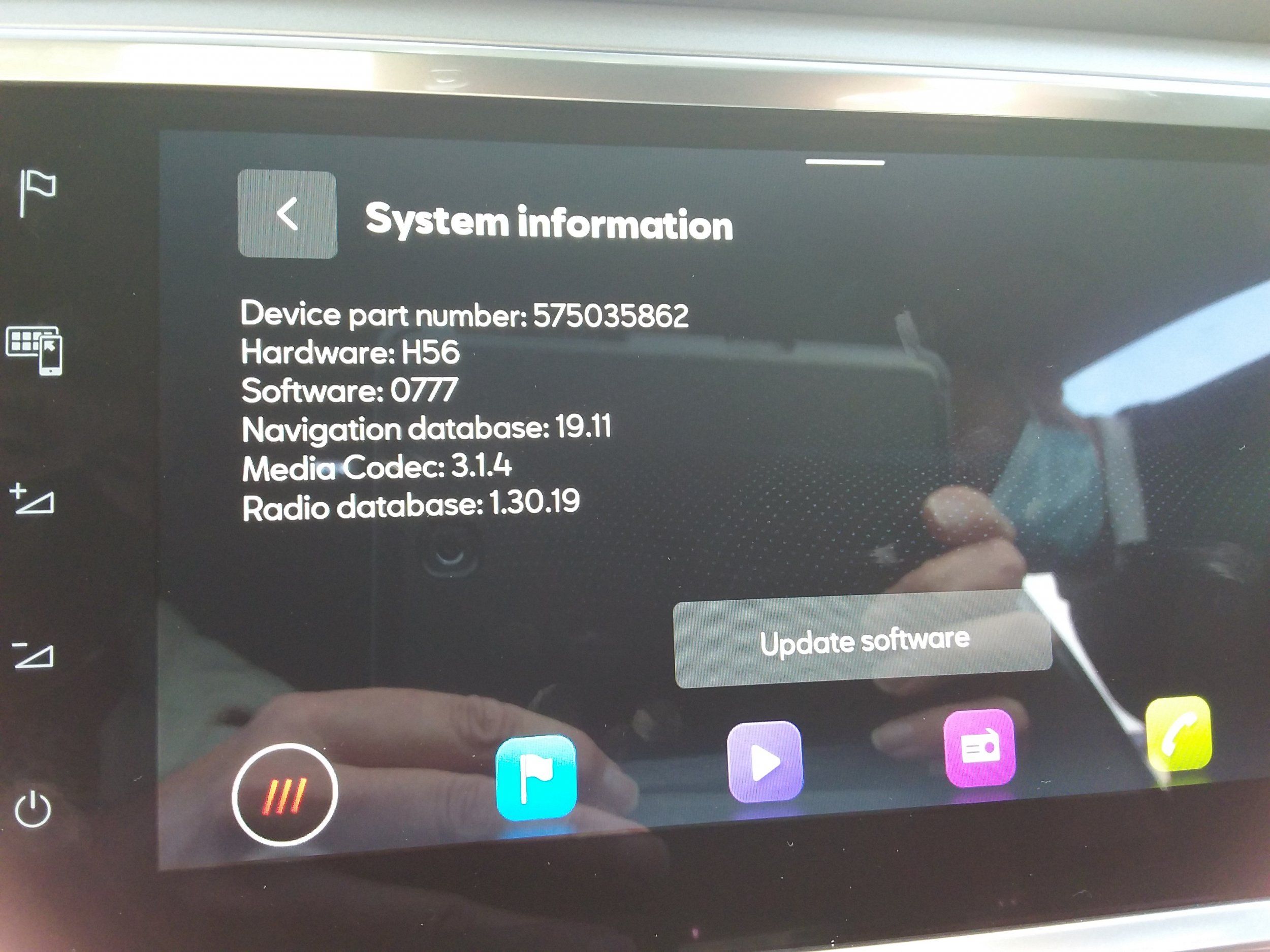

Whilst you are all taking pictures of your FeC screen, hardware number, part number and software version and what features you have. That's the scientific method !.

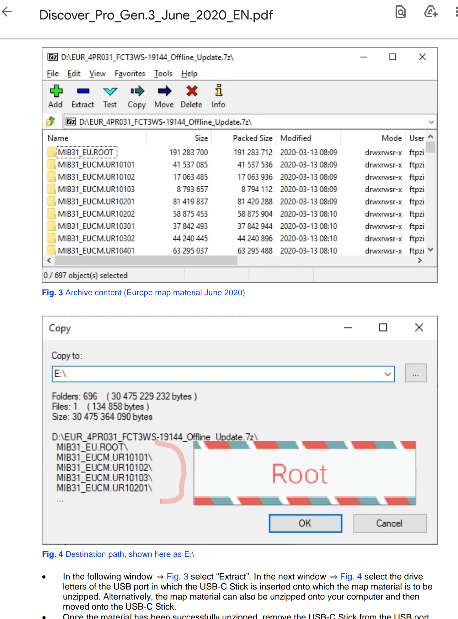

You could try installing the offline navigation file for Turkey if it's just missing that. It won't damage it, just won't see it if it's not that. The file is listed here under Turkey.
You put on a usb-c stick after preparation. Preparation is all important. Seat site doesn't have much on that. Same as VW Mib3 documention attached. File names will obviously be different. Copying them to the route of the USB is all important not one level down. A common mistake with the mib2 high. See diagram in the VW PDF.
Similar to mib2 high a pc is better than a Mac for this, use 7 zip to drag and drop the unzipped contents first to hard disk then the usb-c. If using a Mac then use Keka and CleanMydrive on the USB after.
You have to find the similar button to press on the menu to start it off as VW documentation. The Seat manual makes reference to that screen.
The Turkey map is quite small so if you do get the file preparation correct and find the install screen on your Seat it should be fairly quick. Note it only starts uploading to the unit with the engine running. Like mib2 high if you turn off the engine it will restart from where it gets too. Mib2 high takes upto 60 minutes on Europe. Guess Turkey within 15 minutes... I don't know the timing for mib3 on Europe. If file preparation is correct and it started just leave the USB in till completion turning the ignition off if required.
It won't damage the unit if it isn't suppose to import the map this way. One is testing whether your unit just needs the map installed on it. E.g.. the dealer hasn't done that due to license issues, same as Vags sold in Israel don't come with maps, they are fully prepared but just missing the maps. Might just need the map file presented to it and an up load triggered. As said rigours file preparation of the file has to be made else it won't recognise it. One character out in the download and it will fail import hence the need only to use 7zip on a PC or Mac Keka and CleanMydrive on the USB if using a Mac.

  • Discover_Media_MIB_Gen.2_June_2020_EN.pdf

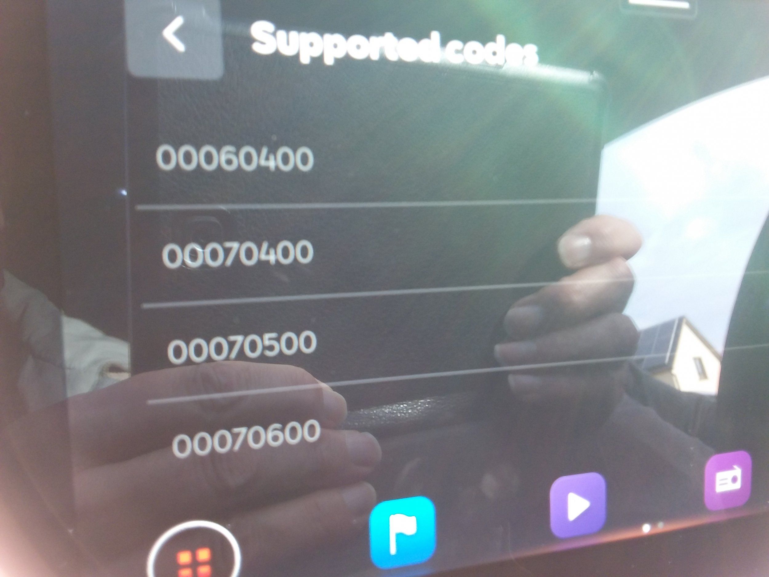

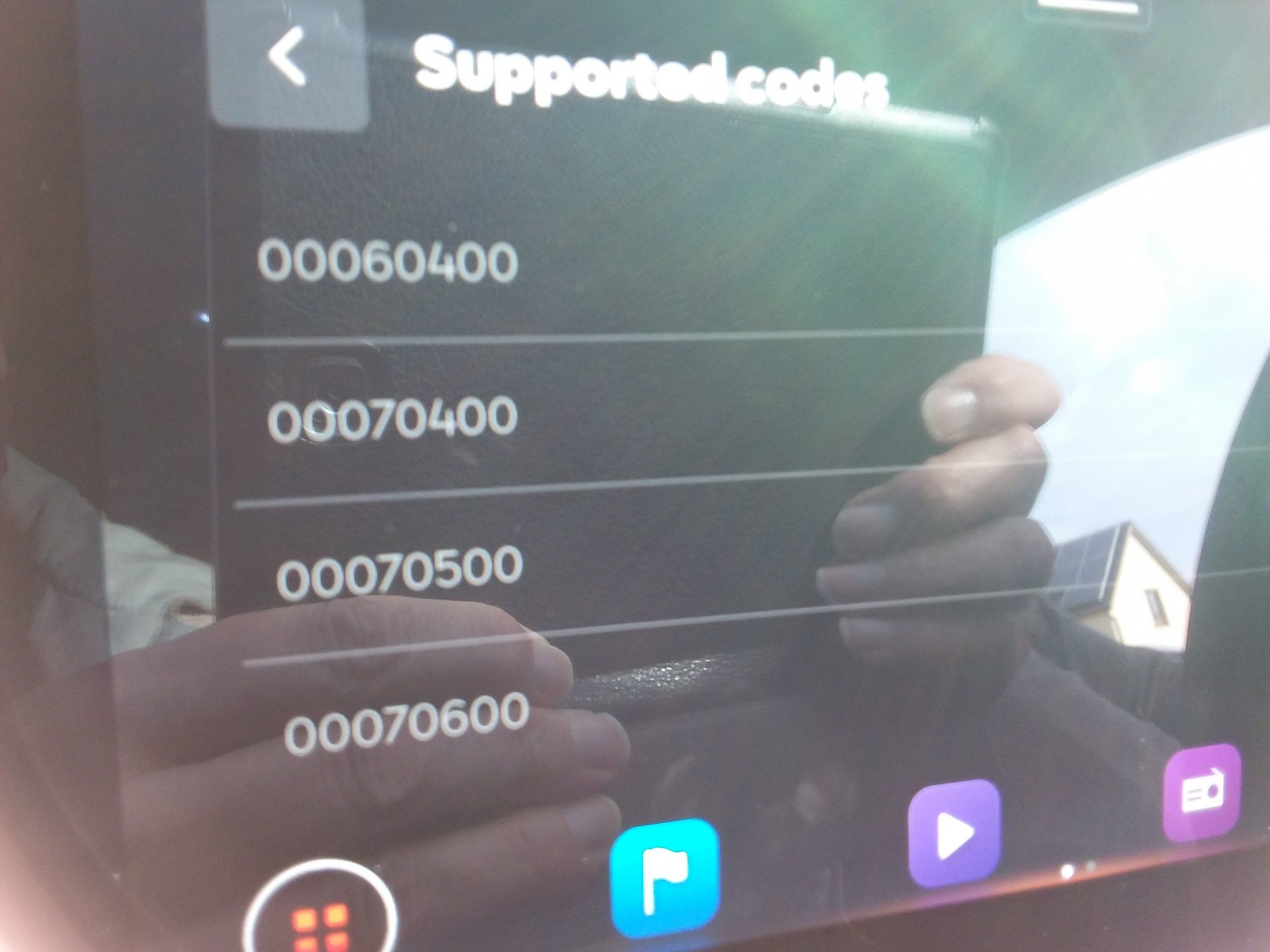

Hi Tell;
Firstly, I'm sorry for the late reply. Last night I compared codes with supported codes and you have two more codes (700 and 00060400).
I don't know what these codes mean and my installed codes screen is empty.
What do you think these codes mean? Could it be navigation?

Well it's interesting since it is how you said nothing is installed if the installed screen is empty and the rest are available but not installed. You could try presenting it with that USB with the maps on it but then I dont reckon its set up to do anything. What I achieved last week by accident but corrected now in mib2.

I'll try to upload maps tonight but firstly I need to find type-c to type-c cable :)

It shouldn't cost too much just try to see if it starts reading the maps as long as you present them as per the document and you are not using a Mac... saying that I would have expected a navigation FeC to be shown on the installed list unless it jumps into action. Unknown territory.

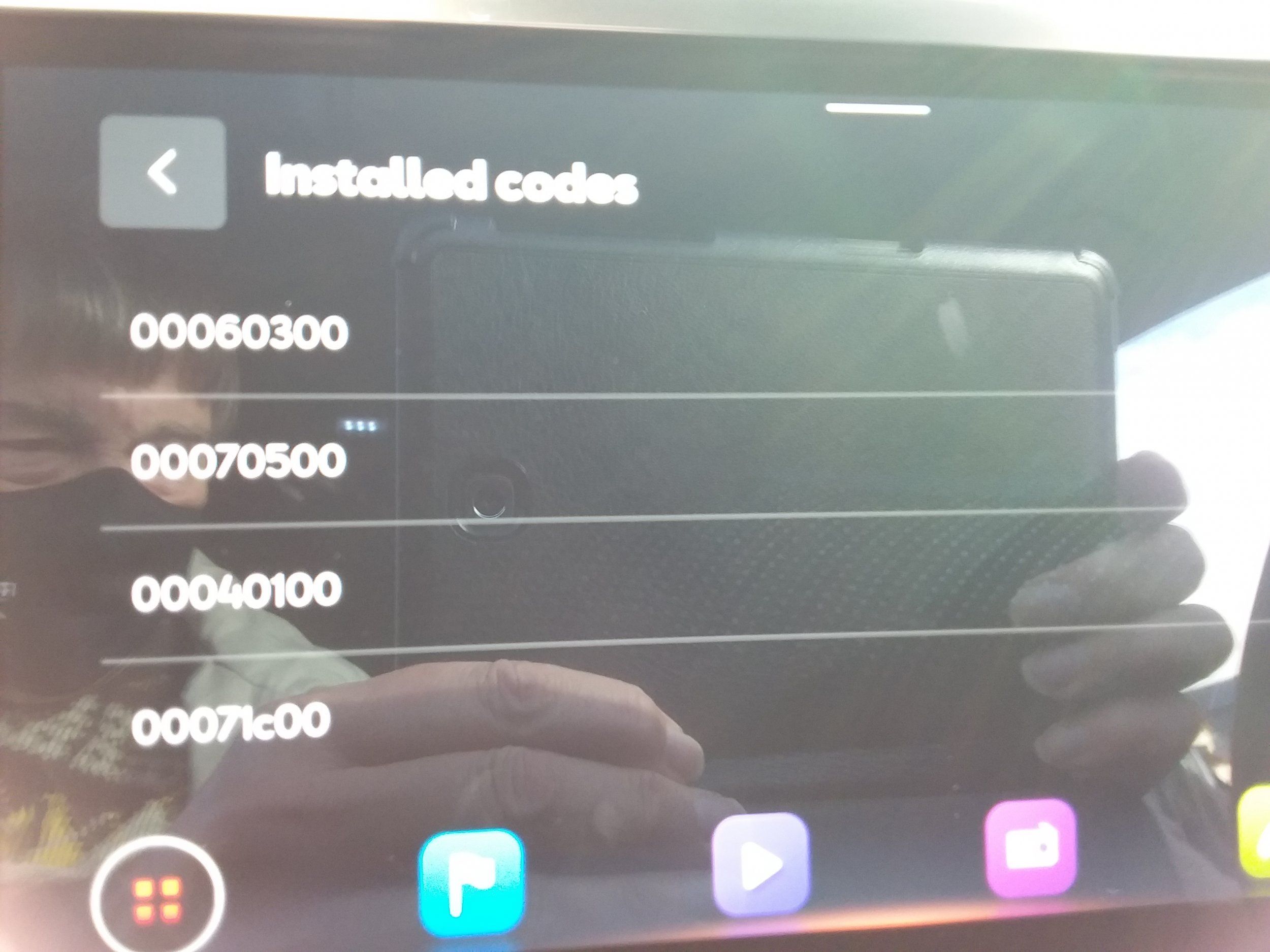

These are the same codes that are available on my first edition. The installed screen is blank as well. Could do with a friendly dealer to tell us what they are and how much $$$ to activate them.

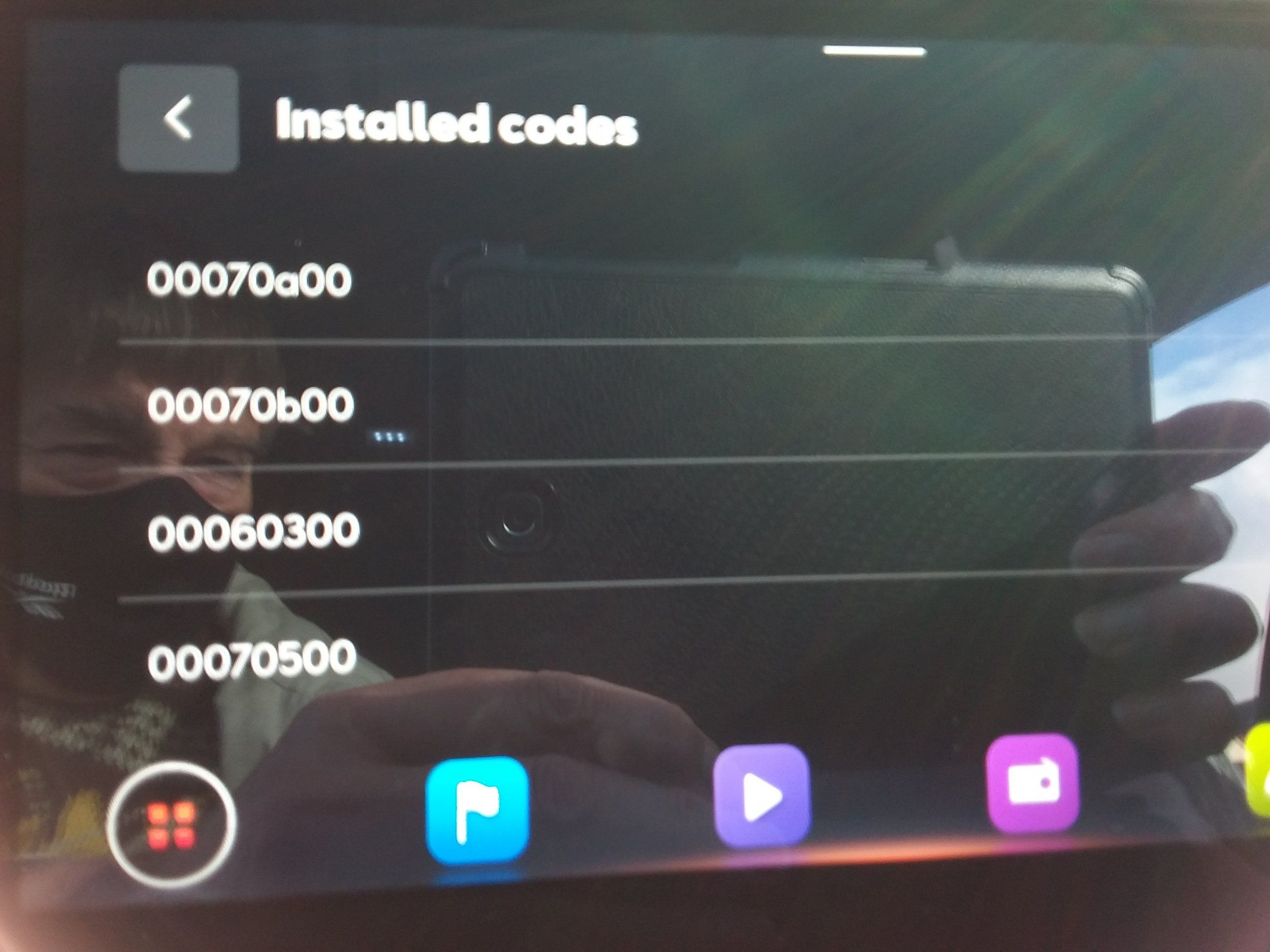

Blank installed FeC screen suggests you have nothing installed. Wonder whether if you dont subscribe to connect services or they aren't enabled will cause your FeCs to come off available. Fresh delivered UK on the road you would expect to show a good range of FeCs installed, not nothing which means not a lot of the functions will be working.

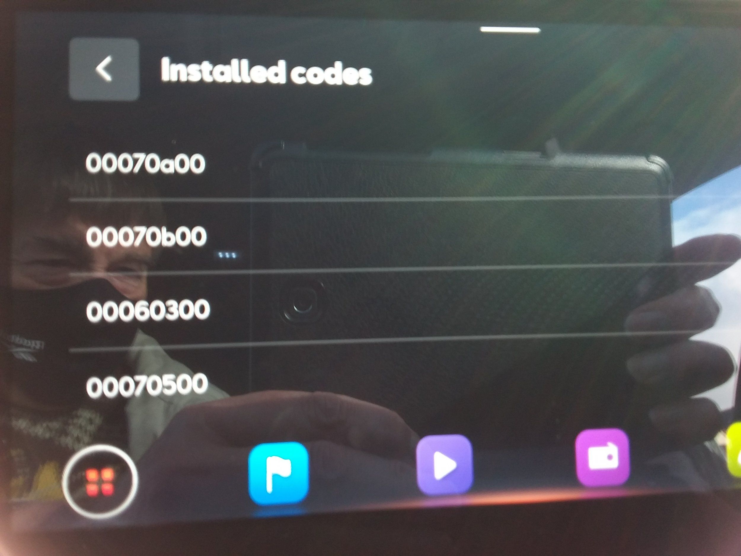

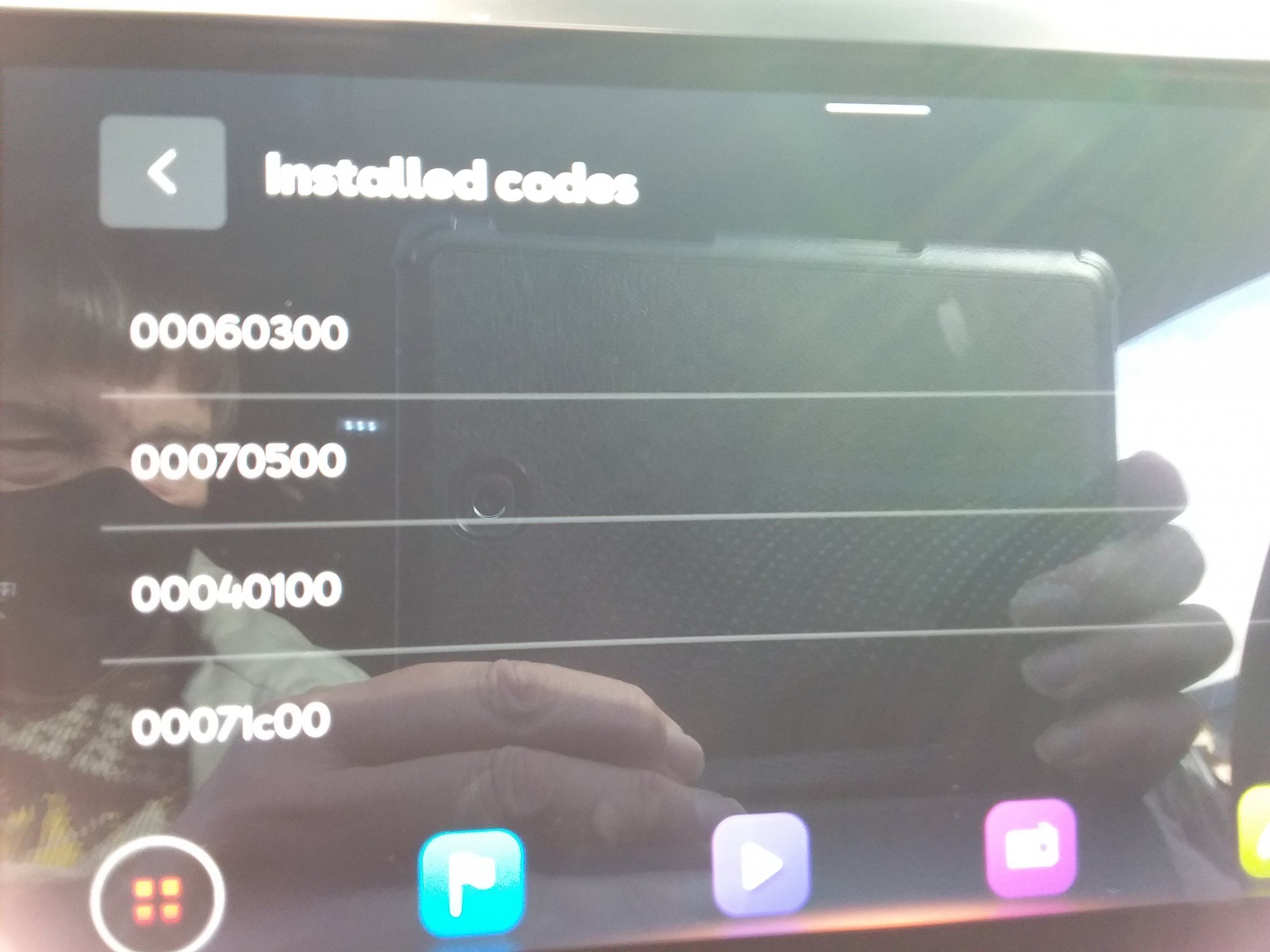

Installed on the one I sat in were:
00070a00
00070b00
00060300
00070500
00040100
00071c00
Looking at the supported list that covers the installed... so the installed are the key ones.... unless the firmware in yours doesn't show correctly the services.

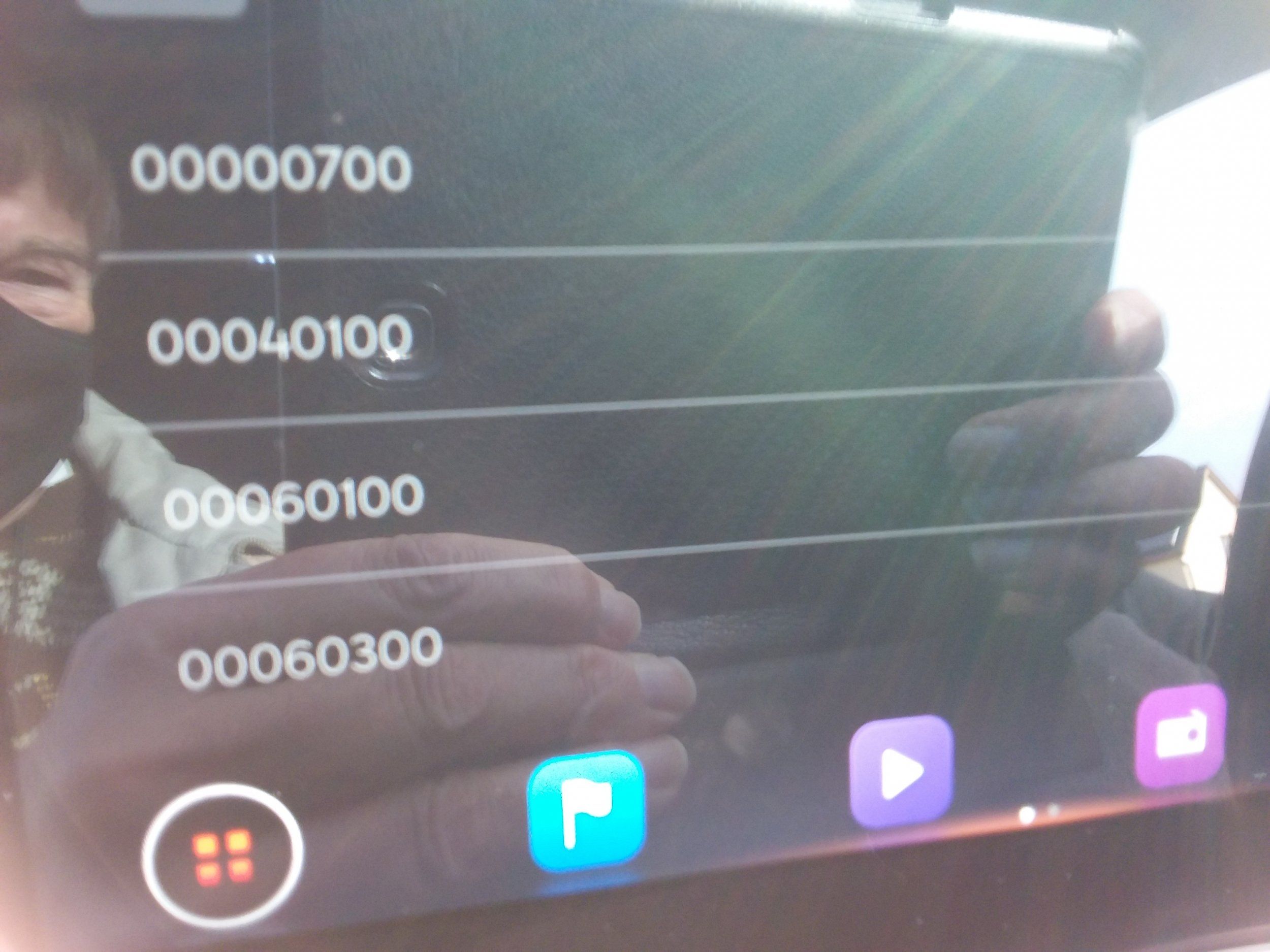

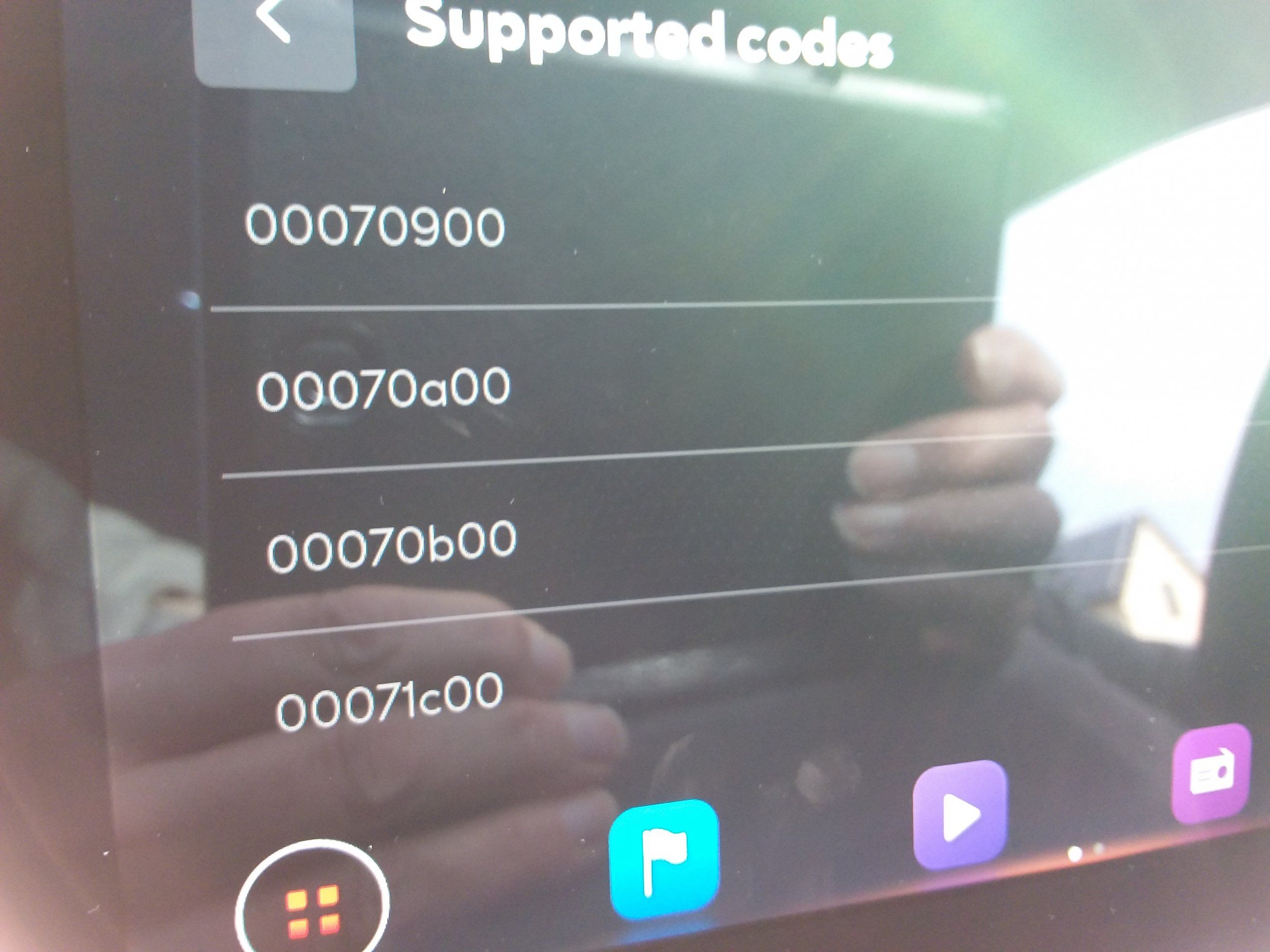

Got these supported
00070900
00070a00 (again)
00070b00 "" ""
00070c00 "" ""
Had a few other codes but missed off top of text supported or installed
00000700
00040100
00060100
00060300
00070a00
00070b00
00060300
00070500
00040100
00071c00
Got these supported
00070900
00070a00 (again)
00070b00 "" ""
00070c00 "" ""
00000700
00040100
00060100
00060300

Best guess is that it is just a bug not showing the installed options on mine. As everything works just fine. Will have a check in the morning.
