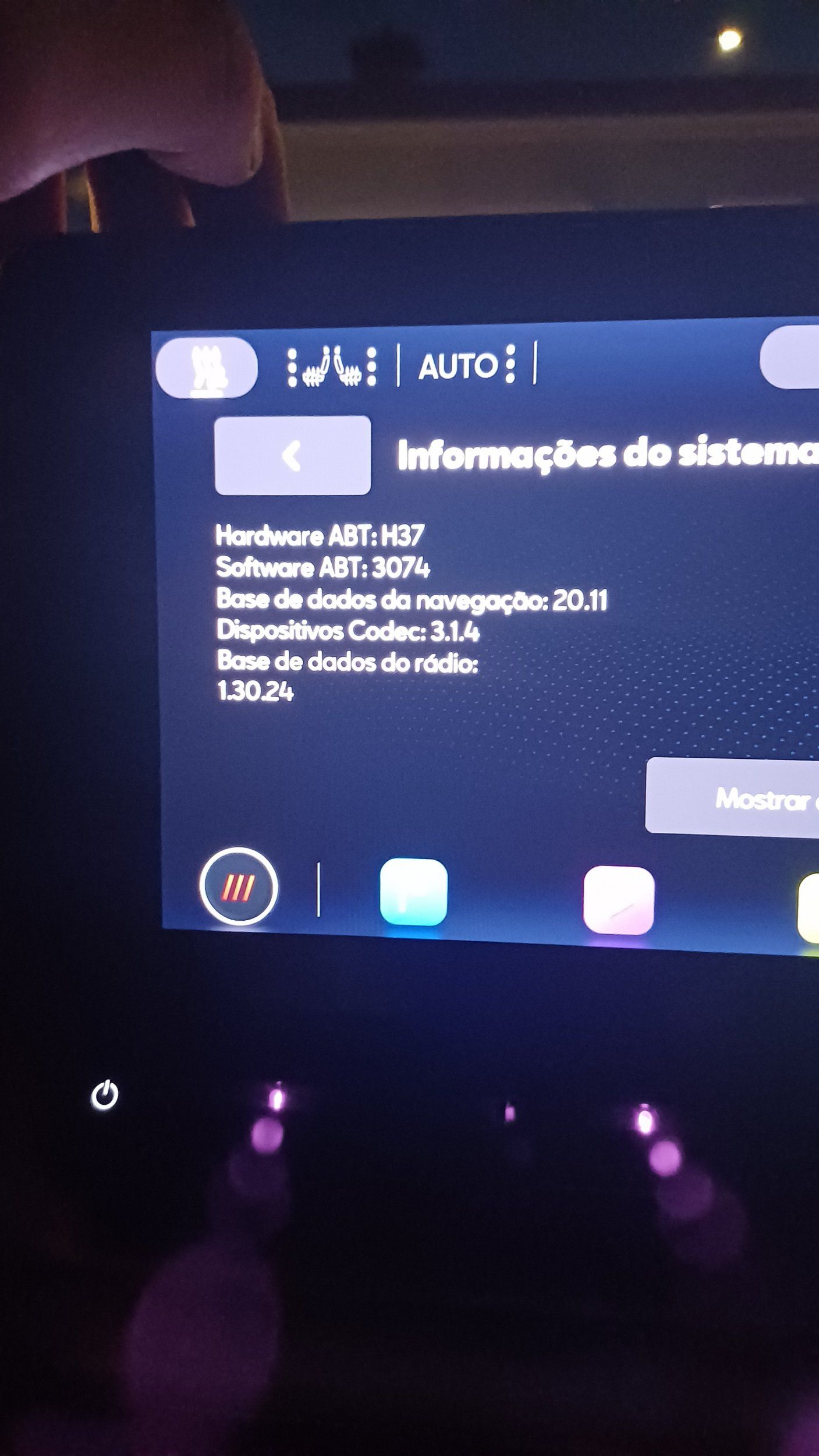

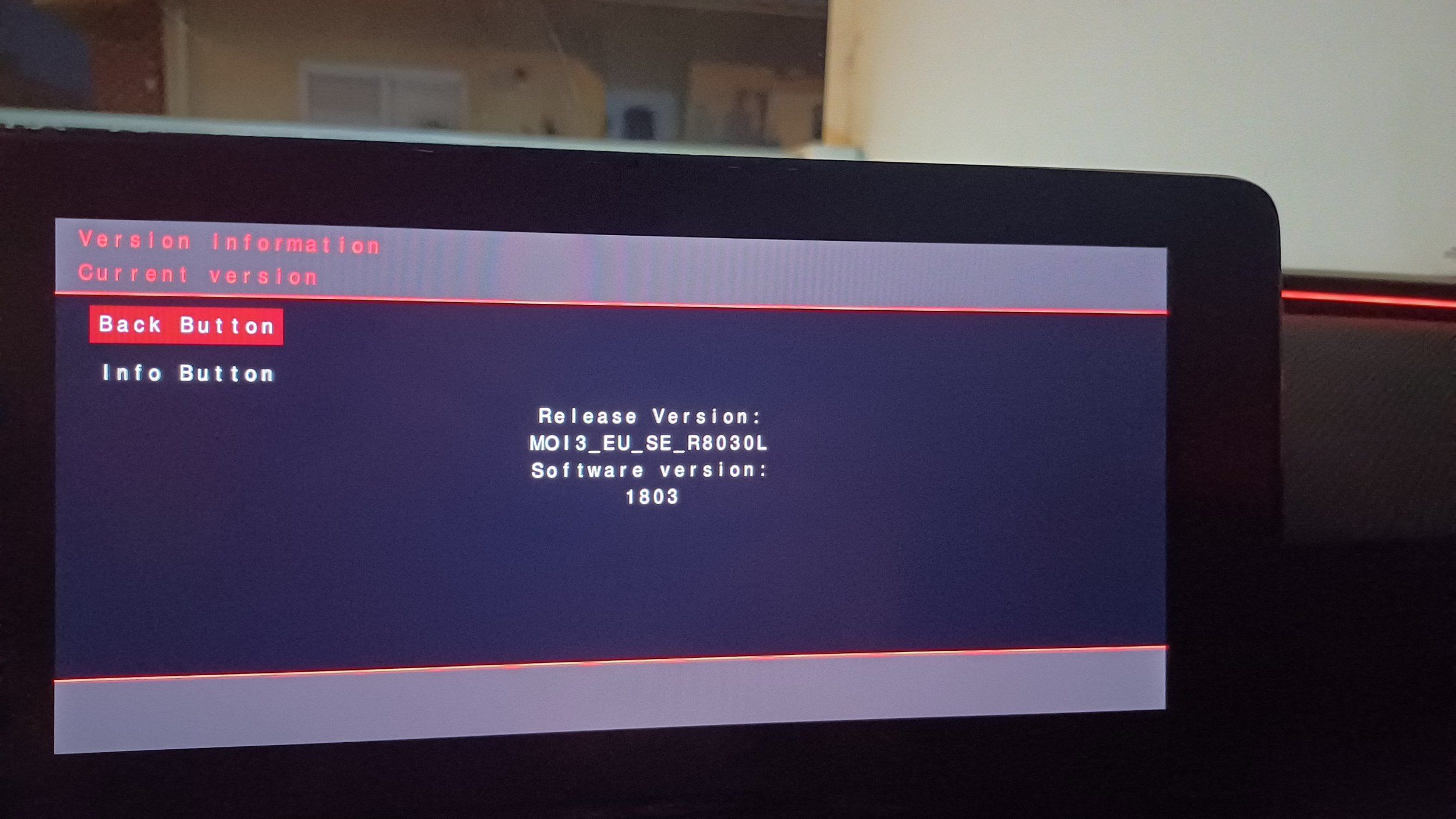

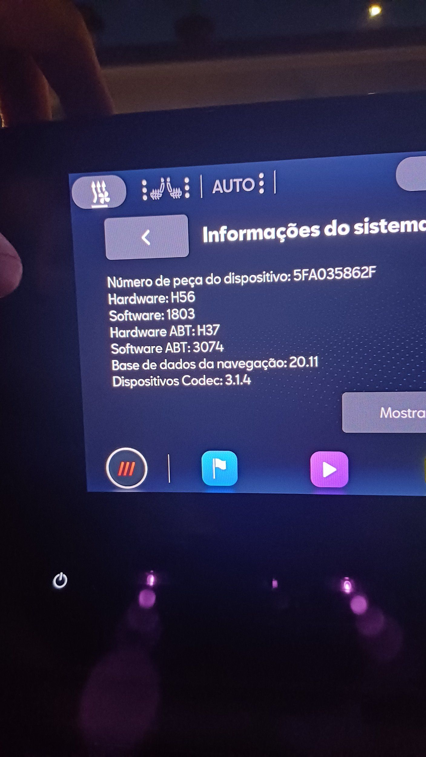

I own a 2020 SEAT Leon 4 1.4 e-Hybrid FR, and I'm looking for guidance on how to update my firmware.
Current system details (pictures attached):​
  • Software version: 1803
  • Hardware: H56
  • Hardware ABT: H37
  • Software ABT: 3074
  • Navigation database: 20.11
  • Radio database: 1.30.24
  • Codec version: 3.1.4
I've seen that newer versions are available, but I haven't found clear instructions on how to perform the update.
  • Is this something that can be done via OTA updates, or does it require a USB update from SEAT?
  • Is it possible to manually update it with files downloaded from somewhere?
  • What improvements/fixes come with the latest updates?
Any help would be greatly appreciated!
Thanks in advance!

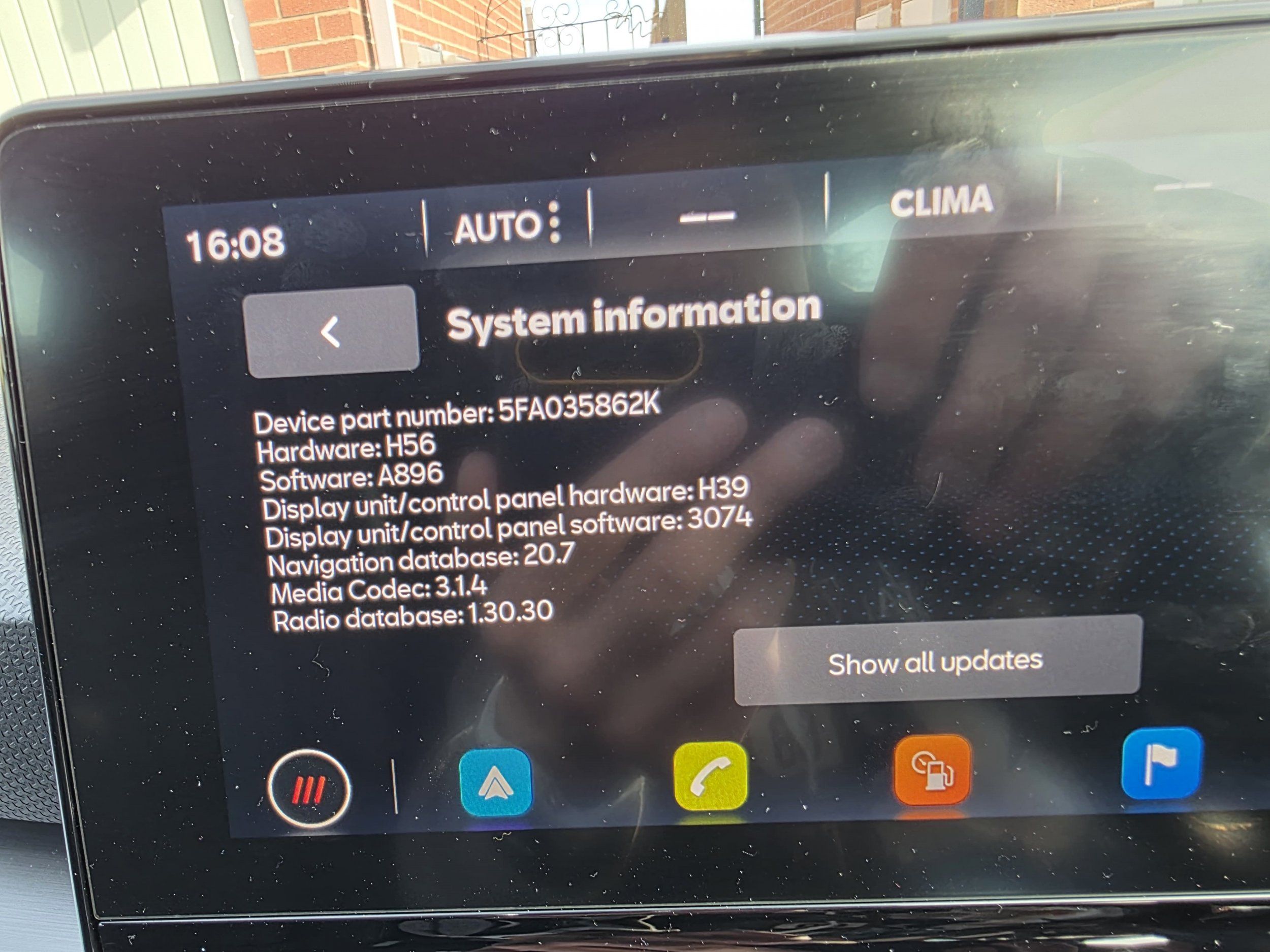

I have the Seat Leon 2021 (mk4?) and have issues with SOS yellow light flashing during a drive to a new place and my SAT nav no updating on the map, actually showing that I was off the motor way when on the motor way with random pulsing forward and back, in and out on the map. stopping somewhere safe, turning off and on didn't fix the issue, but turning off Bluetooth and using phone directly for navigation did as I was in a rush. Will try again full link on known routes to avoid the stress and to test further if the issue happens repeatedly.
I'm hoping its an issue with a dated navigation database as I'm not sure if the car pulls the GPS data from itself or the phone during android auto full link.
Have you had the same issue on your car? Attached images of the firmware to when it was brought and after first update which happened after factory resetting the car and setting myself as the primary user.

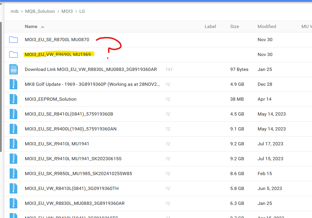

did perform a factory reset mate? If so did that encourage any more updates? I'm also in the same boat being stuck on A896 and semi pondering updating to 1969 once I'm 100% confident I wont run into issues. Luckily I don't have the firmware but keen to get one that works for my UK car.
I do know my SW train is MOI3_EU_SE_R9690L
been trying to locate the file here but not sure if this is the right one. again just making notes and prepping trying to make sure its all good before attempting.
