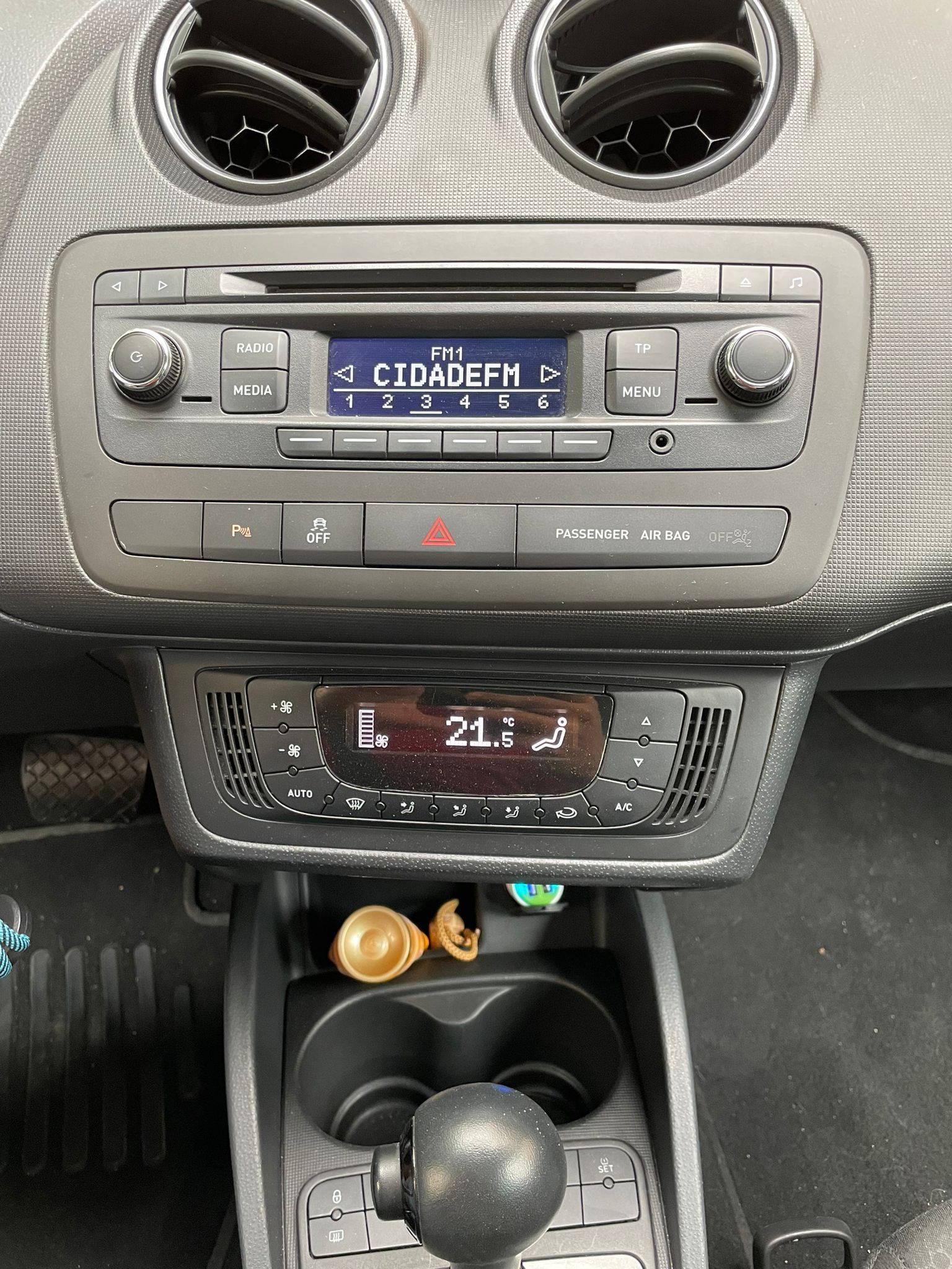

I am trying to do an upgrade on my car(2014) radio (image below) but I cannot find anything about the hazard light, passenger airbag buttons.
I will be mostly using it just for carplay and music. So I imagine a 1DIN radio is enough for me(?)
Can anyone give me some suggestion of radios to use?
And how to deal with the plate and the buttons?
If you can provide me with links or names for the parts I need I will be greatly appreciate.
Thanks

I just found about Your item of interest.
There is new module to be installed instead old one near gear shift.
Pretty much standard one and it takes little bit of fiddling with the cables.
The video I have linked is just as an idea.
for the rest You have found already about.
Cheers
I bought an xtrons. Absolute doddle to install & works well (although still need to sort the boot defaults as it starts up on wrong screen & kph). Run toque app with a obd dongle too. Just replace the lower buttons in front of shifter with one that has the buttons you need. You MIGHT need a harness for the different button location but not something I personally done as I already had hazard & airbag in lower section as earlier car
