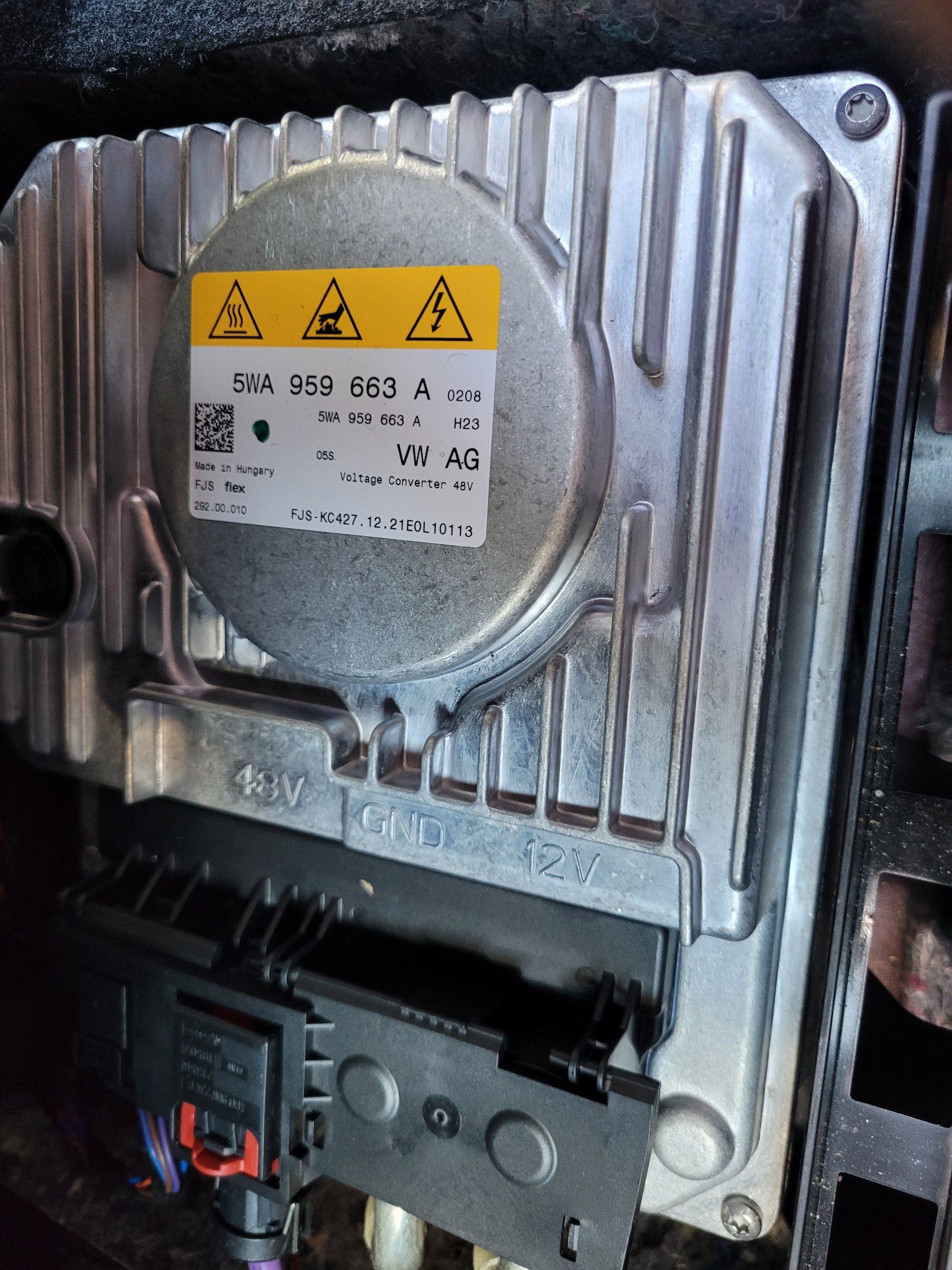

At the moment i want to ad a little amplifier next to the beats audio one, an audiotec fischer match 5.4. This is why i'm trying to find the location of the oem amplifier. I know that in mk4 leon's non-estate eTSI this amplifier is in the trunk next to the sparewheel and that in other versions it's under the driver's seat. But in my car i have a voltage converter under the driver seat (see the picture). This thing works with the 48v battery under the passenger seat.
So does anybody here would be able to tell me where's this beats audio amplifier sits in this car?

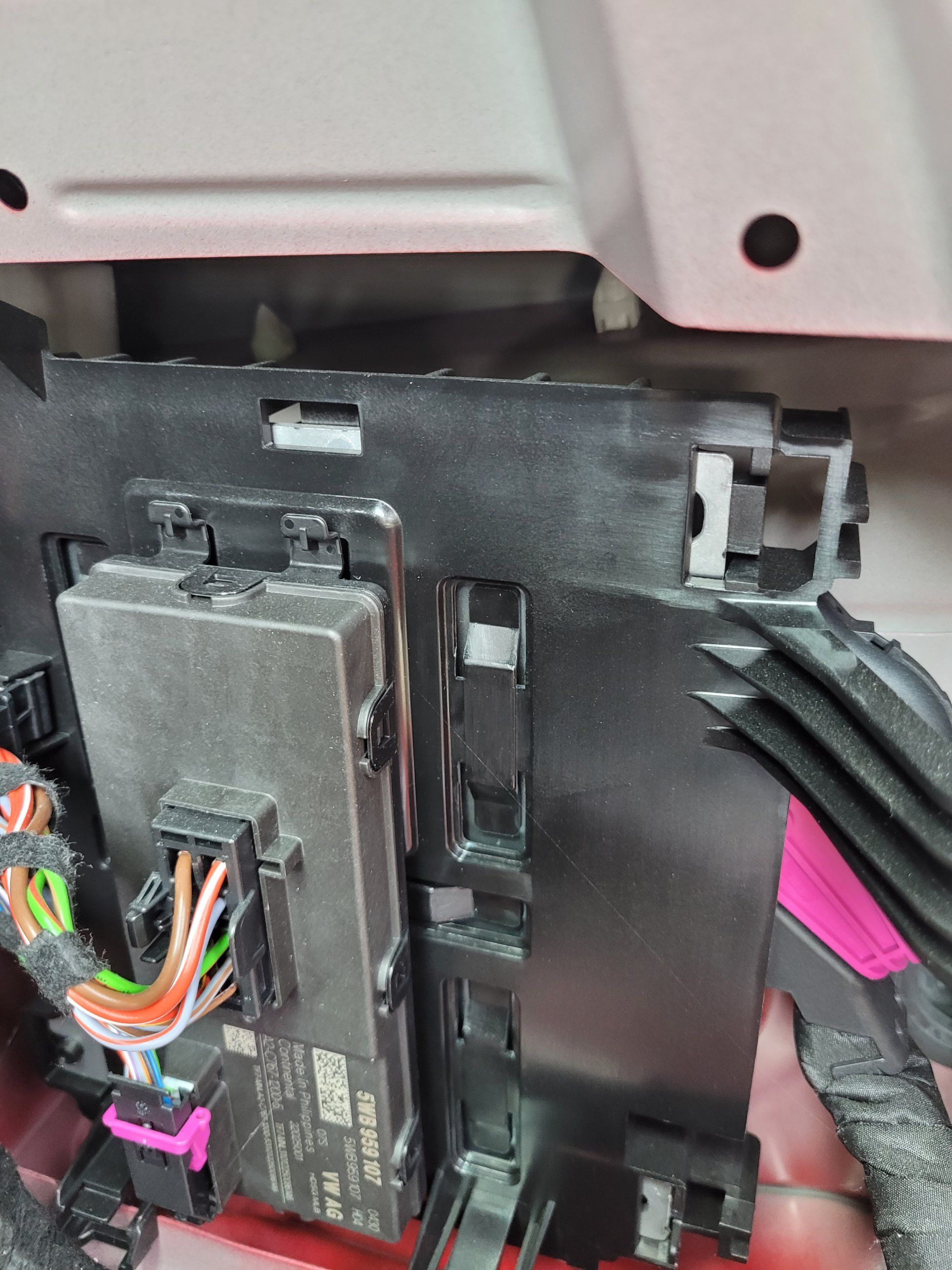

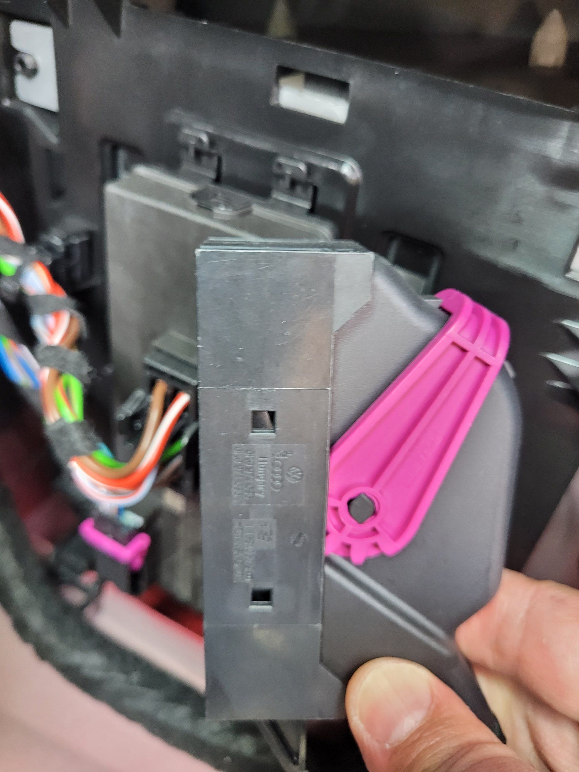

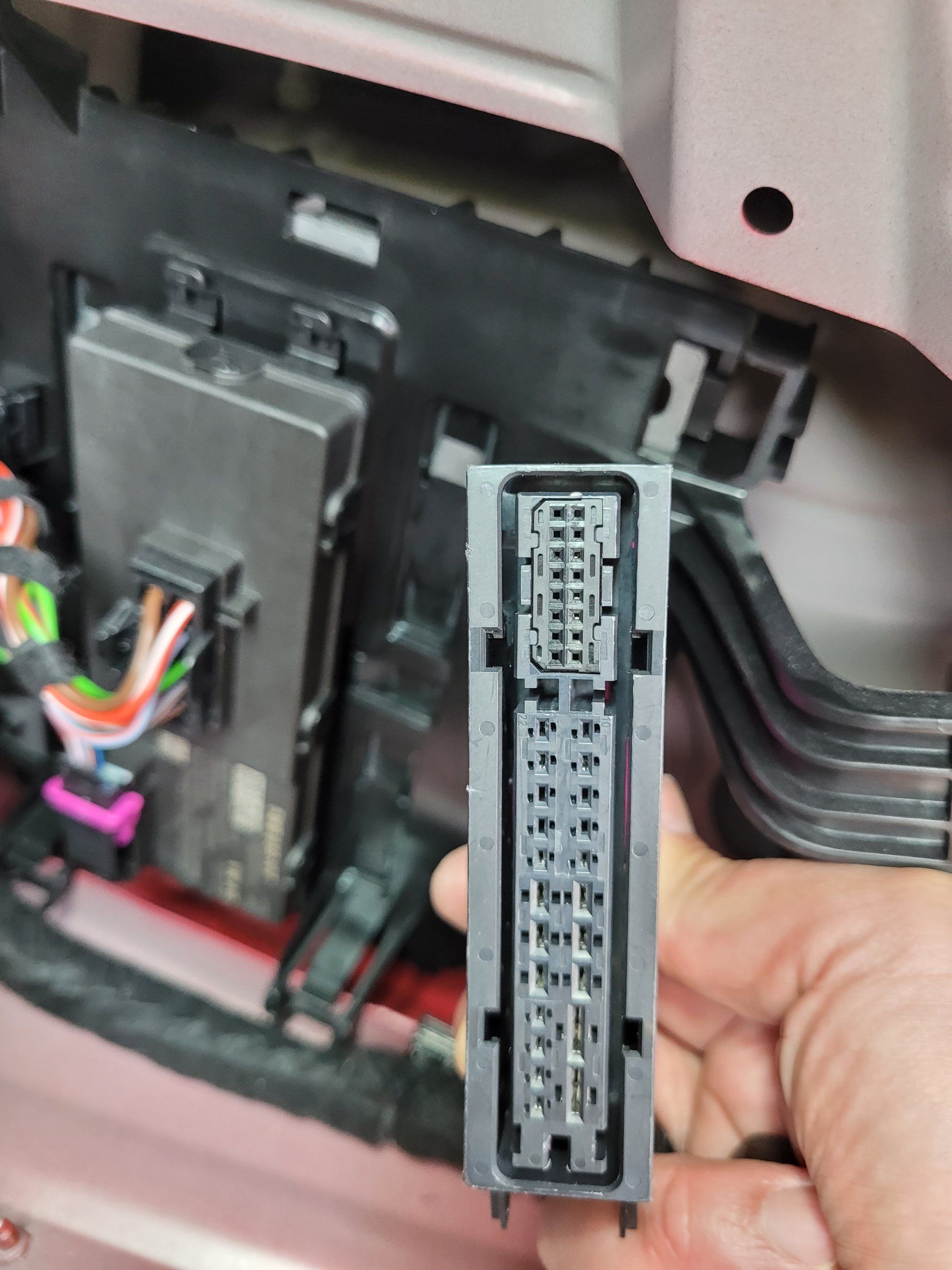

I've finally found the Beats audio amplifier in my car. It's located underneath the trunk garniture, right side, between the right rear wheel and the trunkdoor (french car with left driver's side).
I hope this will help anybody who will need to access this amplifier.
