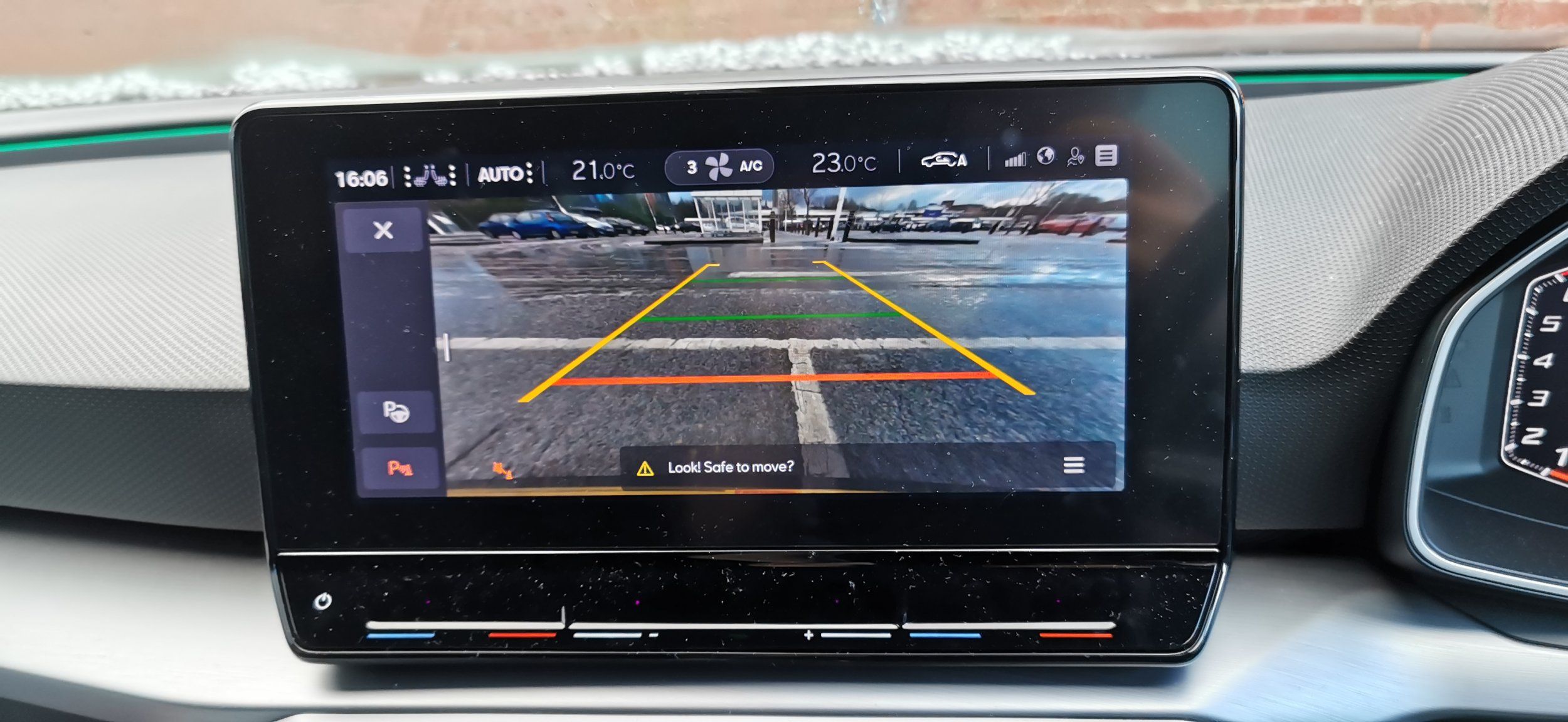

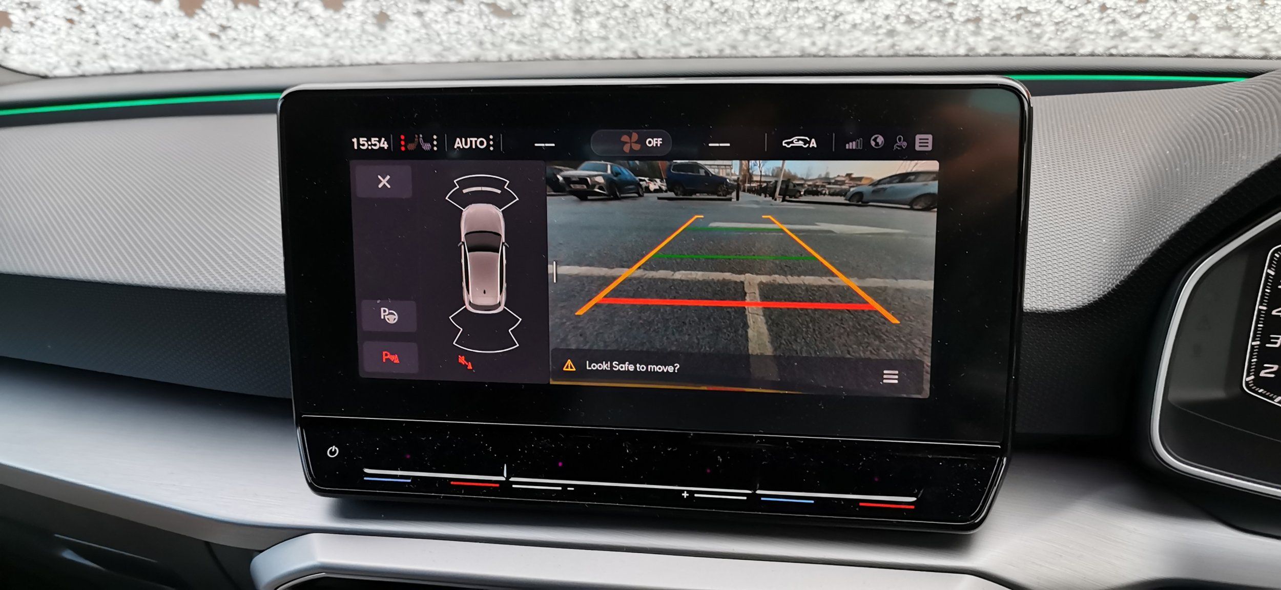

It has dynamic guidelines and multiple views (ie directly behind & wide angle for exiting junctions. There's also a towing view for cars with a tow bar)
Blind spot assist integrates with the PDC display, not the camera view.

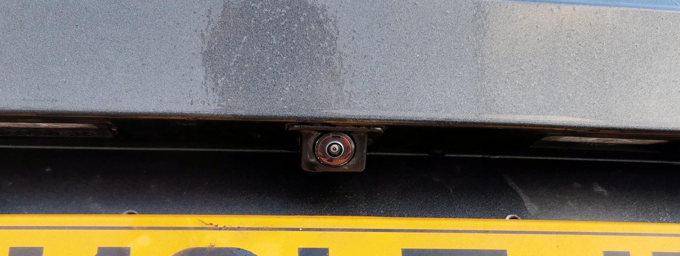

Pictures of retrofitted camera below

Nice, although I'm not so keen on the SEAT factory fit camera position, it's gonna get dirty real quick. @East Yorkshire Retrofits do you know if your camera has a hydrophobic coating on the glass?
Makes me wonder if that's the reason SEAT aren't offering on as many as factory model variants (i.e. less customer complaints??). :unsure: Maybe they are desperately trying to adapt the VW golf/passat badge "flip" version for next model year?? I'd certainly have that version in a heartbeat!
Seat have been fitting cameras in this position on Leon's/Ibiza's for years. It's unlikely they're in a rush to change it, especially to one that's built into the badge as I can't imagine they're particularly cheap to produce
Even on the mk3 Leon, cameras weren't particularly common place. I think it's just somewhere they've seen an opportunity to save money by not fitting them
I doubt the lenses are coated from the factory however there's nothing stopping you doing so ?
