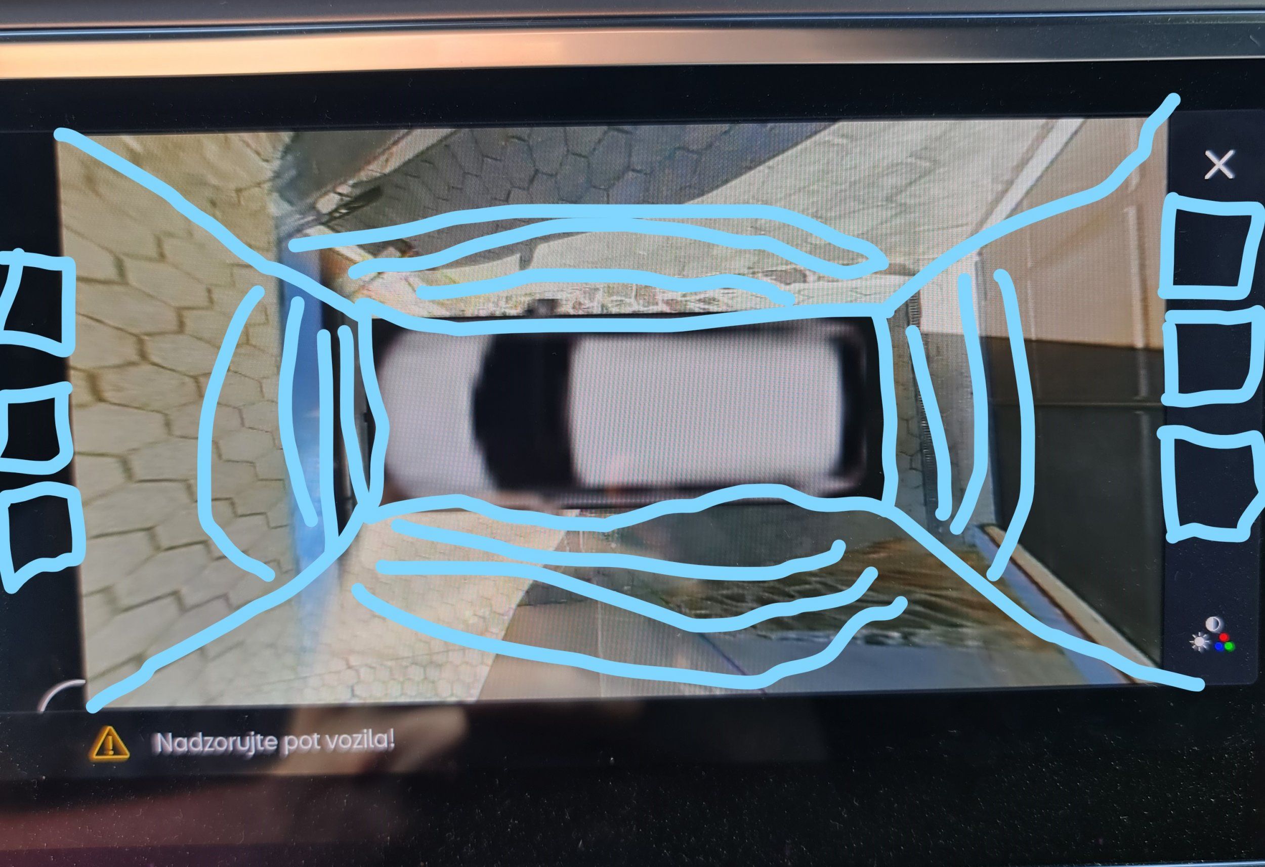

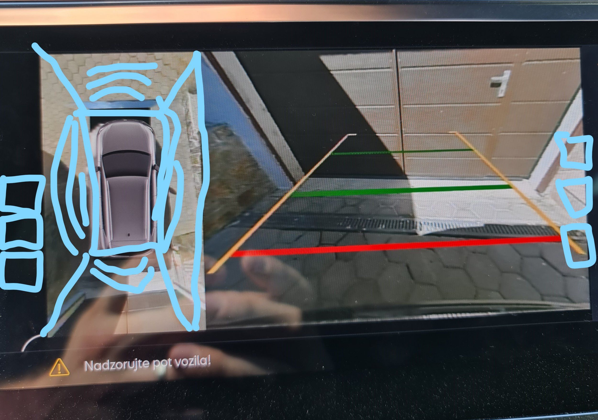

Hello,
since some time ago I opened a discussion regarding the retrofitting and configuration of AreaView2 and MIB3 on the Seat Ateca FR 2021 and I did not get satisfactory answers, I am opening this topic again.
I consulted a few forums and got very different answers:
5F - Multimedia (MIB3):
Vehicle function list BAP:
  • VPS_0x0B: activated
  • VPS_0x0B_msg_bus:
    • What to choose?:
      • Comfort data bus
      • Terminal 15
      • Databus Infotainment
      • Databus extended
6C - Rear View Camera (v mojem primeru AreaView2):
Long coding:
Byte 07: Bit0, Bit1, Bit2, Bit4 - true (Buttons to switch views)
I set the parameters with ObdEleven, and I also have Odis-E 12 with VAS5054A available.
I've tried all the VPS_0x0B_msg_bus options mentioned and it doesn't show the view buttons and PDC lines (see image what I want).
From this retrofitting I wonder if I was able to install the dead angles and Areaview hardware myself with instructions I got on the internet with wiring diagrams why are these coding parameters such a mystery.
Does anyone have exact instructions on how to configure AreaView2 step by step or if you can do it for me online I am willing to pay. Or if anyone has an AreaView2 ROM image from a Seat Ateca FR 2021 that I could upload?
I also inquired with the local authorized service center and nobody wants to do it.
I understand that it's complex, but it's not like it's a NASA rocket.
With all respect
Andrej
