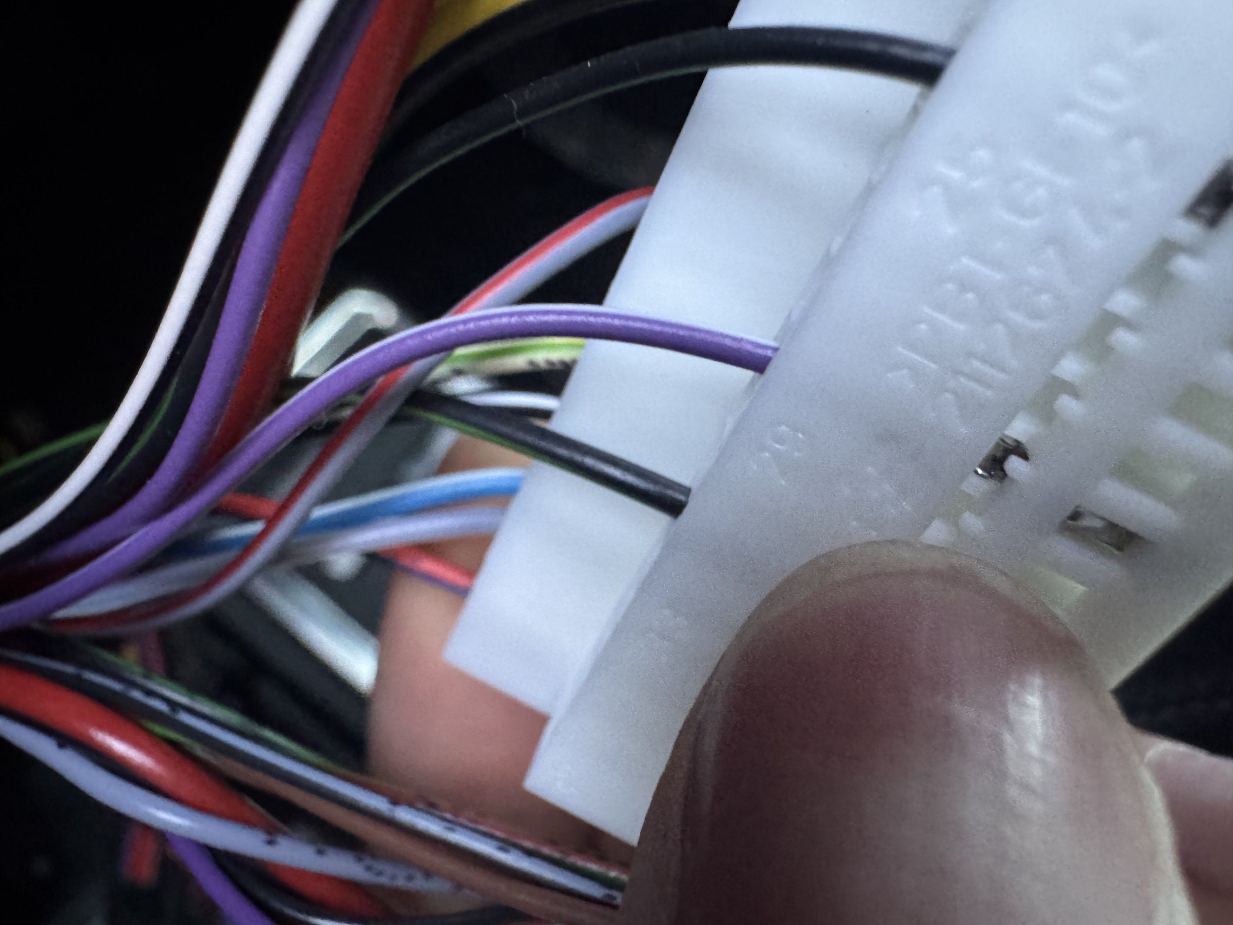

Hi all sorry for digging up an old thread but I retro fitted the four footwell rgb lights I have coded them as described but unfortunately they don't dim from the cars menu the footwell brightness slider does nothing other then completely turn them off if I go all they way down they do get brighter and dimmer when I use the slider for the doors any Ideas ?

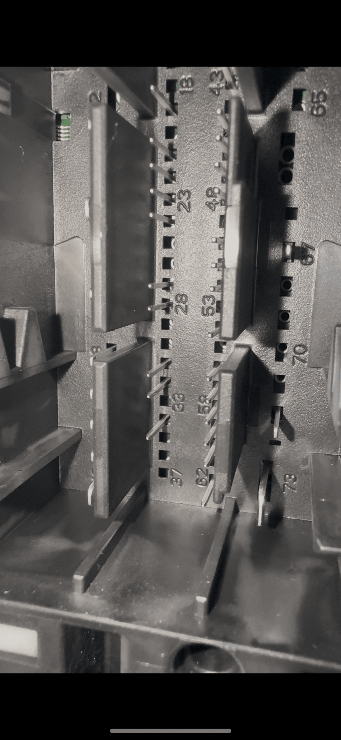

Hi,
Tried to install The aliexpress footwell light.
But realised i don’t have a lin cable on pin 29 to connect to, just the pin 28.
My car is a facelift one so that’s strange but maybe it is because it’s a style business.
My bcm part number is 5q0937084dc and it’s seems it doesn’t have pin 29 on the BCM.
@Chillout can you confirm i can’t retrofit rgb footwell light please?
