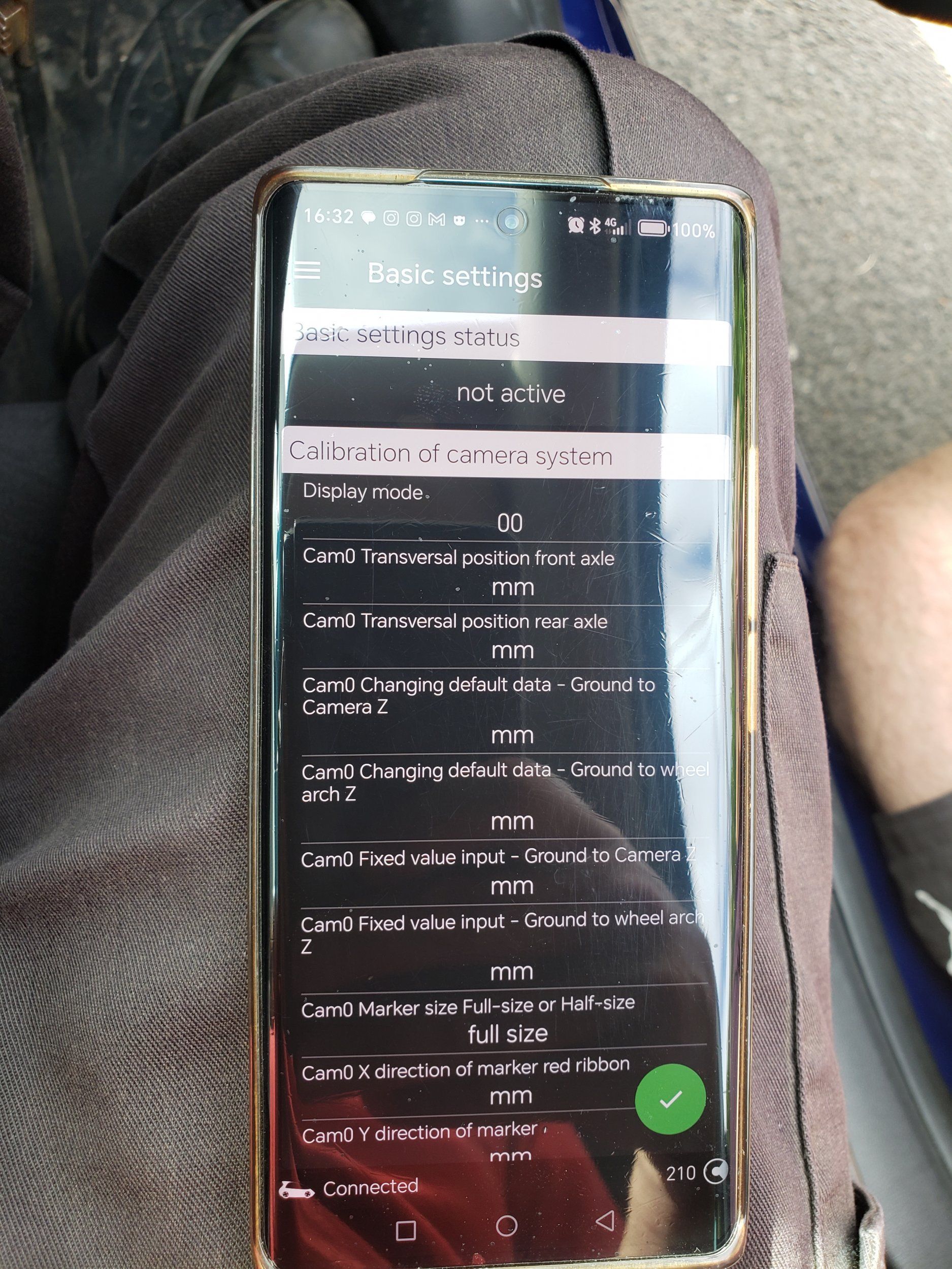

Cannot calibrate the system as All the measurements are at present blank

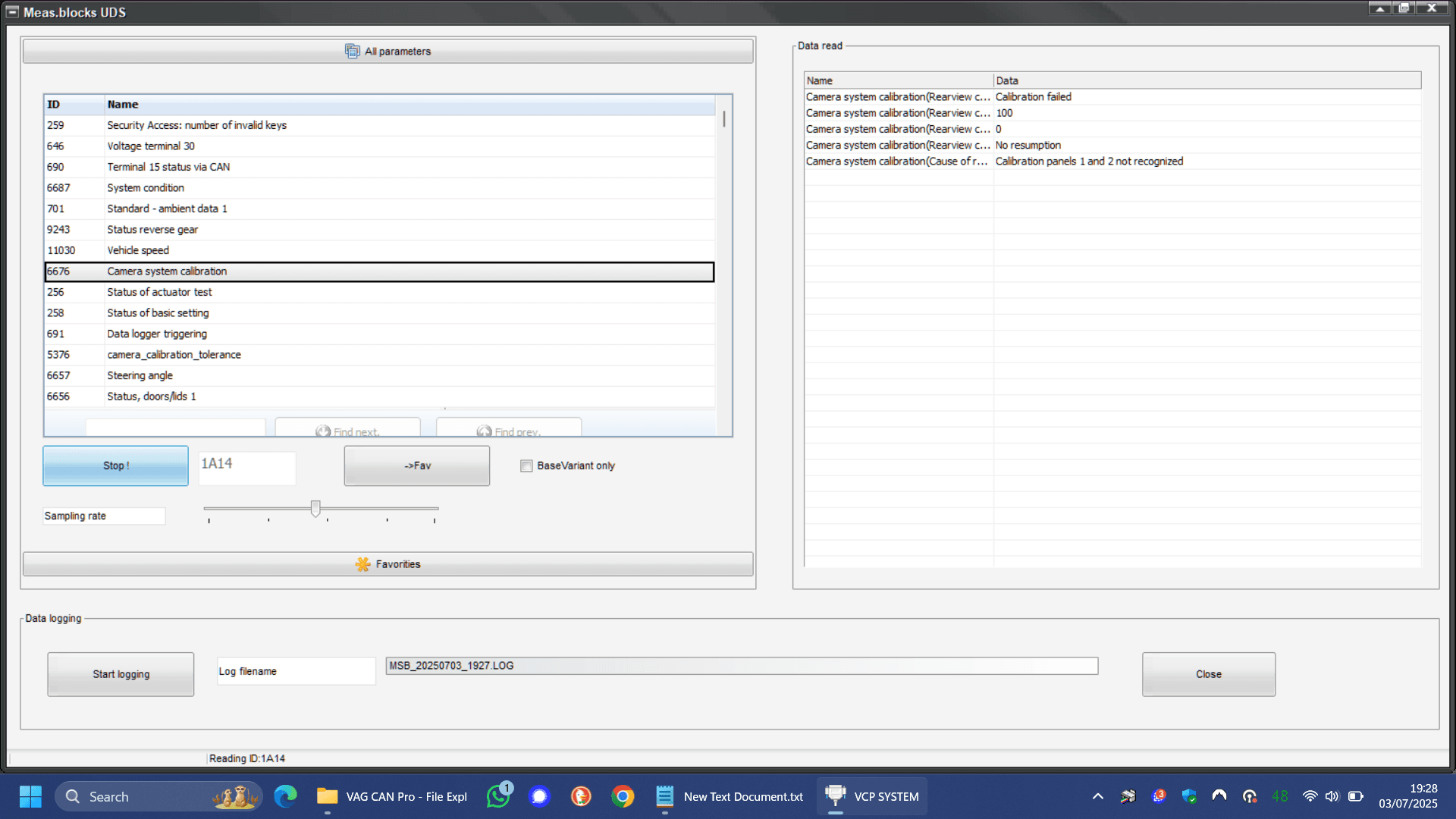

OK, a bit more info - I've had another play with OBD11, and yes, it's still not calibrating, but I've found the reason why. And now I need to sort something out.
Using manually entered figures found on a Golf 7.5 forum, which claim to be specific to the Leon ST, it's coming back every time with the calibration failing because of a malfunction. Further investigation has revealed this malfunction is listed as "failed to recognise calibration panels 1 and 2".
First of all, what does this mean? and secondly, what settings can be changed to sort this out?

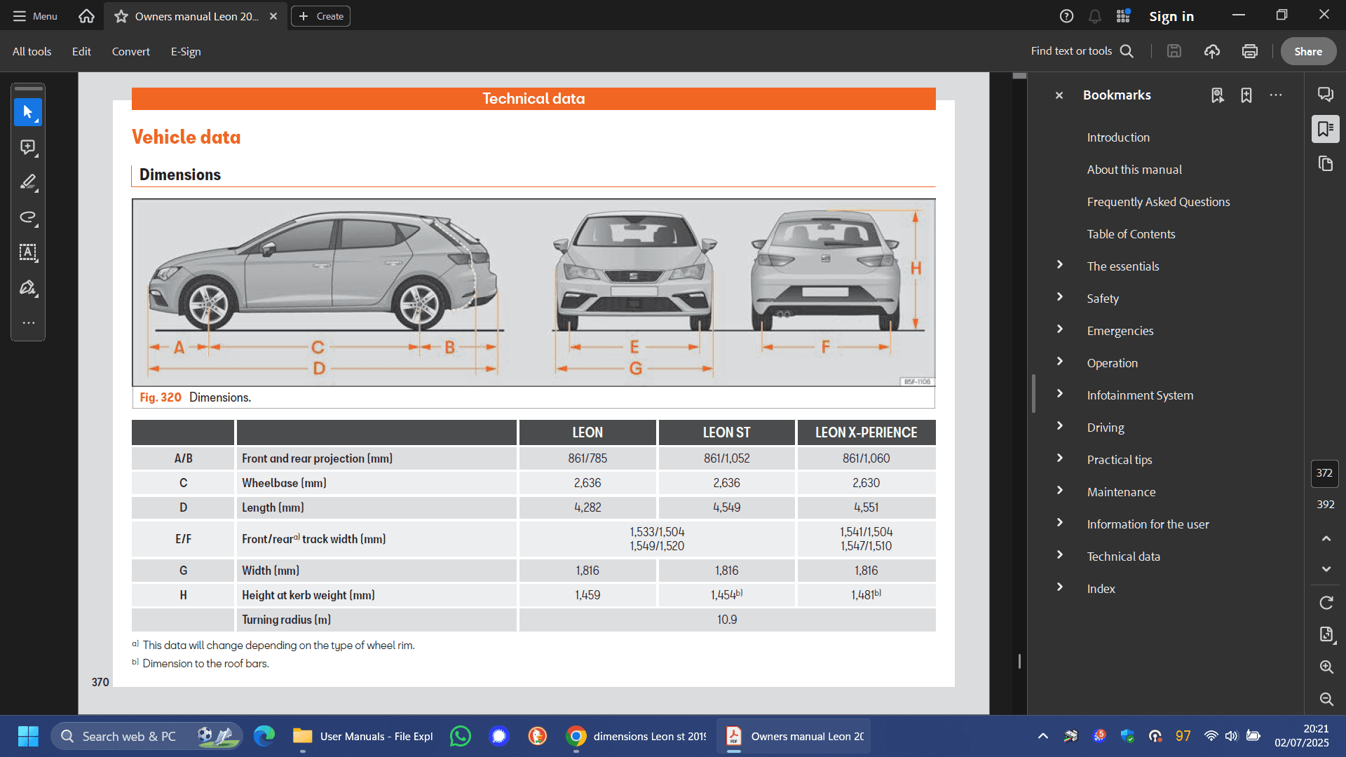

Cam 0 Transversal position front axle - 3091mm (measurement front axle to camera - wheelbase 2636mm + measurement B in diagram)
Cam 0 Transversal position rear axle - 1052mm (measurement rear axle to camera - measurement B in diagram)
Cam 0 Changing default data ground to camera Z - 550mm (measurement between ground and camera)
Cam 0 Changing default ground to wheel arch z - 670mm (measurement ground to highest point of rear wheel arch)
Cam 0 Fixed value input ground to camera Z - 550mm (measurement between ground and camera)
Cam 0 Fixed value ground to wheel arch Z - 670mm (measurement ground to highest point of wheelarch)
Cam 0 Markersize - Full size
Cam 0 X direction of marker red ribbon - 1600mm (distance from rear bumper where red line on screen required)
Cam 0 Y direction of marker - 30mm (offset from centre to where camera is mounted)
Cam 0 division counts horizontal (-32737 or -32878 ...only -32878 seems to work)
Cam 0 division counts vertical (-32737 or -32878 ...only -32878 seems to work)

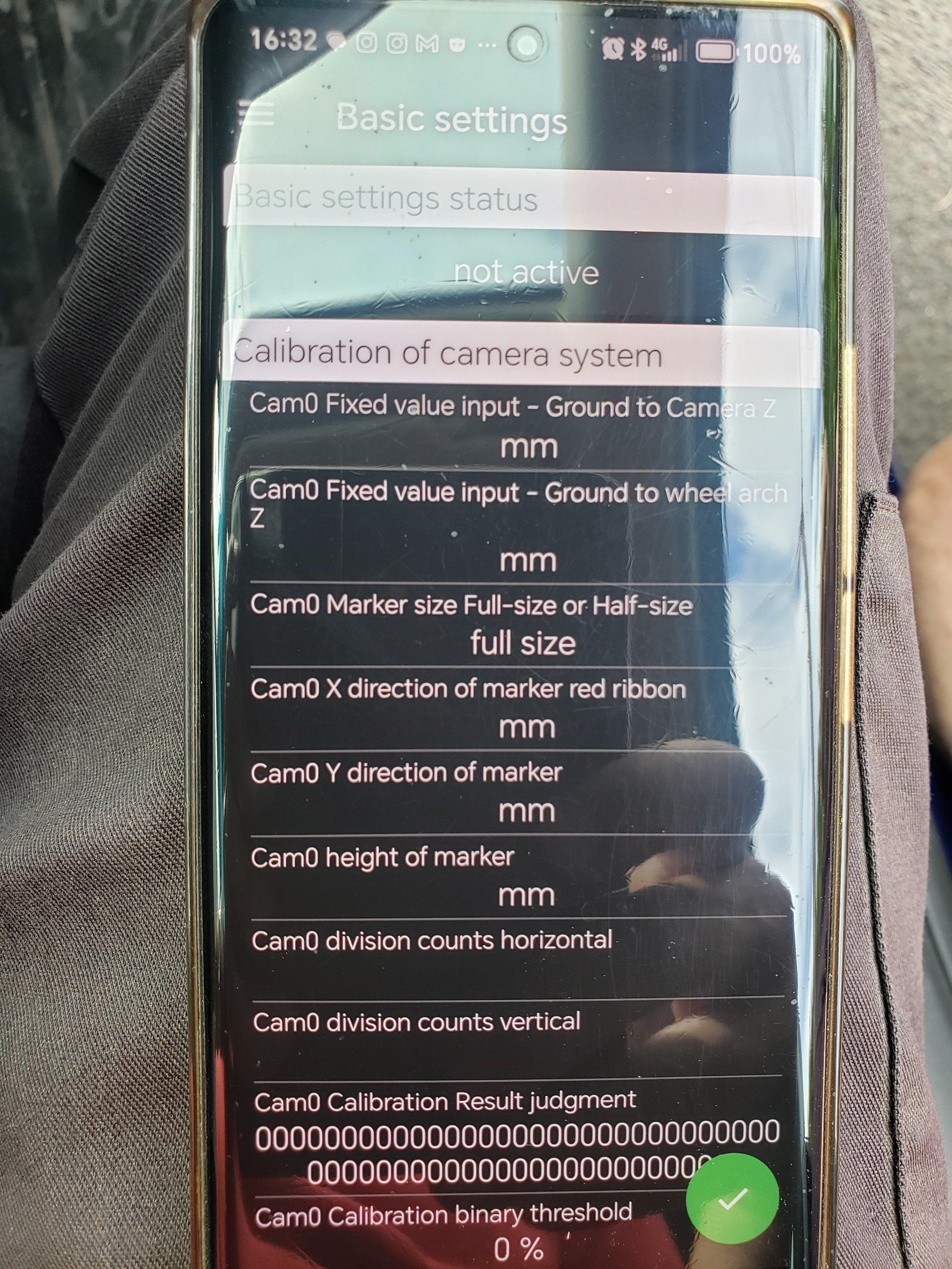

Cam 0 Calibration result judgement - all zeroes at present
Cam 0 Calibration binary threshold - 0%
Can someone please take a look at these figures and offer some advice - I realise that there are no specific published figues for the highline camera on the Leon ST - all I want is to get the camera calibrated and clear the fault

OK, dataset for Octavia 3 has been successfully flashed, but the problem remains that it will not calibrate - same error of calibration panels 1 and 2 not recognised - and same error on both VCP and OBDeleven.
Screenshot from VCP
Any ideas please

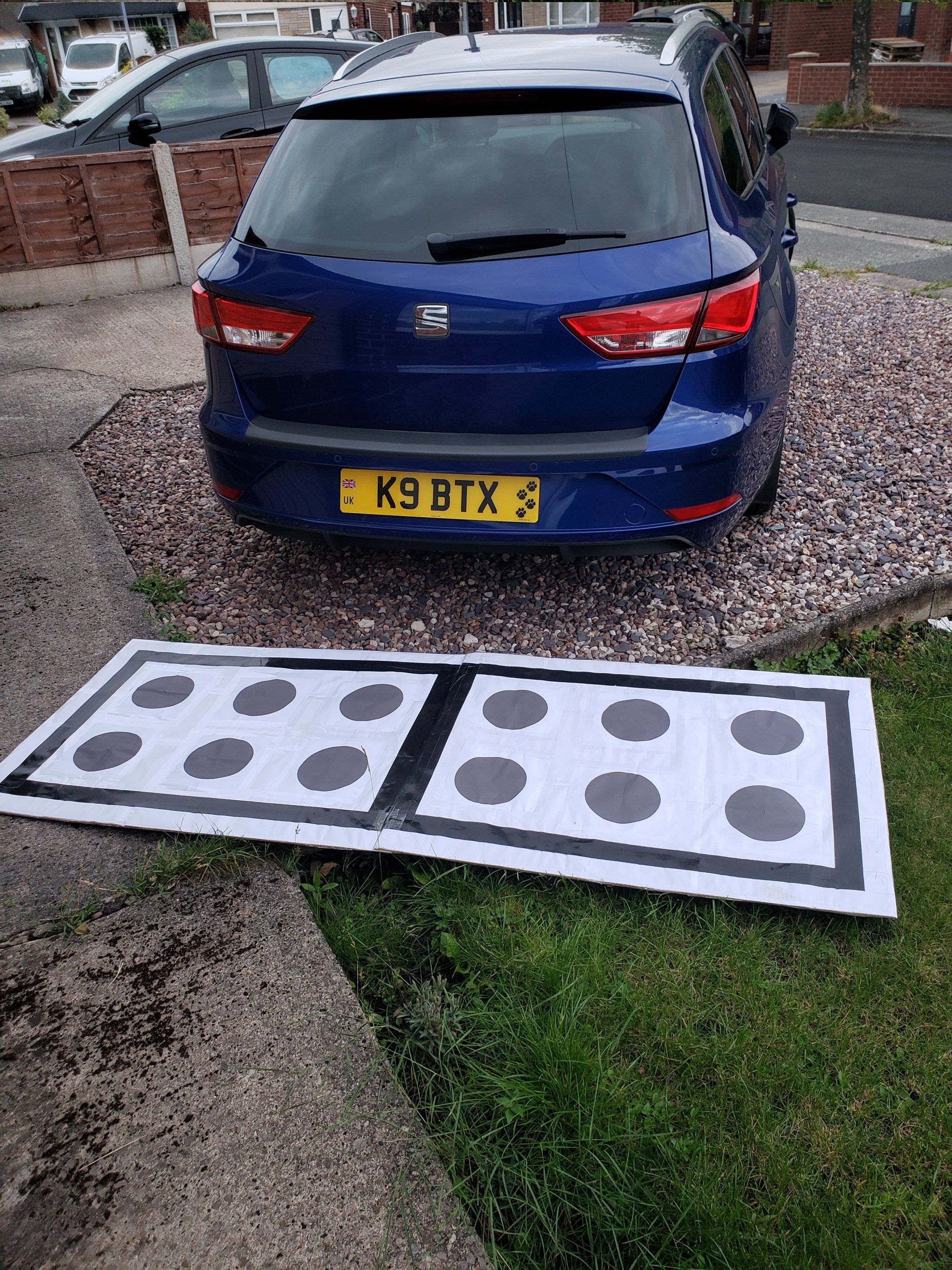

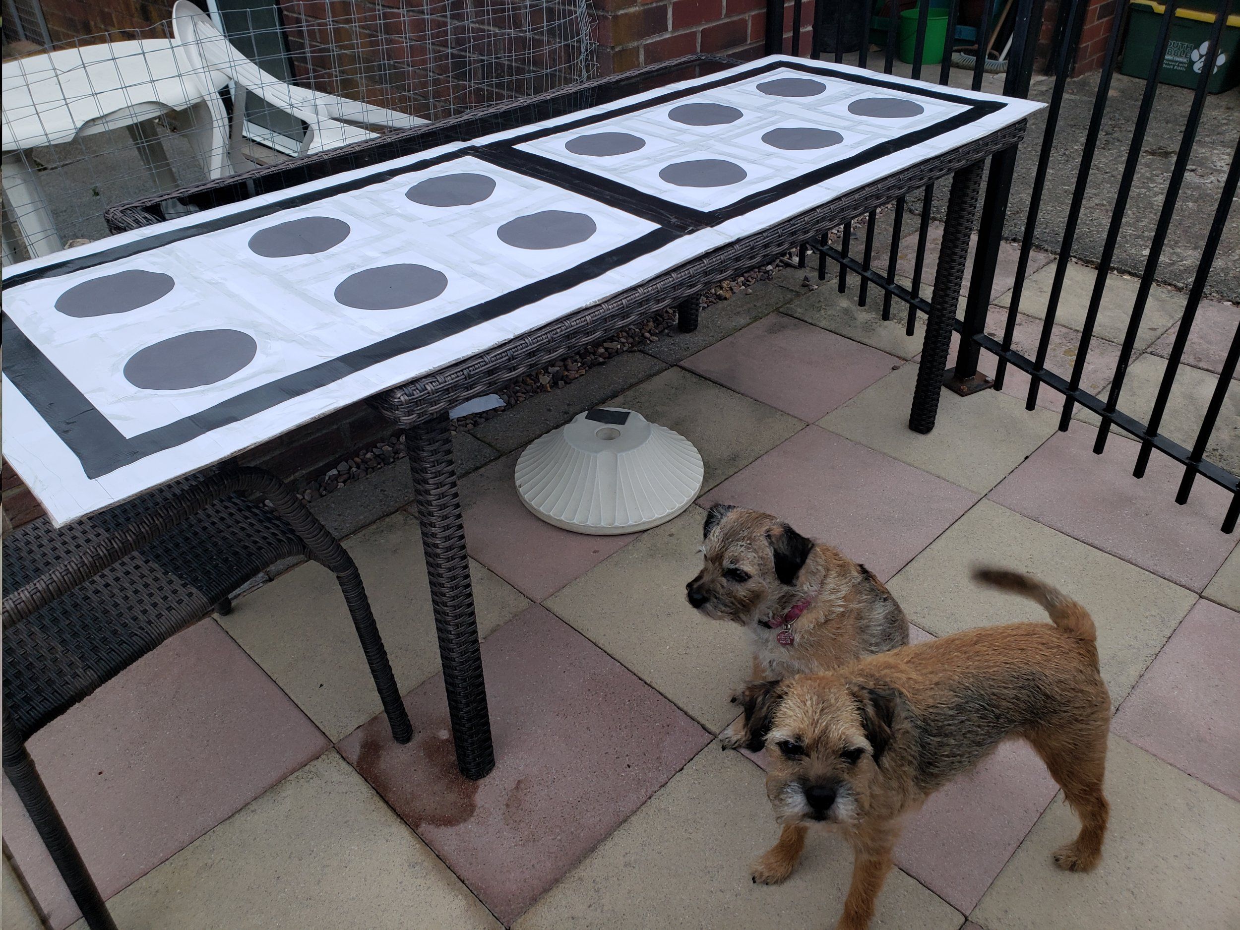

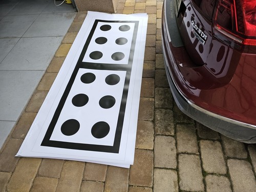

OK, home made board made this afternoon, not had chance to do anything with it. Dimensions exactly to spec, took a while but actually quite enjoyed making it up! Cost - a cut-up Amazon box, a few sheets of A4, some 50mm wide black tape, half a roll of Sellotape, a bit of printer ink for the dots and 2 hours of my time. Please excuse Rosie and Paddy photobombing the pic!
