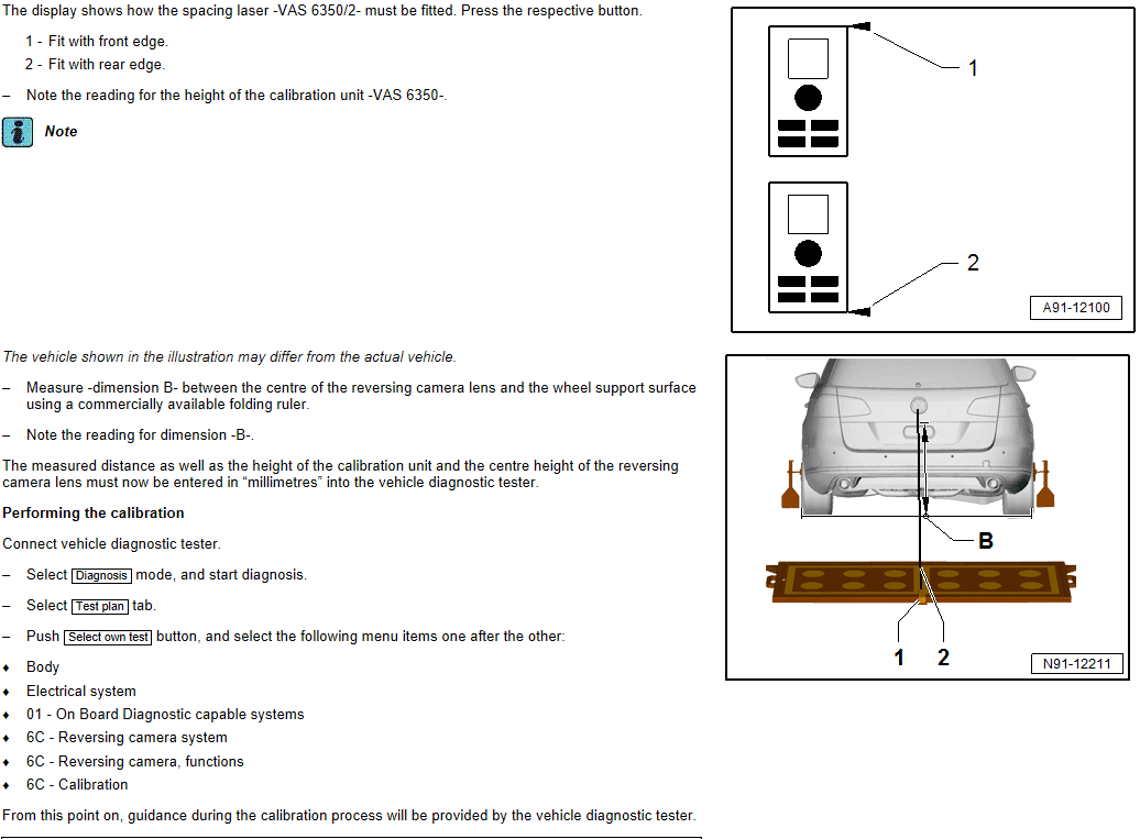

The boards are used to mark the central point for the calibration data to be confirmed as correct for the car spec such as wheelbase, boot open threshold, height from ground to camera etc, that's why laser tools are used to confirm the boards are located correctly for that specific car type. Keep in mind, the boards and calibration sequence is designed to be done via ODIS, which will do a lot of the heavy lifting with the process so it's expected that doing it with 3rd party tools will be problematic. Especially so with a car that was never specified with a highline camera.

For example, here is a random screengrab I just took of the Passat sequence:
