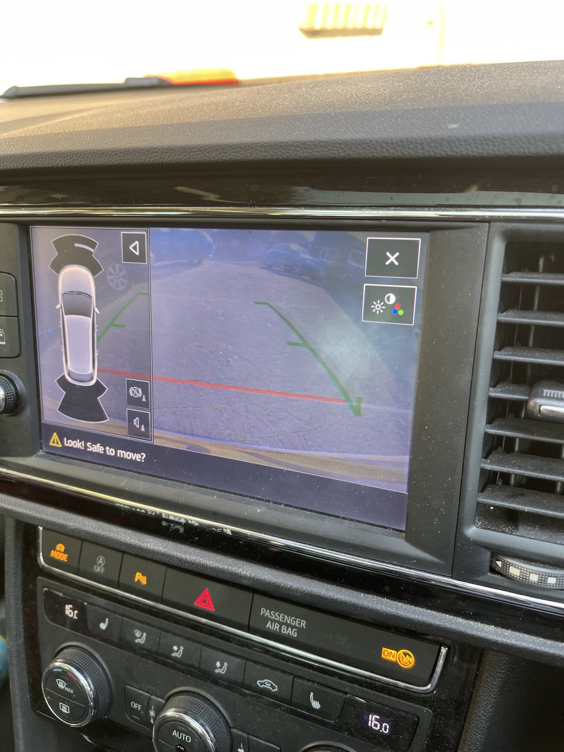

My reversing camera display is very dim for the camera image and the line overlay. Is this a camera fault as I presume the lines are added by electronics behind the dash?

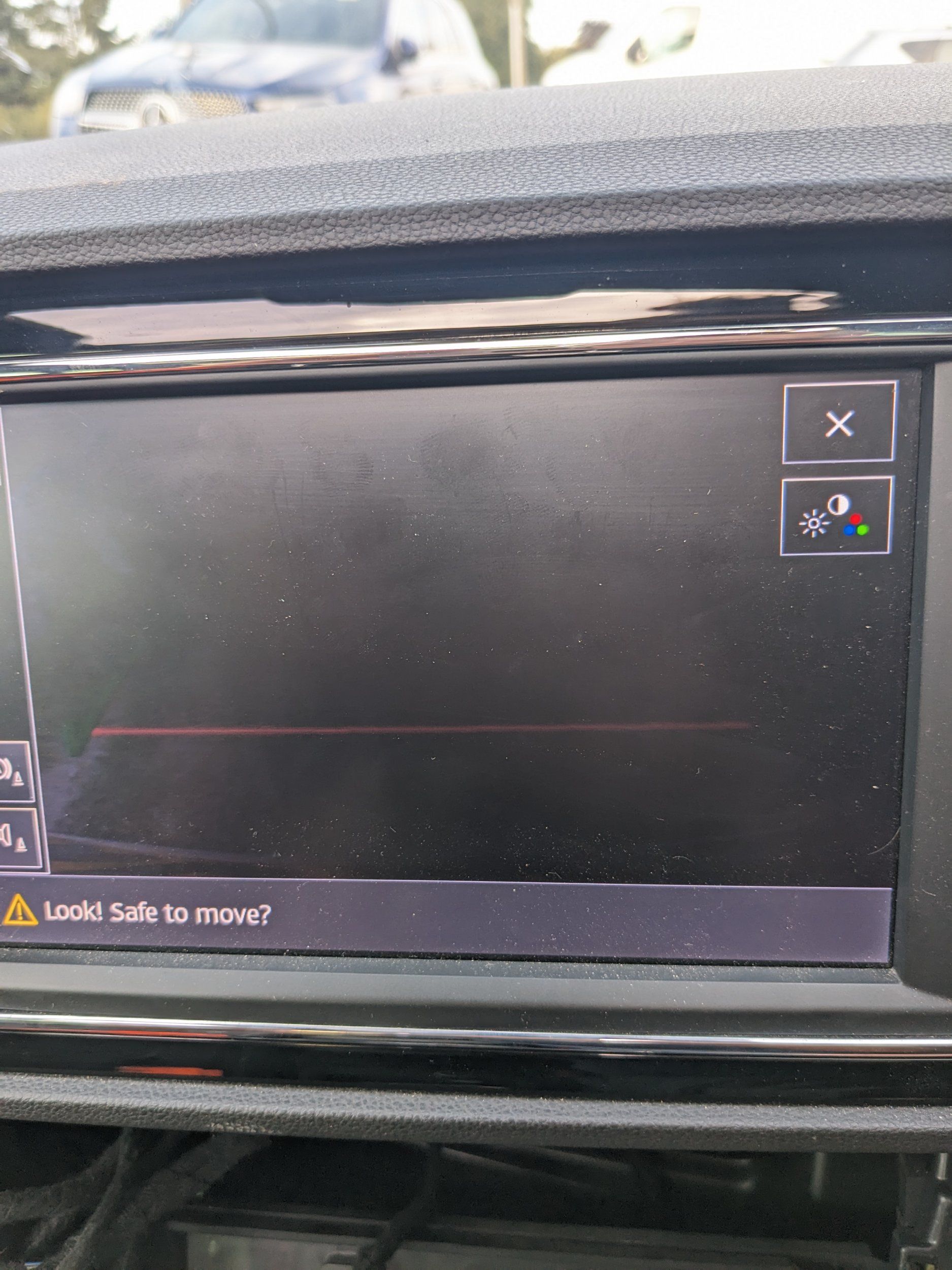

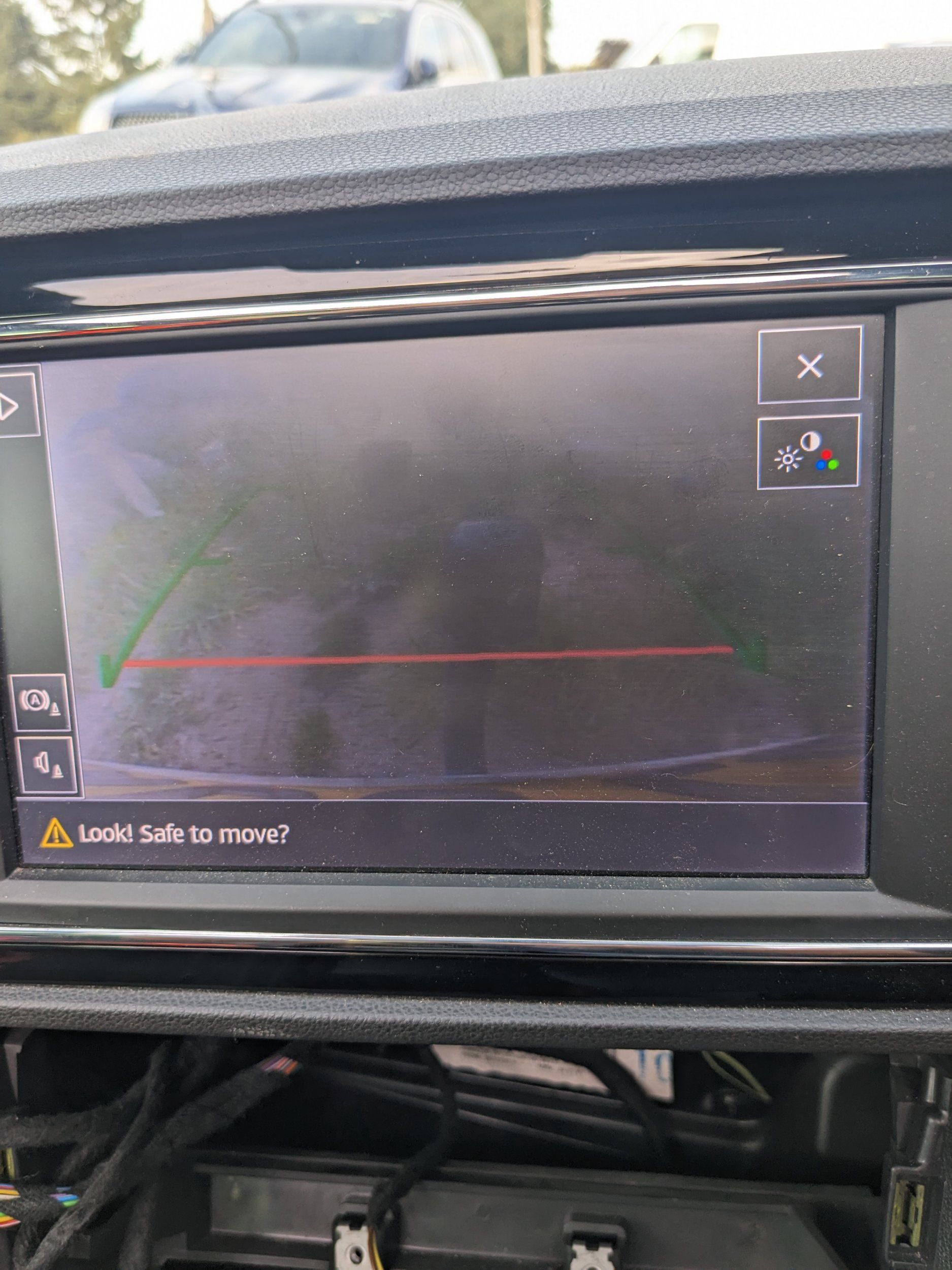

Here you can see my issues with my screen. Had to turn the brightness and contrast fully up just to see anything.

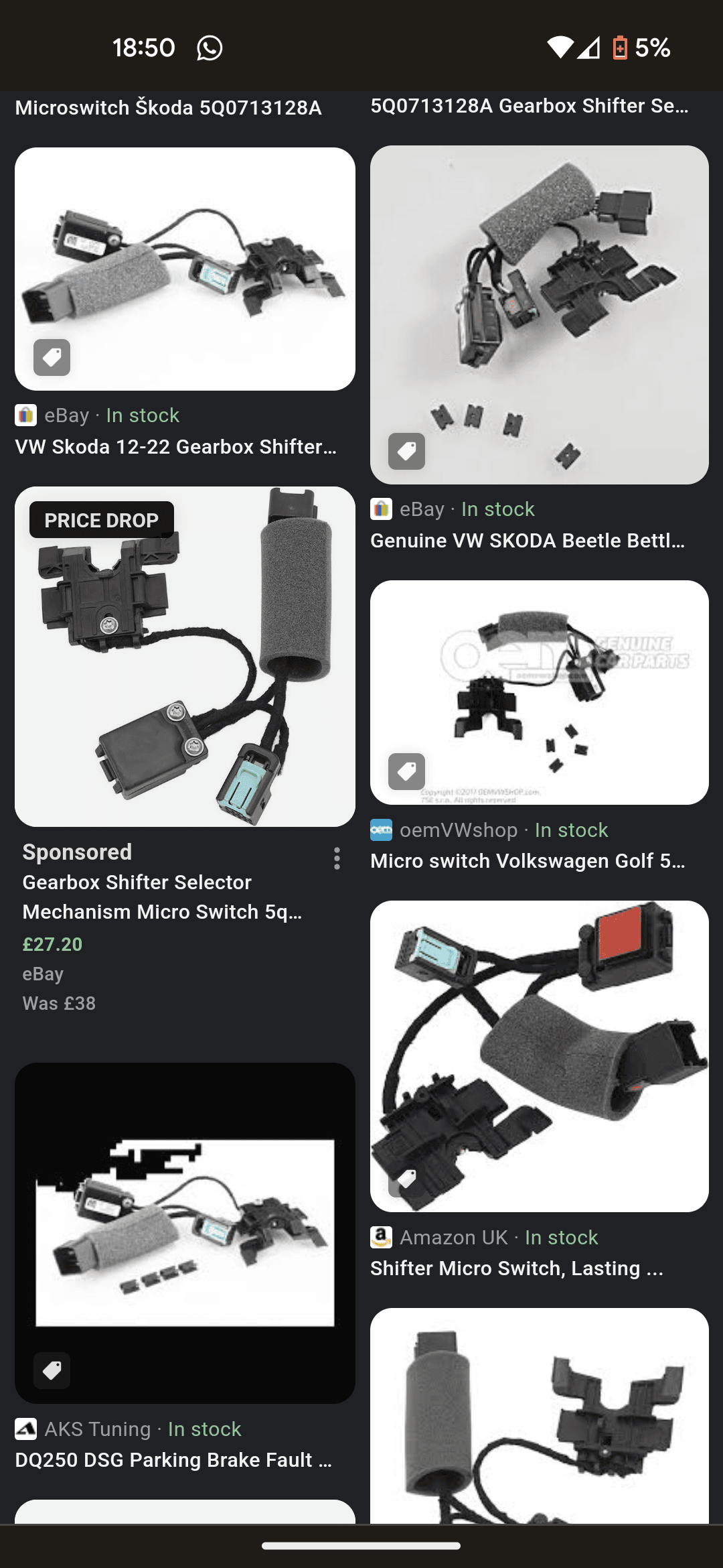

Read about the gear microswitch sometimes failing on alot of VW cars and there is a fix part.
5q0-713-128-a
It's basically an external microswitch released by VW so you don't have to change the gearbox.
Thinking about buying to see if it fixes my issue or not 🤔

More than likely it's the camera. Mine went darker and cloudy because of water ingress. Fitted a new camera and it's fine now.
adambolus
Apr 2, 2011
1,200
Ripley, Derbyshire
I would have normally said the same, but it was strange how when car was in reverse I accidentally leant on the dsg gear selector pushing it sideways and the screen came back to full brightness and view. Hence I think the issue is gear selector end
