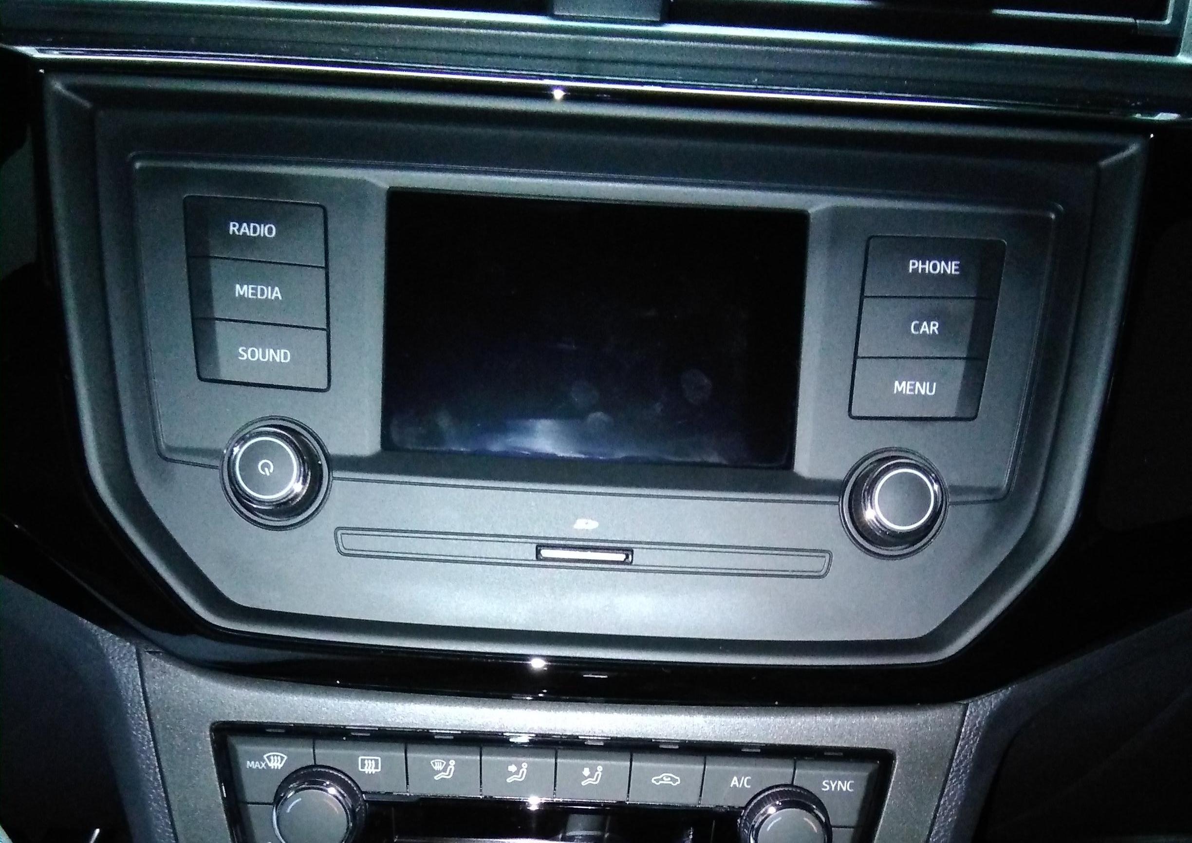

Hello, I want to ask if anybody knows if I can install a reverse camera on my seat Ibiza 2019 1.0 TSI 115Hp on this infotainment system.

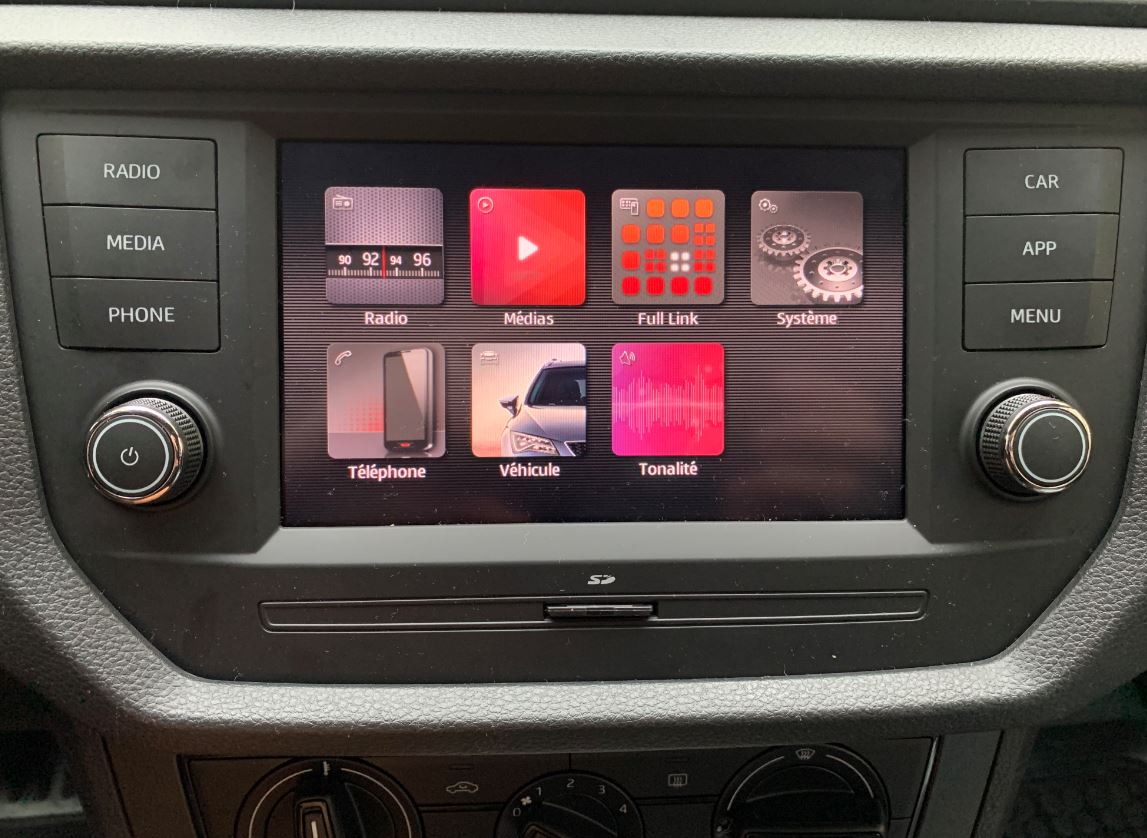

Yes you can install I have the same infotainment and I have a reverse camera.

If you mean this system? Yes camera is posible. But display of TS Is different.. this is the color touch system. With no navigation i think...My camera came with the car but there is in the forum someone that install a camera not the same infotainment but I think that its the same installation method.
How, did it worked ?Yes you can install I have the same infotainment and I have a reverse camera.

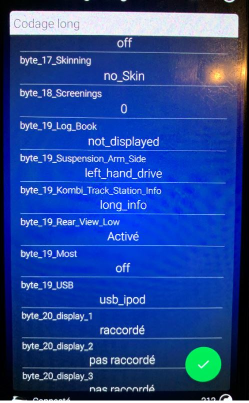

I tried the same thing (as I have the same infotainment type), but in my case it didn’t work ( I followed step by step the procedure, cable of the camera put into stereo’s back, obdeleven coding byte 19) and nothing ....double checked camera on an external screen and camera it’s working

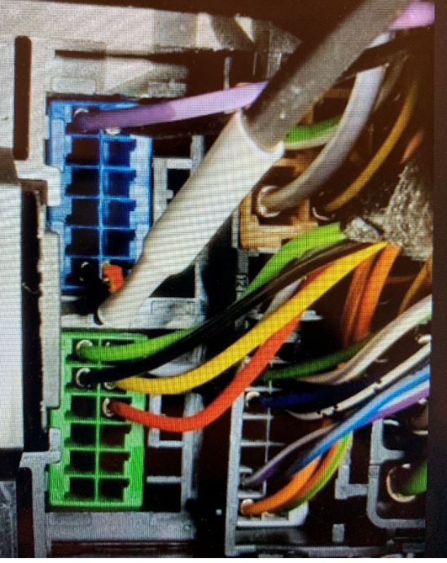

this is how I did it:
