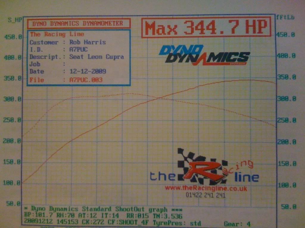

mate, i wouldnt worry about it, if there was an issue you wouldnt e making those figures which to be fair arnt to far off what is expected.
remember DD rollers dont give off these huge pub talk figures.
compare yours to these
Bluefin stage 1
thats enough proof that what you have managed to get from your s is pretty much what to expect. you cant go comparing DD rollers to others as you will just end up dissapointed chasing fiures that might not actually be there in the first place
maybe a small service could free up a couple other ponies, but i wuldnt be worried personally
must have been a freak occurance :cartman::D
nah only joking. if your car can make good figures on DD rollers you know your car is good.
Would be intersting to check if the rubber valve in the DV is in good state.
Just saw a Cupra with a small hole in the rubber. It performed fine (bit lack of power) but gained almost 30 bhp after changing to the newer D rev version.
hi invisible, like the guys have said its a bit of a lottery sometimes so dont get too hung up on figures. saying that though my car produced over 300bhp on stage one revo on Dyno Dynamics rollers which people say are conservative rollers. by all means check there are no other problems like the DV or leaks but id imagine its fine but if you have been running it normally on low octane fuel that could be the problem.

Yours looks about right for DD rollers looking at the above graphs but the only thing thats weird is the standard 225hp figure ;).
Hi , Are your figures from the crank or the wheels ? If they are from the wheels then you are not too far out ,as it looses 25 bhp through the transmission.
