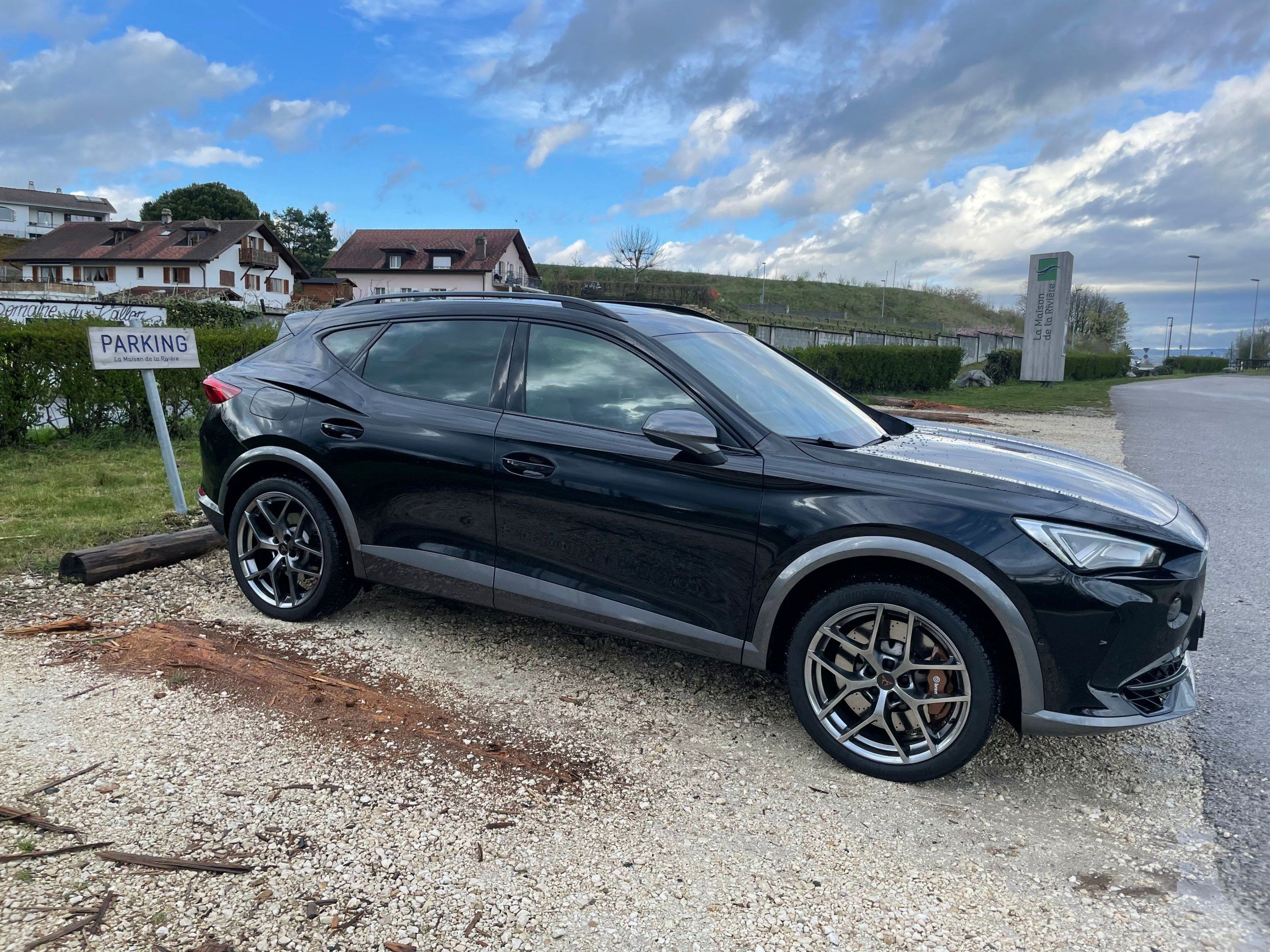

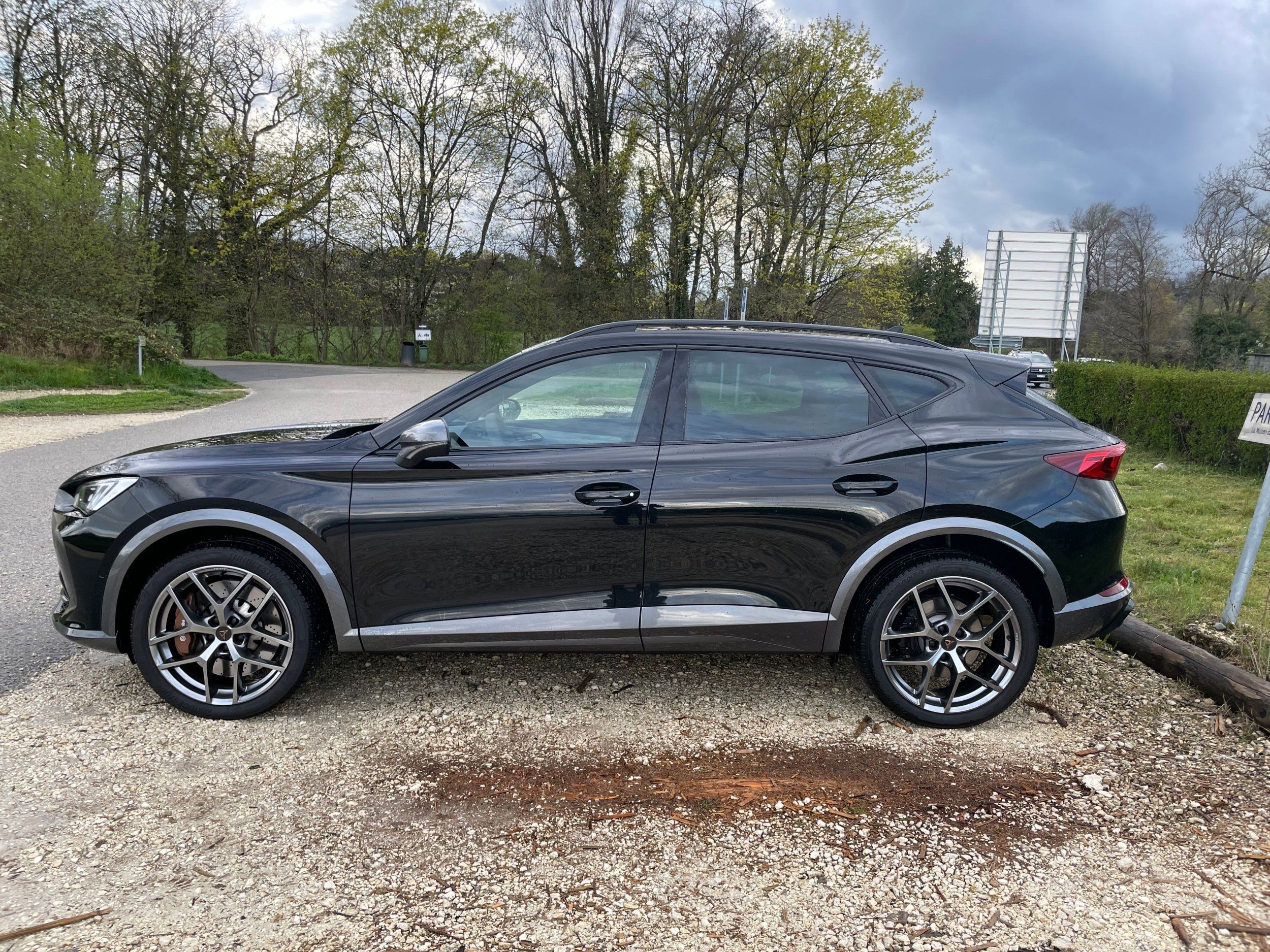

I finally went for the safe option: Borbet Y 8x19 ET37
It was at the end the only model for which I was 100% sure that they would fit even with the Brembo brakes and be approved.
I did not want to take the risk of having not approved wheels or any potential issue with the brake calipers.
There's actually well enough space, I would say even more distance between the calipers and the wheels than with the original Cupra wheels.
